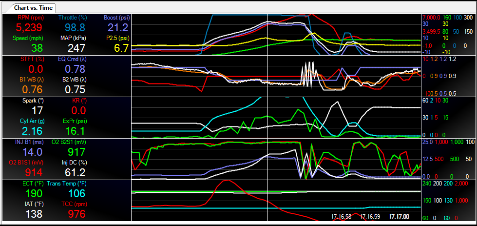

I figured you guys would enjoy this one, a dead idle stomp to WOT before I broke the trans, or this might have been what broke the trans actually. I turned down the controller a little bit so the turbos came in slightly slower than normal since it wasnt a prepped surface. The time scale is 10 seconds.
idle to WOT stomp
The gist is went from vacuum to 2psi before my foot made it all the way to the floor, then 8psi a half second later, and a half second after that was at 17psi or so. This was with a 10psi pulley and turbos set to 6-7psi. Lean tip in is also fixed. Spools twin s475s pretty fast!
