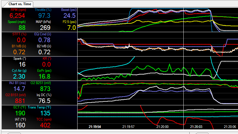

Never figured out what the cutting off issue was, but it hasnt done it the last few times so I am keeping my fingers crossed.
Went to the track again last weekend and did pretty well. It was hot as *****, probably still 80 degrees at midnight near 100% humidity. I think I am about maxed out with this setup since I am bumping up against the 30psi PCM limit with a 10lb pulley and the turbos around 10psi. The setup just gets crazy hot and doesnt really have a chance to cool off. I did 5 runs and the restart IATs on the later ones were 170+. I decreased the controller sensitivity some and that seemed to help with the boost moving around so much.
Turbos still come online super faster which I am very happy with. Here is a log of my best run that I wasnt bouncing off the overboost protection limit:
and here is the video of that same run, still havent messed with the suspension at all.
Next step I think I am going to try one of the larger pulleys I have to slow the blower to 6psi or so and see how that does with more from the turbos to get to the same total boost. May be a few weeks though, I am in the process of moving and setting up the new house and workshop!

What did it run?
I would vote for swapping the whipple for a TVS head unit. I think not compressing air between the rotors would save you a lot of drive loss.

6.5 something at mid 105ish
Eh, maybe, or I just get the new 2650 haha
