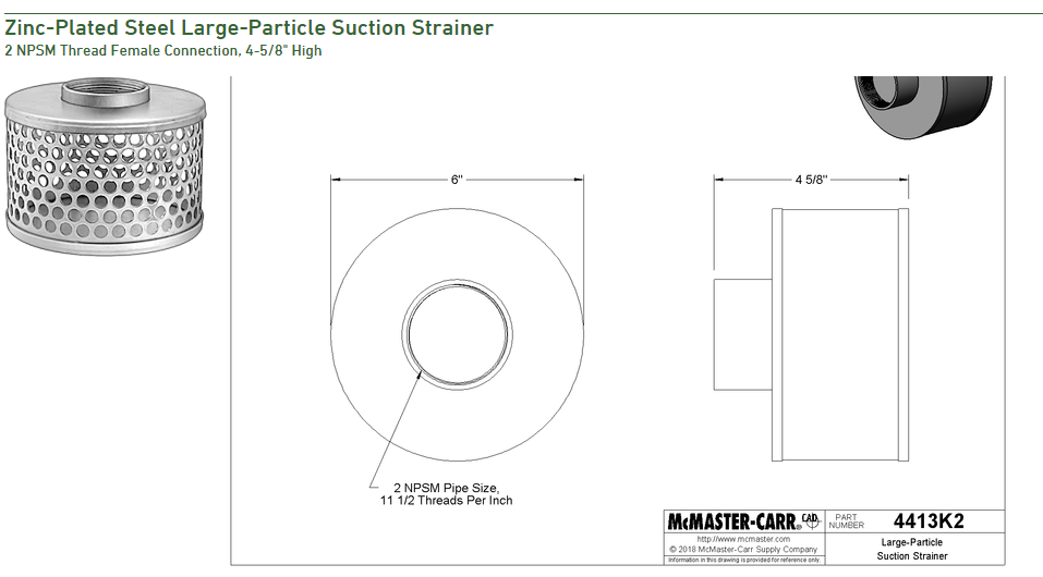

Get a live well overflow screen, it won't disrupt flow too much and will keep ice from plugging your intake and cavitation the pump.

Yea, something like that would be perfect, just need to find a 1.5" version or make an adapter of some sort.

It won't disrupt the flow but it will keep large debris out from clogging the pump. We actually use it in a chiller application.
Also, on the suction side you should use a rigid reinforced hose so it doesn't collapse. The standard fiber reinforced PVC clear hose you have now will soften up in the heat and collapse on the suction side... You need something like this, designed for suction and reinforced so it won't collapse. https://www.homedepot.com/p/HydroMax...2025/310837588

I think I found a winner for the inlet screen, $20 total on mcmaster for the screen and a 1.5 to 2" adapter, may as well oversize the opening
