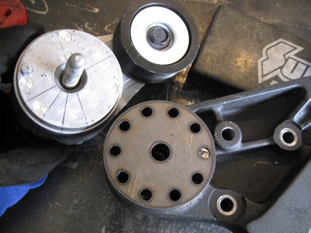

I got to work on the HD tensioner some, since I got everything else working I may as well change it up and try to break it again. Heres the issue with using it and why I was asking so many questions to the Maggie guys:

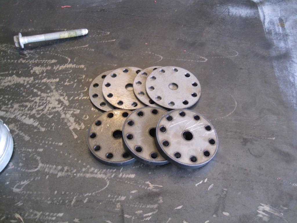

It obviously needs to come way out so I had some spacers/shims made in 3/8", 1/8", and 1/16" (which I dont have yet) to see if I could get it right. I had holes drilled along the edge that lines up with the tensioner pin and are every 36 degrees to give some adjustability. Really this means any tensioner that shares that bolt circle can now be used.

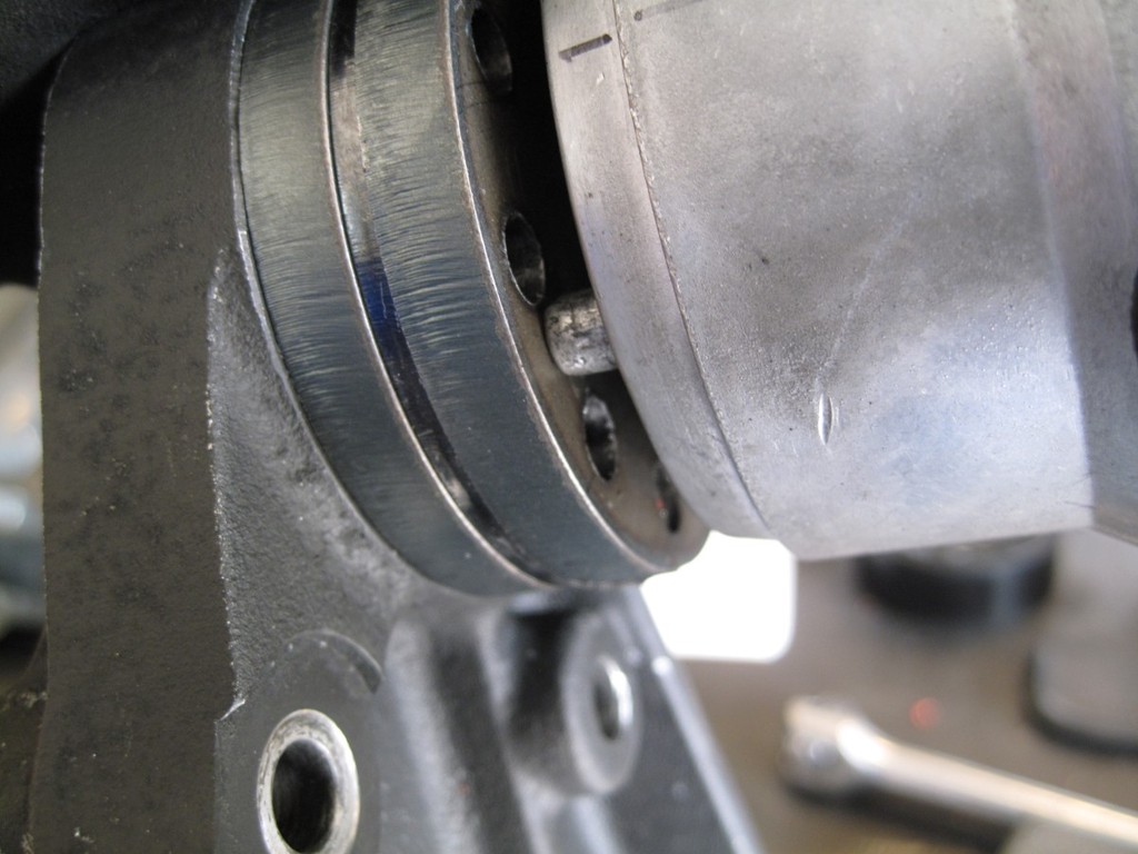

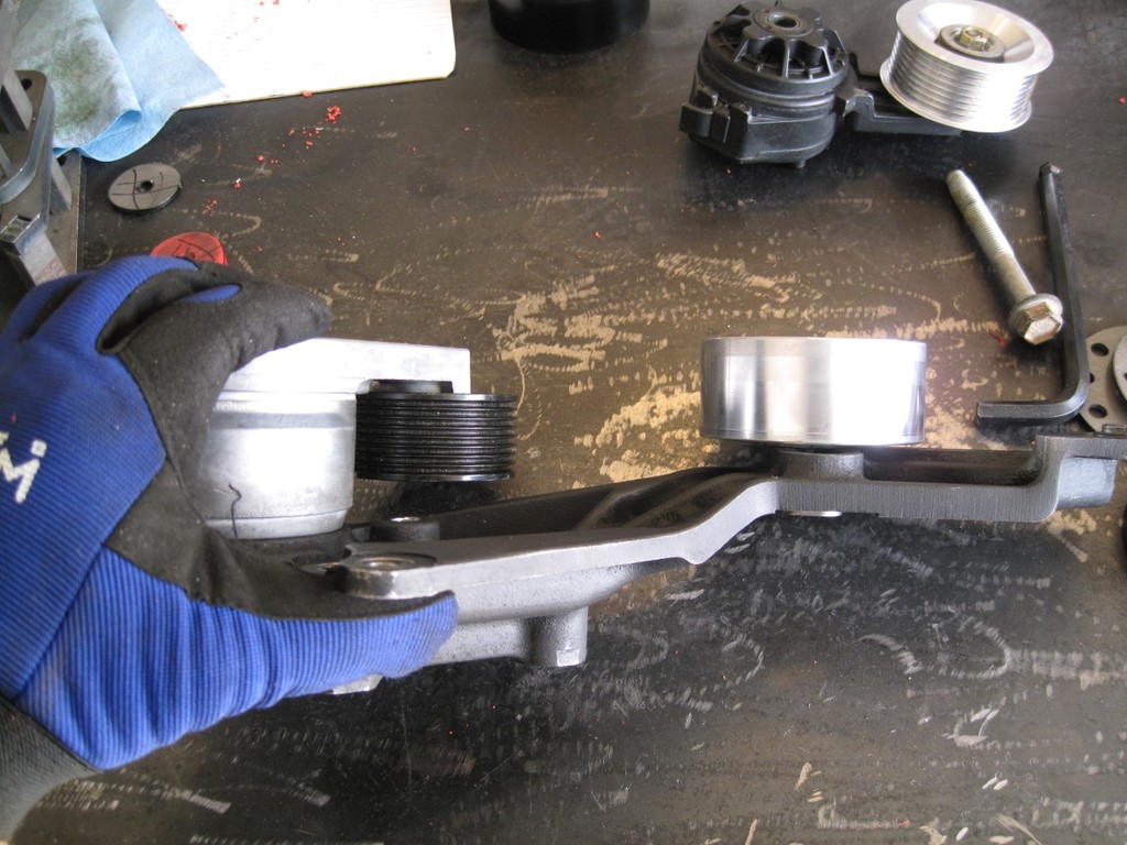

Eventually I am going to get some 5/16" rod to pin them all together and into the accessory bracket so they dont rotate, but for now a sacrificed 5/16" bolt works just fine. I plan to weld them together once I finalize what I need.

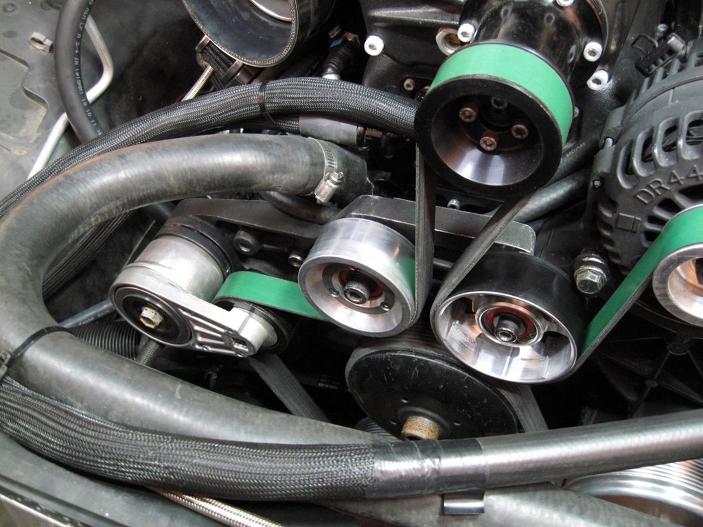

And here it is installed,
A lesson I learned is to actually measure where the belt rides on each pulley vs where the end of the pulley is since some of them have thicker flanges. Based on using a steel straight edge and measuring to the belt, I have the alternator, tensioner, and crank within half a millimeter, and the blower pulley to those within probably 1mm. I got lazy and didnt check the PS pump to that since it has a lot of thrust clearance.

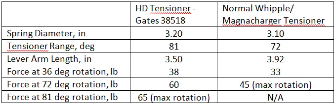

Also here are the results of some testing on the tensioners I did, thought it would be good to put here too.

Solid work! Thanks for the tensioner data too!
