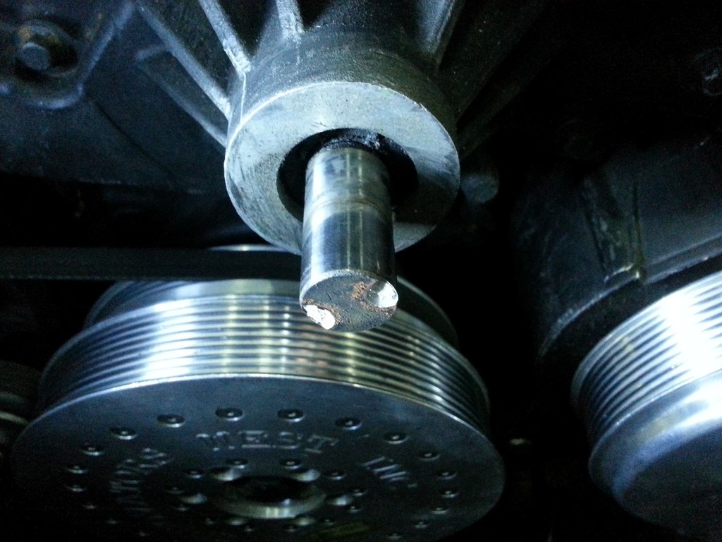

So I ported the IAC pathway in the entrance and exit and even drilled it out to 9/16", which I think I did it too much since now the IAC isnt able to go far enough to full seal the bypass. Its not terrible though, just turned the set screw back some. Its still loud as ****. I give up.
On another note, lets play wheres waldo!
And yes it was tac welded...

time to break out the welder

I remember Mike from New Era was having the problem of losing water pump pullies. He ended up going with an aftermarket pump from PRW that has a 4 bolt hub.

I also have a PRW water pump. No problems thus far but I never had a tacked stock water pump pulley come off either.
