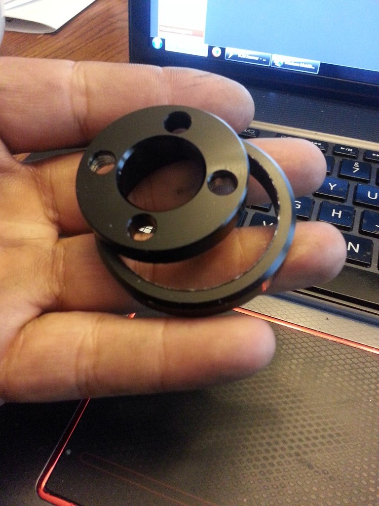

So had a moderate heart attack earlier...started the truck up to make sure I fixed the brake system from a problem I was having of the brakes self-applying after moderate braking pressure. Bleed the booster and cycled through a lot of fluid so I think I fixed that one.
Started the truck and after a few seconds I heard what sounded like rocks bouncing around in the intake. Not good. I put on a shorter belt and took the blower off the circuit and started it again and no sounds, so the problem must be the blower. In my mind the bearings are shot. This morning I take off the pulley to hook up the snout to a drill so I could spin it by hand and found this:
The spacer whipple made only lasted about 45 minutes of run time with no boost time. Obviously I need to think of something else, but in the short term I put the 6 rib pulley back on and no more sounds, so thats good!

So you have to use that spacer for the 8rib but not the 6rib?
Old Sep 5, 2015 | 08:53 PM
  #1030
Atomic's Avatar
I have a gauge for that
Posts: 16,282
Likes: 438
Correct. The issuebis whipple does not make an 8 rib pulley for the silverados. Thr 8rib pulley i have is for a lightning.
My options would be to replace the snout on the blower with a different one, or open up the bore of the pulley so a spacer could have more meat on it.
