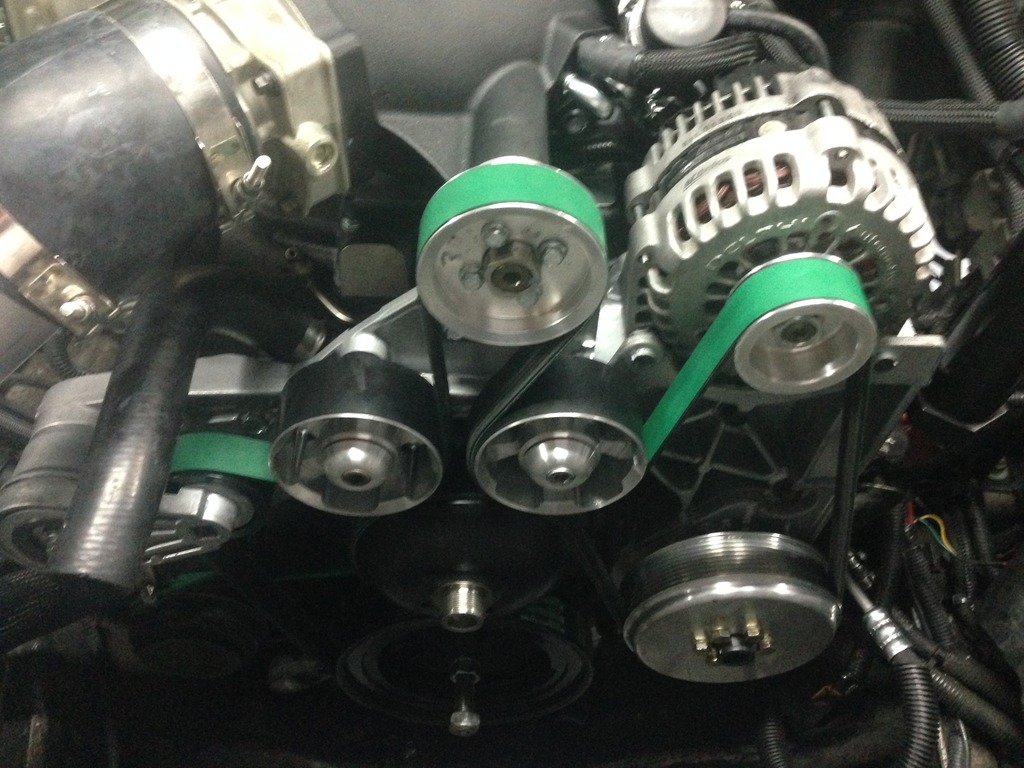

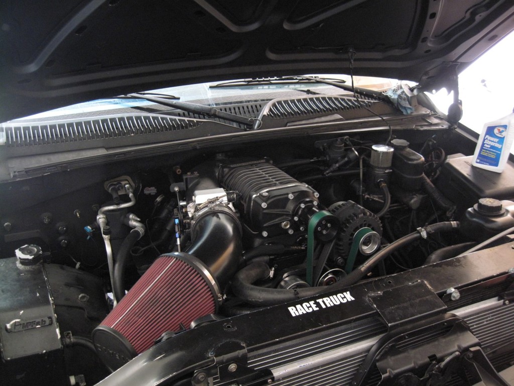

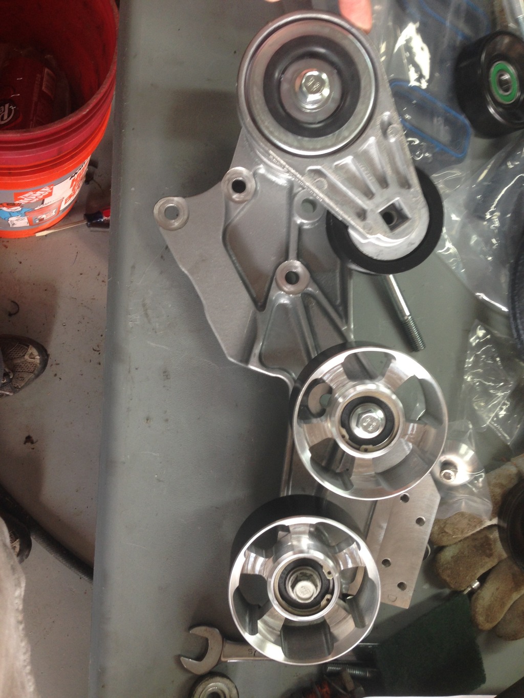

They are pretty damn close. I will gets you exacts in a day or so

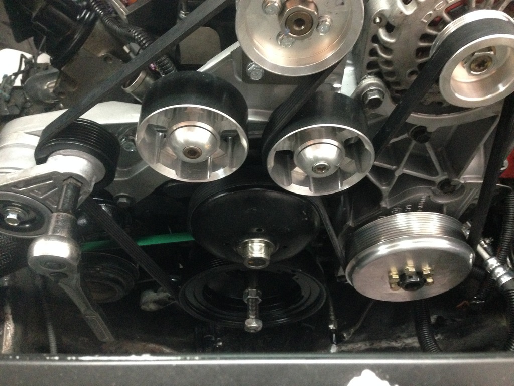

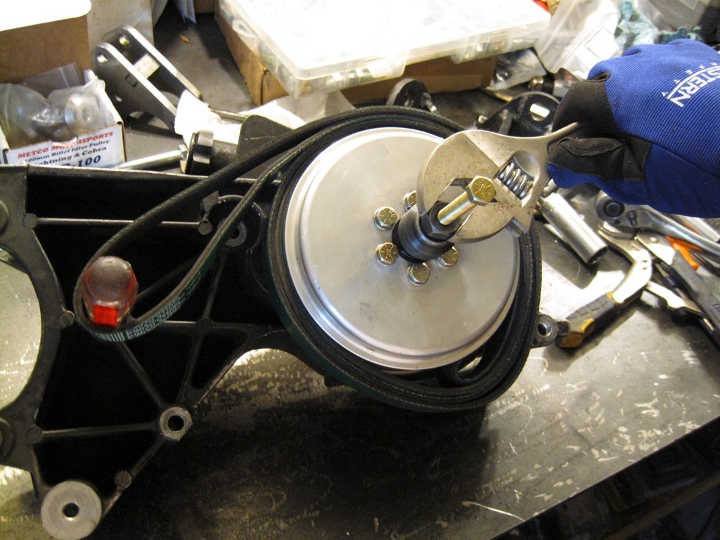

Got it working! Turns out it was the PS pump not being back far enough. Took the whole thing off, hit it with heat to get rid of that locking compound and pulled it off. I figured out a good way to hold the pulley still while I am pressing the pulley on. The new grade 8 bolt worked great.
Too bad I didnt think to do that sooner, freed up a hand to concentrate on tightening the installer.

No more noises? If so SWeeT
I orginally had my PS pulley too far in. I had to pull it out.

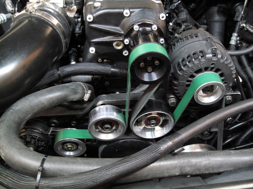

Nothing is easy when its my project
Ill get a video of the TB screaming later...

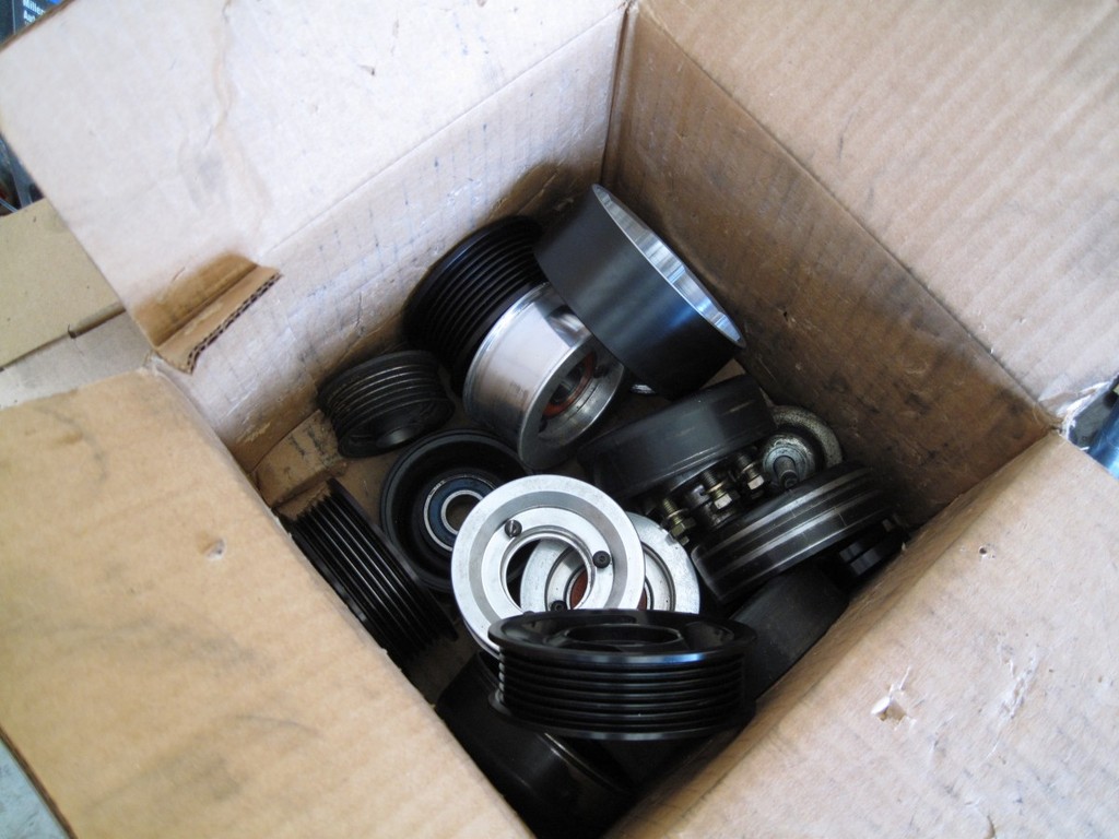

I have collected a nice batch of spare pullies though
