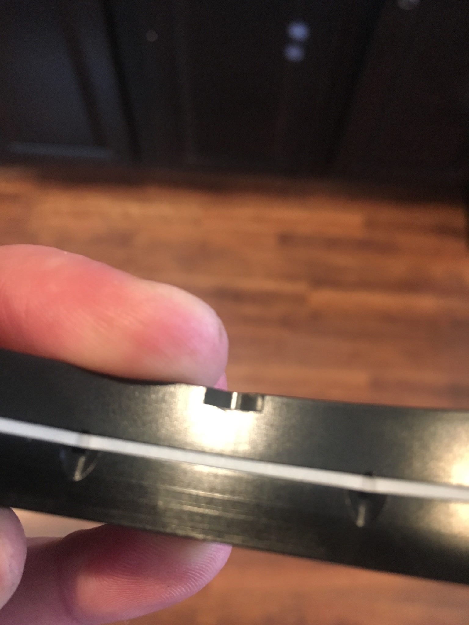

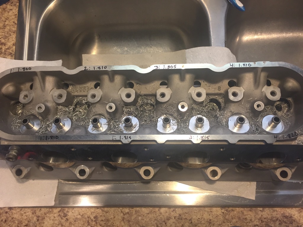

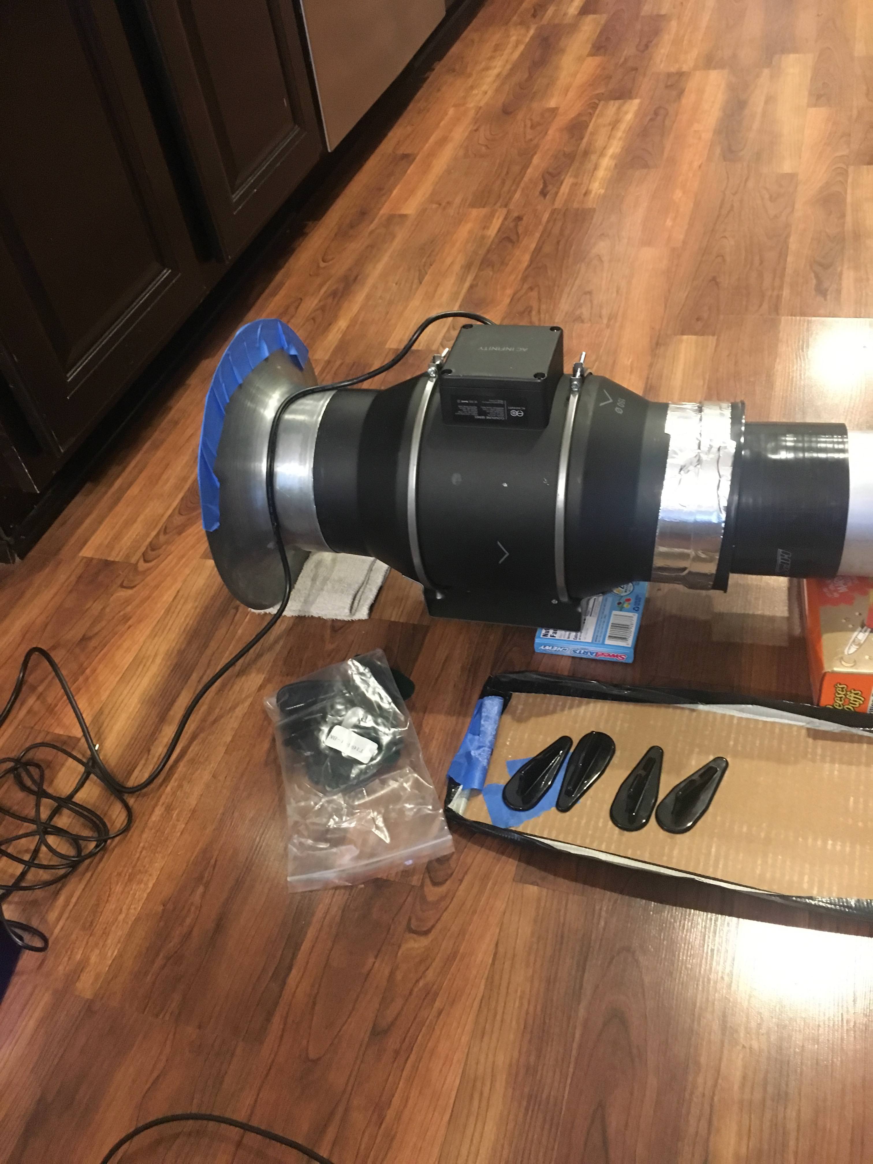

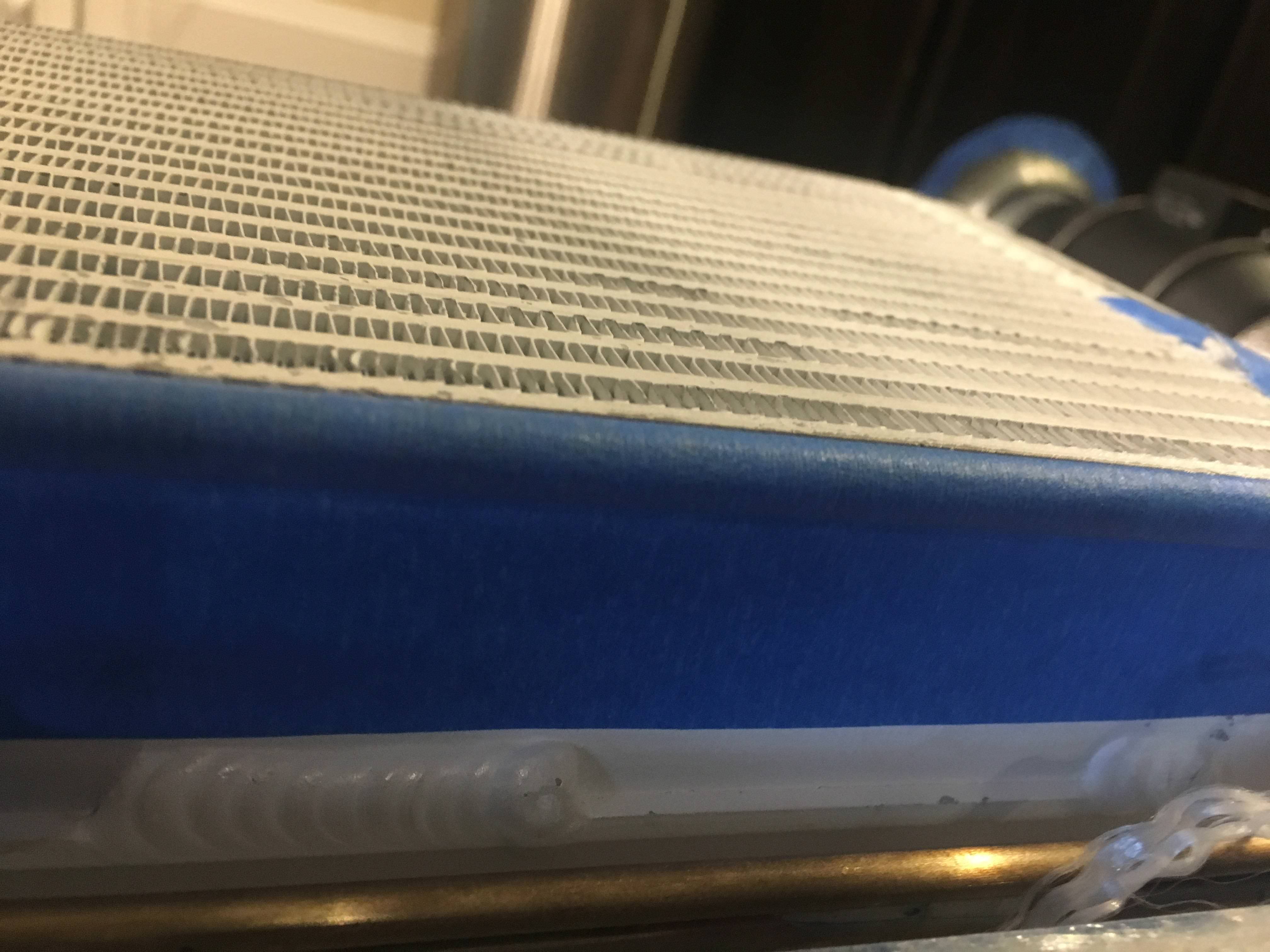

Got a plate to try out with water/meth injection and using the other spacer as a shear plate. Anywho though it was cool...
Also been working on some more airflow mods...I call it the Dynamic InterCooler Knapsack (TM) cause we all like DICK......but it does rearrange the vectors within the quadrants of the port, most specifically within the upper quadrant along the shear plane of the injection phase.

Upgraded the blower too

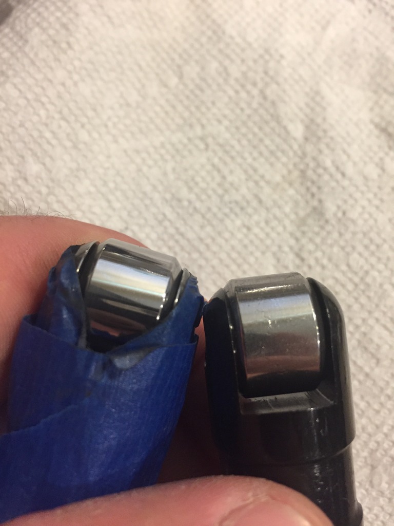

Some more messing up perfectly good parts:
Polishing the rollers on the lifters

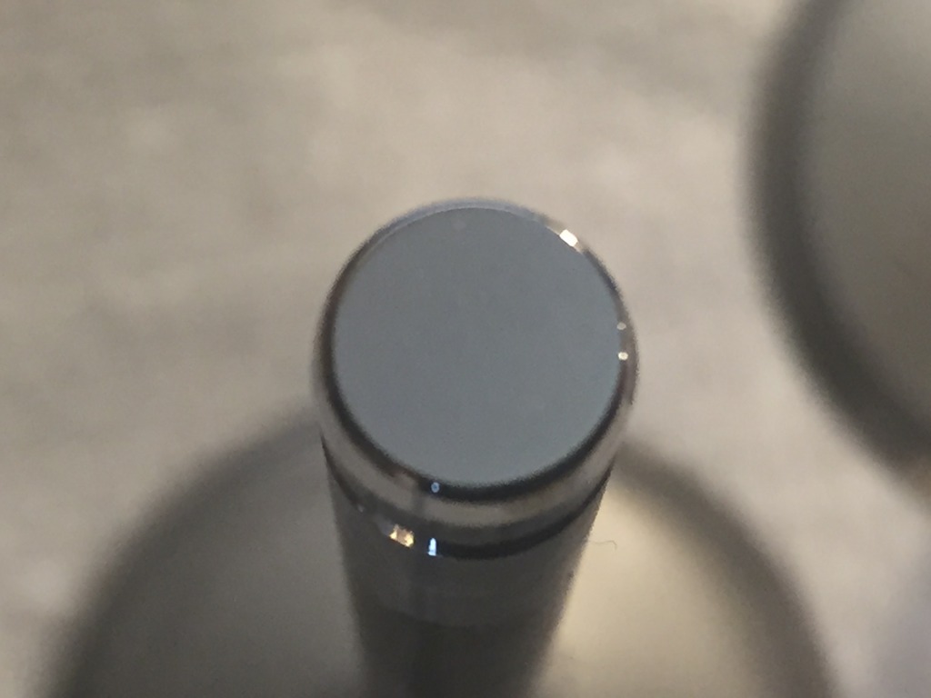

Valves and valves tips
Attachment 81181

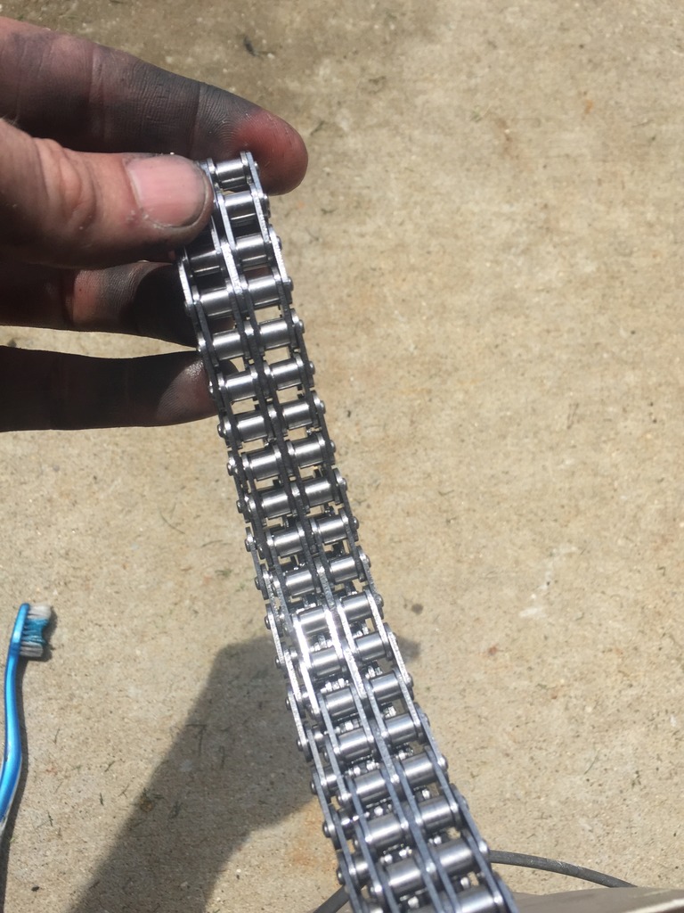

Roller chain

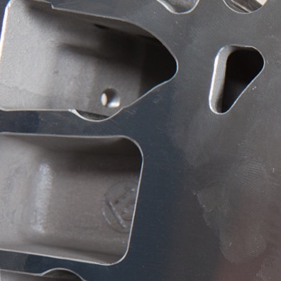

Cylinder head before breaking hard edges:
Attachment 81183
Cylinder head after breaking hard edges
Attachment 81184
