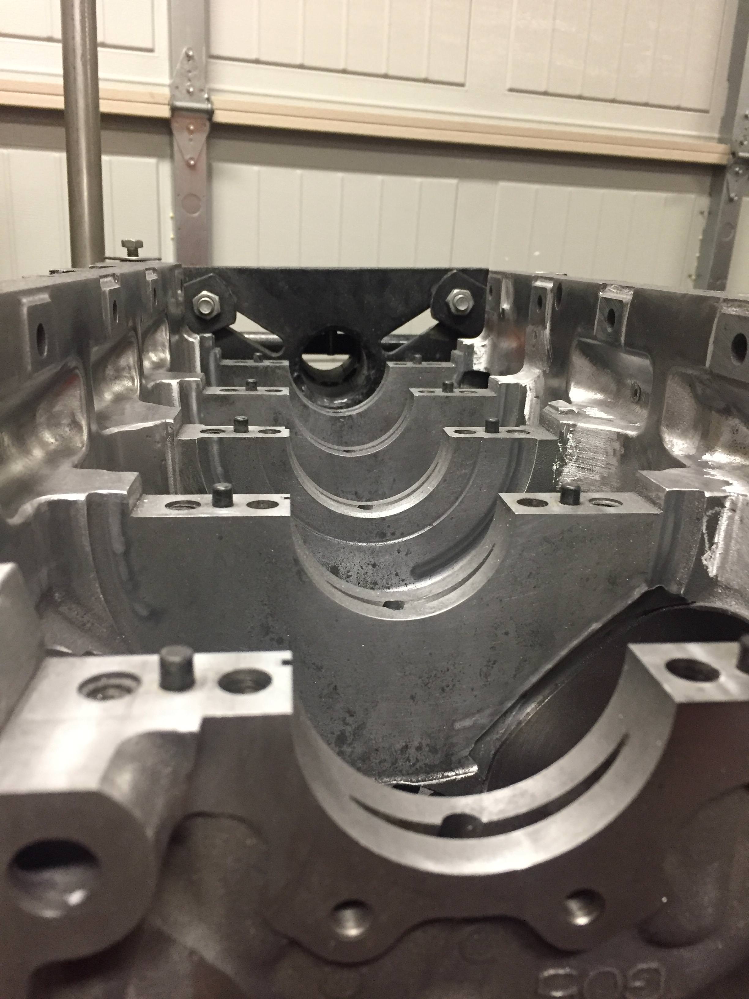

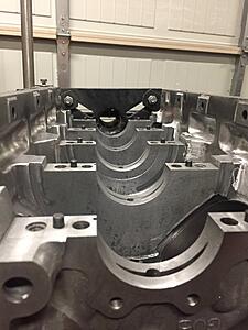

So close to being finished with the crankcase. All bolt holes and hard edges have been chamfered. With aluminum flexing and expanding so much the chamfer on the bolt holes will help prevent the studs pushing up on the edge creating a micro crack that turns macro...main caps seat properly...stop a burr from forming by the stud pushing on hard edge that could prevent the head gasket from doing its job etc etc

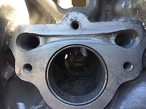

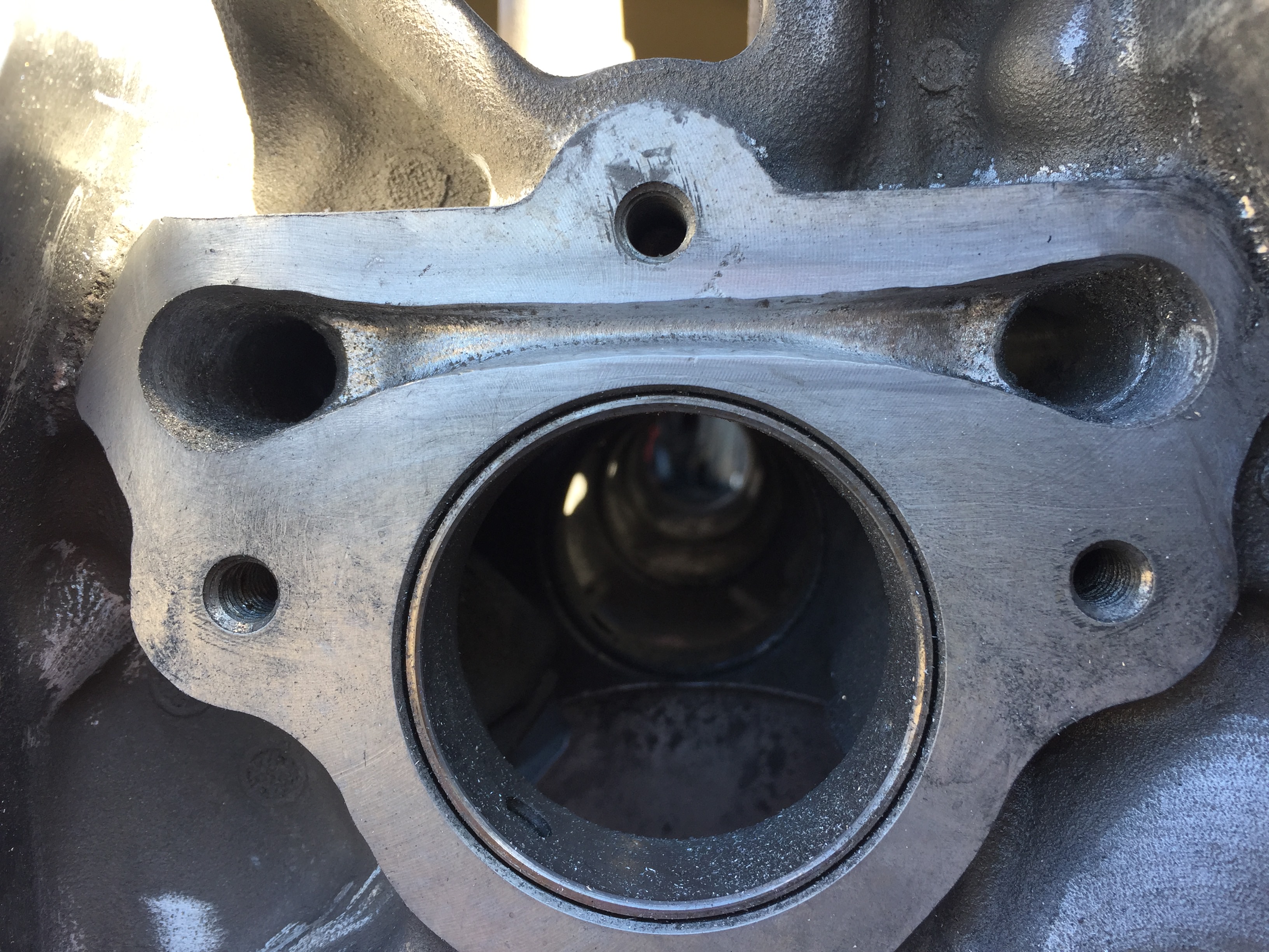

Porting front oil crossover....I’m softening the edges on all the oil passages

Man youre gonna have to have this thing cleaned all over again...

Eythlene glycol and phosphoric acid then hot soapy water will make it spotless
