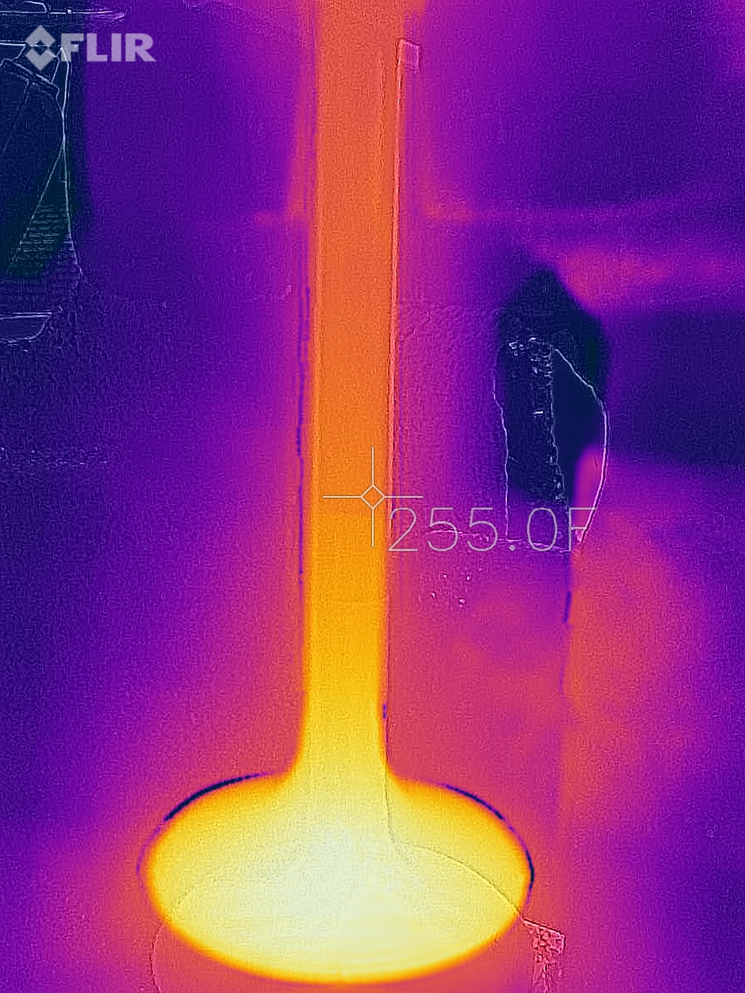

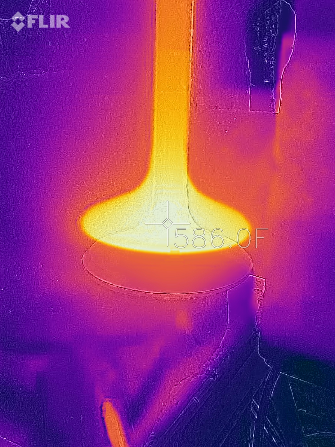

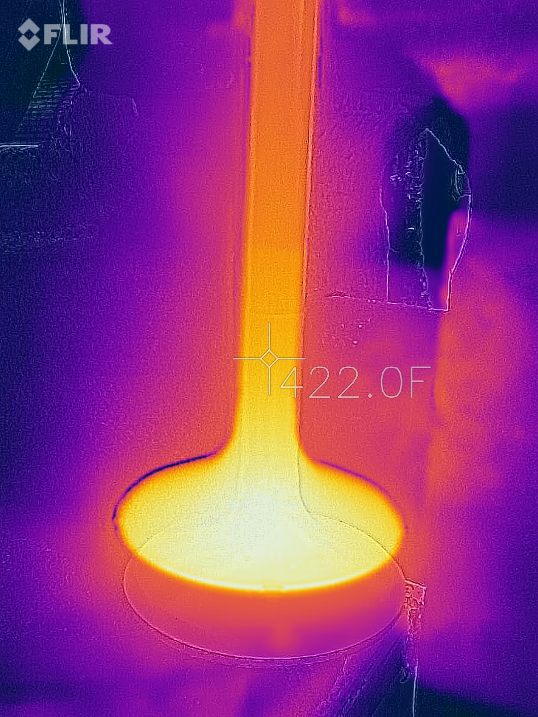

The pics are blurry because I used my wife’s phone and then texted them and then screenshot them.
LSX B8 piston (note uneven temperature distribution)
My coated piston (more even distribution)

Under what conditions did you warm these up for the images?

With a propane torch (used for those pics) , and thus far boiling water, oven, heat gun, oven ....some cool results from the exhaust/intake ports. Fun stuff

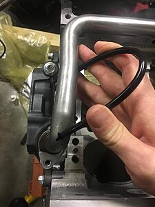

Oil Pump DICK...Direct Injecting Capillary Kicker ...uses what would otherwise be wasted energy and turns it into a extra pump and/or siphon.....thanks Schumann

You know that's the pump inlet right?
