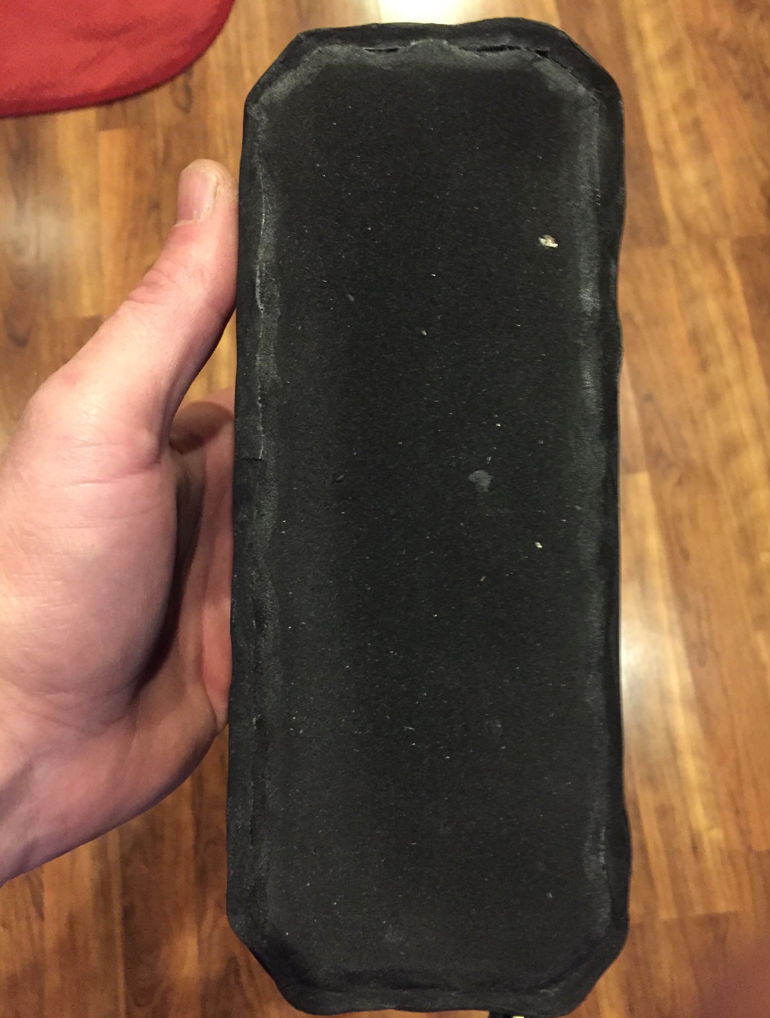

Secret Squirrel part....can you guess what it is?
Petro's Project ERL Superdeck 427 w/ Whipple 2.9L-sszuv0z.jpg

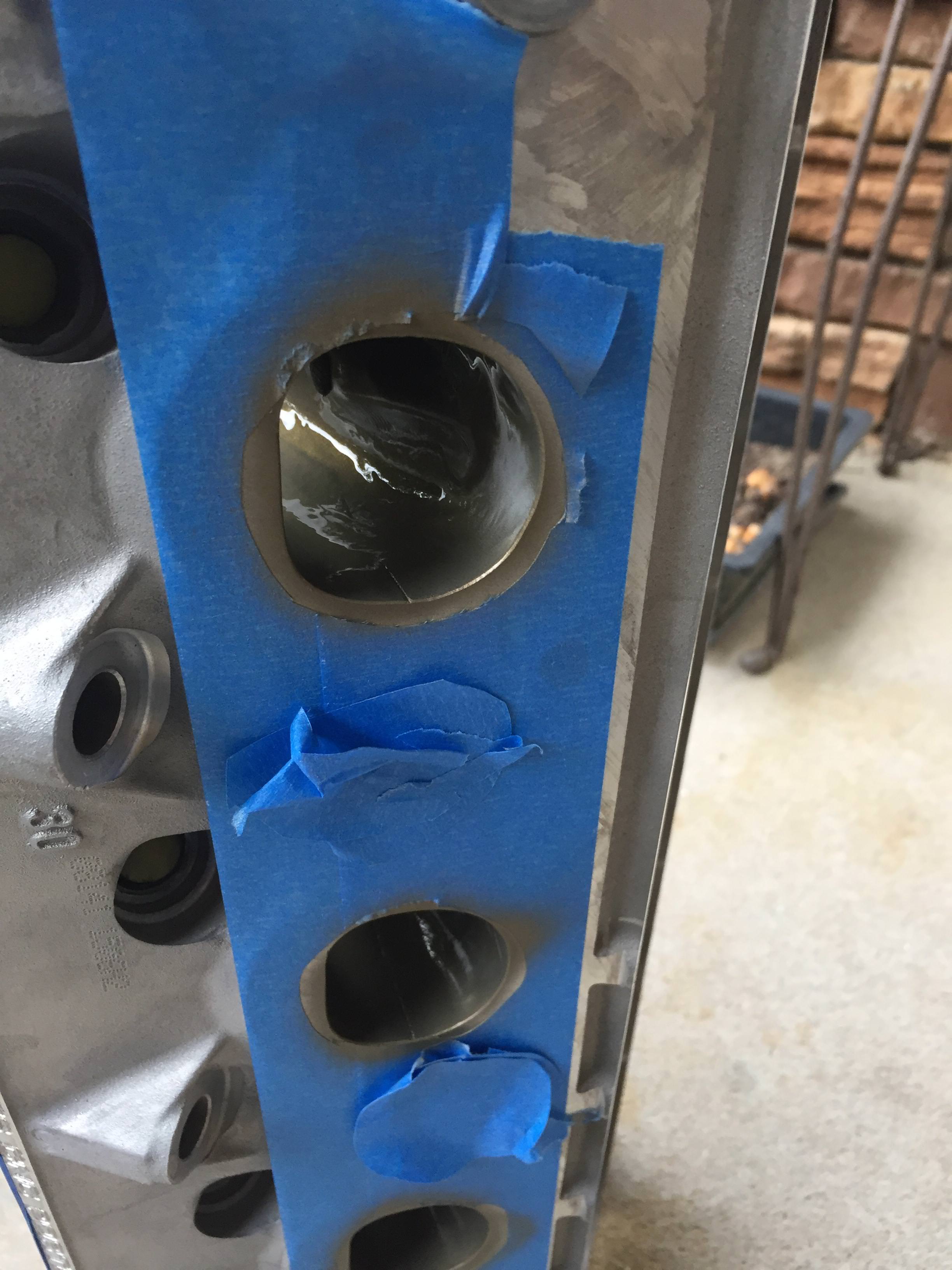

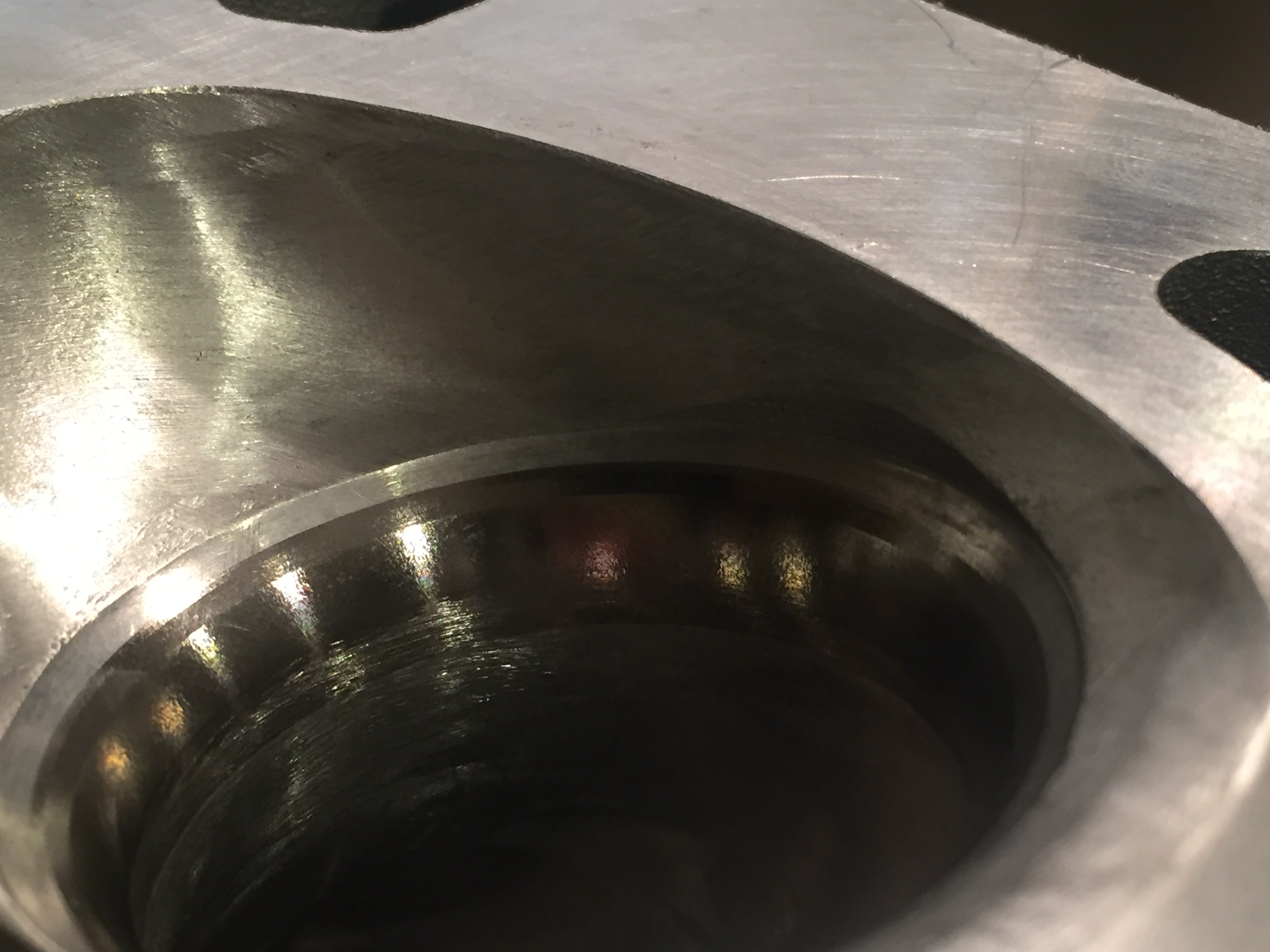

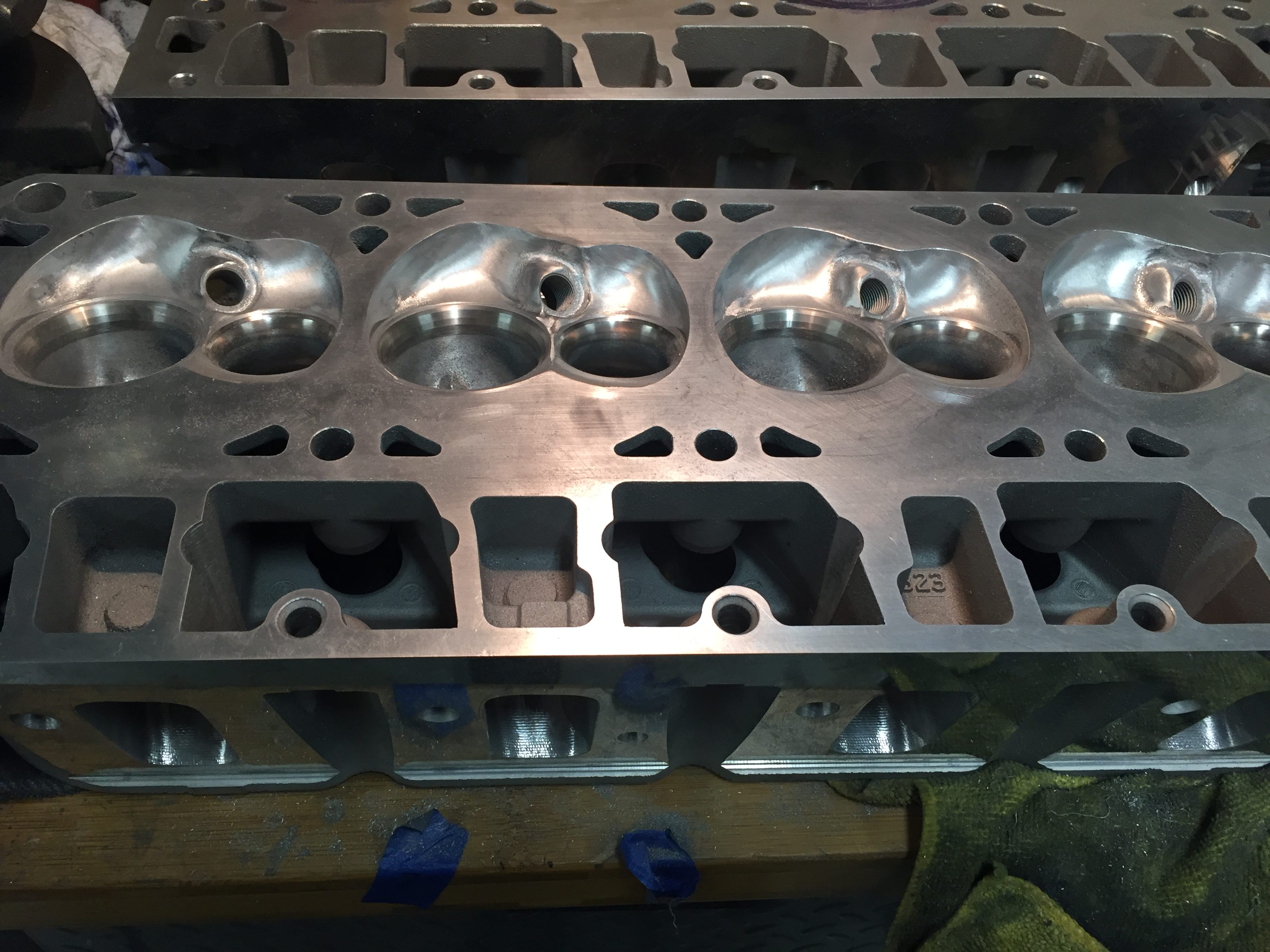

Finally got around to finishing up both cylinder heads
Before breaking hard edges on the combustion chamber. Help prevent detonation causing hot spots and give the coating a softer edge since paint is thinnest at hard edges. Those little pieces of casting flash act like mini blow torches
Petro's Project ERL Superdeck 427 w/ Whipple 2.9L-b3s5qiw.jpg
Petro's Project ERL Superdeck 427 w/ Whipple 2.9L-pujspao.jpg
Chambers smoothed...I still have to break hard edges on the casting holes. If you look at the head at the top you can see the edges smoothed and bolt holes chamfered.

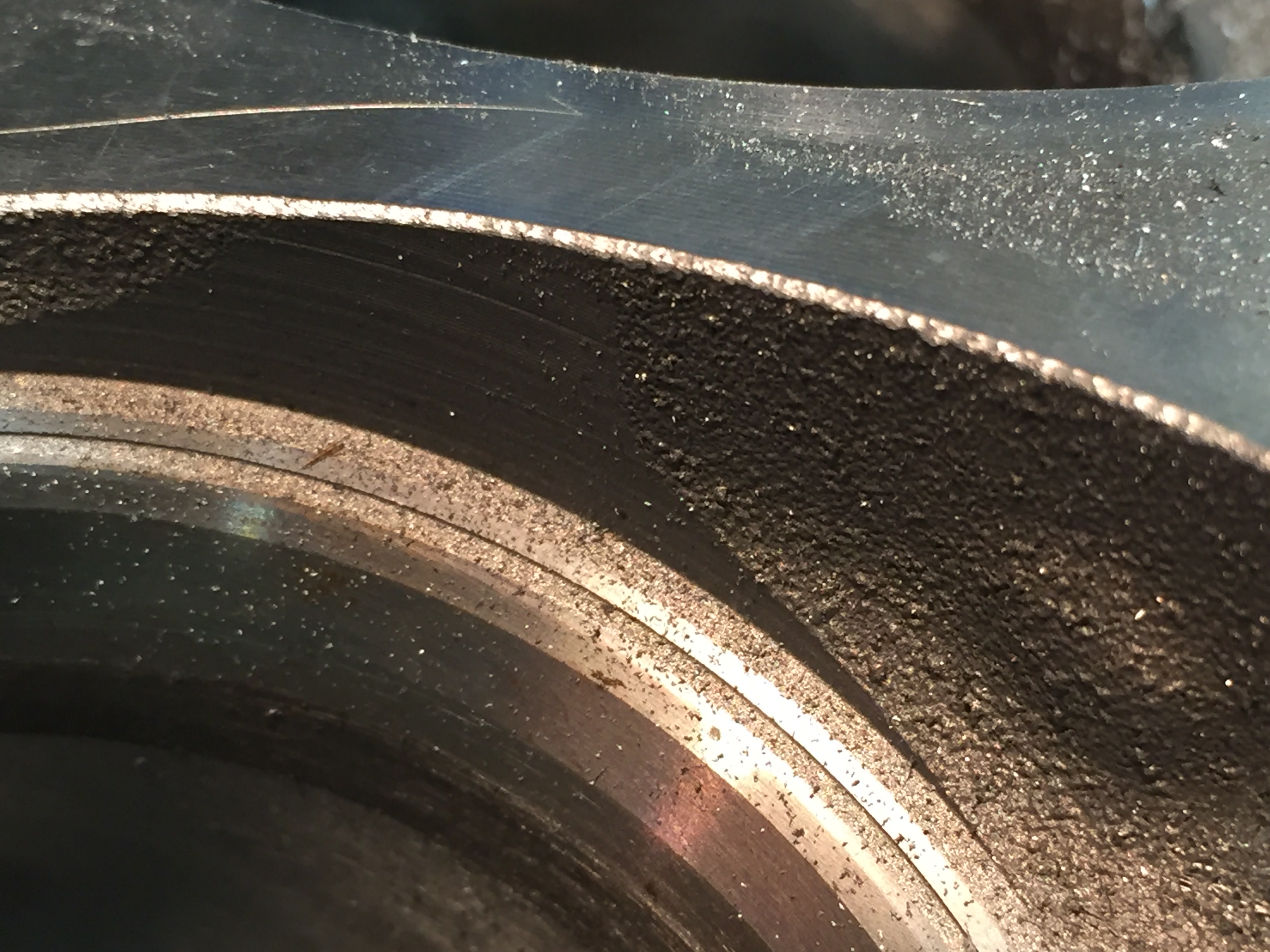

Petro's Project ERL Superdeck 427 w/ Whipple 2.9L-tycujxu.jpg

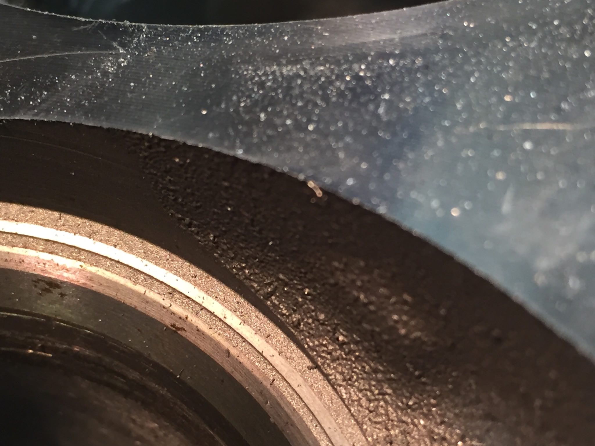

Just enough sanding to remove the casting flash and give the thermal barrier coating a more consistent surface for more even coverage.
Petro's Project ERL Superdeck 427 w/ Whipple 2.9L-8gaoqcv.jpg

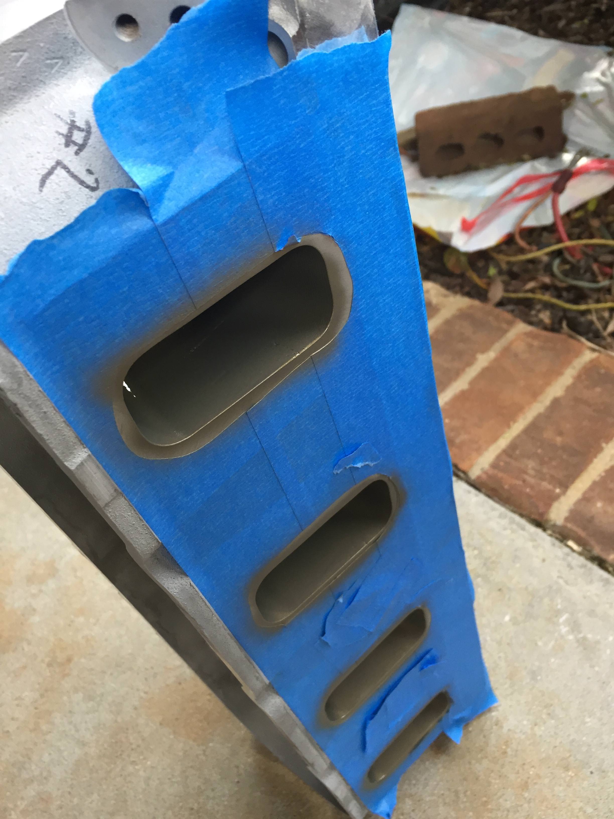

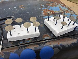

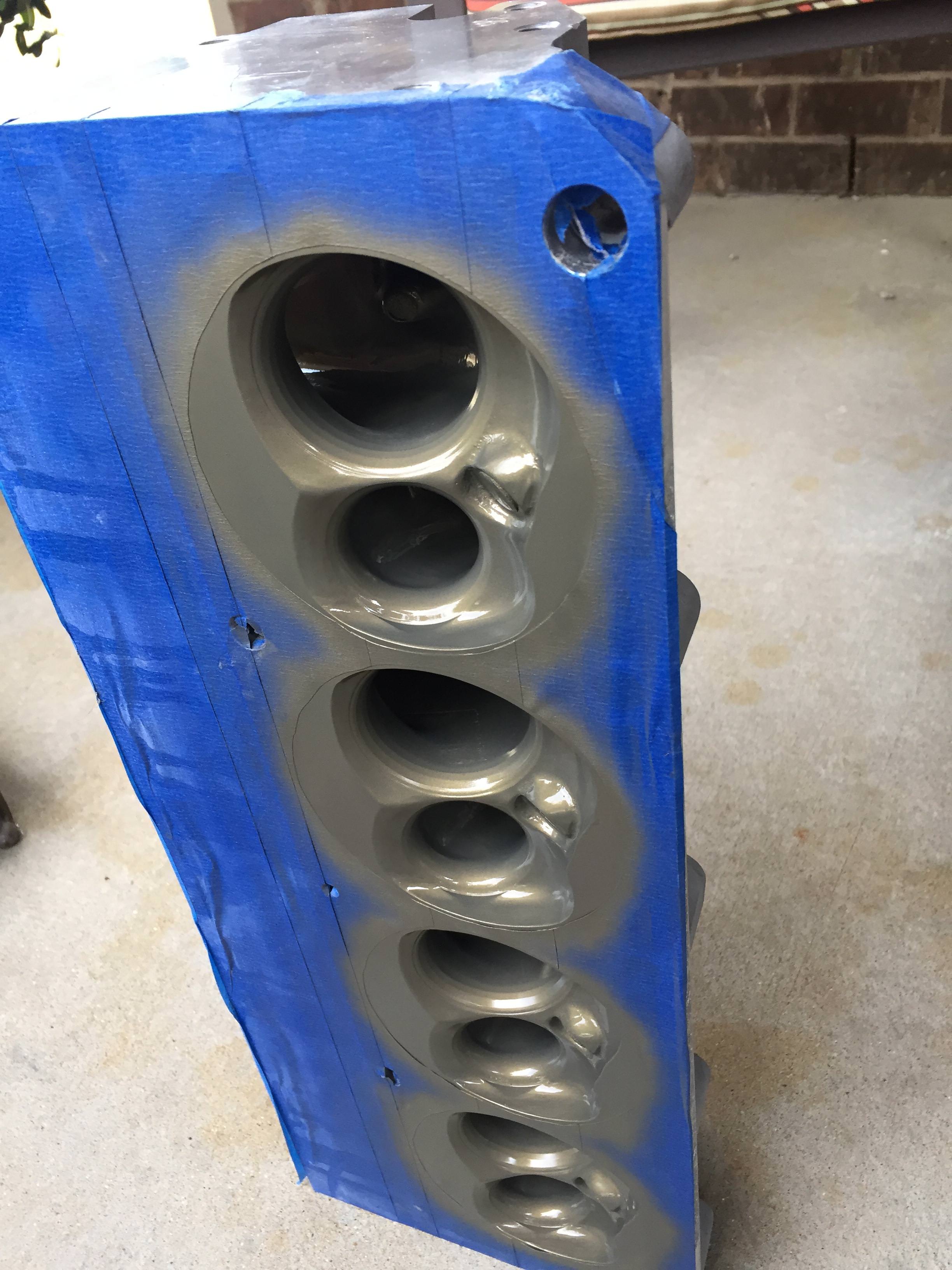

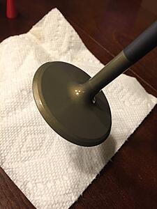

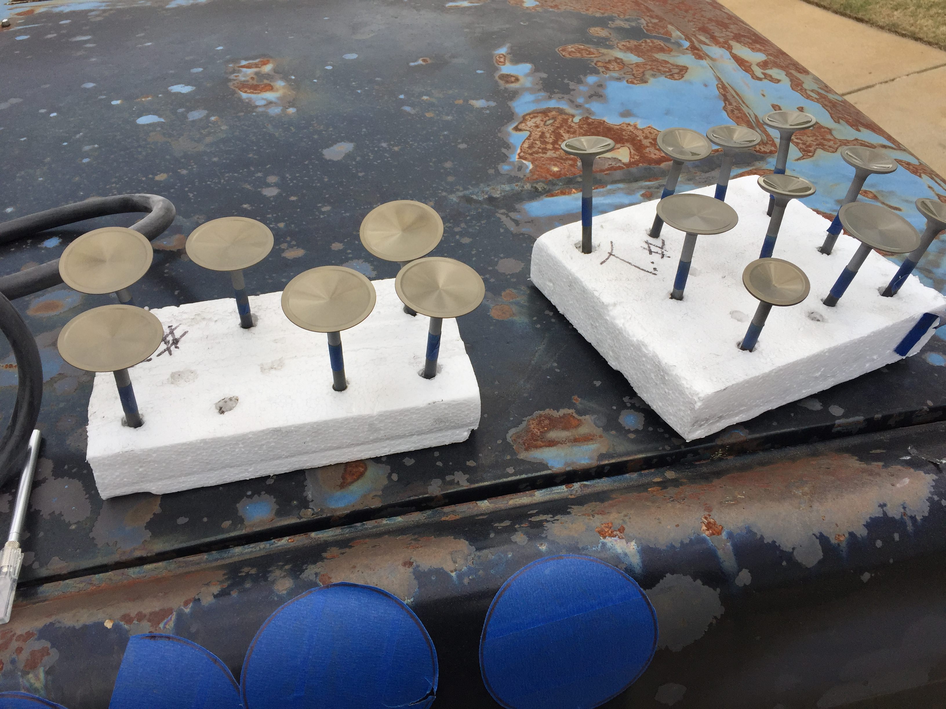

Coating Stuff
Petro's Project ERL Superdeck 427 w/ Whipple 2.9L-afwxgye.jpg
Petro's Project ERL Superdeck 427 w/ Whipple 2.9L-15vwzit.jpg
Petro's Project ERL Superdeck 427 w/ Whipple 2.9L-sbrjm19.jpg
Petro's Project ERL Superdeck 427 w/ Whipple 2.9L-o07lyjy.jpg
Petro's Project ERL Superdeck 427 w/ Whipple 2.9L-8pyvslc.jpg

What did you coat the chamber with?
Old Apr 9, 2018 | 09:32 AM
  #559
Petraszewsky's Avatar
iTrader: (28)
Joined: Oct 2008
Posts: 1,137
Likes: 22
From: USA
The Cerakote piston coat thermal barrier stuff
