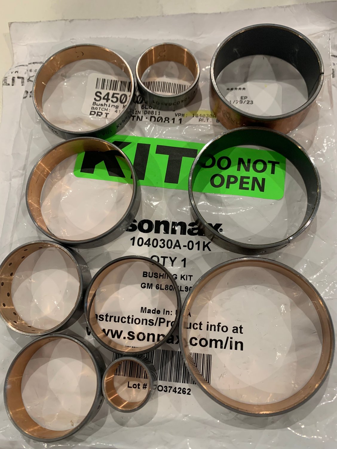

Bronze bushing kit….just a quick clean and burnish with newspaper:

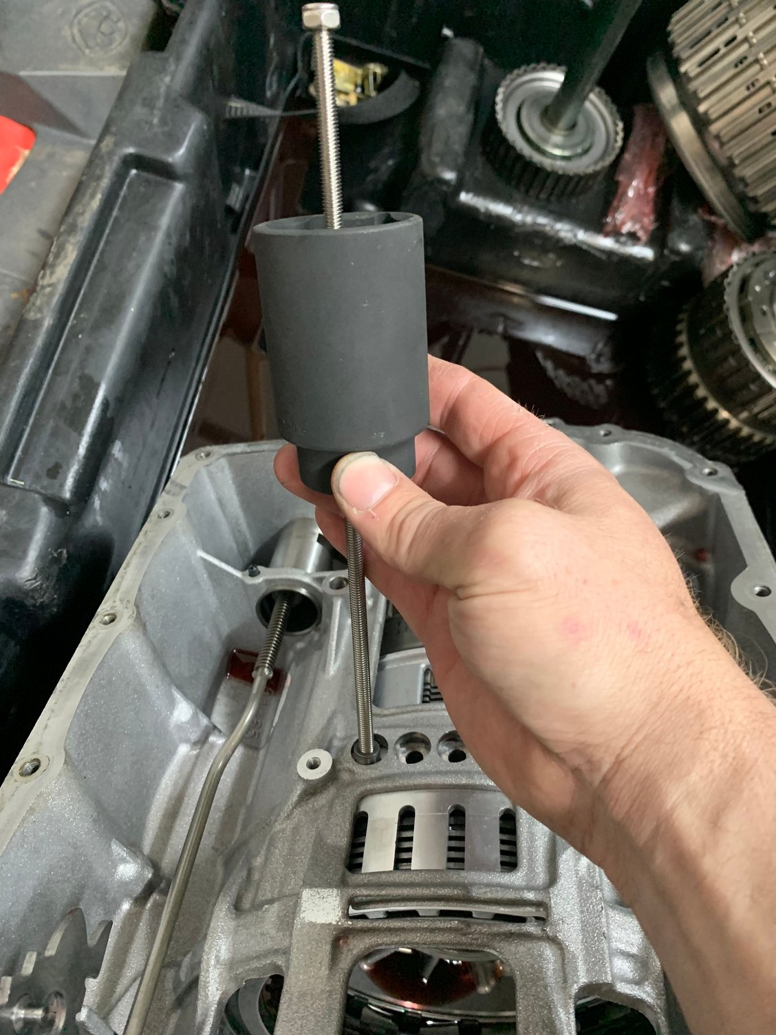

Super duper custom slide hammer….wait to see my redneck shop/arbor press

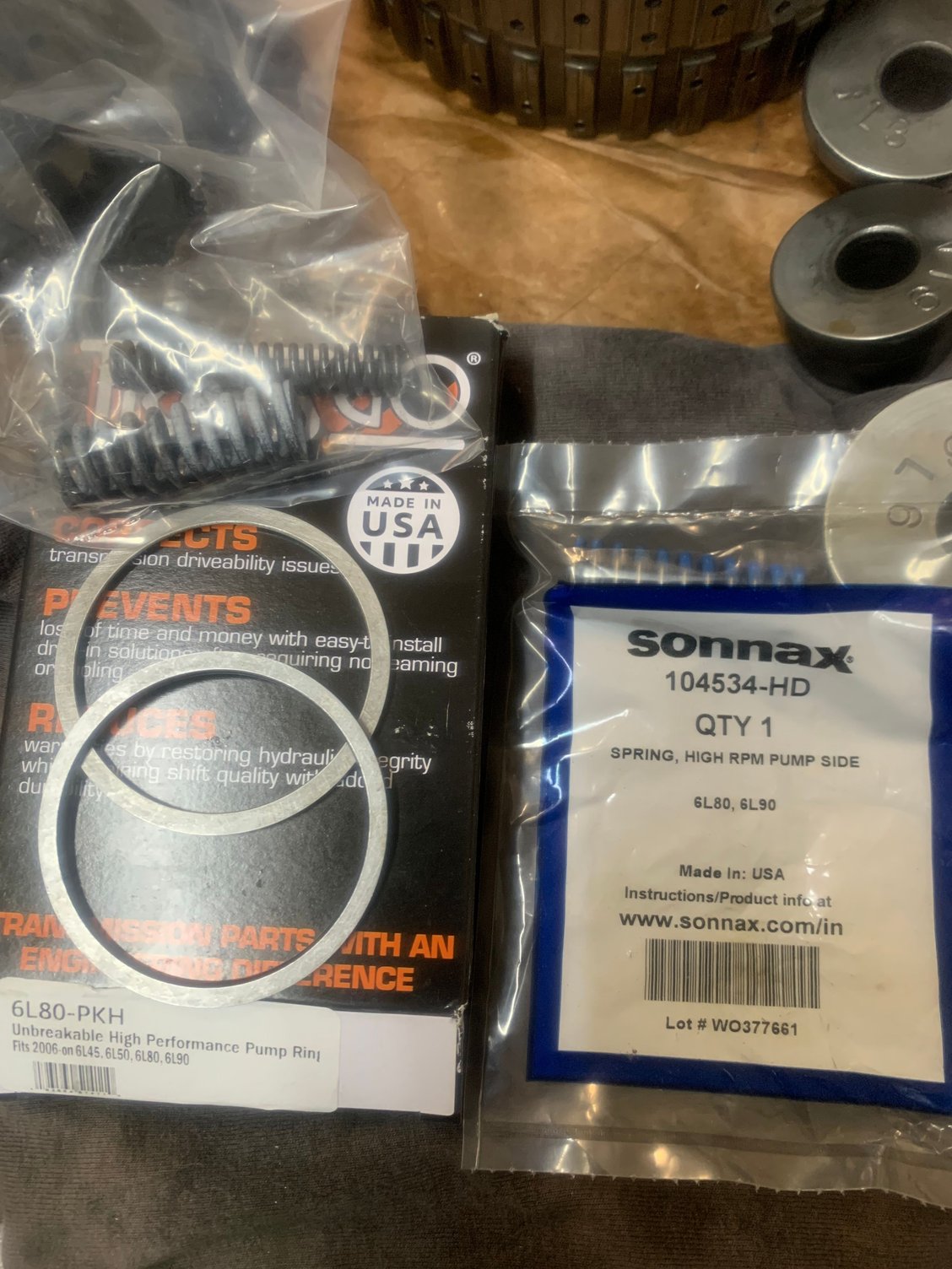

Last bit of little upgrades came in….steel pump rings and stiffer pump slide spring. Only have a few more bushings to beat out so I can install the new bronze ones. El cheapo Amazon clutch compressor actually worked and I got the 1-2-3-4 billet piston installed. I also got most of the way done with installing the mishimoto trans cooler. I didn’t realize the kit still uses the factory cooler inline with the new cooler, so that’s pretty cool. I have to get some more Kooler Kleen flush and I can finish bolting that all together.
