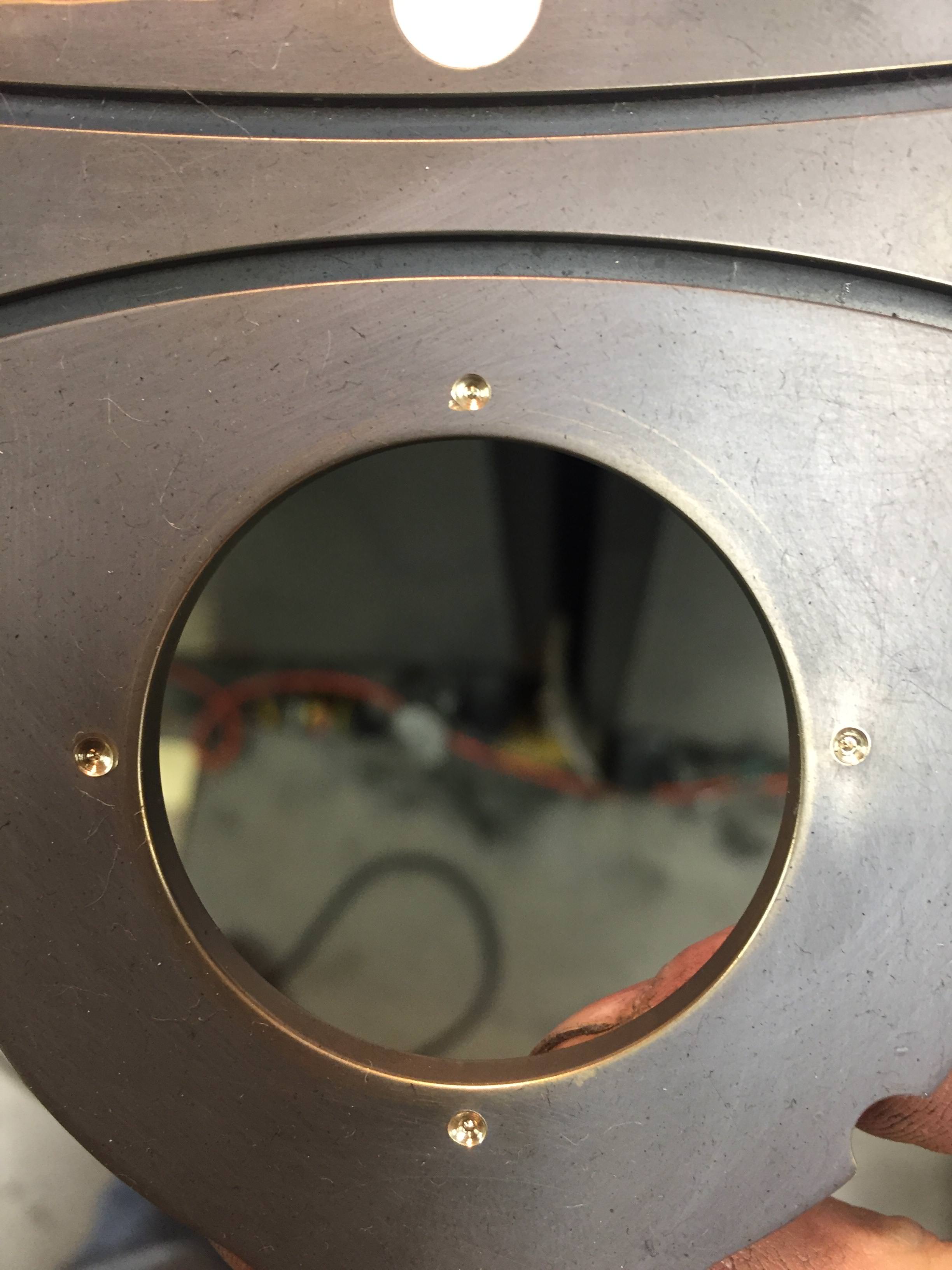

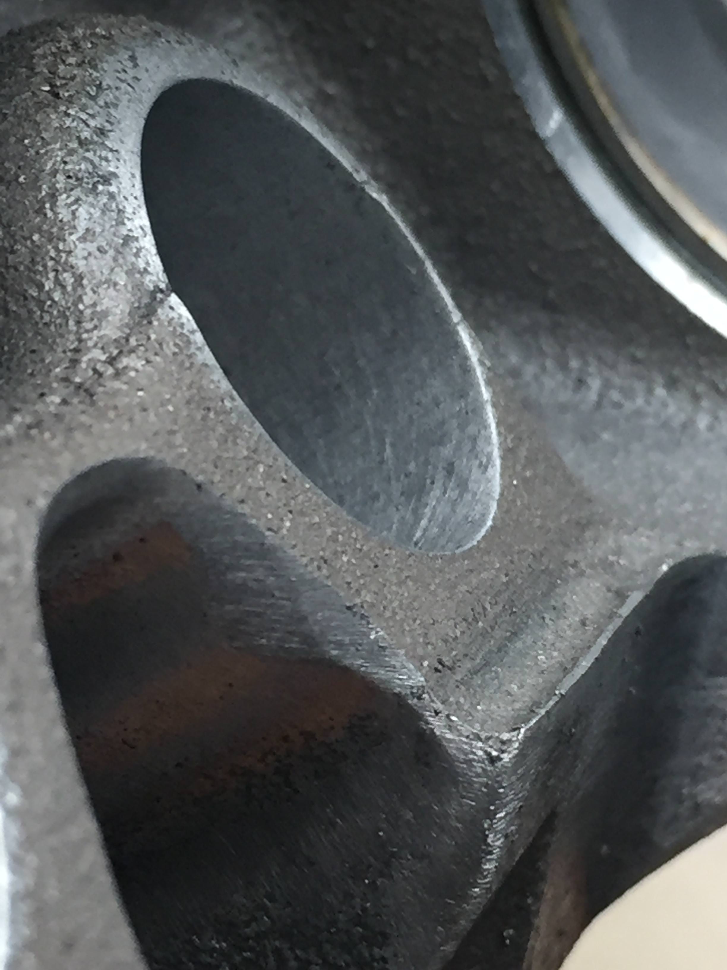

Lifter bores before
Petro's Project ERL Superdeck 427 w/ Whipple 2.9L-vwtxpin.jpg
After
Petro's Project ERL Superdeck 427 w/ Whipple 2.9L-lyakepy.jpg

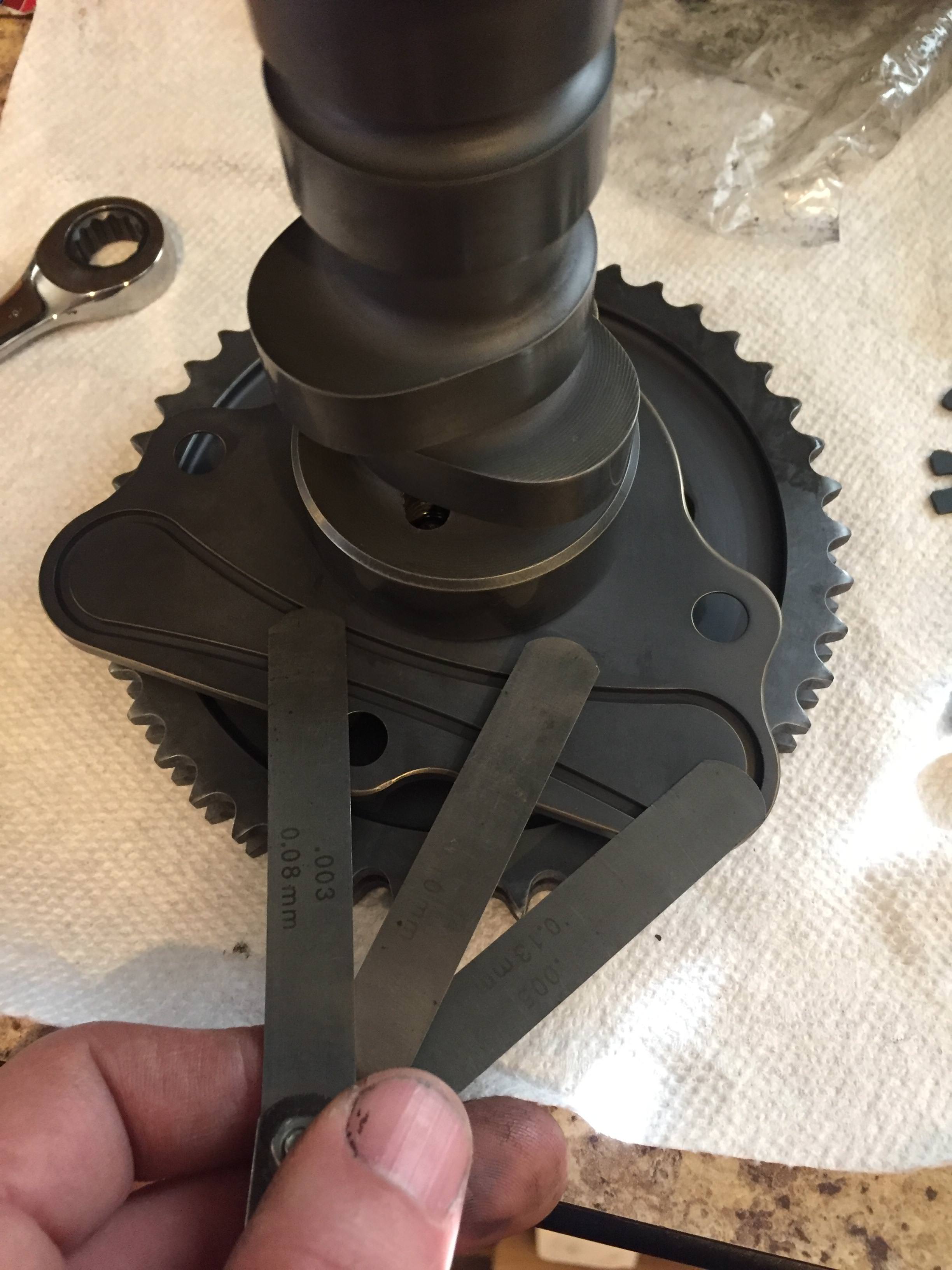

Camshaft end play is roughly .003-.004”....within the spec of minimum and maximum of .001-.012”

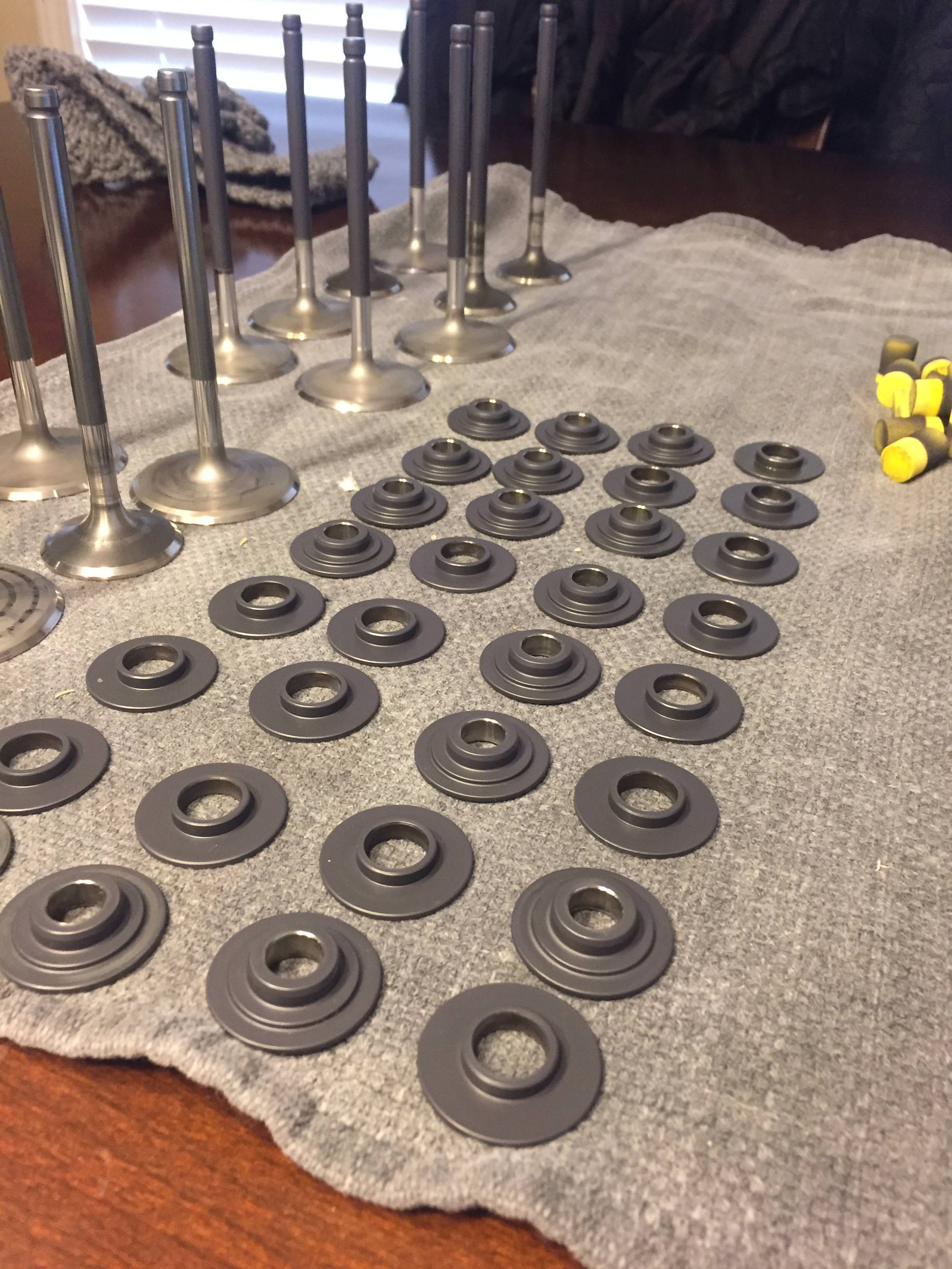

Finally got around to coating the rest of the valvestems with Mircoslick. I had plenty of Mircoslick leftover so I blasted and coated the tops of the seats and bottoms of the titanium retainers.
Petro's Project ERL Superdeck 427 w/ Whipple 2.9L-xwqx8b7.jpg
Scroll down to page 16 and you can see the testing Cerakote did with their thermal barrier coatings. The C-186 Piston Coat I’m using performed well reducing temps by 81* with internal temps of 1706*. The V-171 Turbine Coat did even better in the testing. The turbine coat reduced temps by 185*!
http://www.nicindustries.com/images/...0Manual(2).pdf
