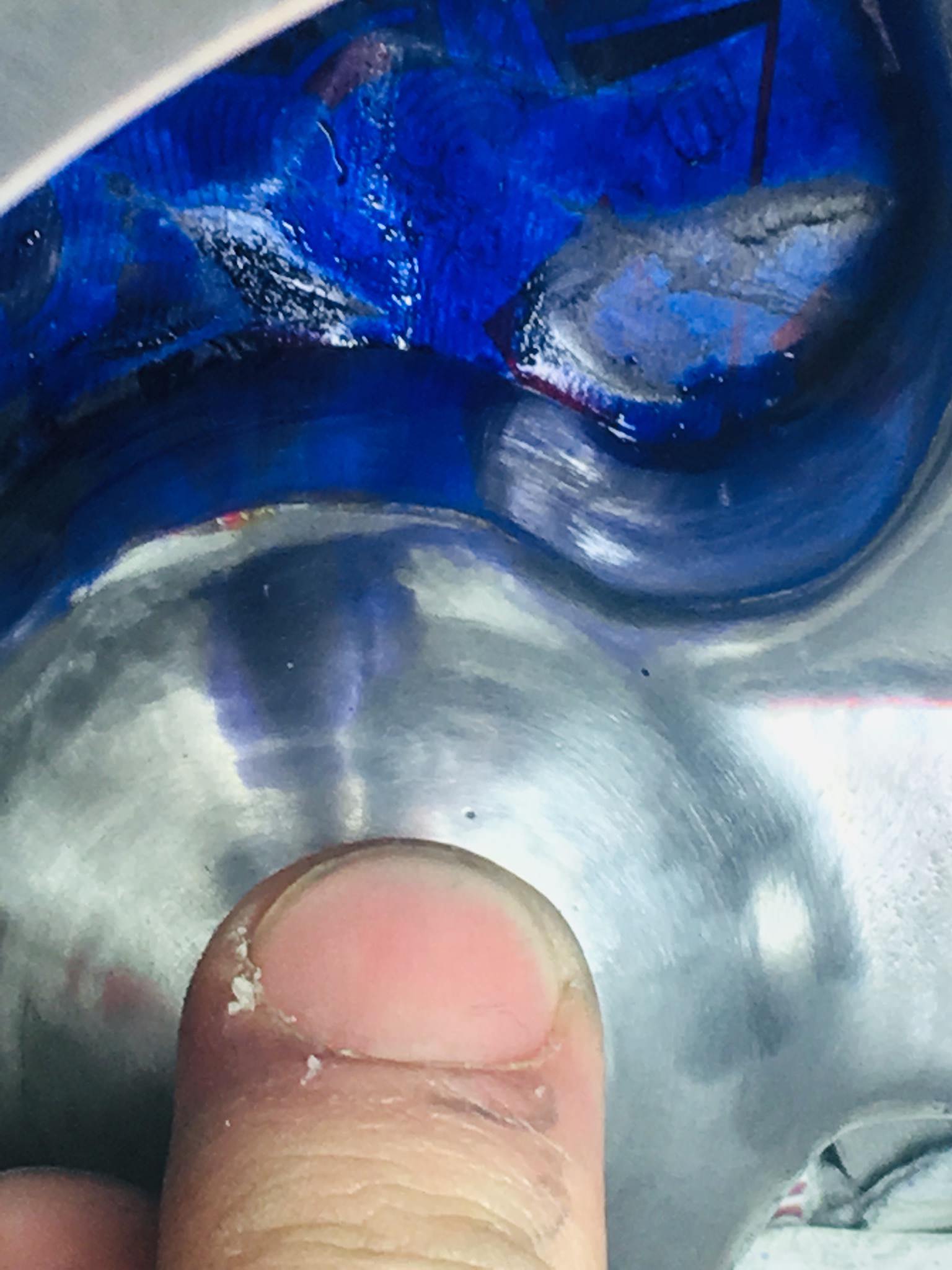

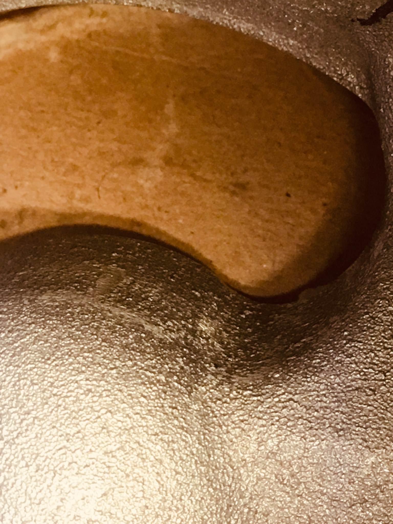

Why not blend the heads opening to match the blower tub?
The head opening is larger than the blower tub opening. Plus this way allows me the ability to make whatever transition I want.

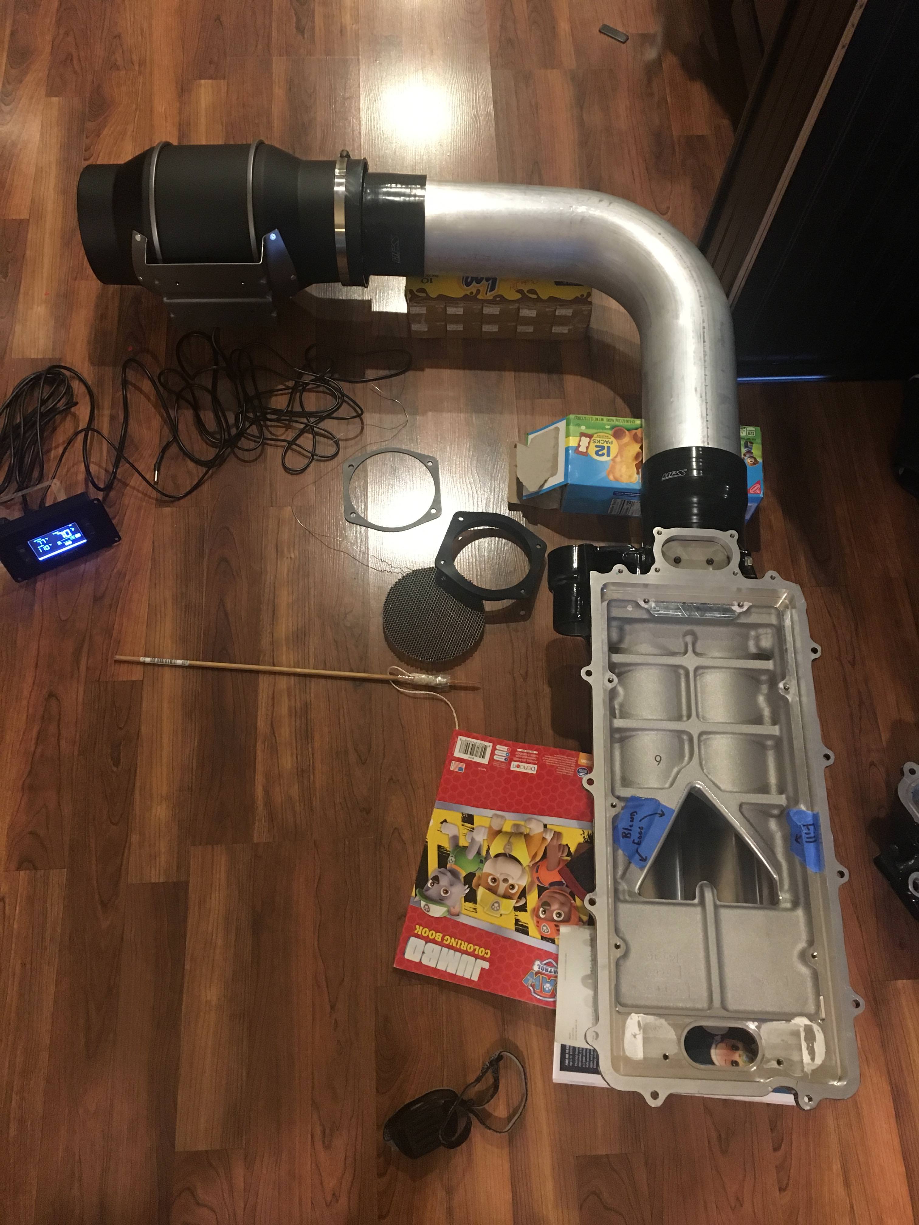

Originally Posted by Bgbldodge
What is that?
It’s the supercharger inlet in front of the rotors

My redneck flow bench has shown me a few things....I’m able to increase the velocity pressure and total pressure using a convergent pressure recovery plate. The flow speeds go from 220mph to 270-300 at 2000cfm though the 4.5” intake tube down to the 4” TB. The increase in mass flow from the system is considerable. I have some more testing to do with vortex generators and turbulator strips/tape. I have some ideas for using them within the lower manifold, intake tube, S/C Inlet, etc. It’s basically a tunnel ram intake I’ve developed with the use of the spacers and epoxy for the floor. My intent is to gain and maintain airspeed post intercooler. (The manufacturer design makes for extra turbulence/heat to be added along with massively decreased airspeed.) I hope for better cylinder fill and fuel shear with the increased speed. I’ve also been tinkering around with using the AN hose inner support springs as “turbulators” within the intercooler hoses. The hoses are insulated from hot engine bay heat with Heatshield Thermal Sleeving so they don’t gain radiate heat. The “turbulators” increase the heat transfer within the system. I also redesigned the inlet/outlets for the reservoir so as not to introduce any air bubbles into the system. (Air = less thermal efficiency) . I’m also on another boron nitride kick....powder .5micron along with brushable and aerosol. This stuff ROCKS! Thermal conductivity, Low friction, low rates of wear, non wettable...All sorts of good stuff coming....

5” intake tube is more optimal then 4.5

Summarized: you’re making a better intake manifold. Yes, a tub sucks dick as an intake manifold, boosted or not.
