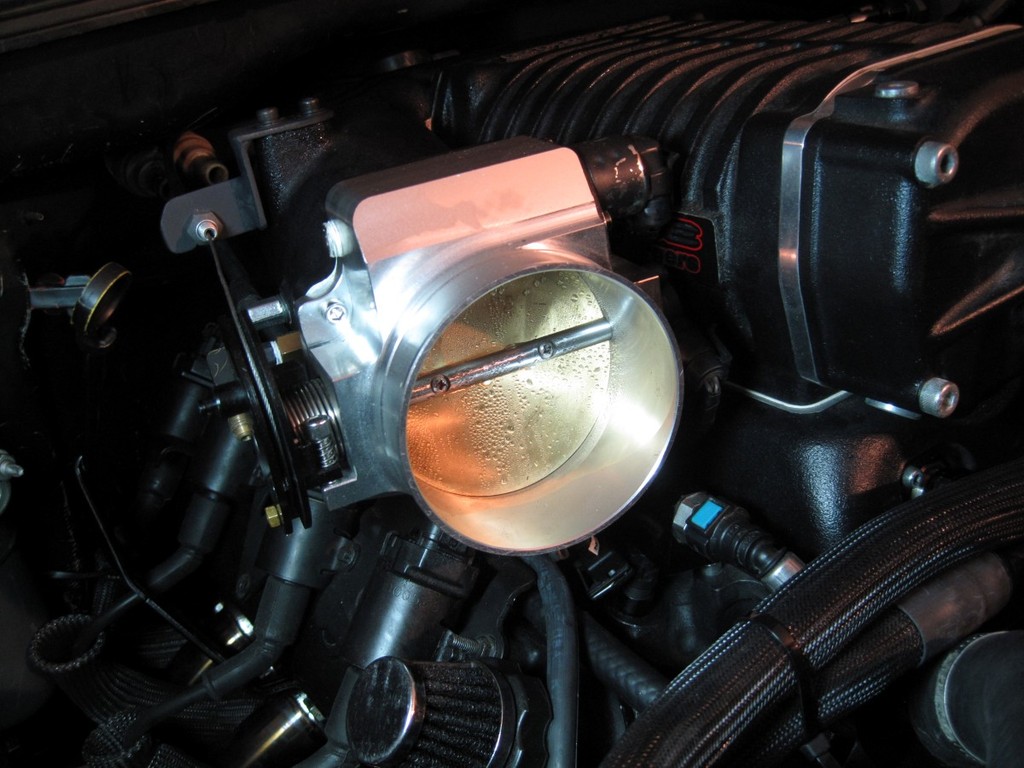

Well got it working and drove around today. First issue was the meth was being wicked (substantially) through the pump enough that it was forming water on the outside of the blower it was so cold

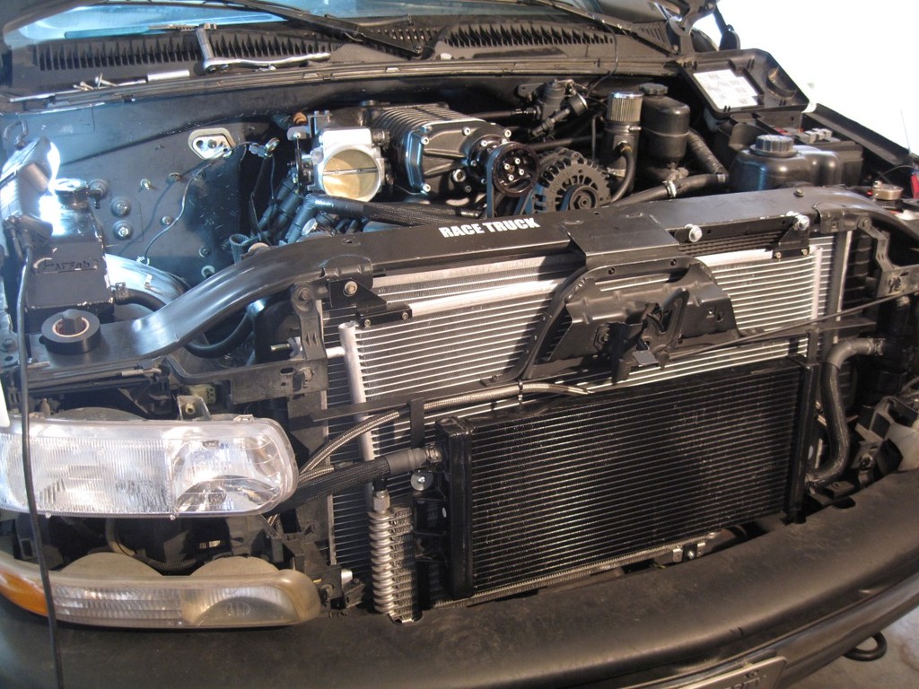

All the coolers:

Basically finished engine bay except I need to make an elbow for the throttle body and filter (mounting directly on the blower wont work, not enough room) and hook up the rest of the AC lines. I also want to get rid of that stupid whipple coolant res for one thats fits in the second battery tray.

Heres what I mean about condensation being on the throttle body and intake tube from the meth being wicked in. Idle was wanting to pull 50% of fuel out. It was basically idleing on meth Keep in mind it was probably 90 degrees in my garage.
