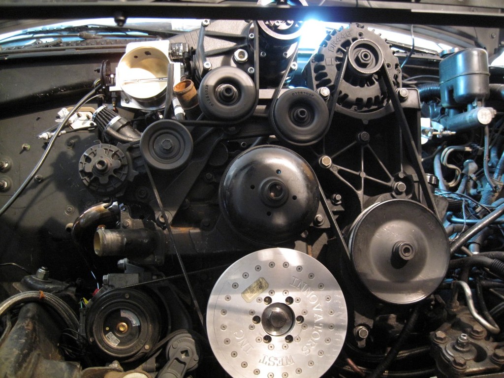

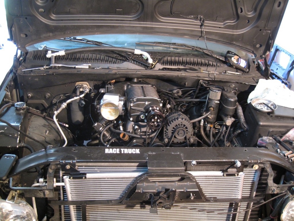

So I got a lot done this weekend. The blower is much easier to install if you do the lower manifold completely first. Bolting on the upper and compressor is very easy except for one bolt that is directly under the elbow and has very little room to get a wrench in there. Overall pretty easy though. I havent finished my spacer/spray bar yet so I am going to go forth without out it until I can get a groove machined and it sent off to spray bars put in.
Got the blower on, throttle cable shortened and mount made, got all 4 corners of the steam vents hooked together, injectors plugged up, fuel lines finished, IW crank pulley installed and all pullies and belt installed, and figured out how to keep my big coolers.

I have all the 8 rib pullies but am going to wait until I am sure its not going to blow up to put on the small 8 rib blower pulley. Until then I am just using the 6 rib belt with the 8 rib crank pulley.
You can kind of see in the picture where I put the oil cooler in between the condensor and radiator. I basically moved the condensor forward and spaced the oil cooler off the radiator support and turned it around so it fits inside the rad.
