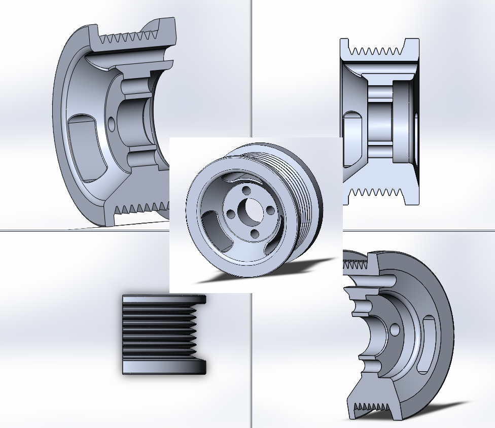

Well on todays episode of what did he draw I made a 8rib whipple pulley with some minor tweaks. I doubled the thickness of the mounting flange and also made it 1/8" deeper to sit more over the top of the hub so there isnt as much bending stress on it. Cutouts also reduced in size to make it a little stronger. The diameter as shown is 2.7".

Be careful over spinning a twins crew.

Care to elaborate?
The 2.7 should put it at max speed near the shift since the crank pulley is smaller than I thought.

What size crank pulley and shift RPM. Last I knew the key speed for the whipple was 18k.
