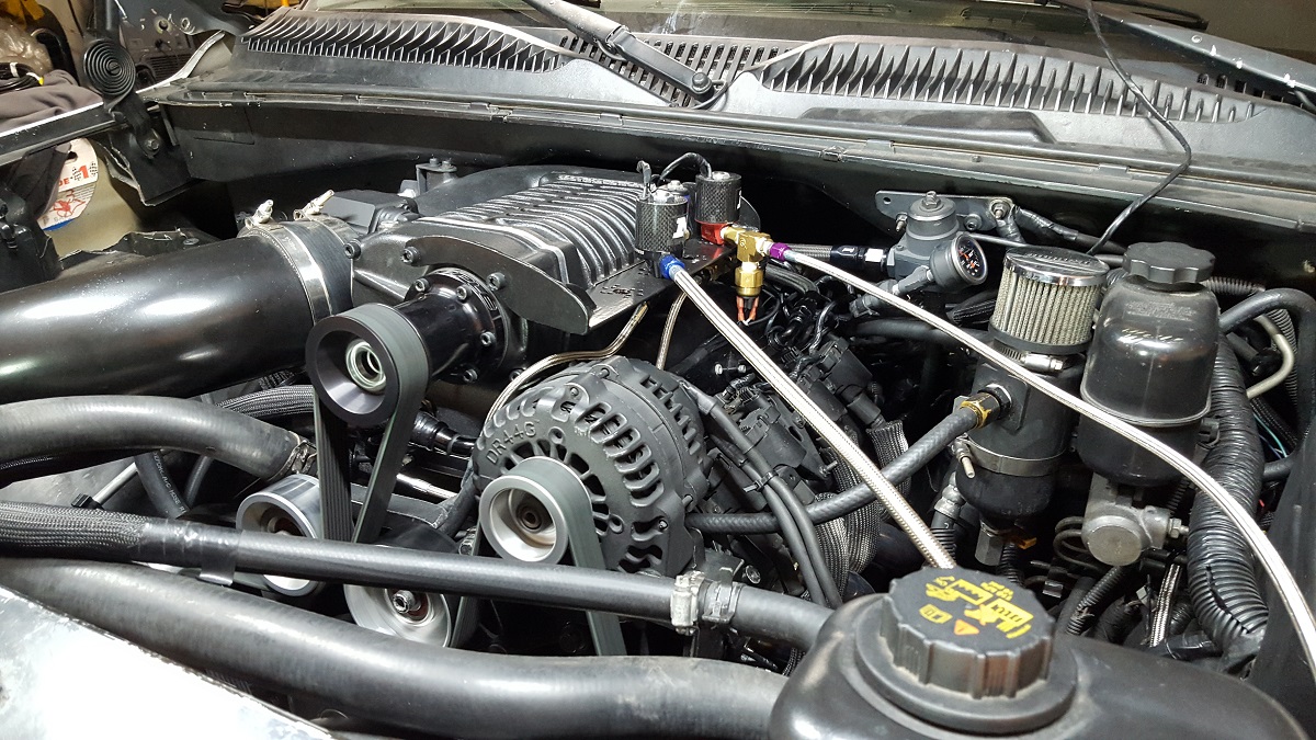

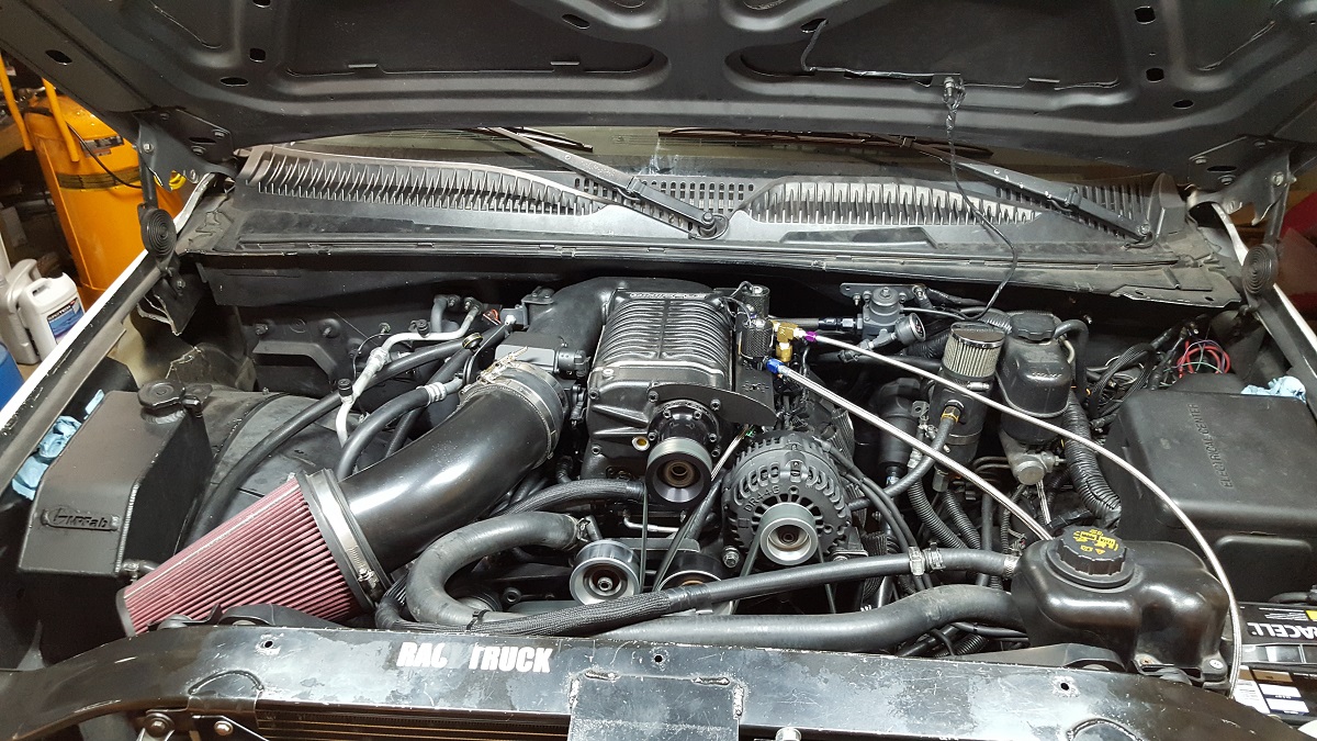

Got the truck back together this weekend and put a couple hours worth of driving on it. This thing gets awful gas mileage
I havent actually measured it (purposefully), but you can tell it drinks gas. Everything went fine after I fixed a leaking valve cover and got all the air out of the intercooler. I also swapped in a 160 degree tstat from a stock one I was using earlier. I was able to use the same belt with the spacer, just raised the moveable idler up some to make some slack.
The tune overall wanted about 5-10% more fuel everywhere especially part throttle, which I found interesting. The AC condensor also really impacts radiator performance, more than I expected actually. Never had a heat problem, but with it just sitting temps would climb to the 190 range with the fans on low, and drop to the 170s 180s when driving.
I also discovered the burst disk on one of my bottles was leaking so I lost most of a bottle of nitrous without ever using any. Fixed now but thats irritating. I got my blanket kit in also.
I all I have left is wiring stuff for the nitrous. I am going to put the intercooler pump on a switch so I can turn it off if I want to instead of it running whenever key is turned to run. I am going to add switches for the purge, heater blanket, and master arm. They will all fit on the left by the vent.
I also plan to finish the new coolant tank soon to get that out of the way to over by the big hole in the fender in the secondary battery tray.
Changing jets on the spacer plate is going to be a pain in the *** because its so hard to reach and theres a lot going on there. Not a huge deal, just wanted to complain about it.
