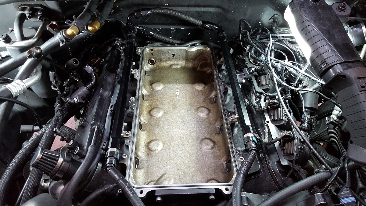

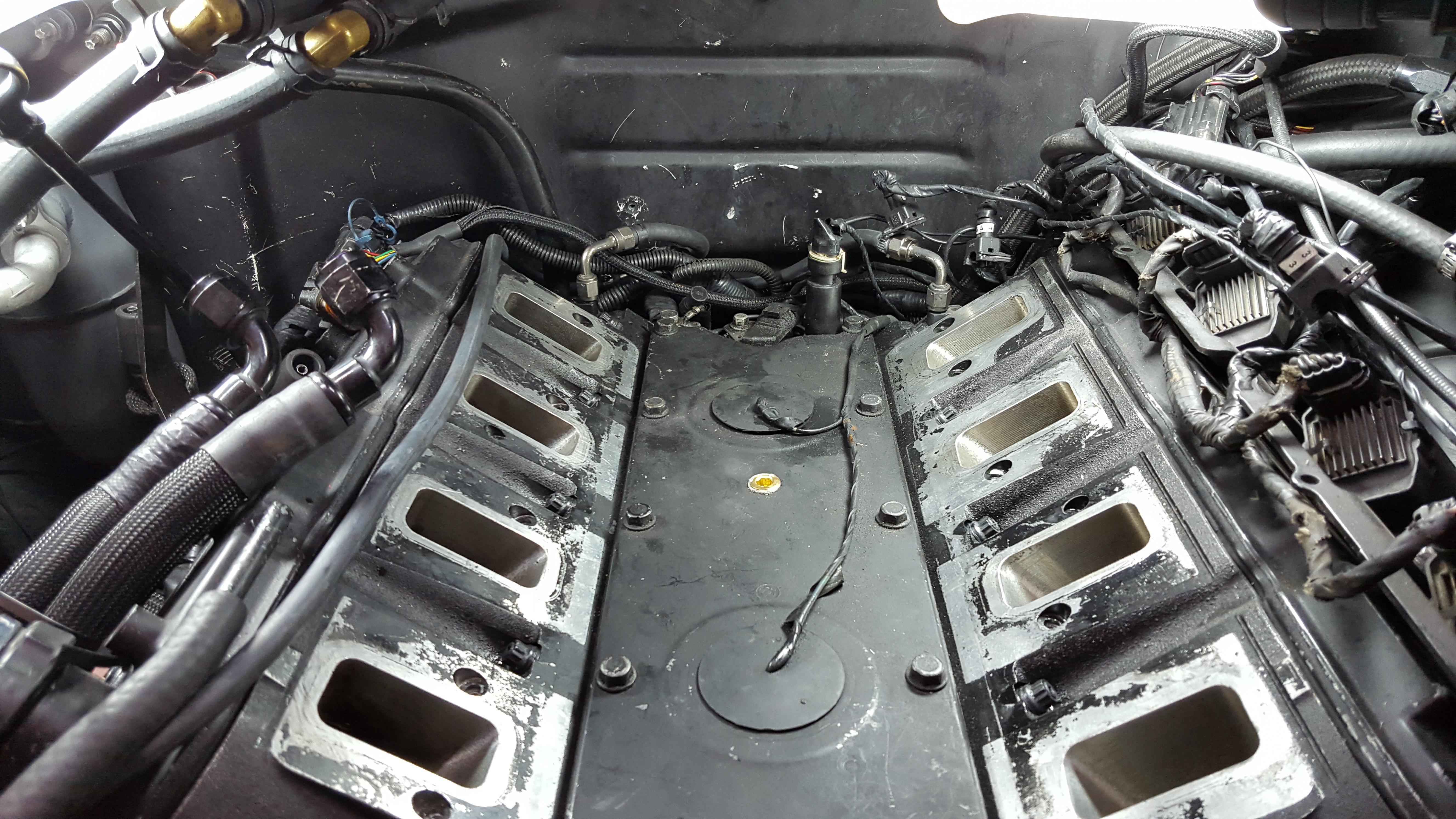

Good thing I decided to use the 1/2" spacer as it was a pain to install. Theres not a whole lot of room between the cowl and lower manifold anyway, unless you want to put the whole blower (upper and lower) in at once, but that would be a huge pain to reach all the intake bolts. The 1" spacer would be impossible to install without cutting the cowl. Ended up using duct tape to hold the spacer to the upper when I flipped it over to put in there.

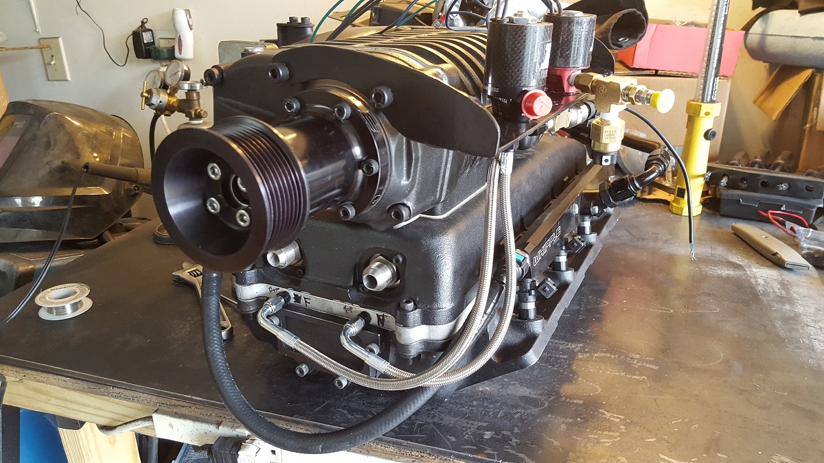

I am having to monkey around with the solenoid placement so I can get all the lines by the alternator smoothly without kinks, it sits closer than I remember. I think I am going to have to use a 45 or 90 bend on the nitrous outlet which I was trying to avoid but oh well.

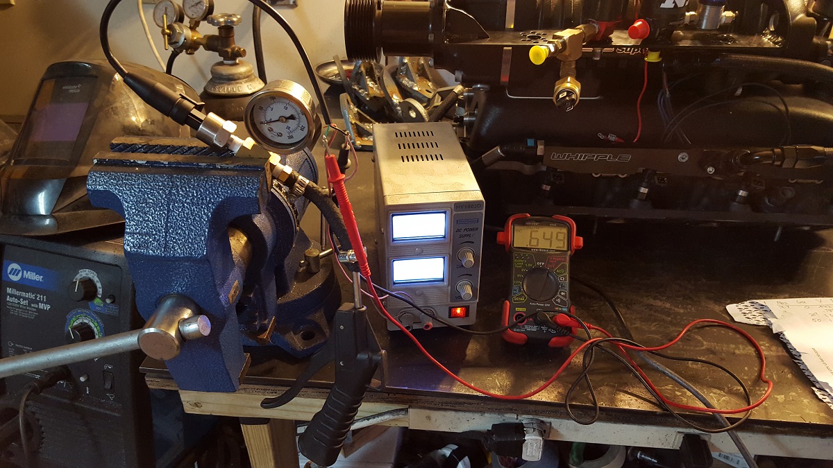

The fuel solenoid looks busy as well because I have a pressure switch on the inlet side, and on the output side I am going to use the pressure transducer which I got to monitor the meth pump output pressure. The one pic is of my calibration setup with my adjustable DC power supply
I also redid the fuel crossover at the back to be a little less obnoxious. I still have the whipple one on the front, so the one in the back is overkill most likely. I drilled a hole in the bracket for the purge line to go through as well.
I want to use a big 12pin connector for all the crap instead of wiring it individually. I think that will look a lot better and allow me to disconnect the whole thing as a single unit instead of 11wires individually.
The new jets I need should be there this week, so really all I have left is wiring. This weekend is packed though, so maybe next week it will make noise.
