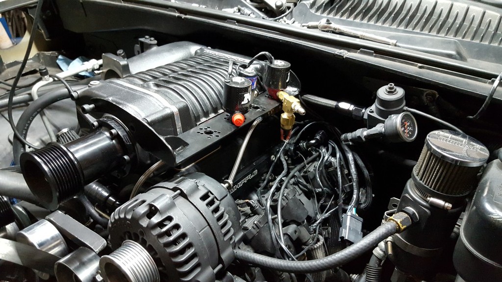

Well I got the solenoids where I want them and the blower bolted back down. Just need to reconnect some engine wiring and wire up the window switch and buttons and should be ready to rock!

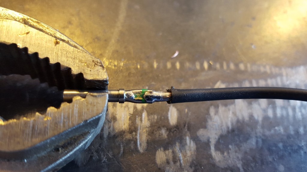

Because there are so many wires I got one of the 12 pin deutsch connectors and decided to use that to make removing it to get out of the way a lot easier. Its a bit of a pain to assemble, but I think will pay off in the end. I didnt have the crimp tool so I crushed and soldered them all to make sure they fit. Connector was $18 on ebay.
I cant weld that great but I can solder like a ****
Lot of wires!

I used a deutsch connector for my ls swap too, but I used the open barrel pins (an MSD connector) and bought the MSD crimp jaws and put them on a Harbor freight set of ratcheting crimpers (they fit right in coincidentally). The closed barrel pins like you have are way better, but the crimpers for them are spendy. So I went with the open ones.

I just use a 40w pen from radio shack thats about 15 years old now haha. I have a 100w gun, but dont like it near as much. Solder is some 0.022", not sure on the lead/tin split.
I thought about buying the MSD connector, but the deutsch one was a little cheaper. You can also have them make the whole thing for you, but for what I wanted it wouldve been roughly $150 for 2ft of wire on both ends. This is the one I used http://www.ebay.com/itm/231798775040?_trksid=p2057872.m2749.l2649&ssPageName=STRK%3AMEBIDX%3AIT
What do the good crimpers do? Just crush the pin around the wire? I did that anyway with some pliers and soldered them and tried to pull them out with no success so I dont think I will have any issues. I might take you up on that if I make one of the big 40+ pin connectors one day.

The MSD connector I got is just like what you did, but the pins are stamped instead of being solid like yours. It was about $30 and the solid pins are higher quality. (https://www.msdperformance.com/produ...ors/parts/8186)
From what I understand, the good crimpers essentially crimp the wire to close to ideal force and evenly. What you want out of a good crimp is for all of the individual wire strands and pin to be compresses enough to deform everything into essentially a solid chunk. You want no air gap between the individual wire strands and between the wire and pin.
The difference between using any old crimper and the deutsch one is that the deutsch one tightens the pin onto the wire all around and gets you a good crimp. The regular crimper squeezes one point and the wire strands can separate and move to the sides and not be crimped.
