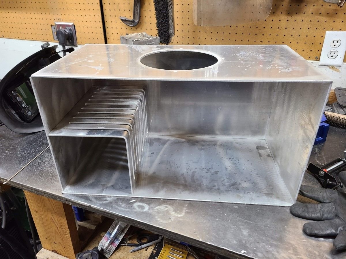

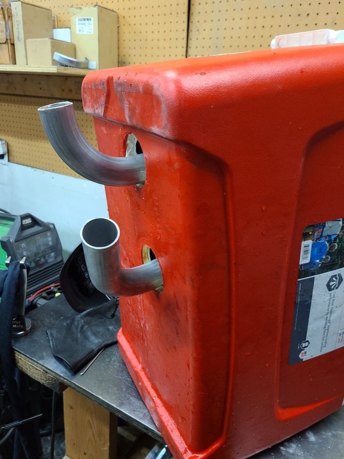

Well went to the track last weekend and ran 3 times. Trans works. Engine is being weird, any time I put it in drive at idle and idles horrible and doesnt want to stay going, havent had time to look at it yet. Main thing was turns out the igloo cooler doesnt seal very well so when I launched I was loosing some water out of the lid. By some I mean like a gallon even with it strapped closed After the 3rd time the track official was like what the hell do you have back there and pretty much said I was done for the night. Probably for the best until I can figure out why it was missing.
The heat exchanger did keep it cooler I think, water didnt get as hot as it did the other day, but man this thing soaks up some heat like crazy. It will easy eat ice like the freaking cookie monster. 10lb bag might drop it 10F or so and melts in minutes. Gonna have to take a **** ton of ice for it to be useful. I didnt expect it to heat up this quickly honestly.
Plan B for the cooler, I am going to make an aluminum box to fit inside of it, so you will still only see the cooler, but inside will be a real tank that wont leak. Drew it up and had a local guy cut it out of 1/8 aluminum. Probably couldve gone much thinner but whatever, thing is crash rated at this point. Volume is right at 9.5 gallons or so. There are some races this weekend I am going to try and make.
