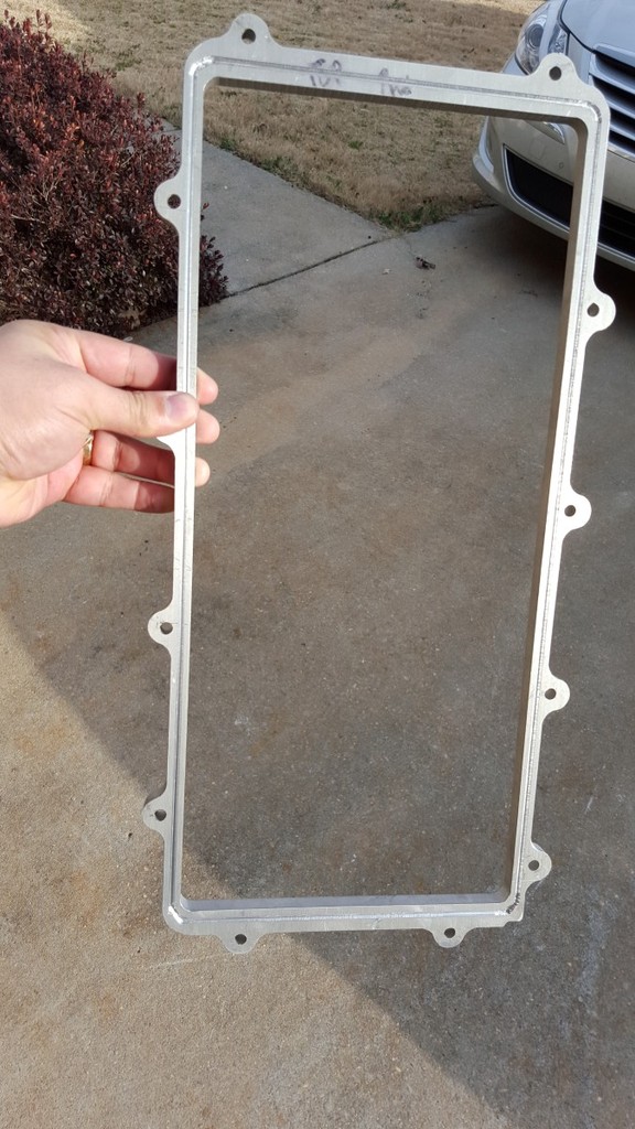

Finally got my spacer machined for an o-ring. If I make another one it will be CNC'd. The taper on this piece is a little disappointing considering what I paid to have it made on a waterjet. The guy that cut the groove could do the straight portions easy, but the corners he had to do by hand. This should work for now but there is certainly room for improvement with the whole thing.

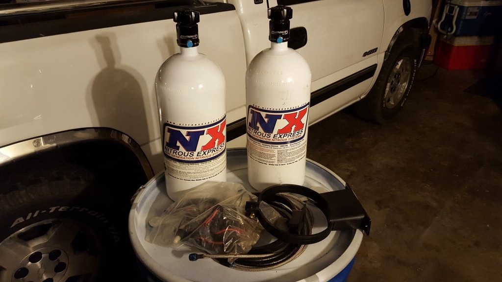

I am picking up some unused nitrous stuff from mitch this afternoon (couple bottles, solenoids, lines, etc.) but will still need a controller and spray bars installed in the spacer. I keep going back and forth on if I want nitrous express or nitrous outlet to do it. The stuff from mitch is nitrous express (not that it matters), and they also answered my emails while outlet didnt.

Not too shabby!
It will be great to see what kind of gains the increased plenum volume alone adds.
I know its not cheap but I'm still over here voting for a smaller pulley to turn this up a notch.

Yea I thought about having the same guy make a stout waterpump pulley also but he hasn't emailed me back...

Look who joined the party!
