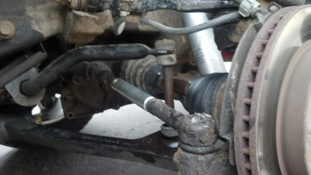

Tie rod sleeves installed

Why dont you clean it? It probably has 5lb of grease on it

Grease = slick. Slick = less friction. Less friction = less drag. Less drag = faster. Therefore, we can deduce that Grease = Faster, and extending that theory, More Grease = More Faster. Duh
