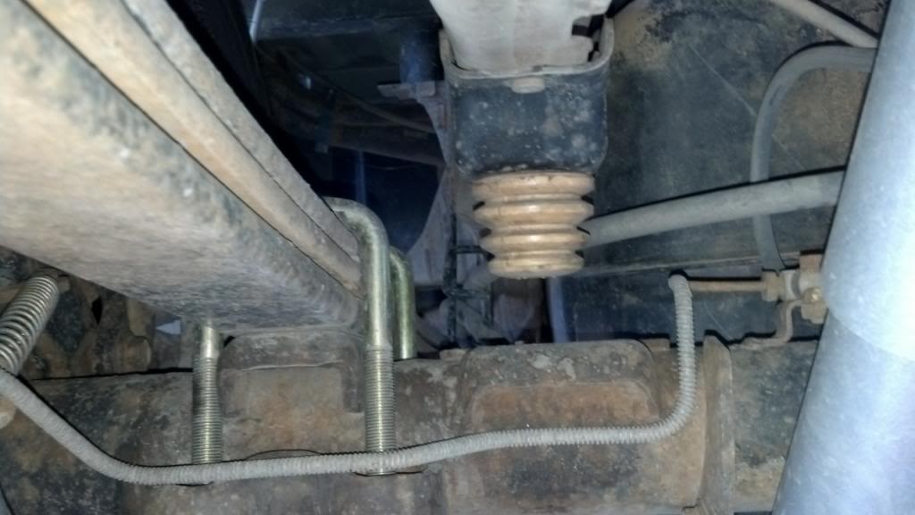

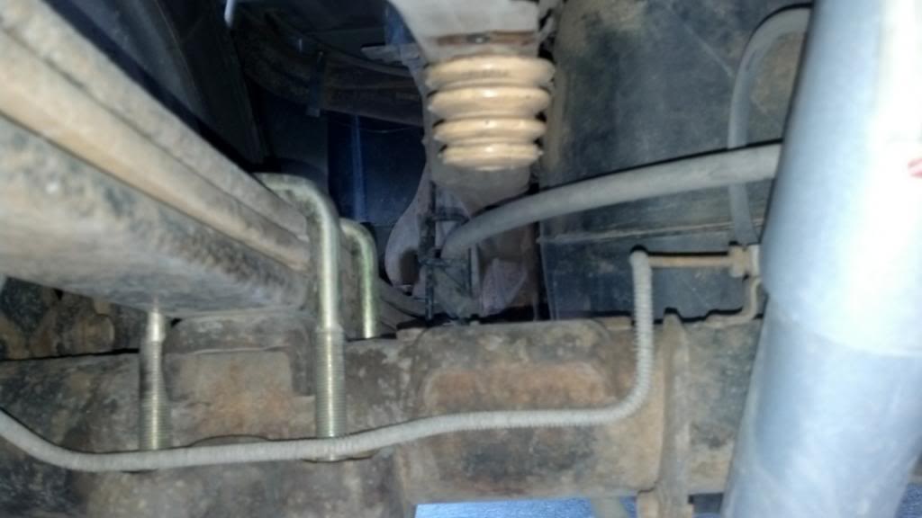

Definitely remove that bracket and relocate the jounce bumper directly on the frame. Two nuts inside the frame rail hold that bracket on, and there is already a hole in the frame, in the right spot, for the jounce bumper. It will ride dramatically better just by removing that bracket.

I'll take it for a drive tomorrow and see if this makes a difference. I didn't see any marks on the axle pads, so I'm not sure if it was contacting it or not, but this is better anyway. Most of the ride quality I'm talking about is on flat level ground, which I think is more the springs and lack of weight over the rear end in combination with the much heavier 20" wheels than anything else.
Removing the overload will be good anyway, I'll be able to put in the shims. I tried once before and the spring pin wasn't long enough to engage the full spring pack, shim, and axle pad. With the overload out, it should be fine.
Before:
After:
