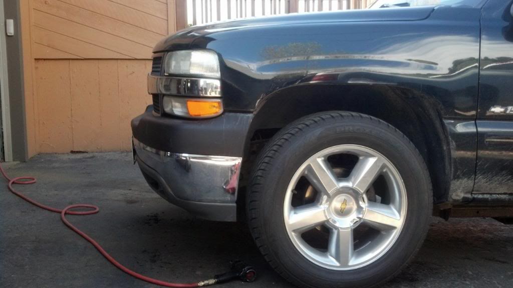

Got the bumper raised today!
Before:

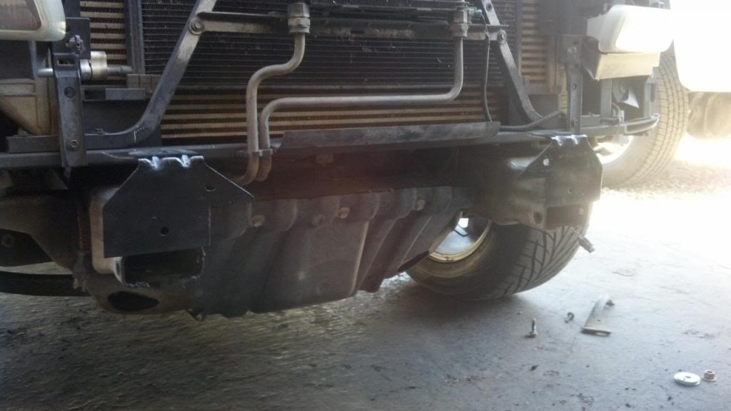

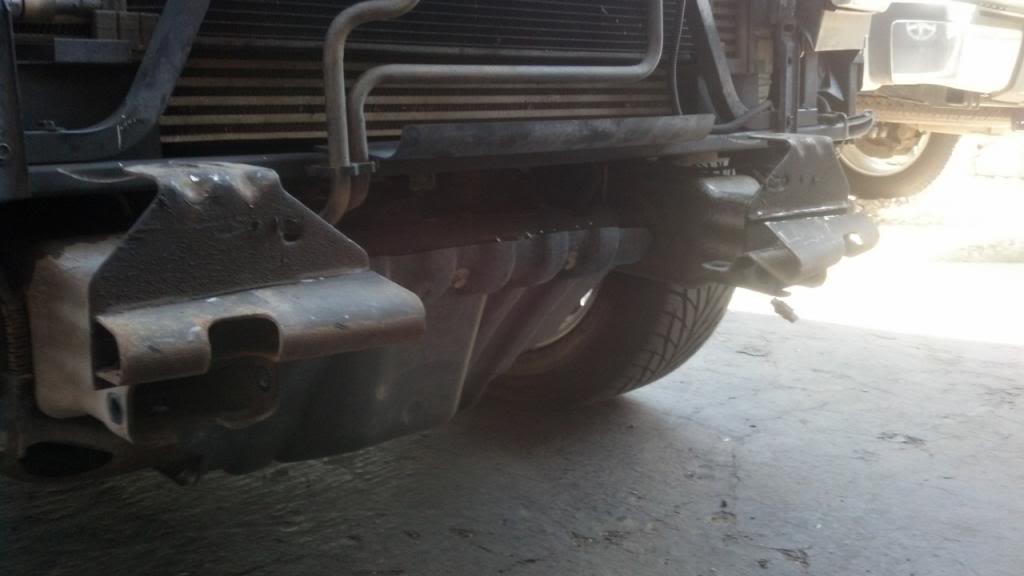

Frame horns and lower mounting bracket needed to be removed to allow the bumper to lift upwards.
Cutting off the frame horns:

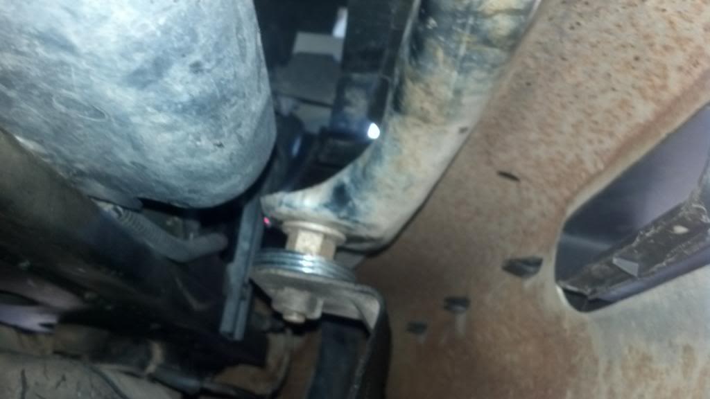

Brackets cut and painted:

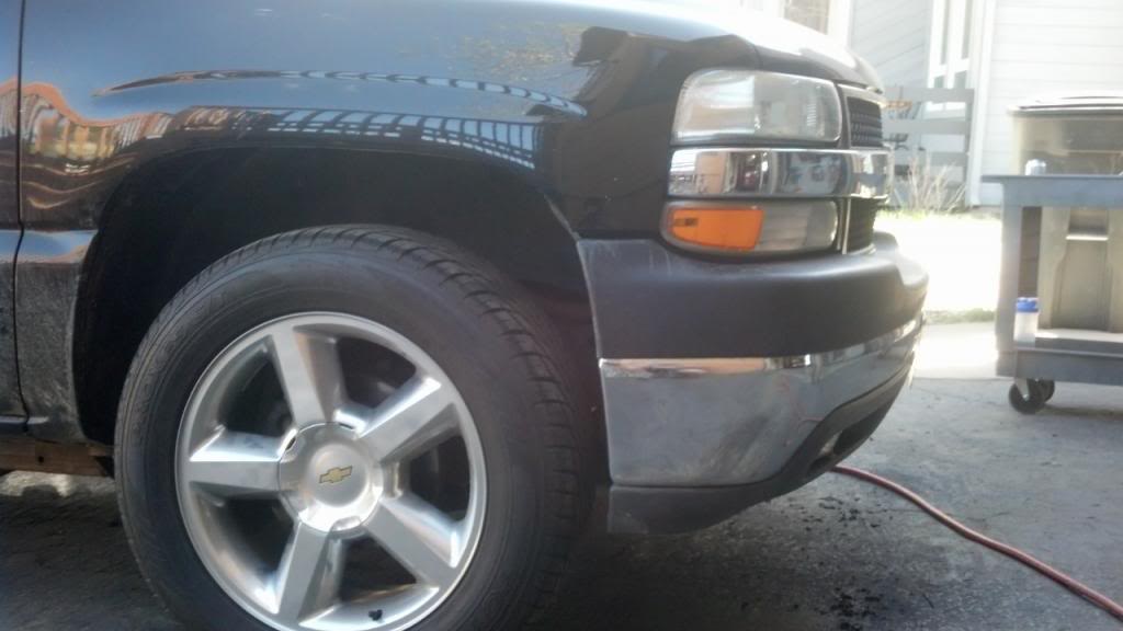

I used washers and a bolt on each side to lift the bumper. Ended up raising it about 1.25 inches. The driver's side had to come up an extra 1/8" or so to line up correctly with the lights. I think the radiator support might be tweaked up a little on the driver's side, that's the side that took the impact on the donor truck. Not a big deal.

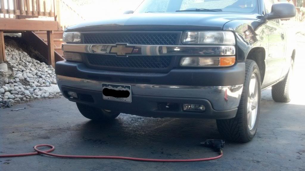

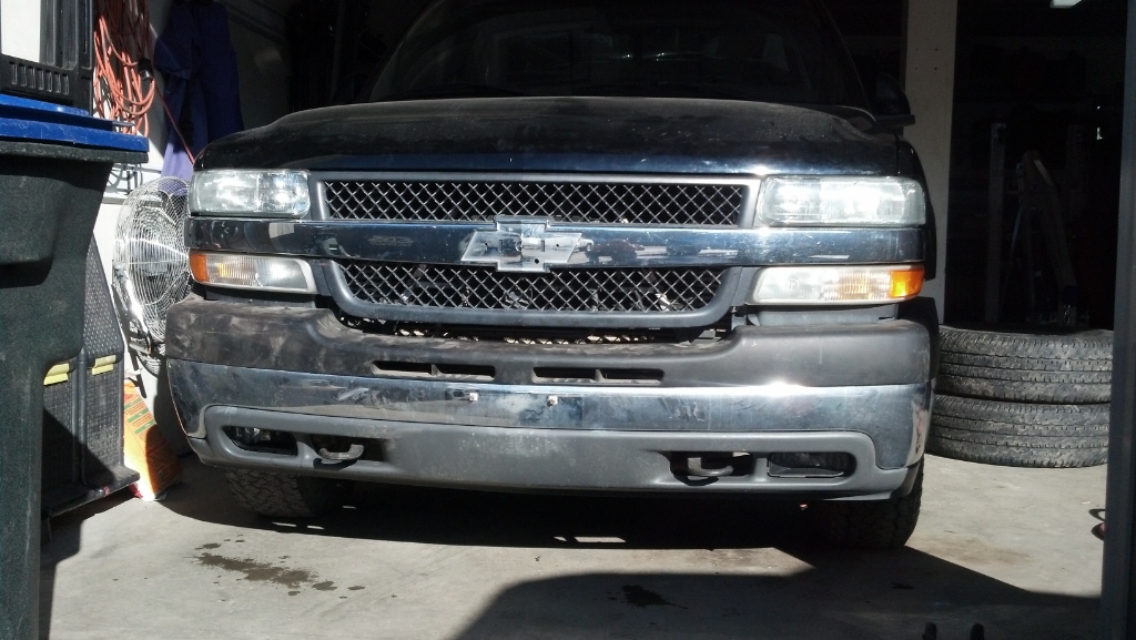

After:
Sides line up pretty well with the fenders

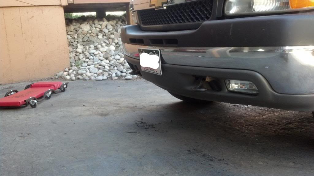

Tow hooks still fit too, just sit a little lower than normal

Good job man, that bumper lines up perfectly now.

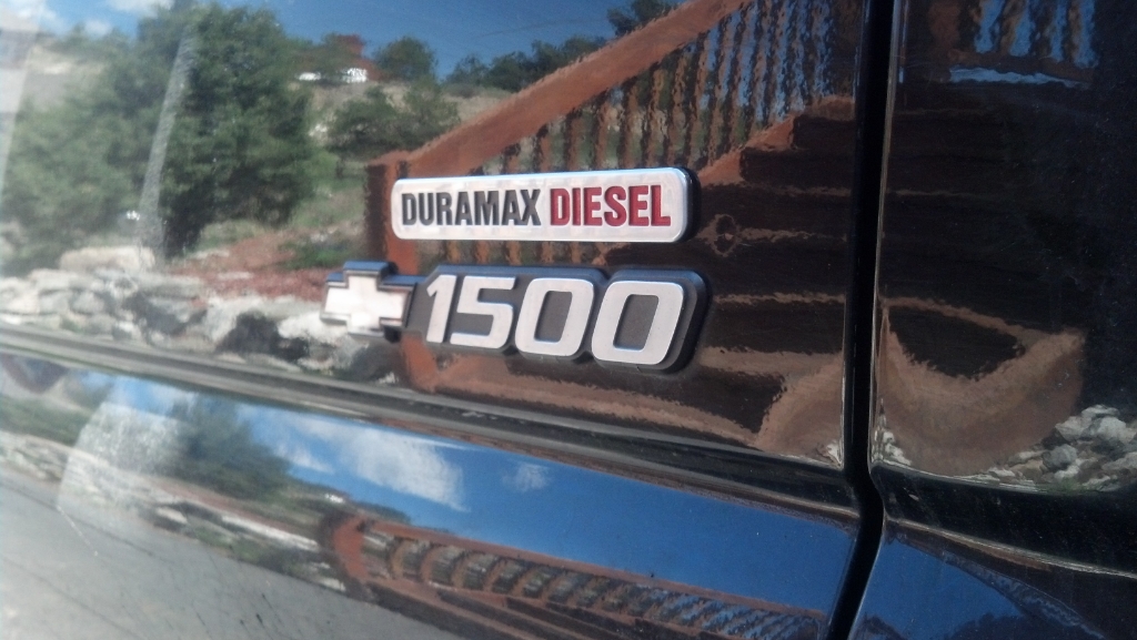

Thanks guys. I got the badges put on today too.
