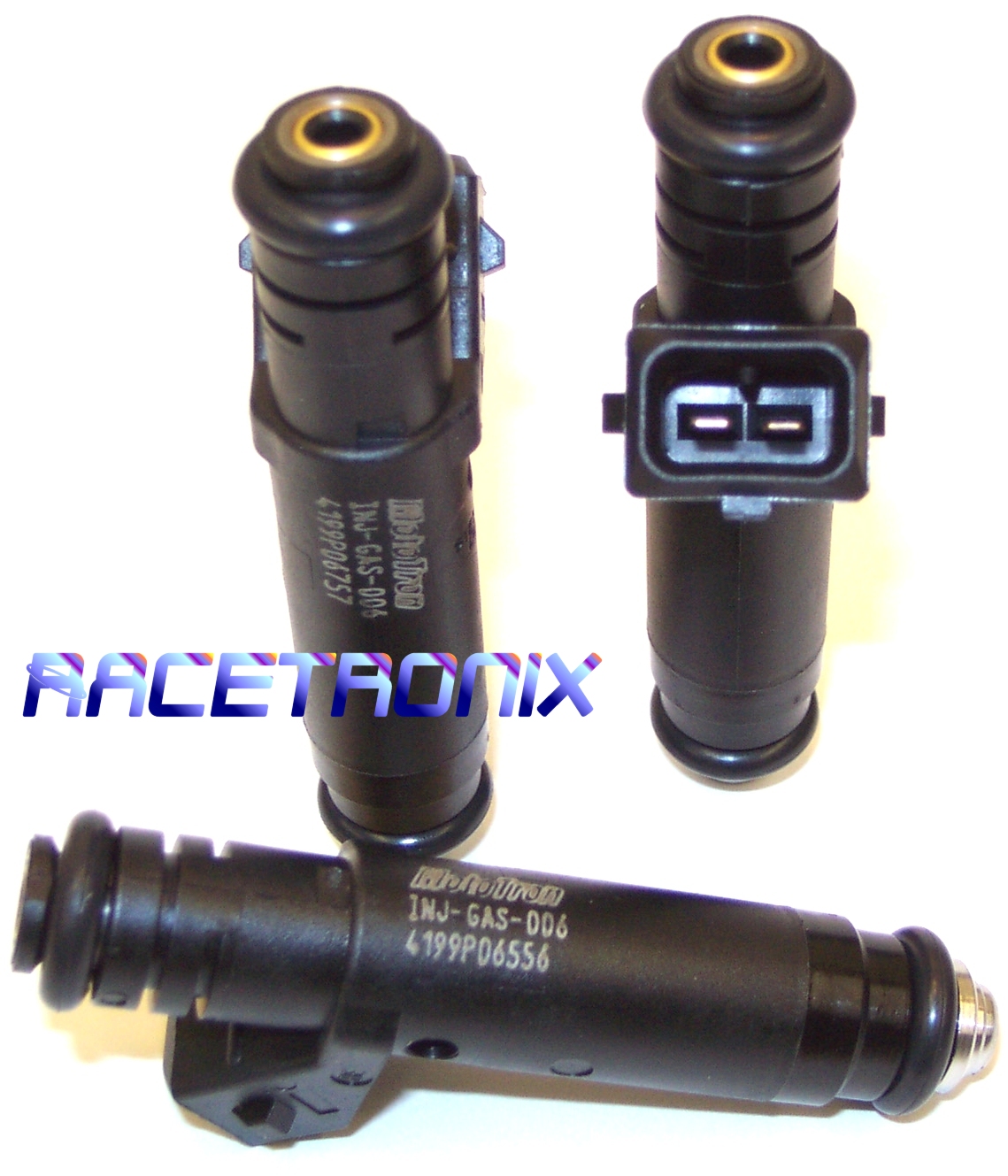

quick question, this picture here: http://www.racetronix.com/product/Injectors/L107-3.jpg
is that an EV1,or 6, in the description it said 1 which i dont doubt, but the adapters confuse the heck out of me. i have the more square connection on the injector vs the one in the picture ( more rectangular). is that msd connector kit good with that injetor EV1 (more rectangular) ? if so thats going to be the ticket.
thanks for the clarification.
