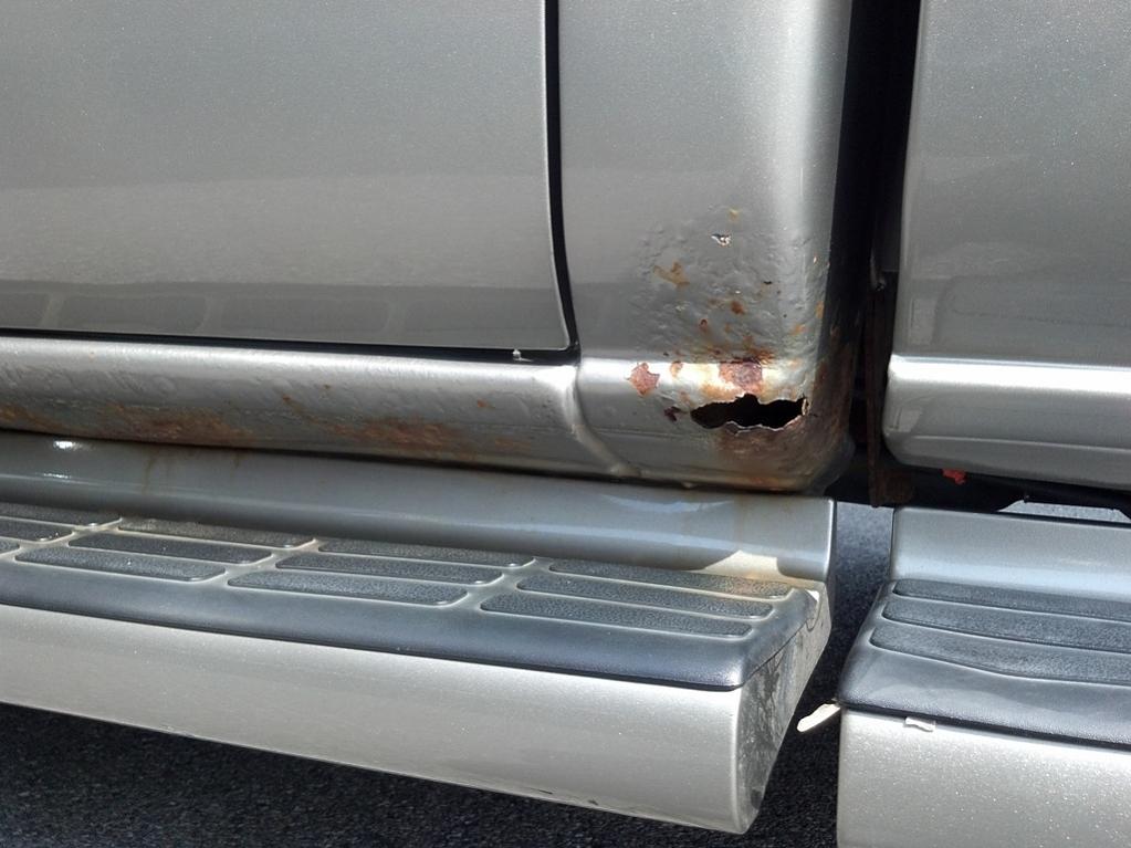

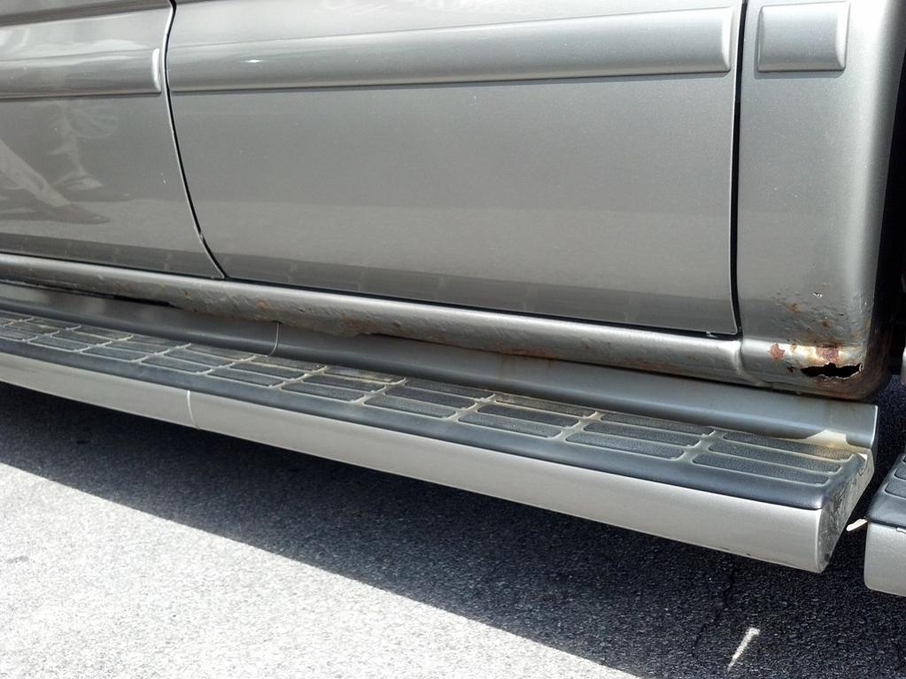

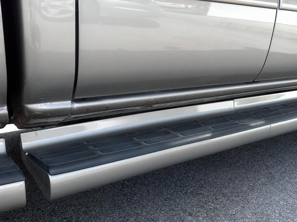

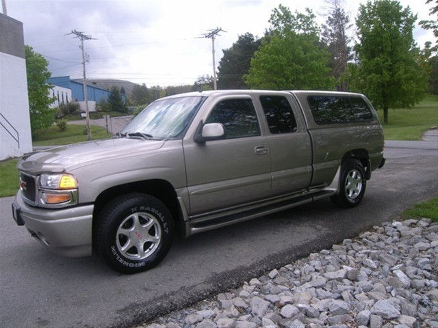

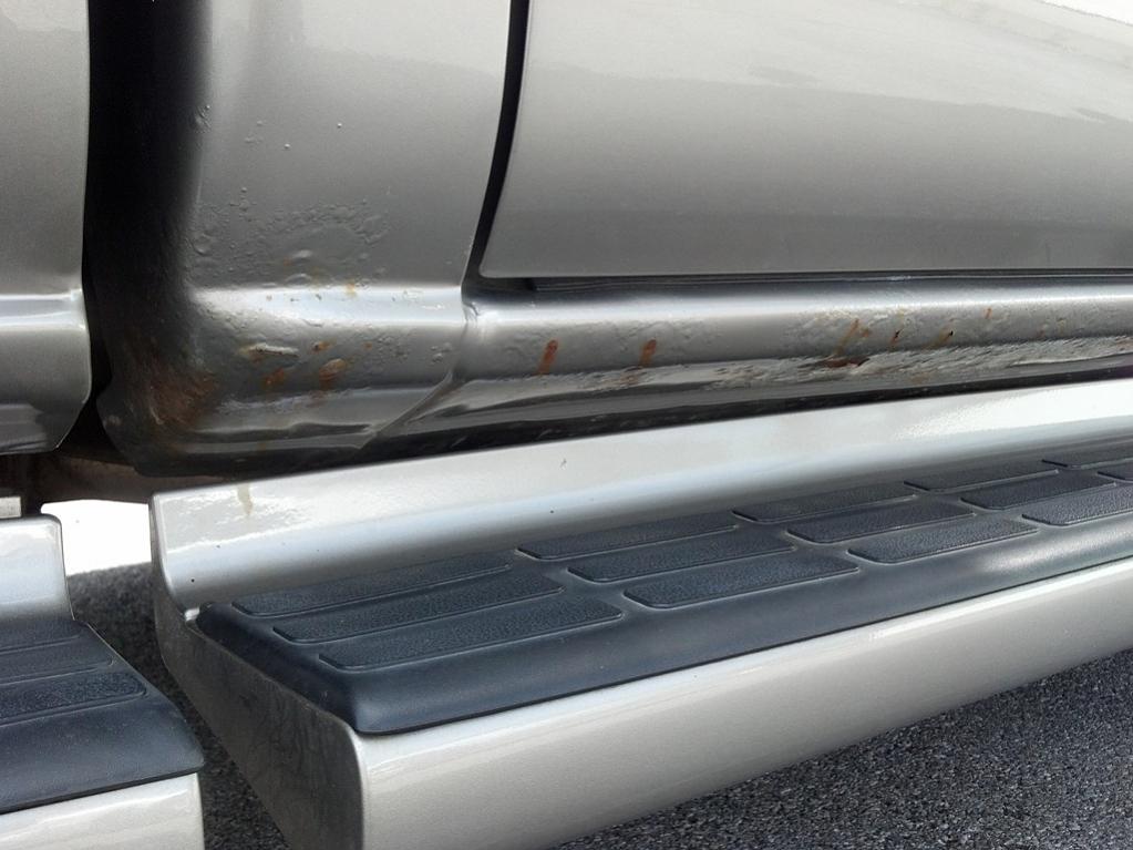

I've been looking for a decent 6.0L truck for months now and it seems as though everything I look at is rusted out. Even a few ss's have the rockers rusted out. Well I found a c3 w/80k miles that i'm looking at $13000 out the door with new rockers and cab corners being put on and repainting under the massive factory running boards
Aside from needing new rockers/cab corners the truck doesn't have any other issues that I can find, theres not even a door ding on this one.
Does this seem like a fair deal? The place is a very big gm dealer thats very reputable with its collision center as well.
Outside the extreme rust through in the areas you’ve shown, it looks like it fairly clean. Some more of the typical rust-through area are the latch area of the underside front of the hood and the back bumper shell, especially under the plastic. Also, anywhere the side steps rub against the side of the truck and has removed the paint is suspect.
The C³ is a very nice truck and has a lot of content, but there are typical problem areas to keep an eye out for, they usually involve the following:

What year is it? I think u could find a less rusted truck with under 100k miles for that price. Im not saying its a bad deal cause there going to fix it and it seems to be a pretty clean truck. If the underneath and backsides of the sheetmetal looks good. The inside bottom of the doors and frame are om. Then i wouldnt say ur getting hurt. But if it were me personally id have to think pretty hard.

I dont think your getting raped on the deal. Itd be nice of they fixed it all for u. Im sure u tried but. Id put it to them like this. How many people honestly are goi g to go to a dealership looking to buy a truck with rusted out cab corners. So if they want to move it which is there business theyll fix it. Are u leaving the big running boards on it?
