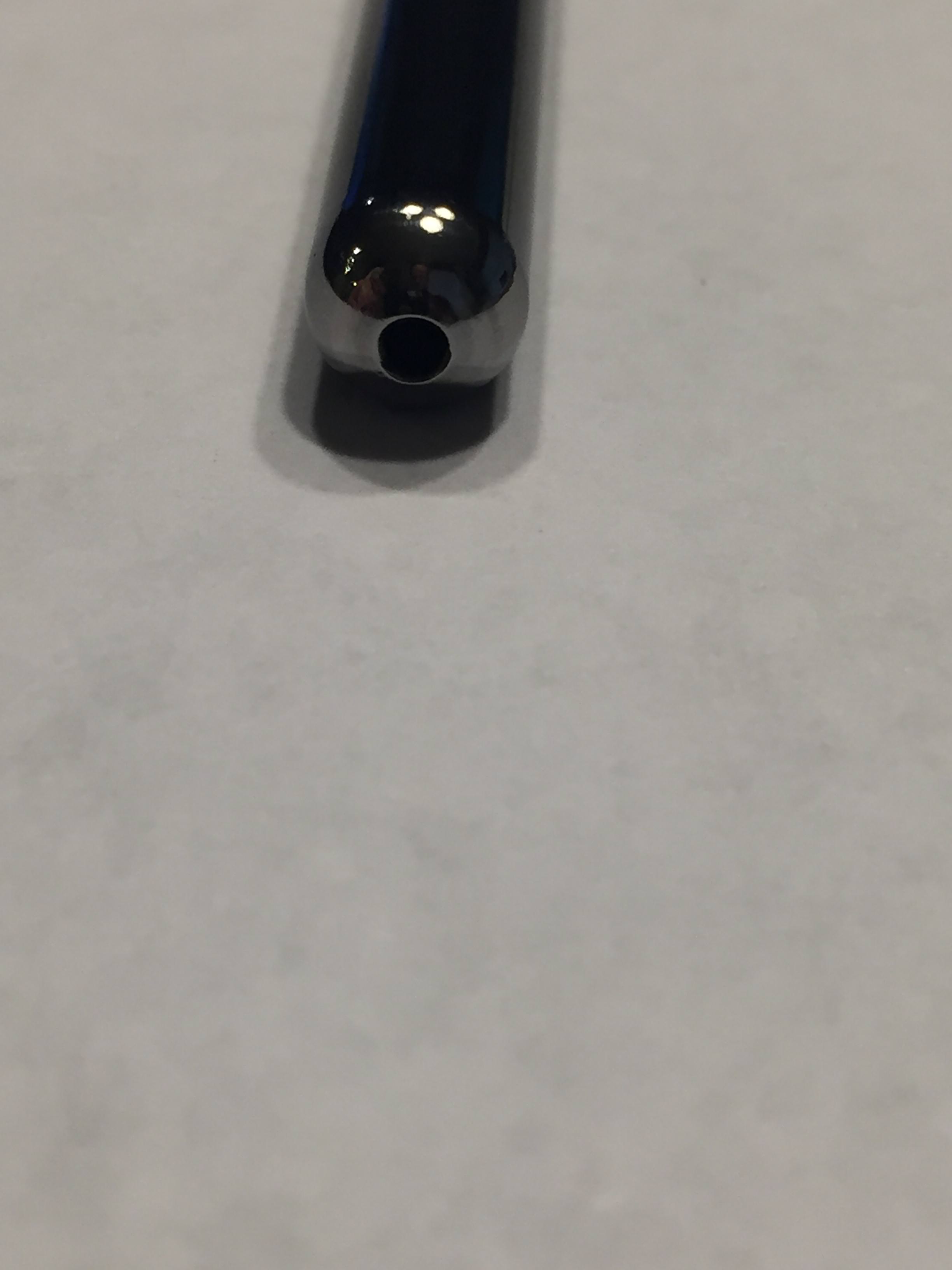

Polishing rocker arm cups and pushrod ends
