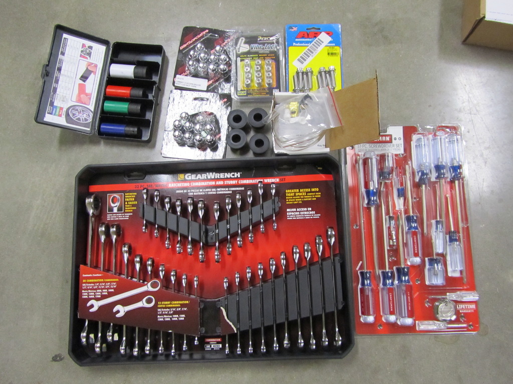

Got a couple new things for Christmas. Nothing big just tiny parts
-ARP SS Bellhousing bolts
-Black poly engine mount inserts (I had red but want to match the black ES trans mount haha)
-Lug Nuts
-Lug nut sockets
-Tools
-Fumoto Oil Drain Valve (because of the location of the oil drain bolt when you drain the oil it gets all over the crossmember. With this valve I won't have messes.)
-Percy's SS locking header bolts
