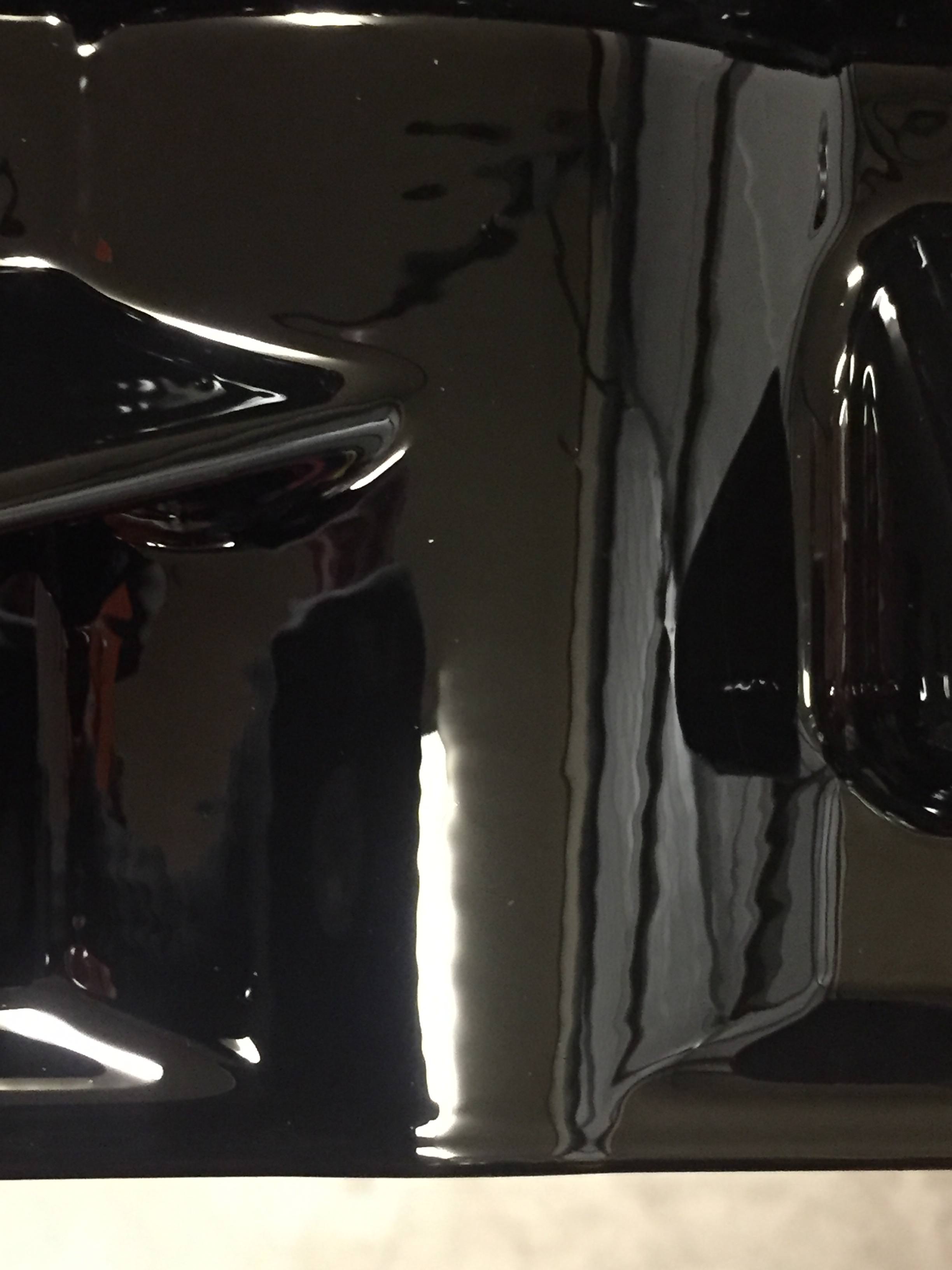

After 3-4 coats of gloss black and sanding inbetween I was finally happy enough with the finish. I just finished up putting 3 coats of clear on it and when it fully cures I’m going to start putting the shortblock back together.

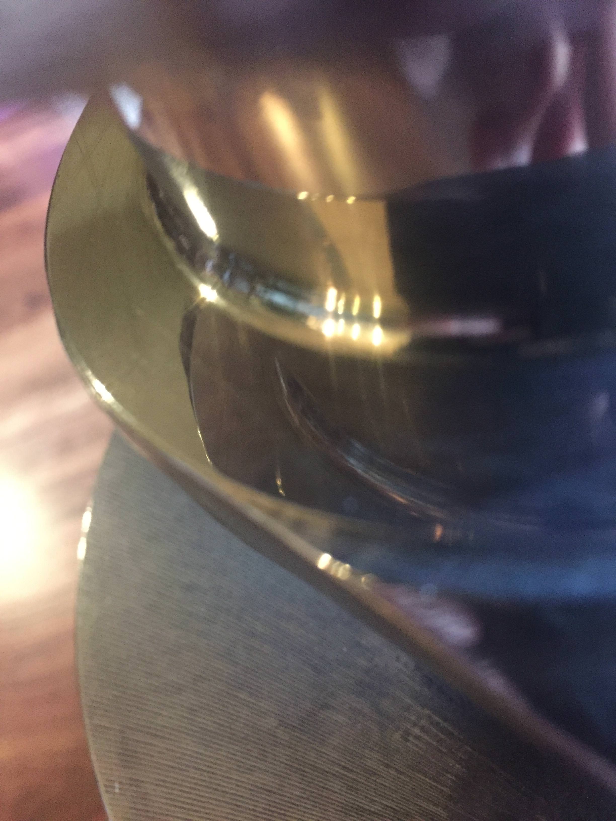

Before on #3 main rear thrust face...that sunburst pattern is no bueno
Petro's Project ERL Superdeck 427 w/ Whipple 2.9L-xzgcz35.jpg
And after redneck garage polishing
Petro's Project ERL Superdeck 427 w/ Whipple 2.9L-fb0v73u.jpg

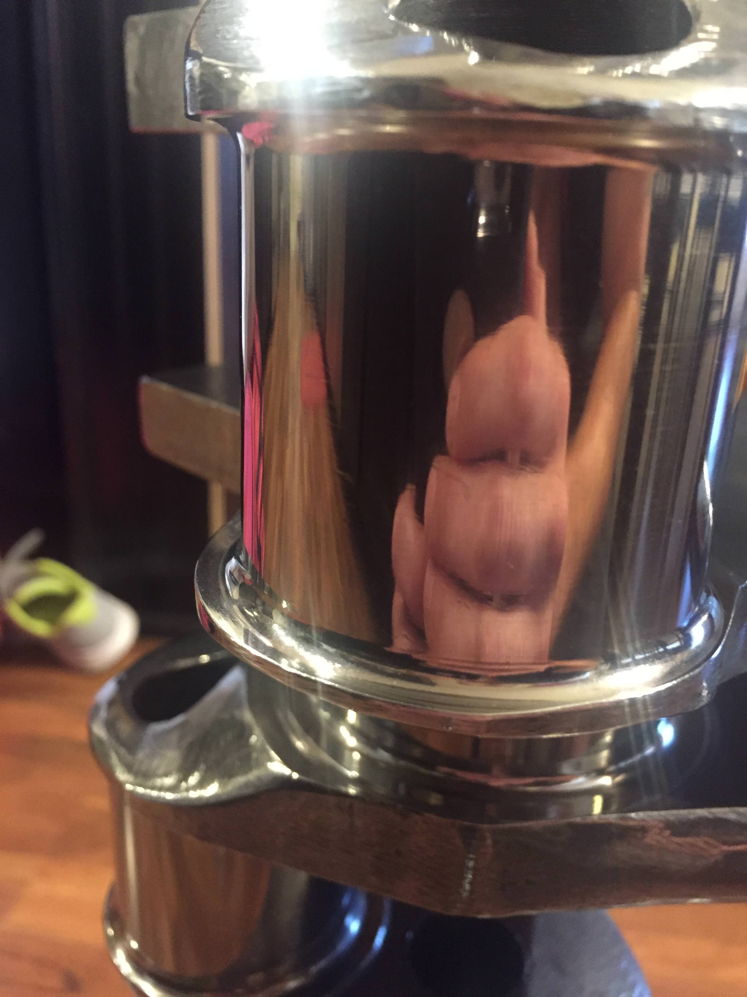

How the rod journals turned out....
Petro's Project ERL Superdeck 427 w/ Whipple 2.9L-vg4jab5.jpg

Damn. That’s pretty. Any concern with oil not clinging to the surface?
Old Jun 2, 2018 | 07:42 PM
  #580
Petraszewsky's Avatar
iTrader: (28)
Joined: Oct 2008
Posts: 1,137
Likes: 22
From: USA
I buffed the counterweights in hopes it would help oil sling off but I don’t think it’ll be a issue since the mains and rod journals are pressure fed oil. Plus the moly coating on the bearings holds more oil since it’s porous. I also looked at them magnified 40x and you can see lots of nicks and gouges still....I’ll try to get a pic of what I’m talking about. They weren’t visible before since the grinding marks tricked the eyes into thinking they were all straight lines but after polishing there’s nasty looking gouges from the abrasives loading up. Pretty cool stuff to see.
