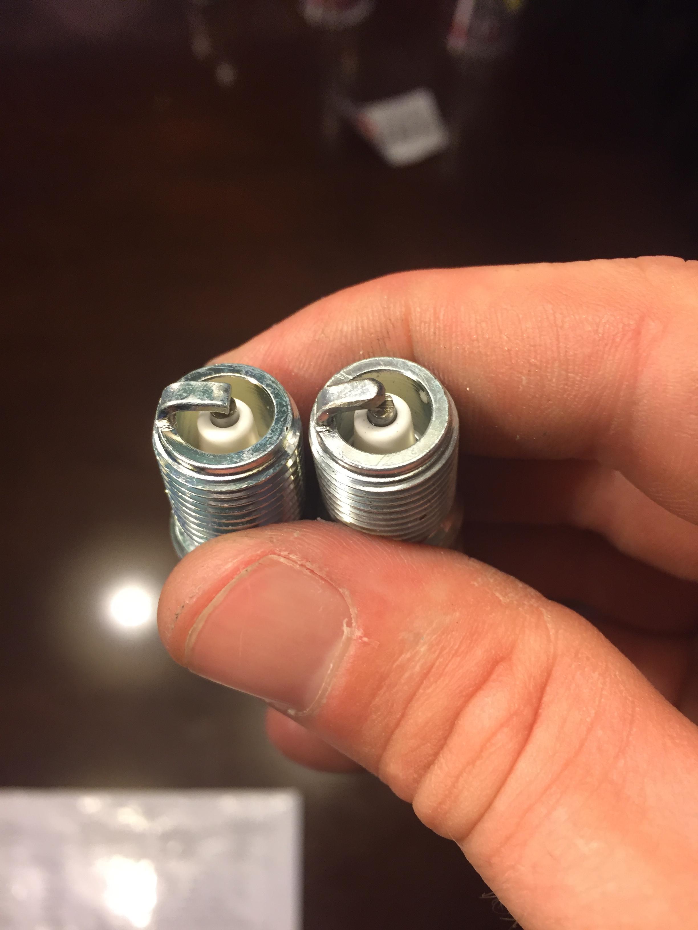

I have no money so I've been messing around with stuff I probably shouldn't but what the heck....rounding off sharp edges on spark plug strap and on the body. I plan to index them and I might try a side gapping a set and see how they do.

The strap of the spark plug has the tip projecting down a bit for a reason, it appears you sanded that off.

Yeah the corners of the ground strap were pointed down like a upside down "U". I rounded the top side and made the bottom side sharper. Like a 45* chamfer of the side and filed the face back a little and flat with sharp bottom and rounded tops.

Yeah it's getting to the point no matter what your numbers are it's going to be hard to differentiation what may have helped you and what many have hurt you.

NGK are cheap plugs anyways if they end up sucking....if it's down on power then I'll get a slightly more radical cam haha. I got a two piece timing cover just for that.
