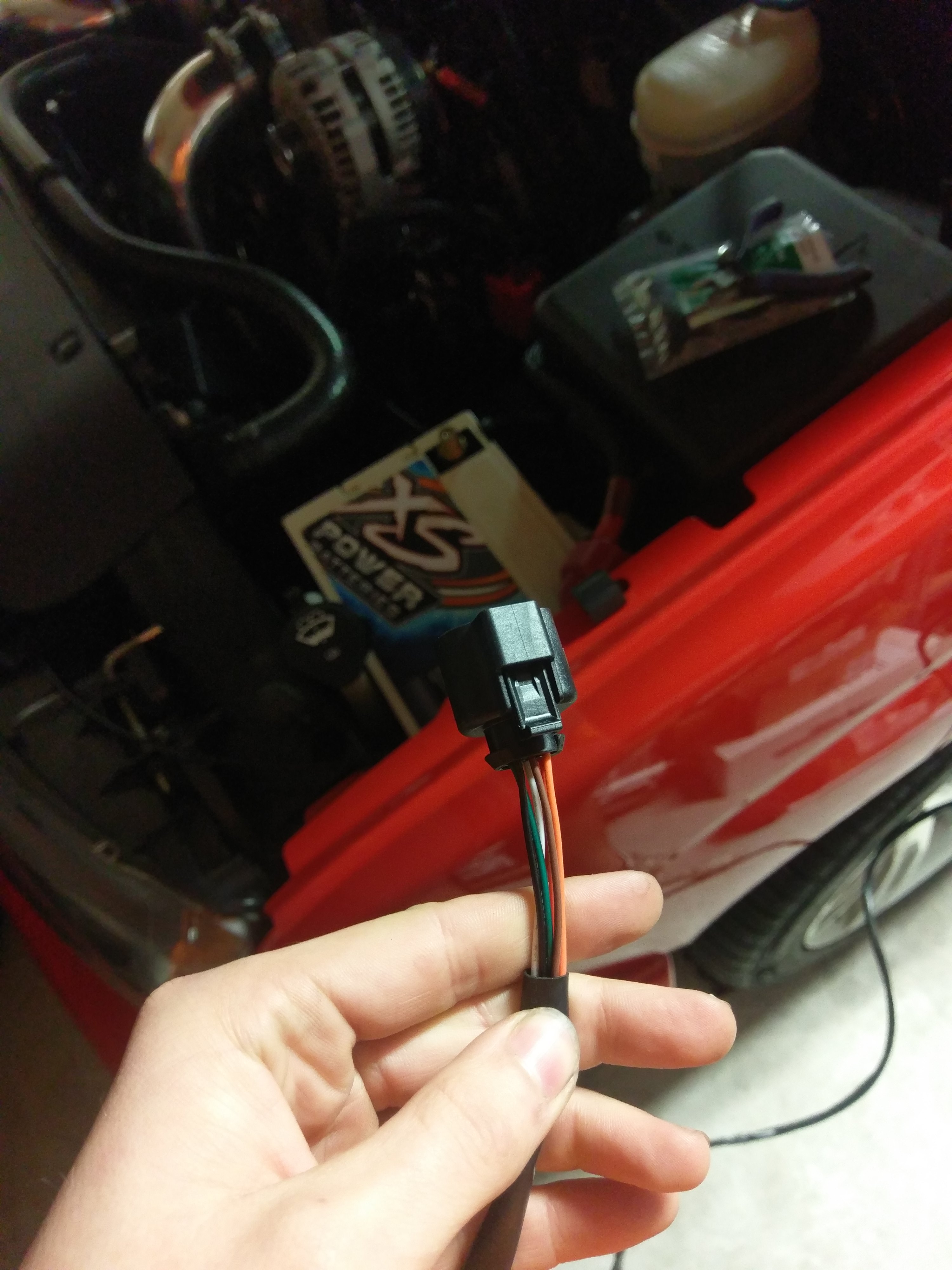

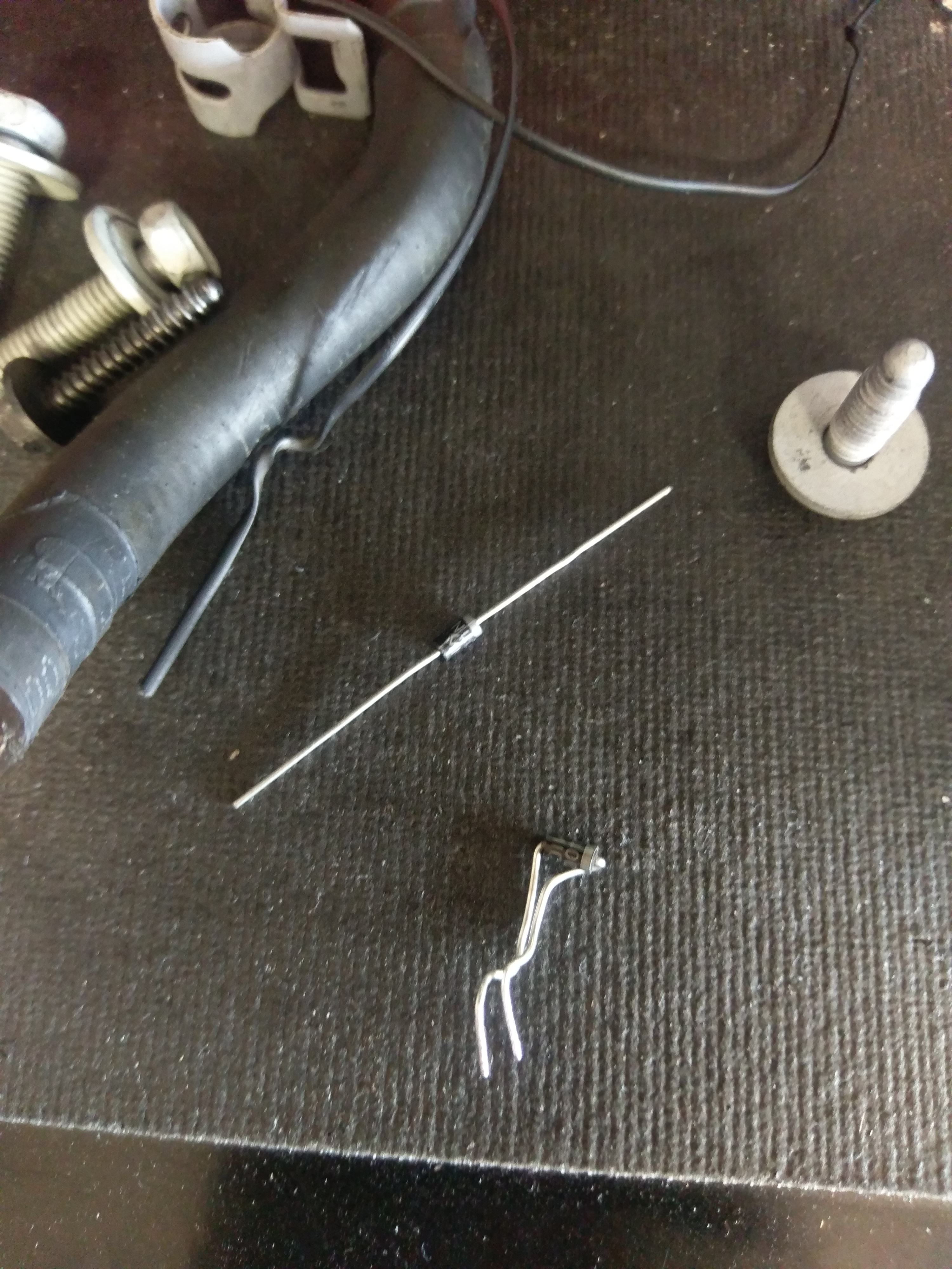

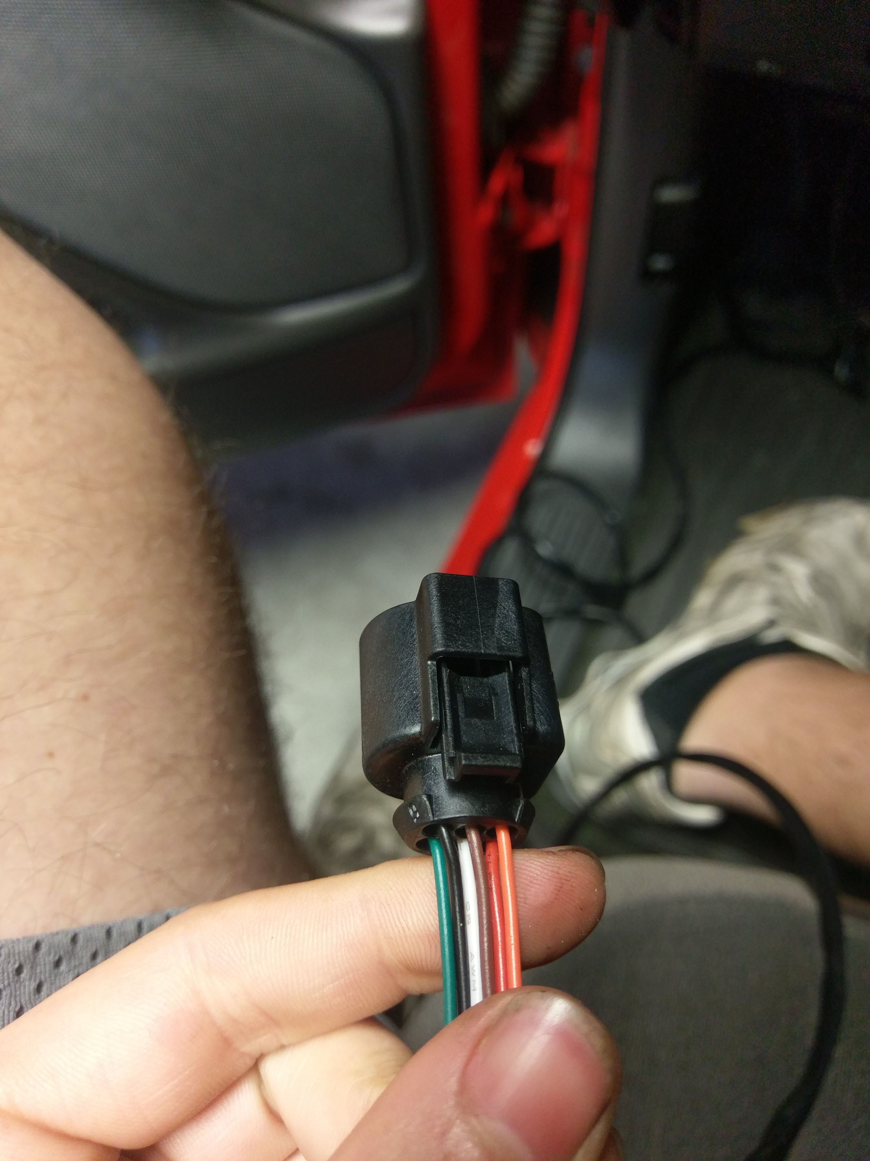

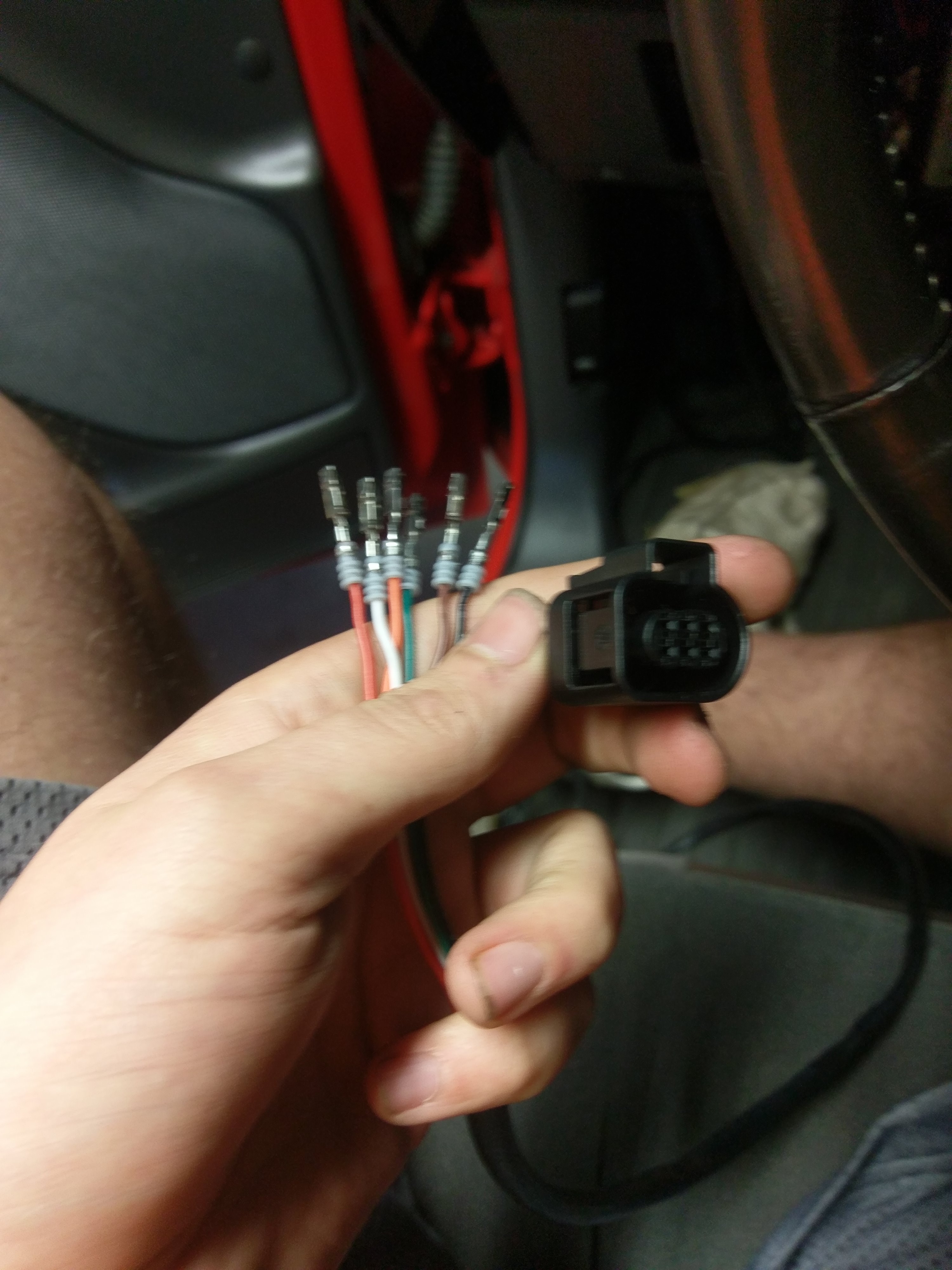

I couldn't get the AEM wideband plug through the firewall, so I depinned it and got it through and routed across the engine
ILuvJDM's 2007 NBS RCSB Build - Turbo/4L80e/Coilovers/Wilwoods-yeoyhus.jpg
ILuvJDM's 2007 NBS RCSB Build - Turbo/4L80e/Coilovers/Wilwoods-4xzogu4.jpg
Success

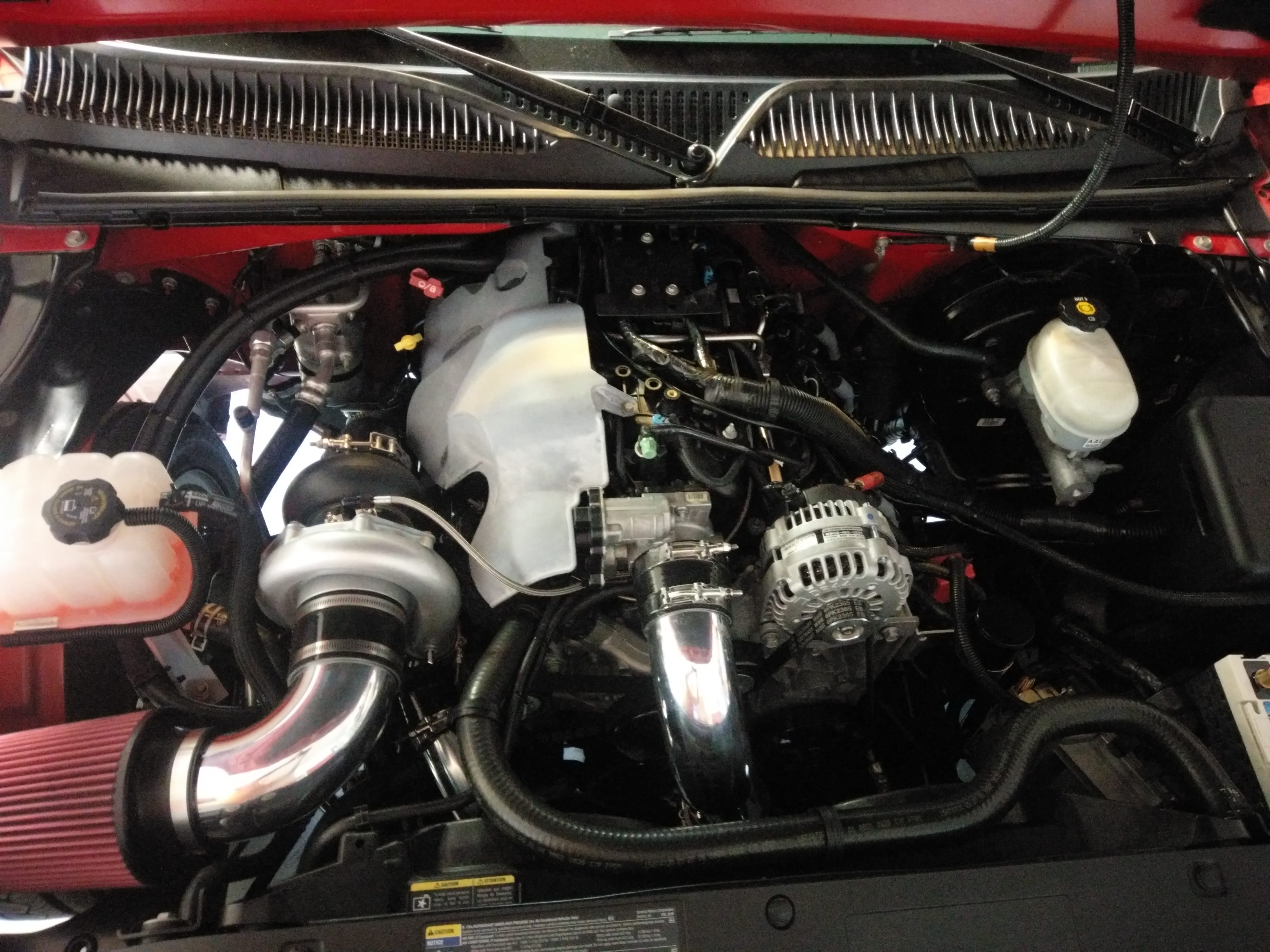

Routed and zip-tied

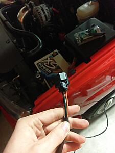

I used a diode bent in half to depress the two pins required at the same time

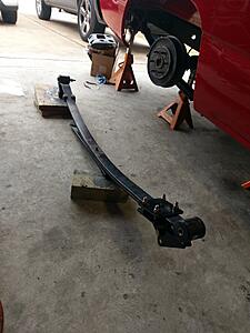

Here we go again
ILuvJDM's 2007 NBS RCSB Build - Turbo/4L80e/Coilovers/Wilwoods-fcjrh18.jpg

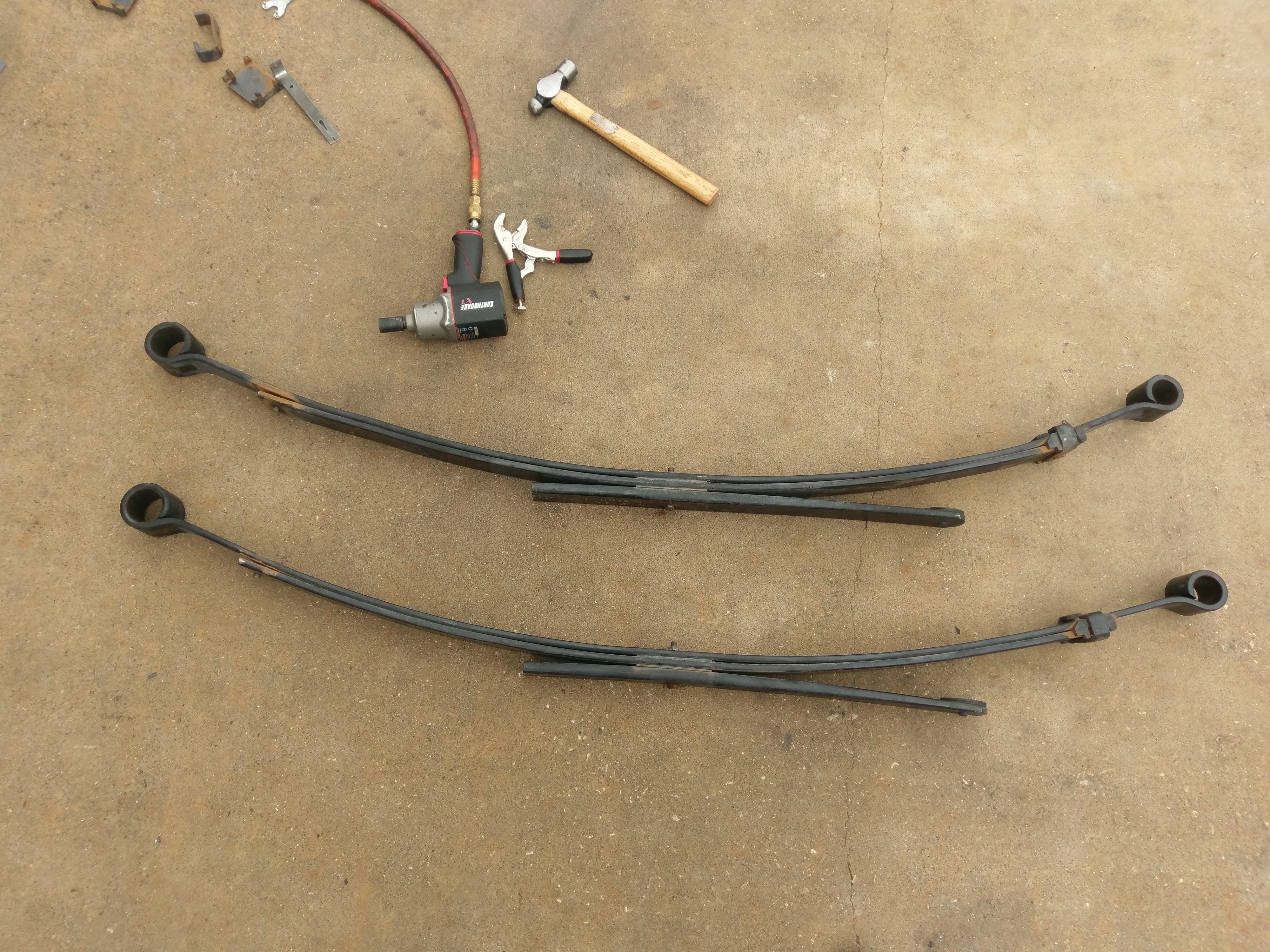

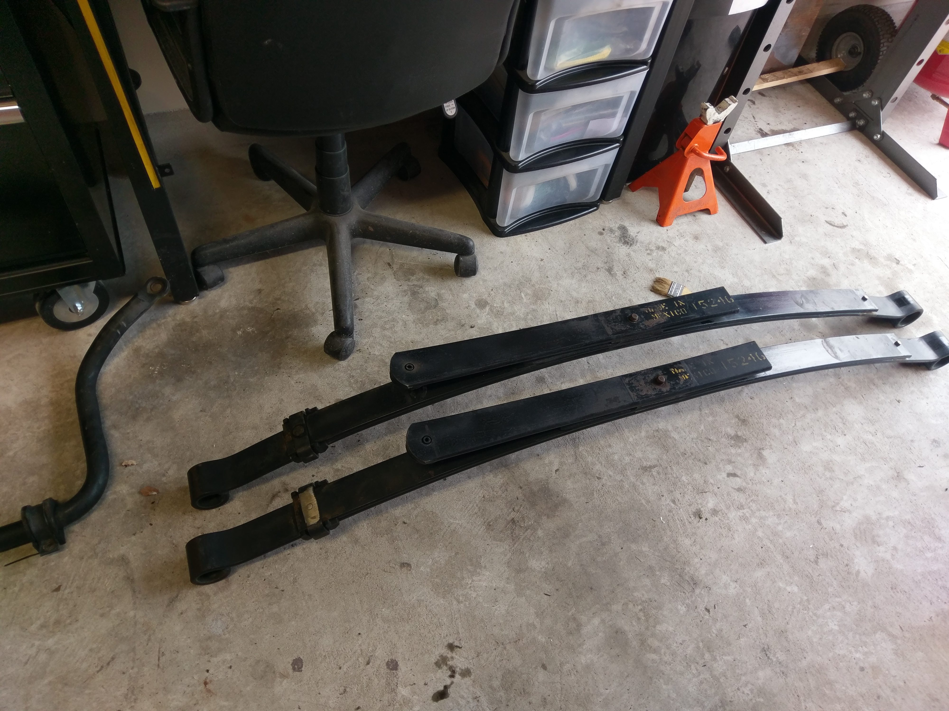

You can tell previous owner had axle clamp on it for axle wrap, it bent the springs

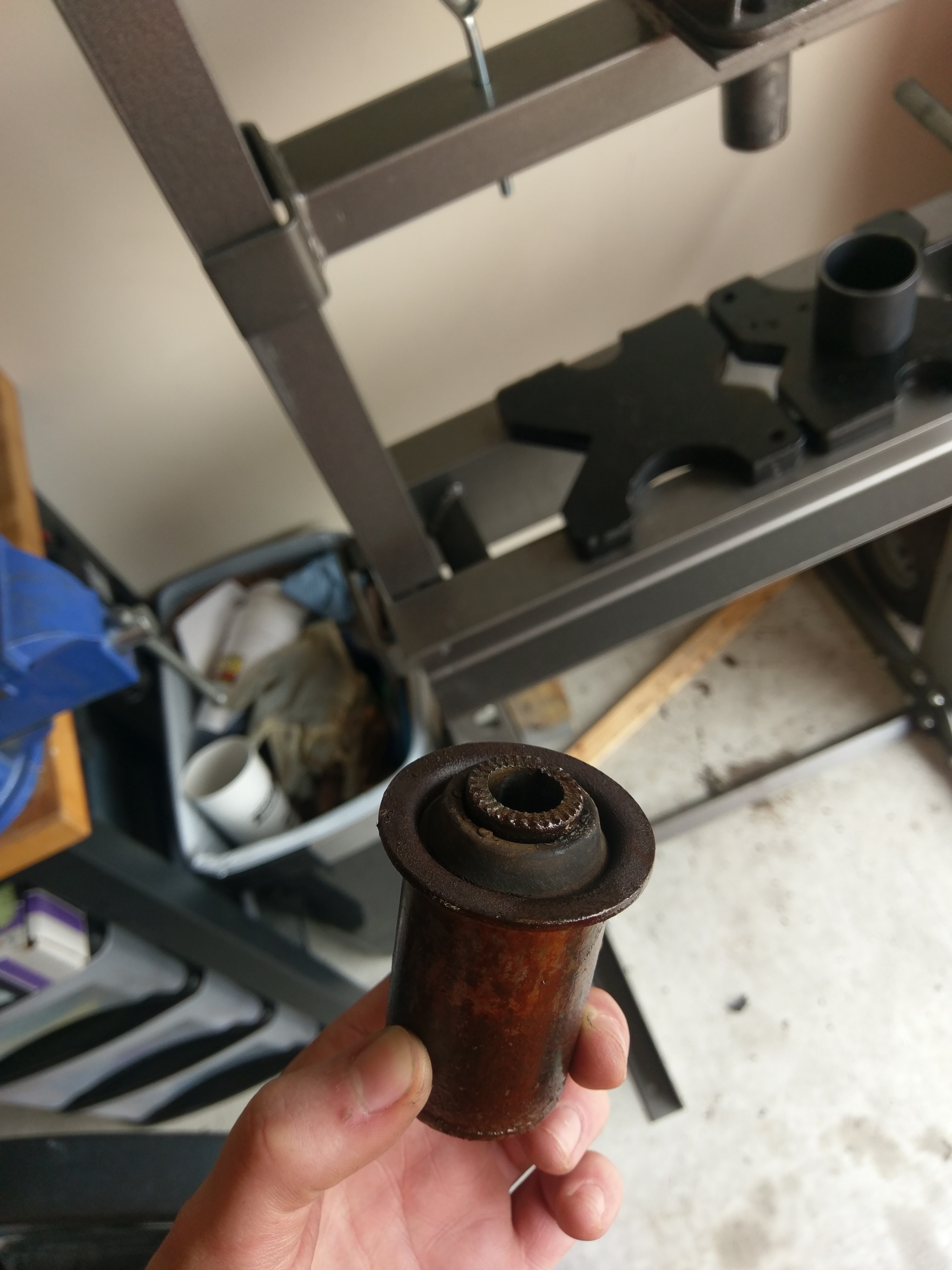

Inside of the shackle bushing hole was very rusty, so trying to get the scale off

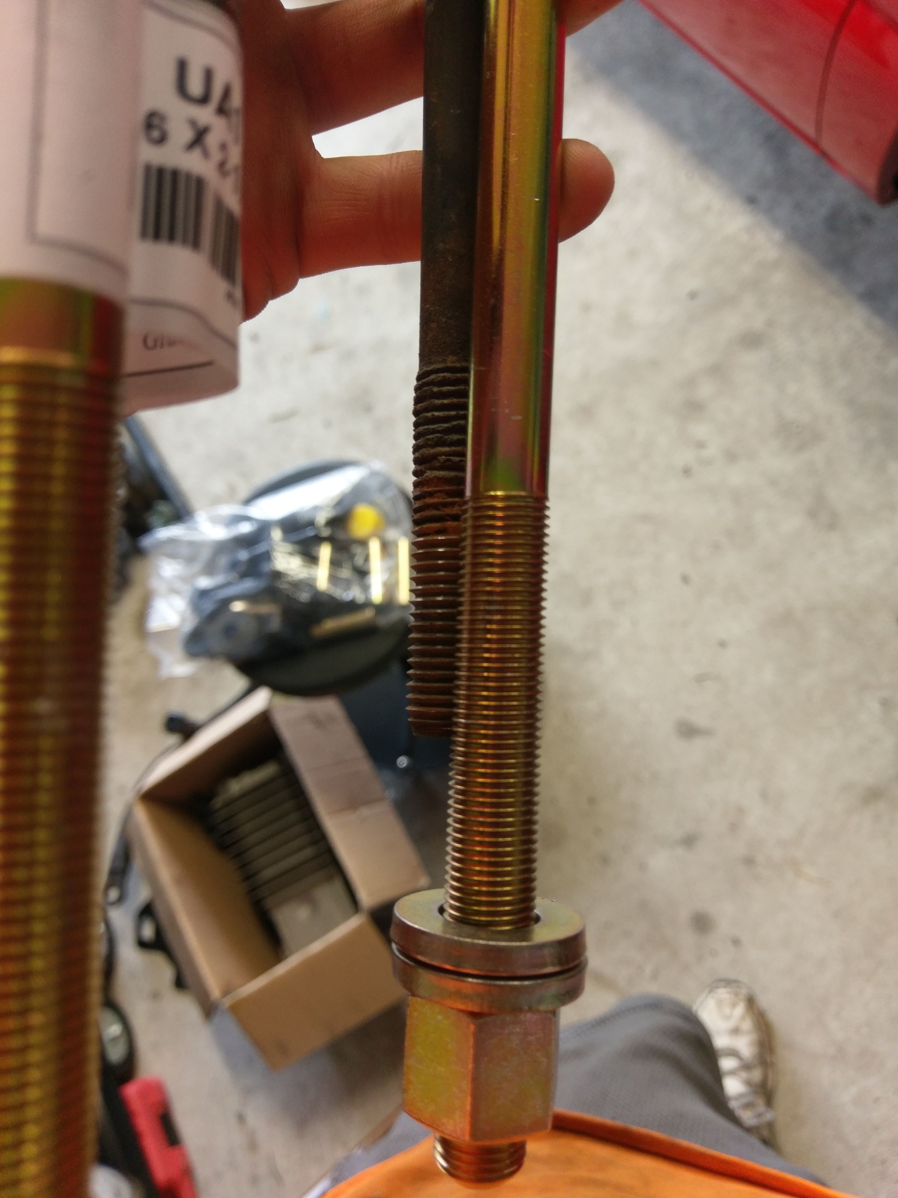

New u-bolts and poly bushings came in the mail
ILuvJDM's 2007 NBS RCSB Build - Turbo/4L80e/Coilovers/Wilwoods-hdkqvax.jpg
Lots of excess threads, but they should have enough threads to apply pressure with the flip kit, which was my worry

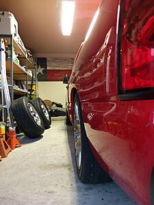

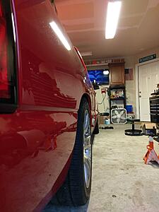

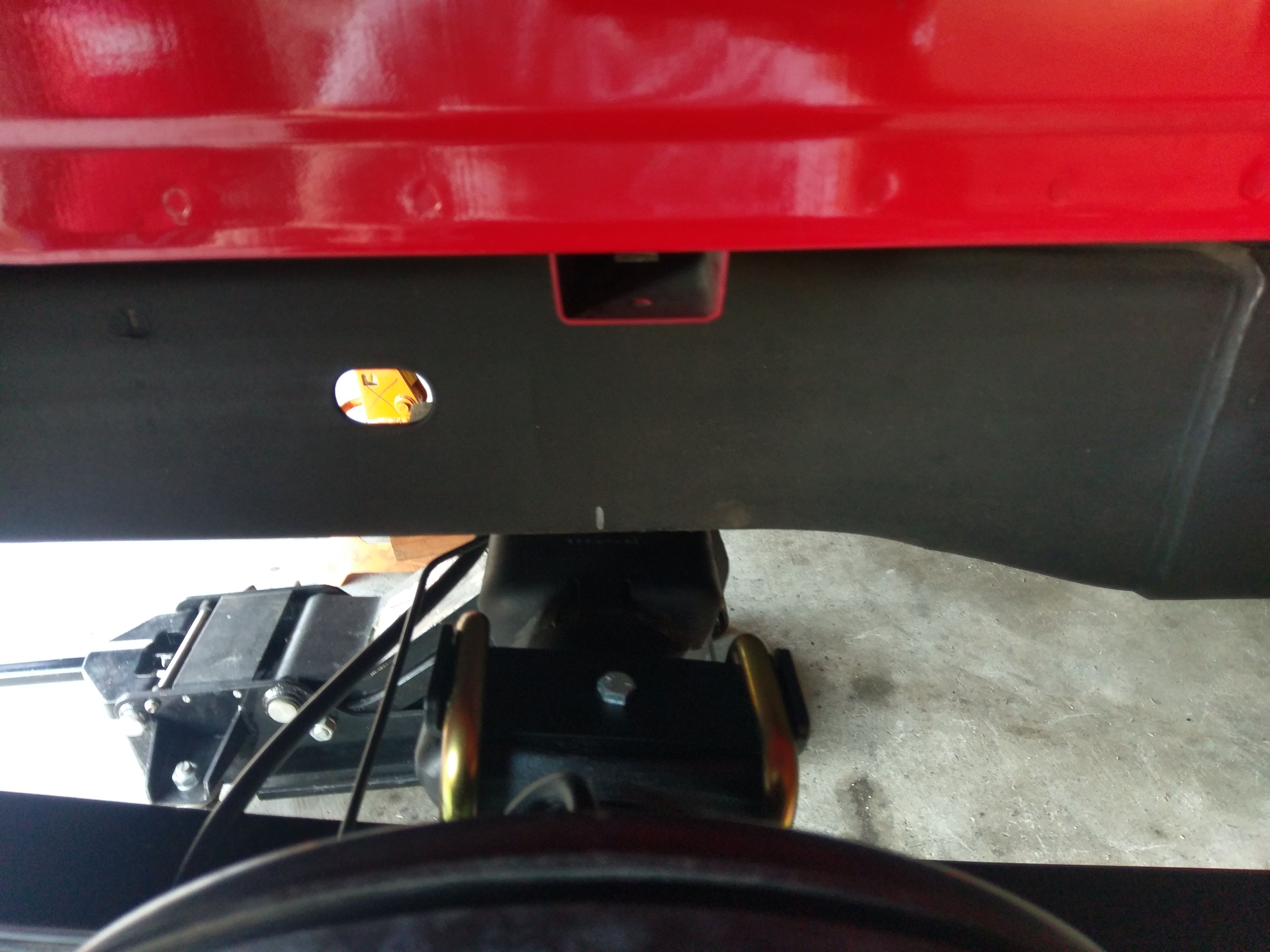

Back on all 4 tires
ILuvJDM's 2007 NBS RCSB Build - Turbo/4L80e/Coilovers/Wilwoods-0huz2w6.jpg

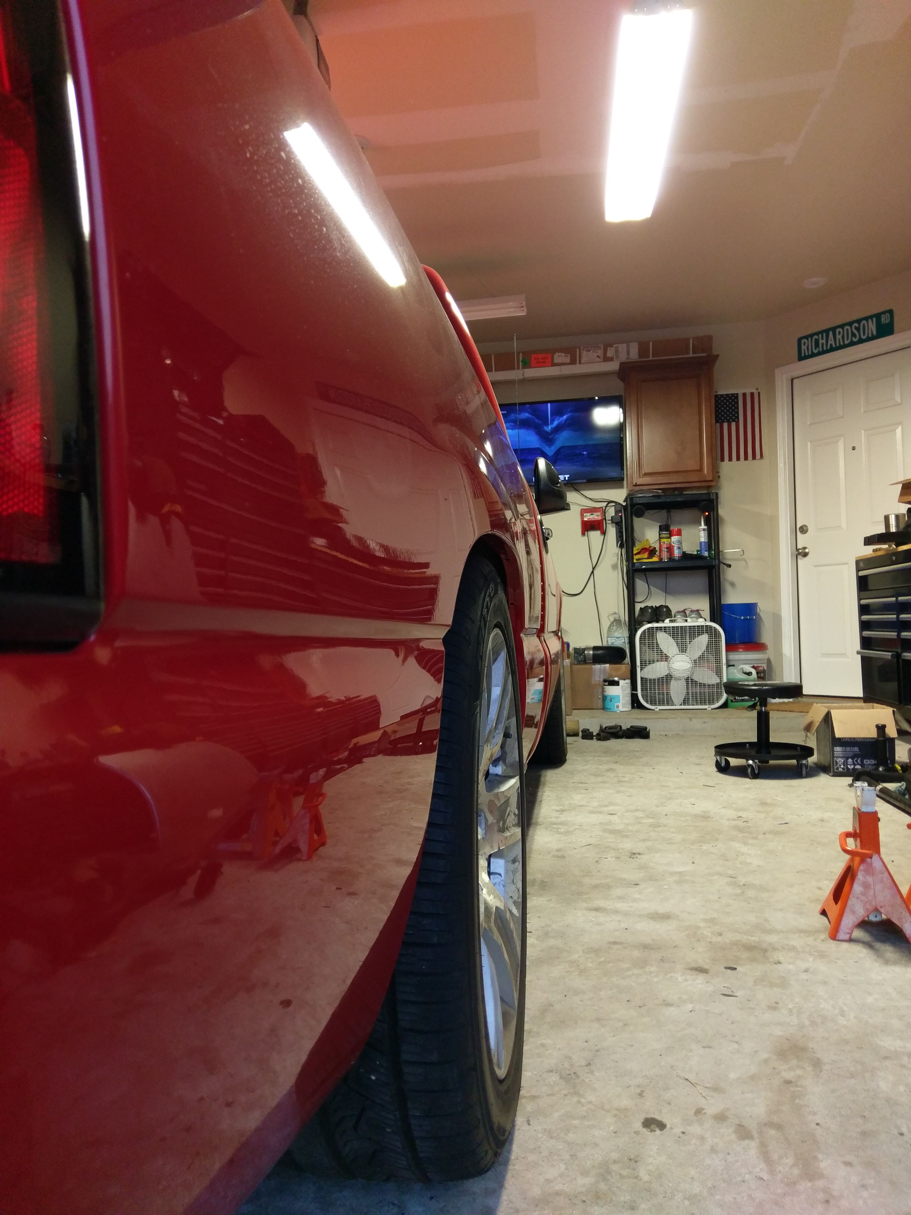

Axle seems to be over to the passenger side a bit more than the drivers
ILuvJDM's 2007 NBS RCSB Build - Turbo/4L80e/Coilovers/Wilwoods-3a1t2e7.jpg
ILuvJDM's 2007 NBS RCSB Build - Turbo/4L80e/Coilovers/Wilwoods-qm2b4py.jpg
ILuvJDM's 2007 NBS RCSB Build - Turbo/4L80e/Coilovers/Wilwoods-joqj0gm.jpg
ILuvJDM's 2007 NBS RCSB Build - Turbo/4L80e/Coilovers/Wilwoods-t3r3yxt.jpg
Center of notch marked

Do the 2014+ wheels still tuck like the nnbs wheels? Looks like they stick out more.
pretty sure they are the same, the rear passenger side looks more flush because the axle isn't centered on these trucks from the factory. I looked into the axle centering thing and found a ton of threads on multiple forums about it, and the general consensus is every truck has the same issue with axle being pushed to the passenger side
Old Feb 15, 2018 | 01:36 PM
  #70
Atomic's Avatar
I have a gauge for that
Posts: 16,282
Likes: 438
You want it slightly offset so the ujoint cap velocity is not zero, but its generally <1degree. If its dead on perfectly aligned the cap doesnt rotate and doesnt get lubricated properly.
