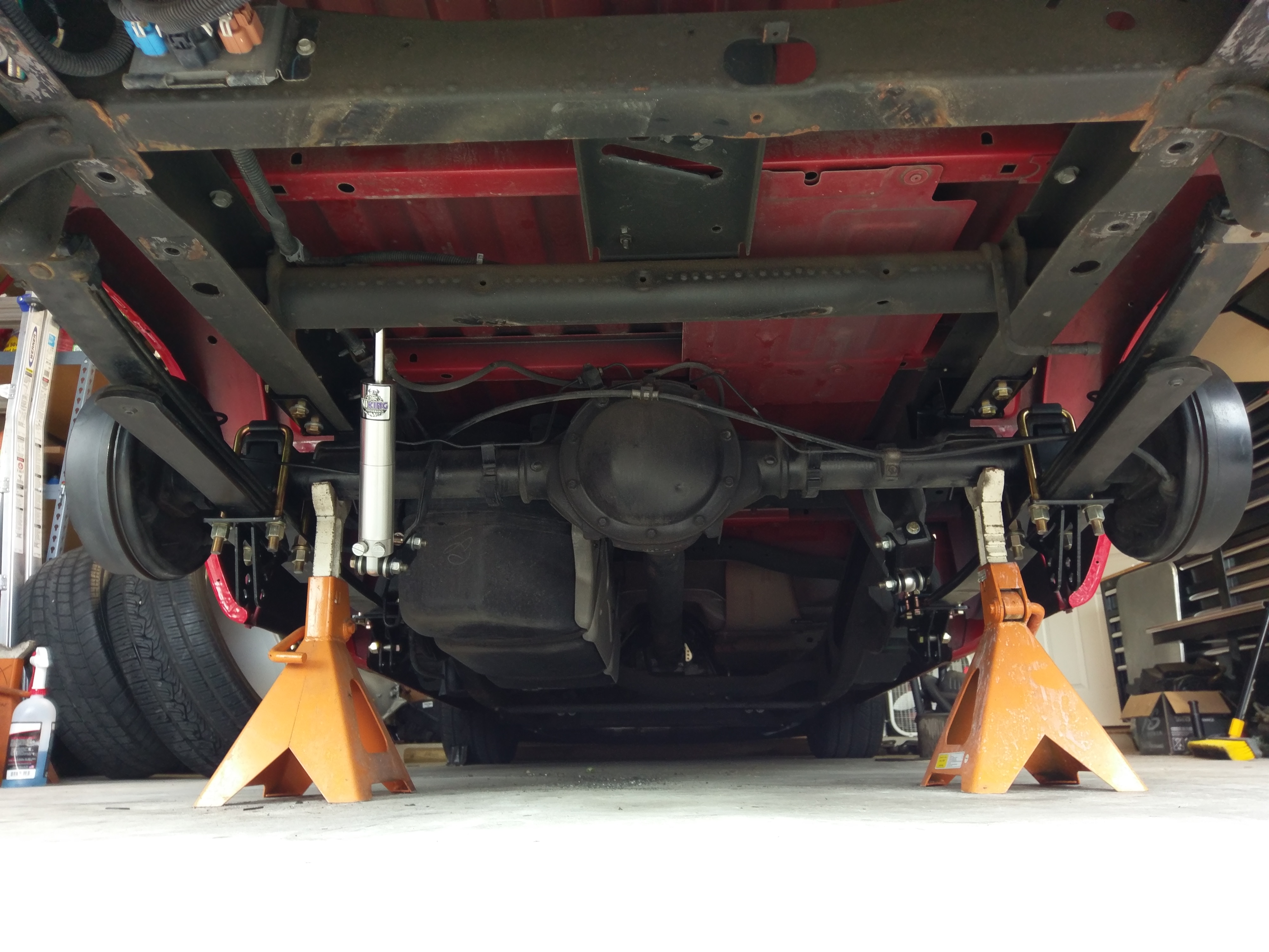

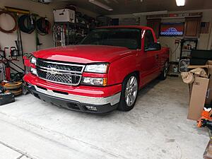

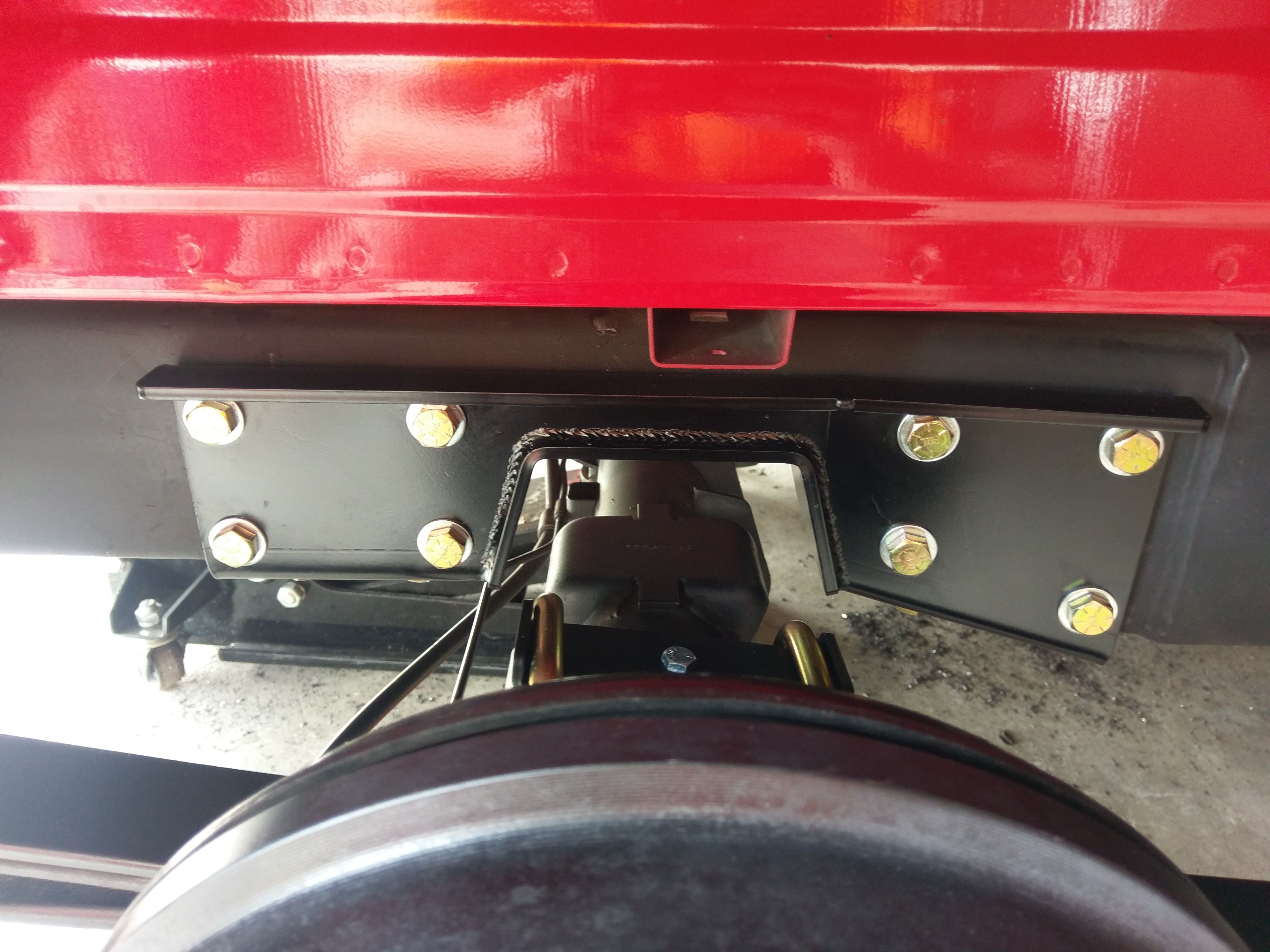

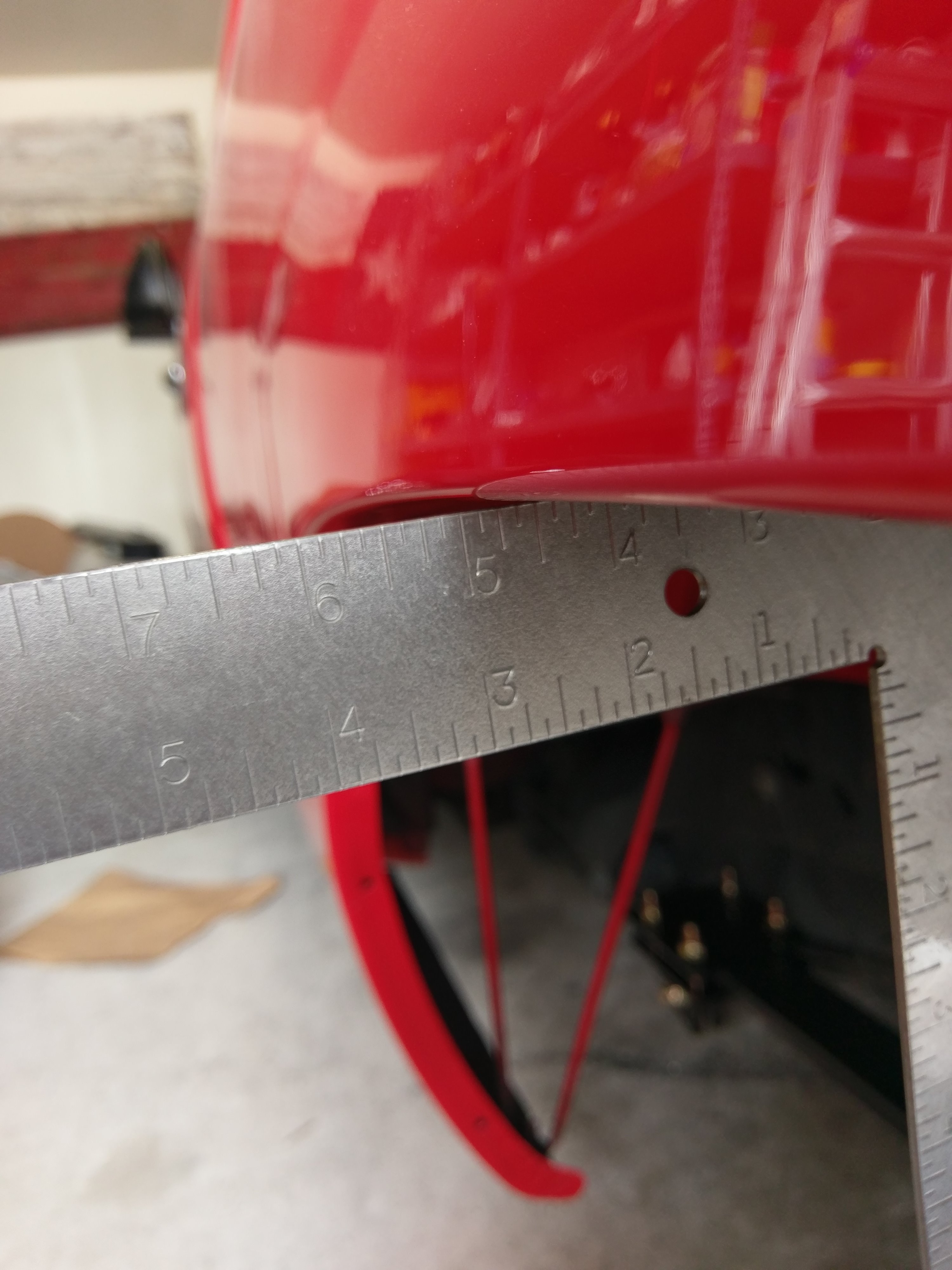

Got the rear finished today, I'm worn out
ILuvJDM's 2007 NBS RCSB Build - Turbo/4L80e/Coilovers/Wilwoods-gbnskgd.jpg
ILuvJDM's 2007 NBS RCSB Build - Turbo/4L80e/Coilovers/Wilwoods-ulym7fg.jpg
ILuvJDM's 2007 NBS RCSB Build - Turbo/4L80e/Coilovers/Wilwoods-p1r6mfx.jpg

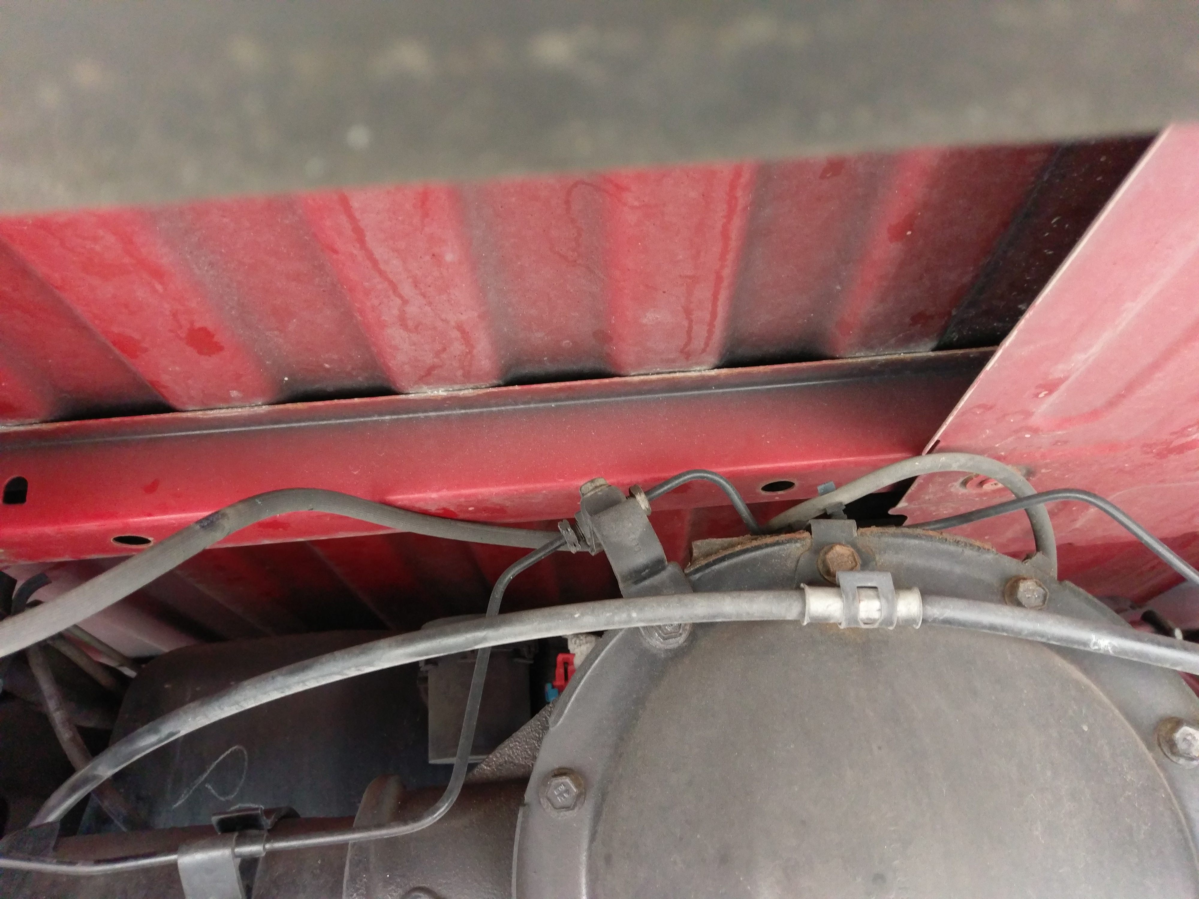

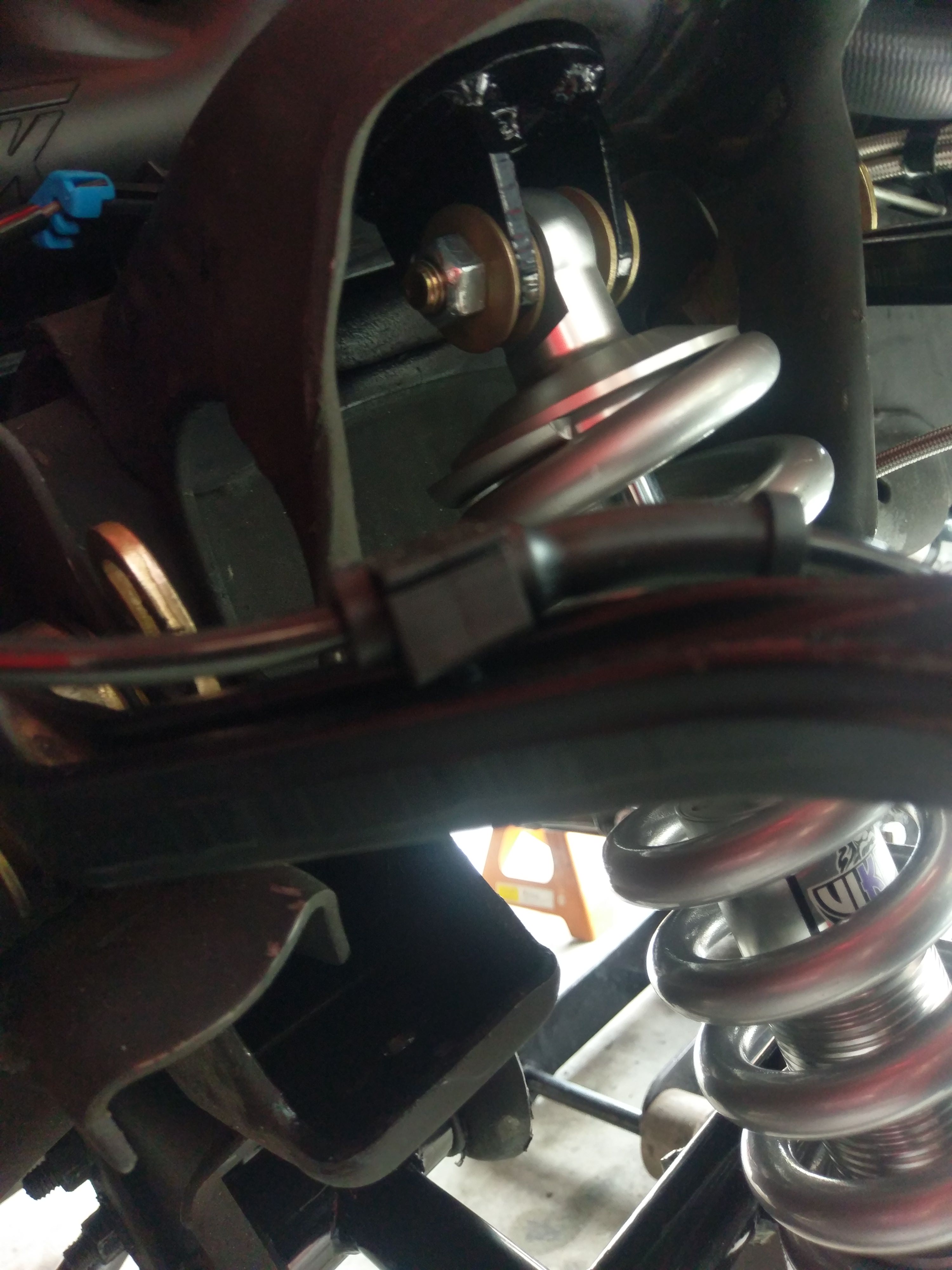

Added some protection to the brake line that goes over the notch
ILuvJDM's 2007 NBS RCSB Build - Turbo/4L80e/Coilovers/Wilwoods-mwvhep5.jpg
Rubbing the brake line on the bottom of the bed, but I have a stainless line to replace it and hopefully route it better
ILuvJDM's 2007 NBS RCSB Build - Turbo/4L80e/Coilovers/Wilwoods-flshyhy.jpg

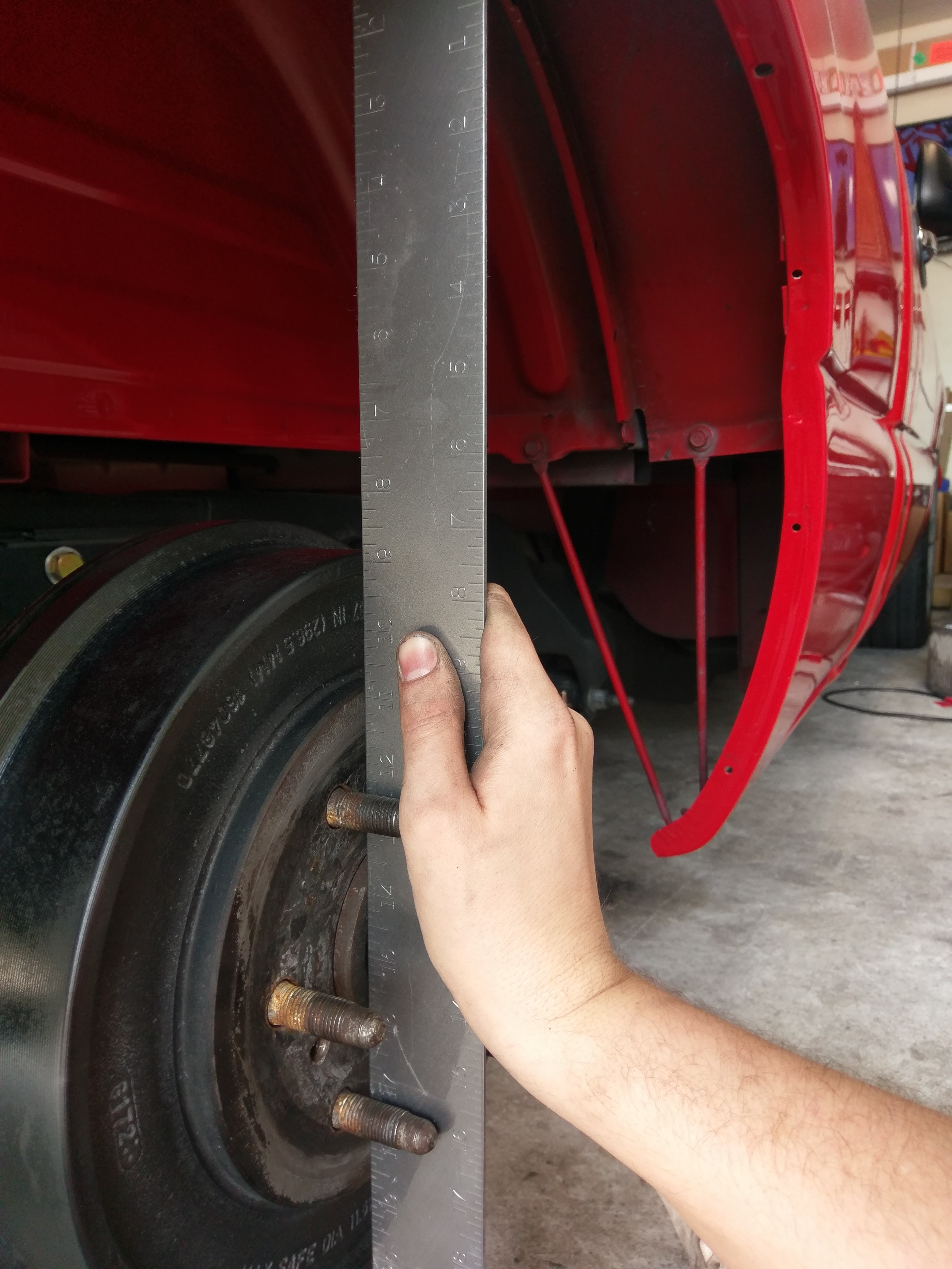

I moved the axle over as far as possible. I got them even at full droop of the axle, but once you put the weight on the axle, it kicks over 1/2"
ILuvJDM's 2007 NBS RCSB Build - Turbo/4L80e/Coilovers/Wilwoods-xdait9z.jpg
ILuvJDM's 2007 NBS RCSB Build - Turbo/4L80e/Coilovers/Wilwoods-rpc6vl1.jpg
ILuvJDM's 2007 NBS RCSB Build - Turbo/4L80e/Coilovers/Wilwoods-sjo5bez.jpg

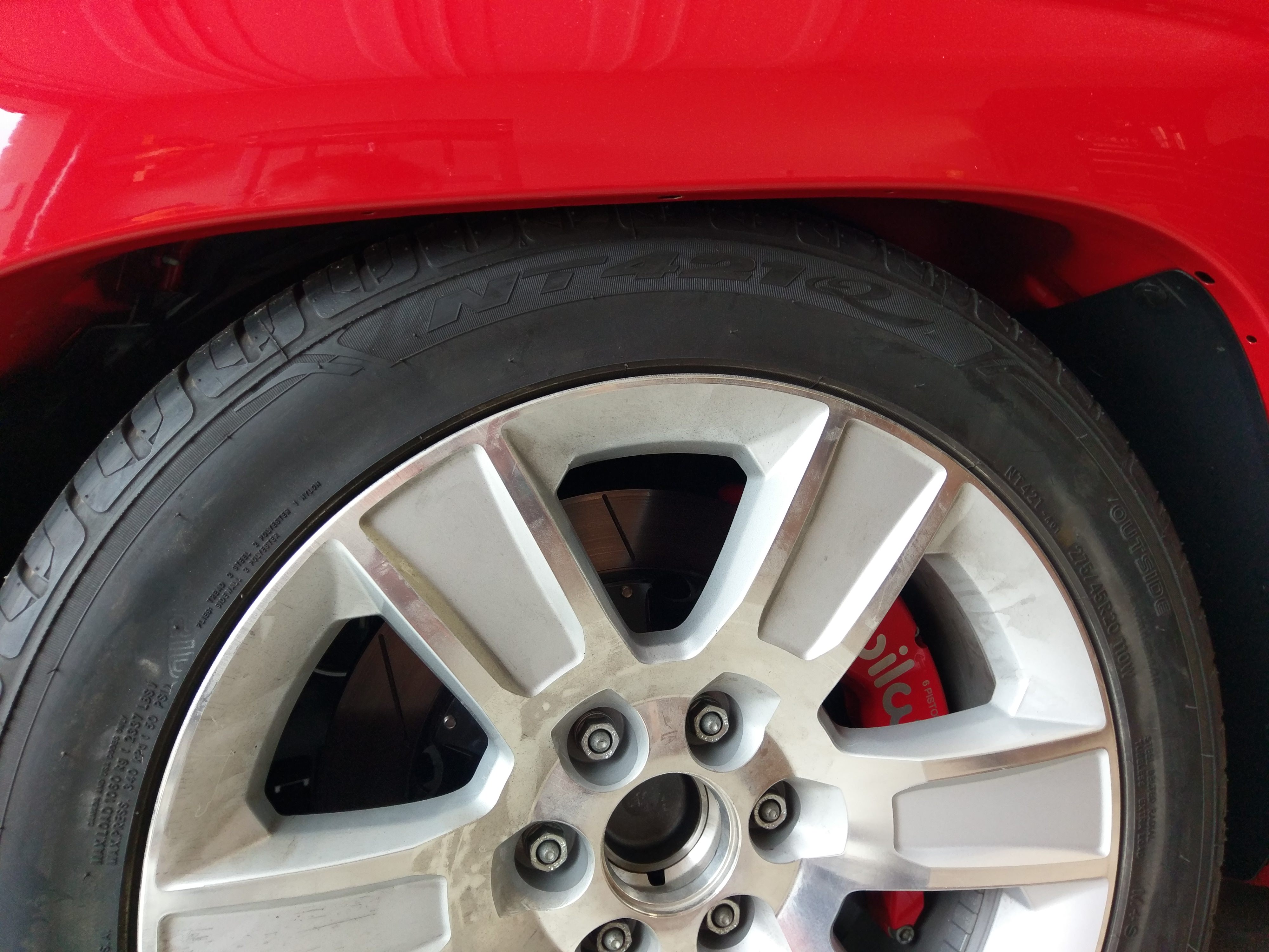

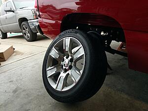

Cleaned up the wheels before installing them
ILuvJDM's 2007 NBS RCSB Build - Turbo/4L80e/Coilovers/Wilwoods-iremhxv.jpg
Then turned the truck around again to finish the last few items on my list before being able to drive it
ILuvJDM's 2007 NBS RCSB Build - Turbo/4L80e/Coilovers/Wilwoods-mnbqlow.jpg
Still settling
ILuvJDM's 2007 NBS RCSB Build - Turbo/4L80e/Coilovers/Wilwoods-v4e68vu.jpg

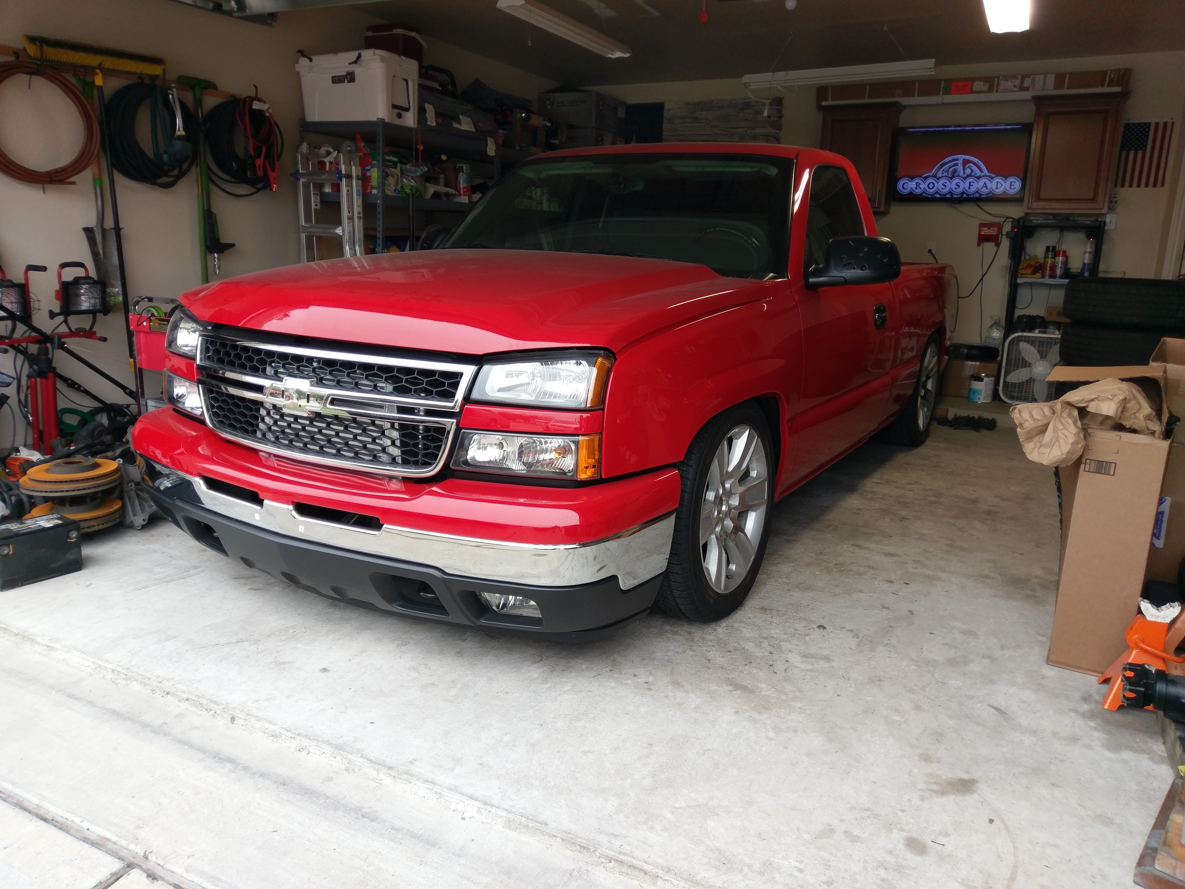

thanks, I'm not too sure on the drop, but the truck is lower than I want in the front right now. I'm shooting for 15.0" front height which is around 4.5" front drop. I try to keep the fender gap the same front to back

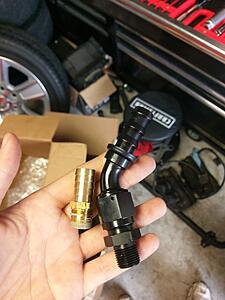

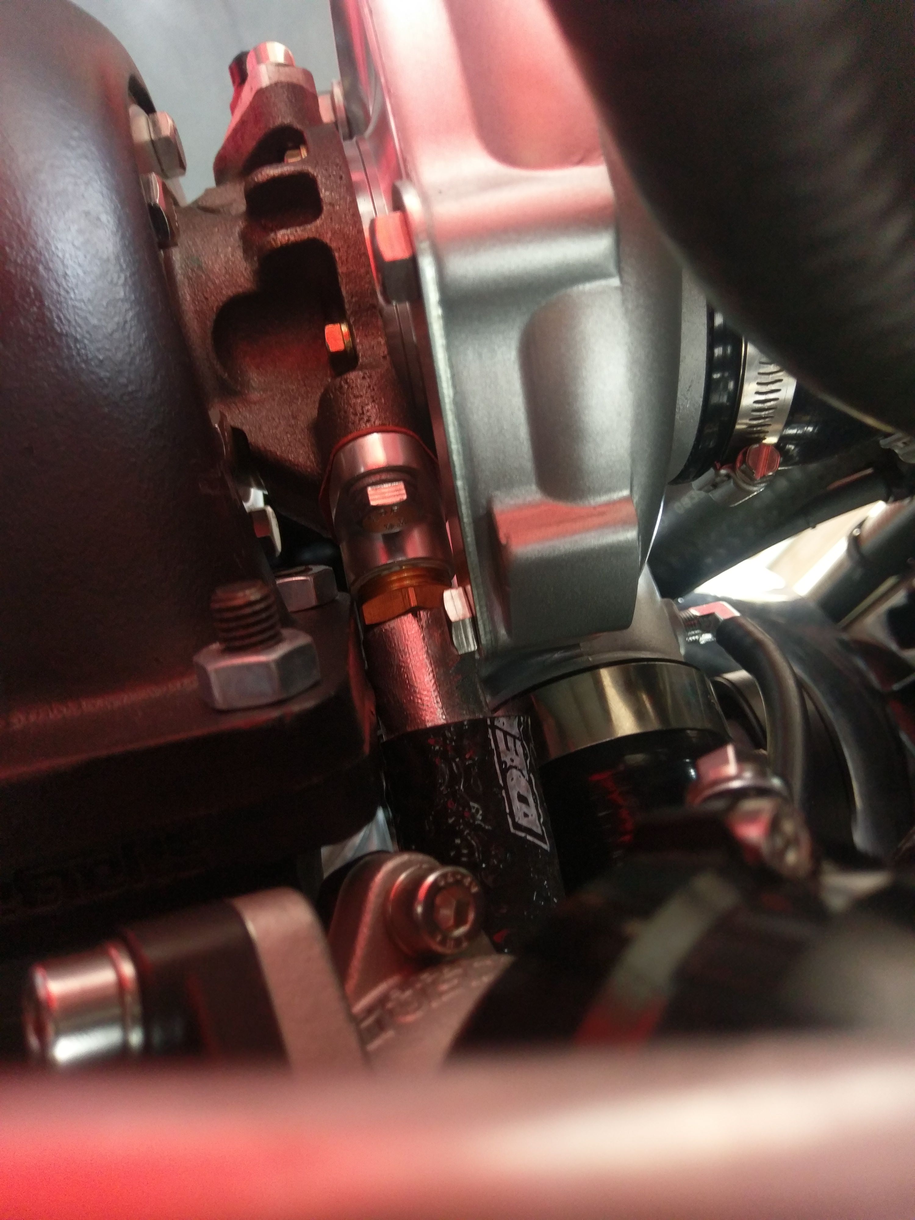

Got some of the small, final items done today, which are the hardest things on a project

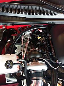

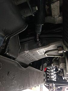

Brass fitting that came with the kit vs the aeroquip pushlock fitting. Went with a 45 angle to -10AN and then a -10AN to 3/8npt so I could reuse the hole I already tapped
ILuvJDM's 2007 NBS RCSB Build - Turbo/4L80e/Coilovers/Wilwoods-4bz1oud.jpg
ILuvJDM's 2007 NBS RCSB Build - Turbo/4L80e/Coilovers/Wilwoods-x4wnmsy.jpg
It was too hard to get to the bolts for the drain fitting, so I just left this one alone. It's a vertical fitting on a gravity drain, so I don't see that barb fitting ever leaking...
ILuvJDM's 2007 NBS RCSB Build - Turbo/4L80e/Coilovers/Wilwoods-ibgymha.jpg

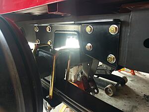

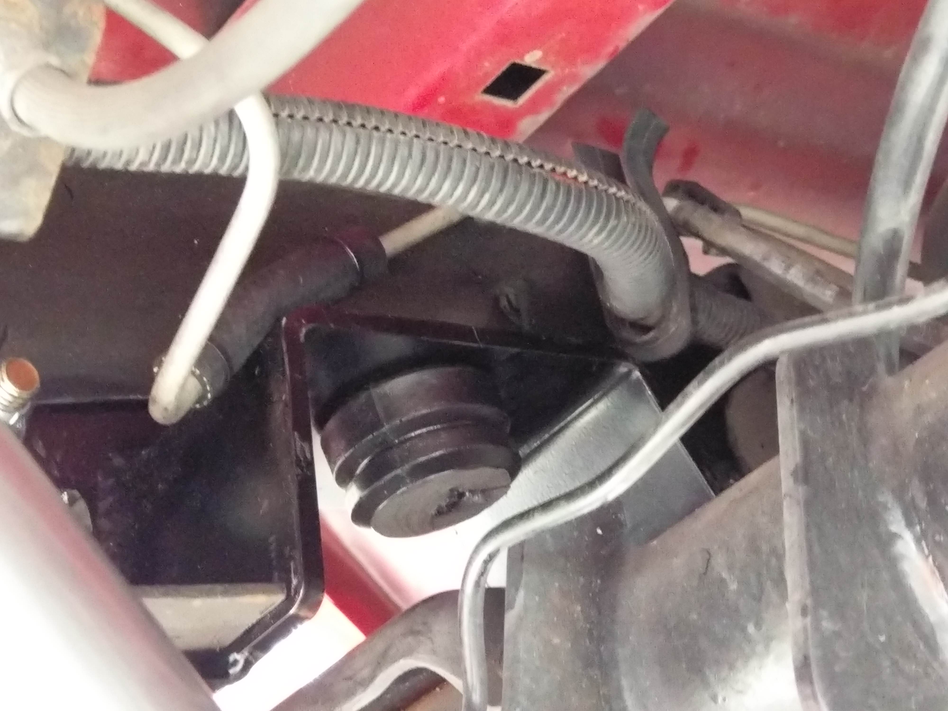

Added some locking nuts to my coilover mounts. They were leftover from my c-notch hardware
ILuvJDM's 2007 NBS RCSB Build - Turbo/4L80e/Coilovers/Wilwoods-ylzfrz8.jpg

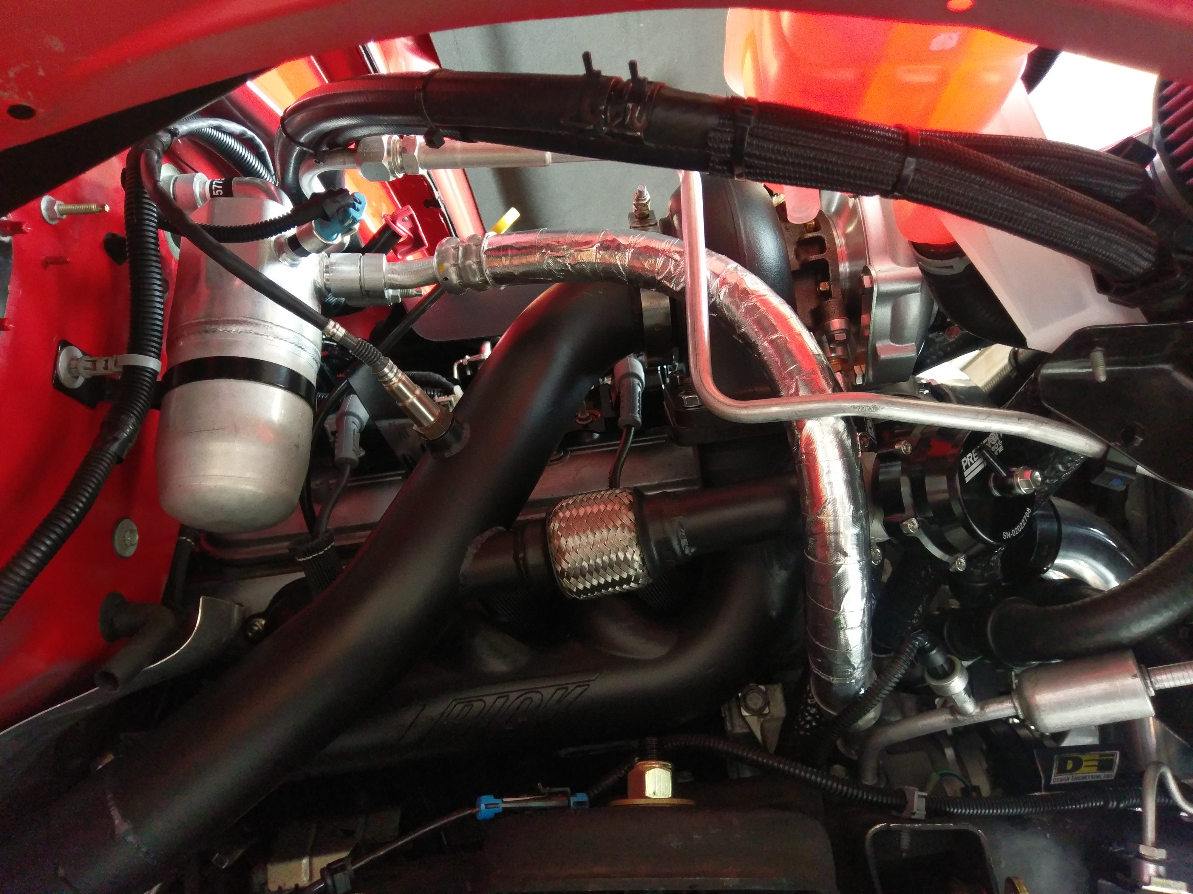

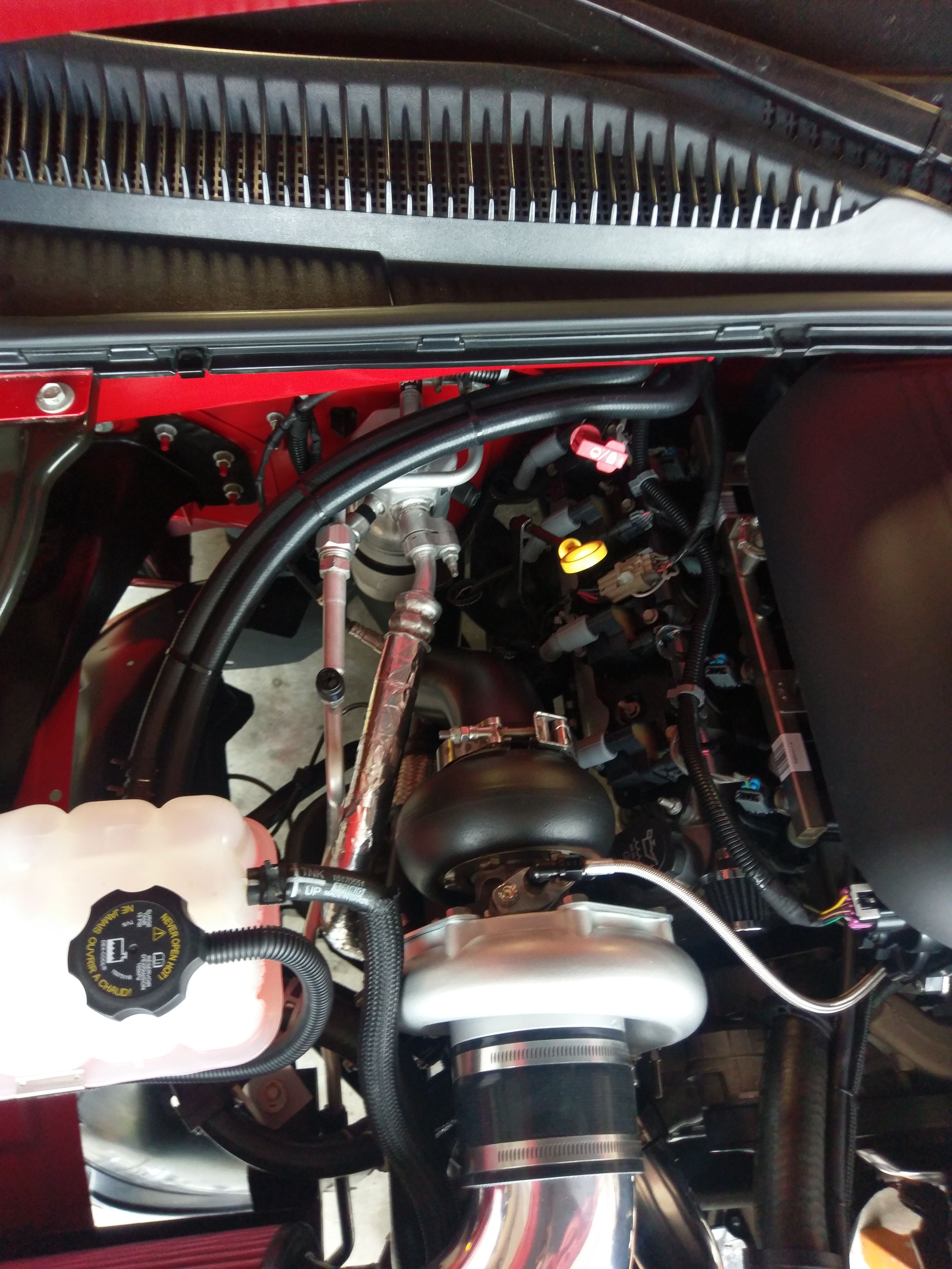

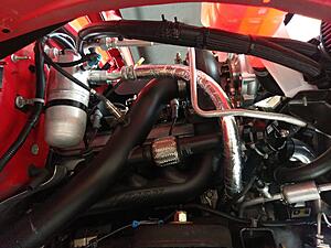

I bought some super expensive fire sleeve for the AC line, but it doesn't fit the curves of the line, so that was a waste of $80. Decided to just use DEI cool tape. Not too happy with the look, but it should keep the line from bursting
ILuvJDM's 2007 NBS RCSB Build - Turbo/4L80e/Coilovers/Wilwoods-rh6qita.jpg
ILuvJDM's 2007 NBS RCSB Build - Turbo/4L80e/Coilovers/Wilwoods-yojqsb3.jpg
Also got both fender liners installed, tightened the clamp for the crossover where there was a small exhaust leak, added the safety washers for the heim tie rod ends, adjusted the ride height of the coilovers, cleaned the front wheels and torqued them down.
