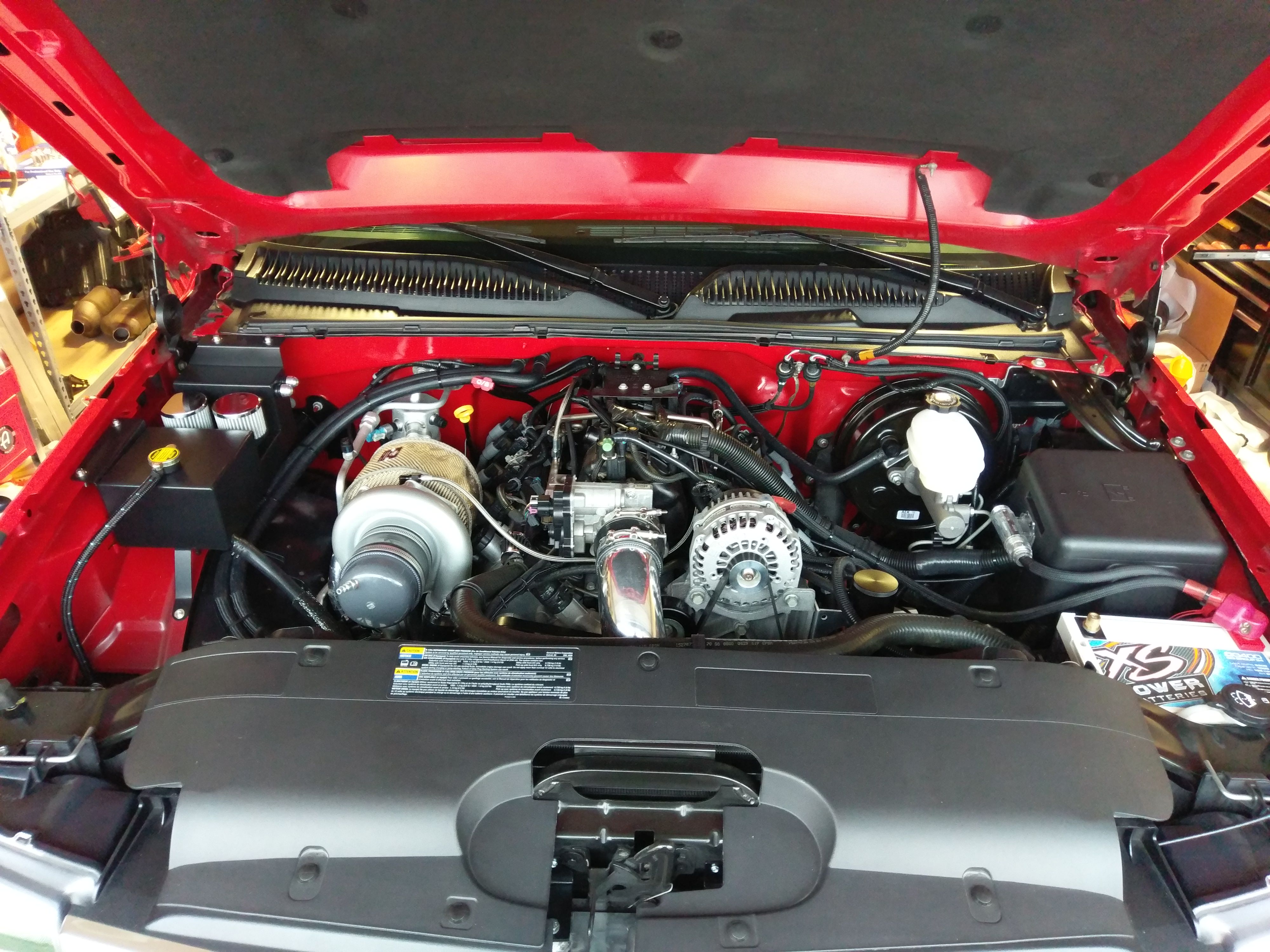

Since I had a new ACDelco master cylinder on my parts shelf, I figured I would put it on
ILuvJDM's 2007 NBS RCSB Build - Turbo/4L80e/Coilovers/Wilwoods-3skzxu7.jpg
Any bets on if that was the original fluid from 2007?
ILuvJDM's 2007 NBS RCSB Build - Turbo/4L80e/Coilovers/Wilwoods-dg3fupi.jpg
Bench bleeding new one. Is it normal for the plunger to only go in like 1/8"? The instructions said 3/4"-1" but I put all 235lbs into it and it wouldnt go any further... Bubbles came out for a while and eventually it was perfect fluid with no bubbles, so I'm sure it's fine
ILuvJDM's 2007 NBS RCSB Build - Turbo/4L80e/Coilovers/Wilwoods-57j1rzm.jpg
Installed
ILuvJDM's 2007 NBS RCSB Build - Turbo/4L80e/Coilovers/Wilwoods-da0l0ep.jpg
Front suspension is done, just need to bleed the brakes and do an alignment then bolt up the coilovers. Good news is the measurement for ride height only went from 11.75" to 12.0" at my ride height, so the c205 shocks will still work perfect
ILuvJDM's 2007 NBS RCSB Build - Turbo/4L80e/Coilovers/Wilwoods-6pss6dt.jpg
ILuvJDM's 2007 NBS RCSB Build - Turbo/4L80e/Coilovers/Wilwoods-yshngcy.jpg
