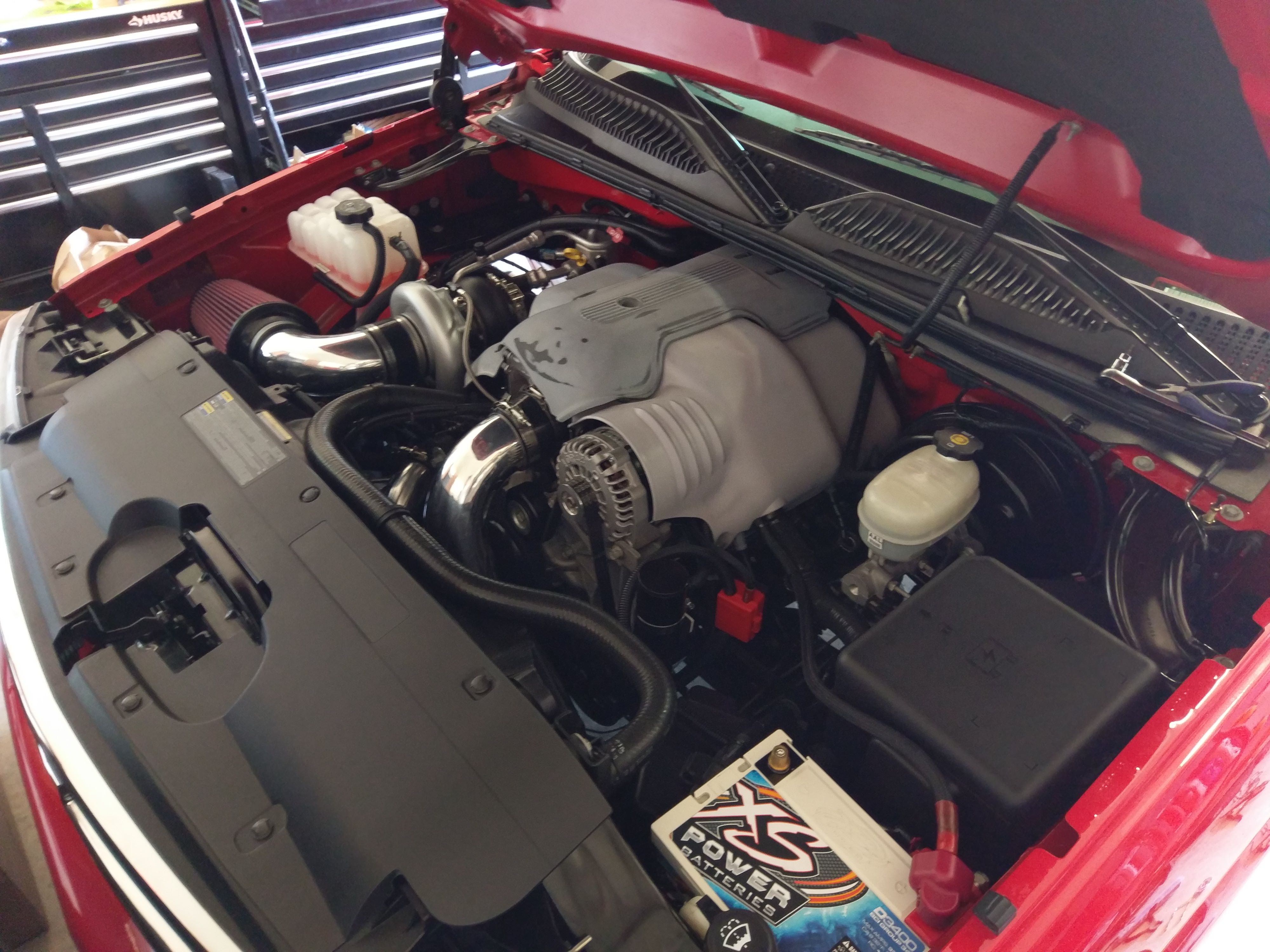

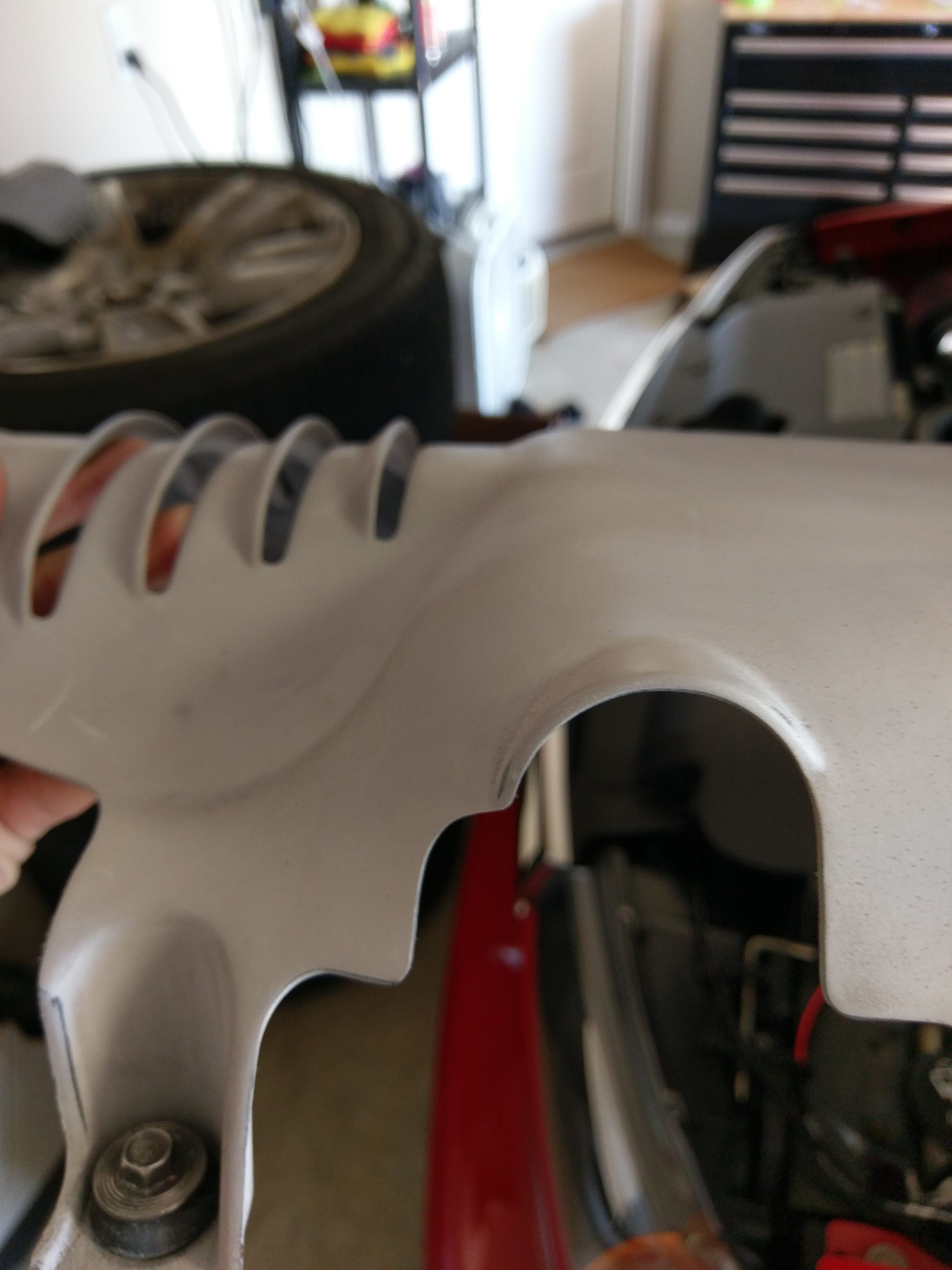

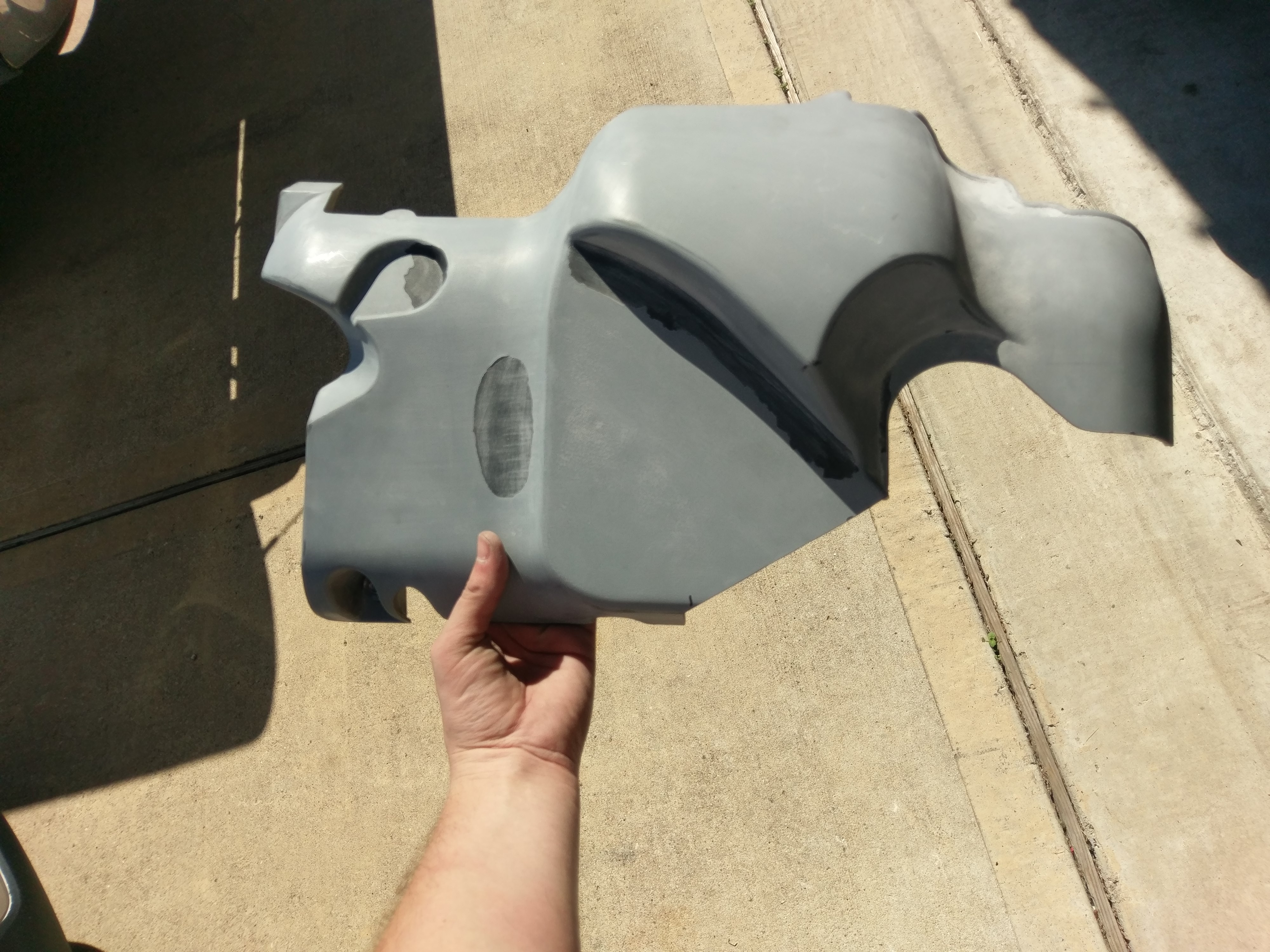

Finally tackled the three piece engine covers. Had to modify the drivers side to fit the 0ga power wire coming off the alternator
ILuvJDM's 2007 NBS RCSB Build - Turbo/4L80e/Coilovers/Wilwoods-punlqco.jpg
Just added a nice smooth opening using a dremel, looks like the factory openings
ILuvJDM's 2007 NBS RCSB Build - Turbo/4L80e/Coilovers/Wilwoods-mxxux4o.jpg

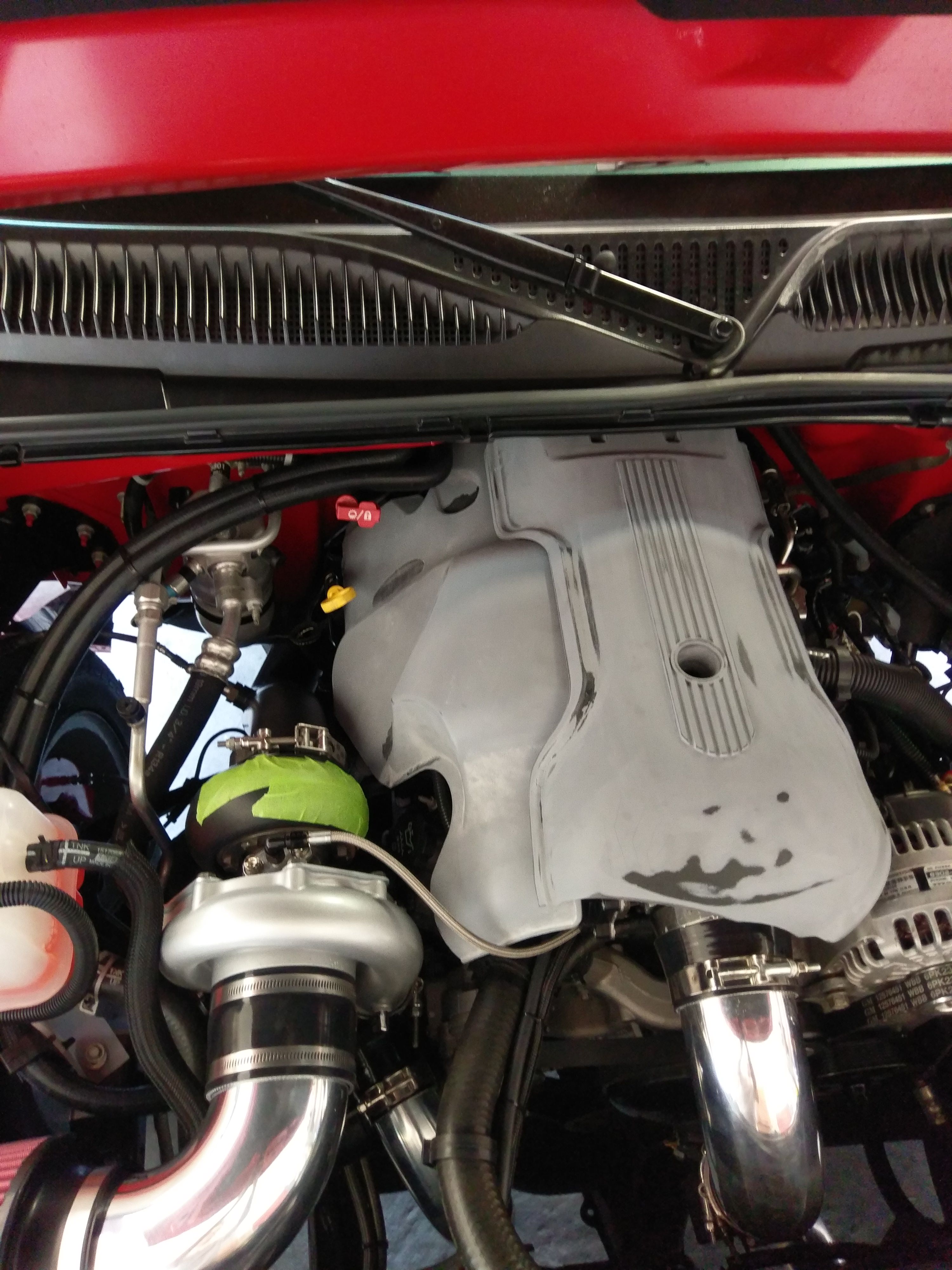

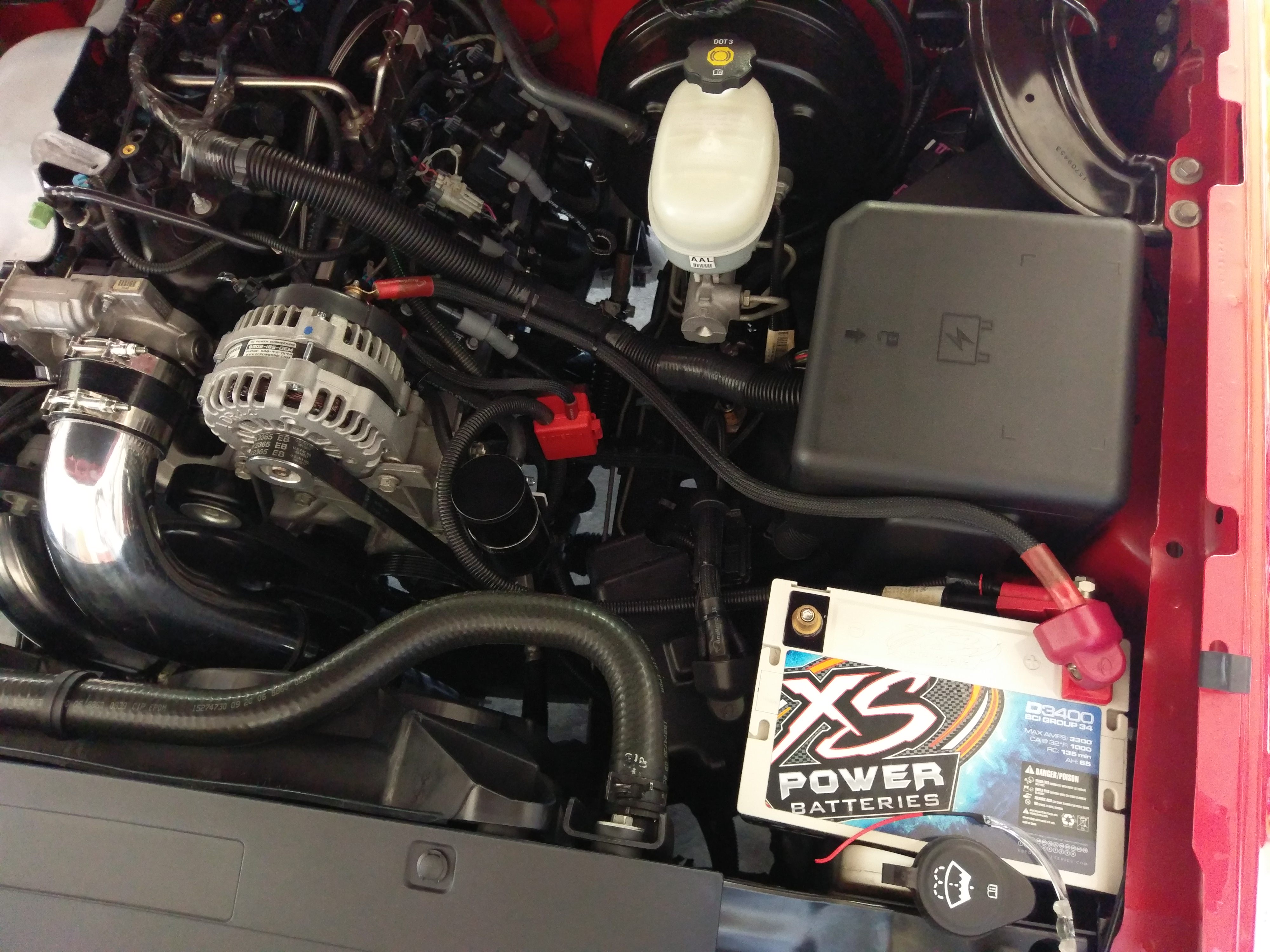

What I had to do to the passenger side to clear the turbo
ILuvJDM's 2007 NBS RCSB Build - Turbo/4L80e/Coilovers/Wilwoods-14zzfvx.jpg
ILuvJDM's 2007 NBS RCSB Build - Turbo/4L80e/Coilovers/Wilwoods-113yqnc.jpg
Just need to bodywork and paint with the 2k satin black I got
ILuvJDM's 2007 NBS RCSB Build - Turbo/4L80e/Coilovers/Wilwoods-wrrnhgj.jpg
ILuvJDM's 2007 NBS RCSB Build - Turbo/4L80e/Coilovers/Wilwoods-z8xlspa.jpg

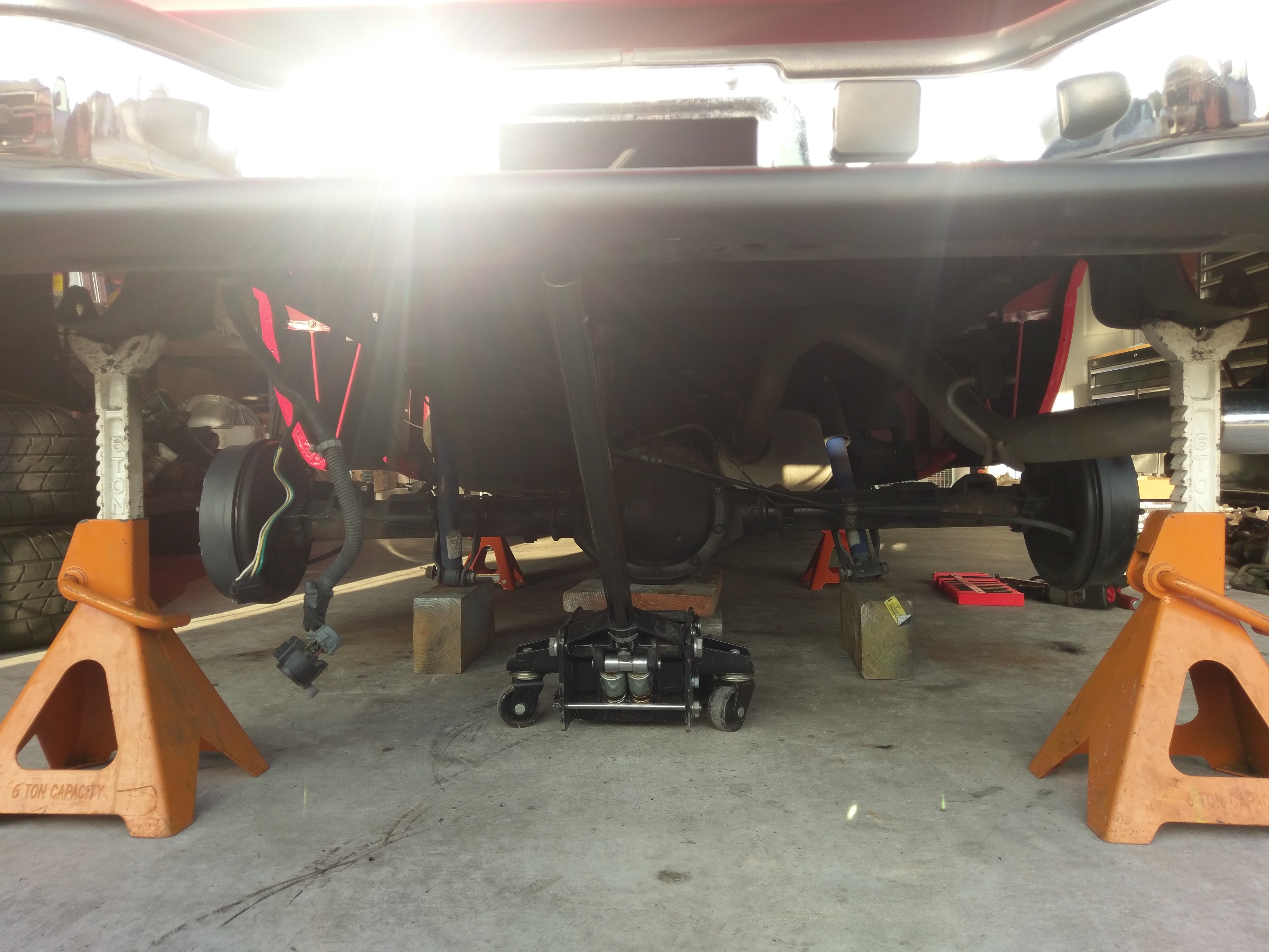

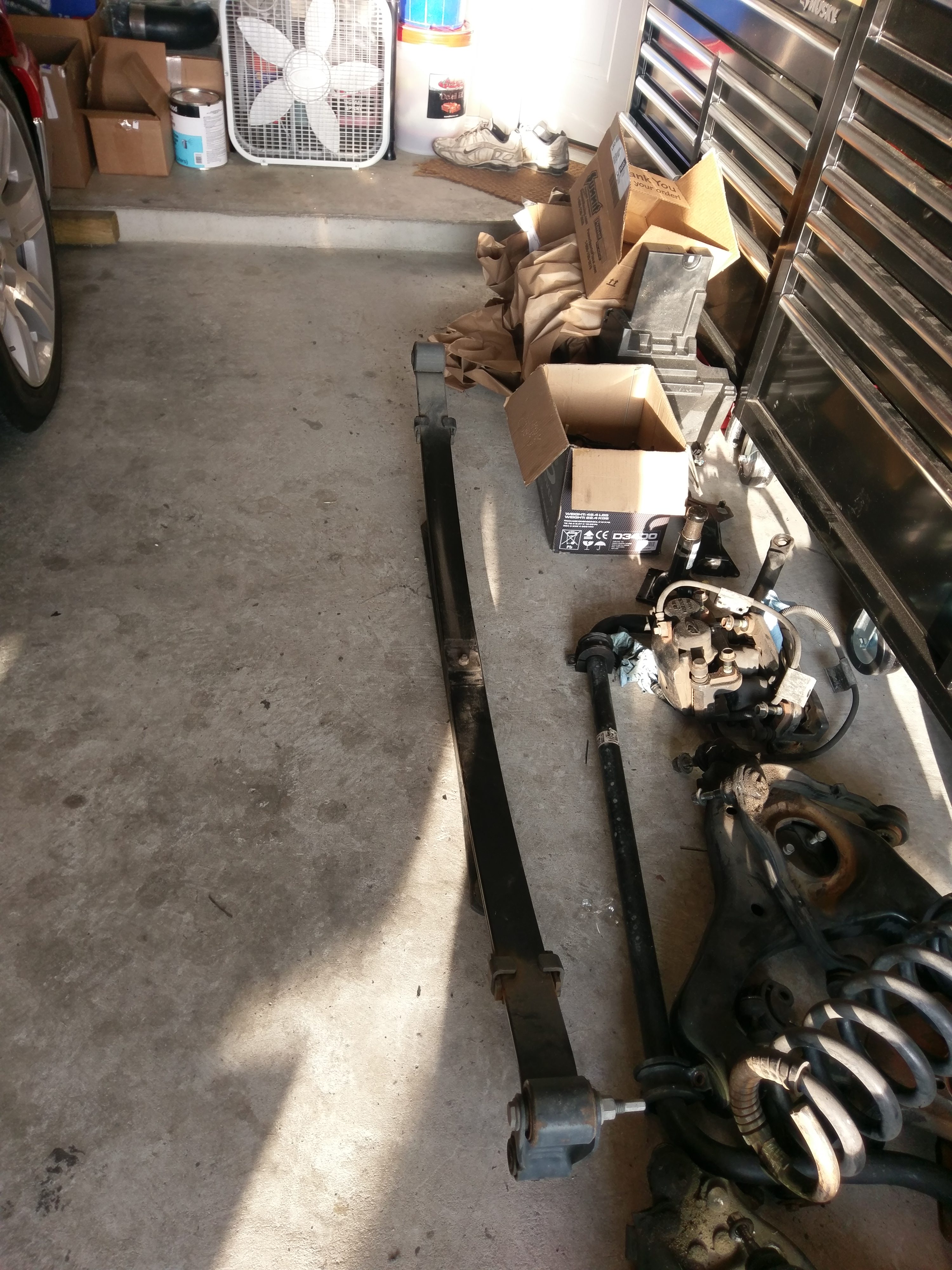

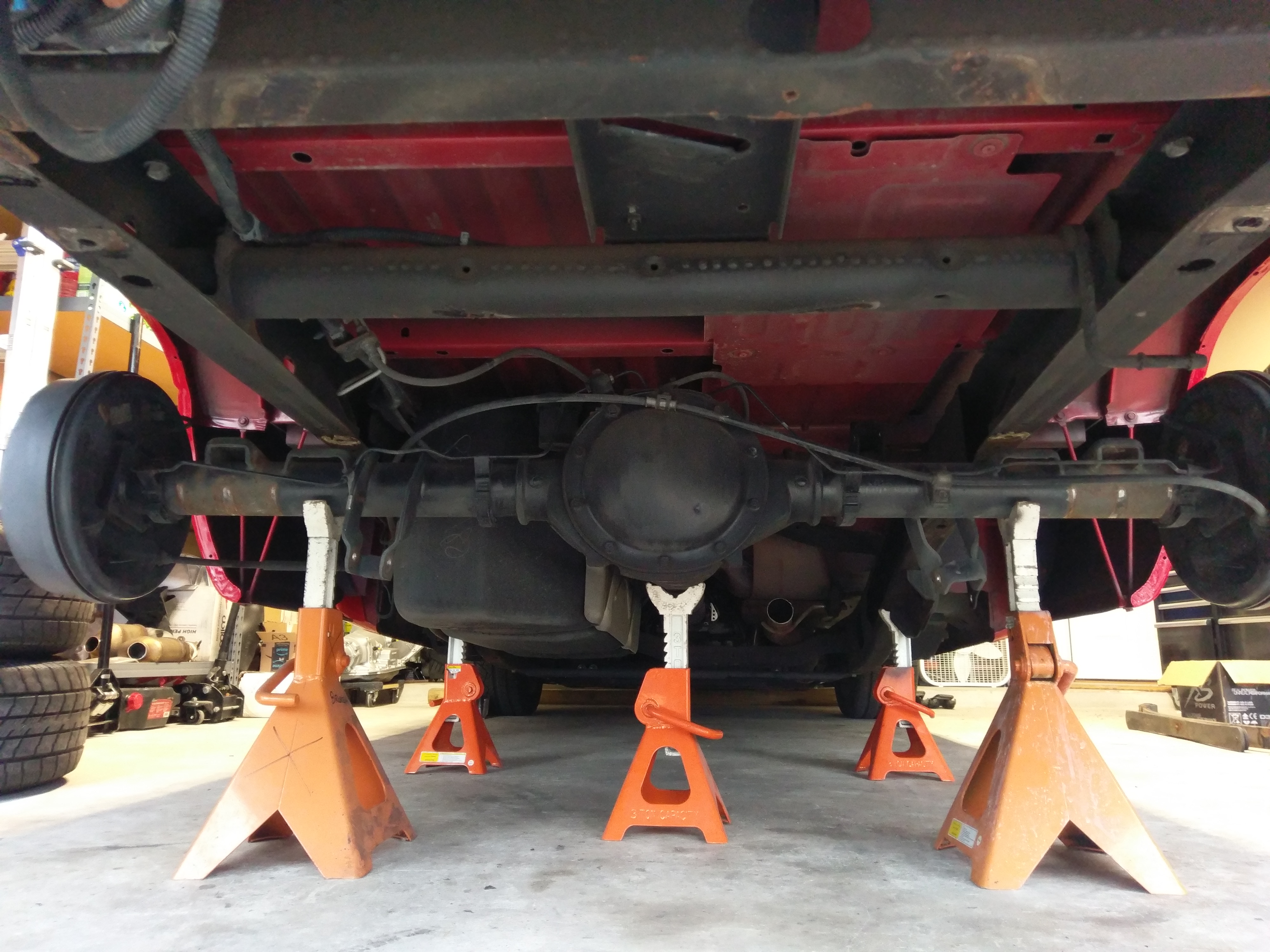

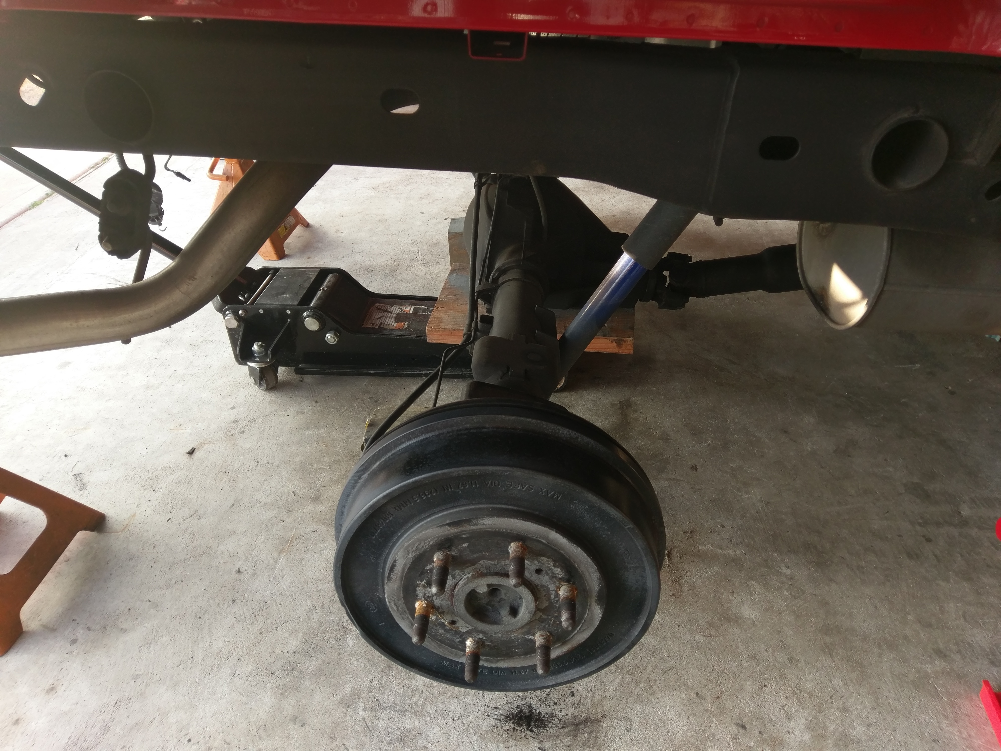

Got the rear disassmbled yesterday after work. Removed the spare tire and hitch. I noticed the drivers side front leaf bolt was already replaced with a shorter bolt, so I was able to easily drop both springs
ILuvJDM's 2007 NBS RCSB Build - Turbo/4L80e/Coilovers/Wilwoods-dkxokua.jpg
ILuvJDM's 2007 NBS RCSB Build - Turbo/4L80e/Coilovers/Wilwoods-w5txsx0.jpg
ILuvJDM's 2007 NBS RCSB Build - Turbo/4L80e/Coilovers/Wilwoods-ivjxucl.jpg
ILuvJDM's 2007 NBS RCSB Build - Turbo/4L80e/Coilovers/Wilwoods-ua7jjdz.jpg
Since both leafs are out, I went ahead and ordered some energy suspension poly bushings and brand new u-bolts. I'll do some cleanup and paint on the springs while they're out and also prep them for the traction bars but cutting overload and the front clamp

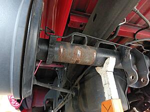

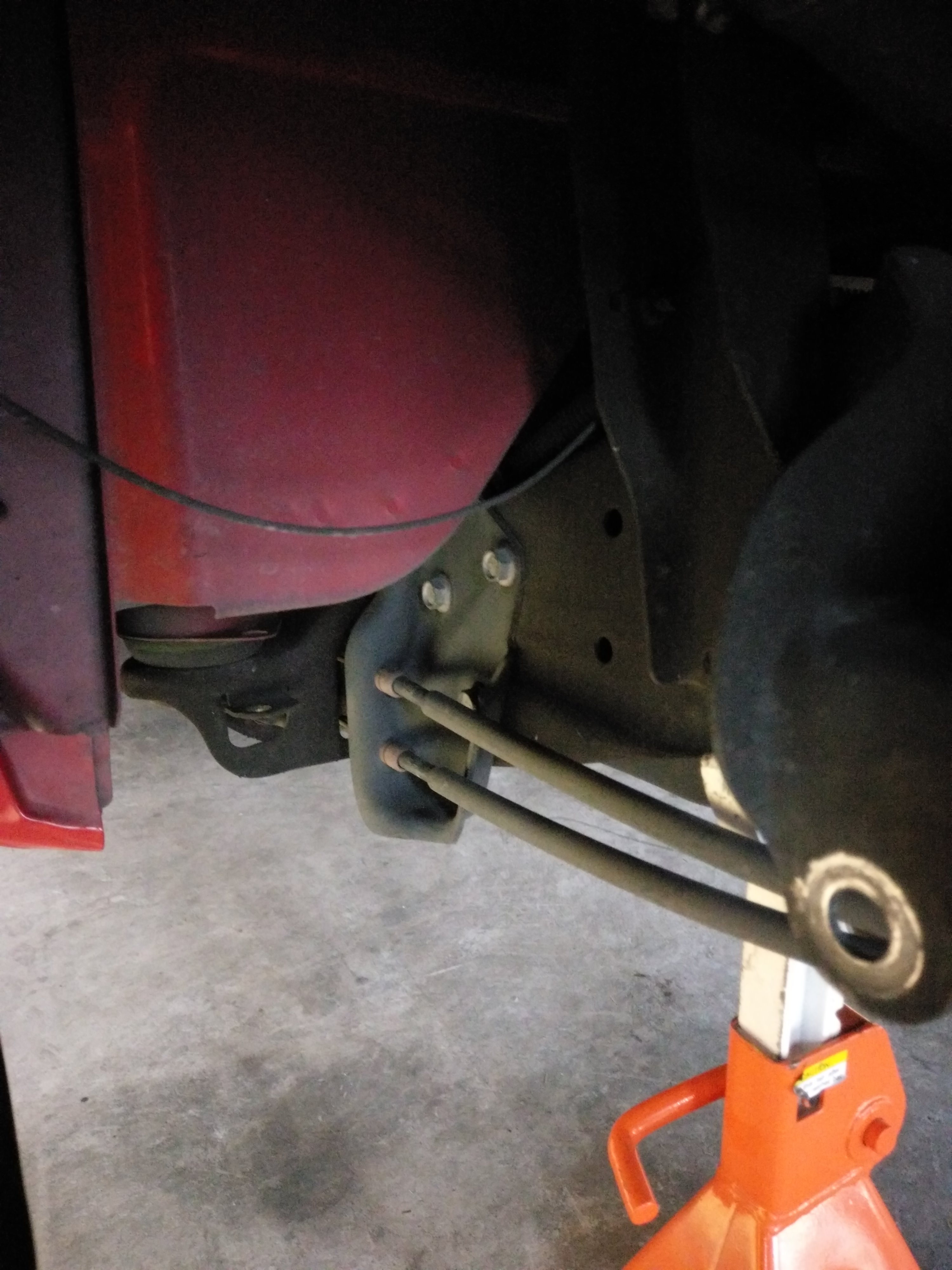

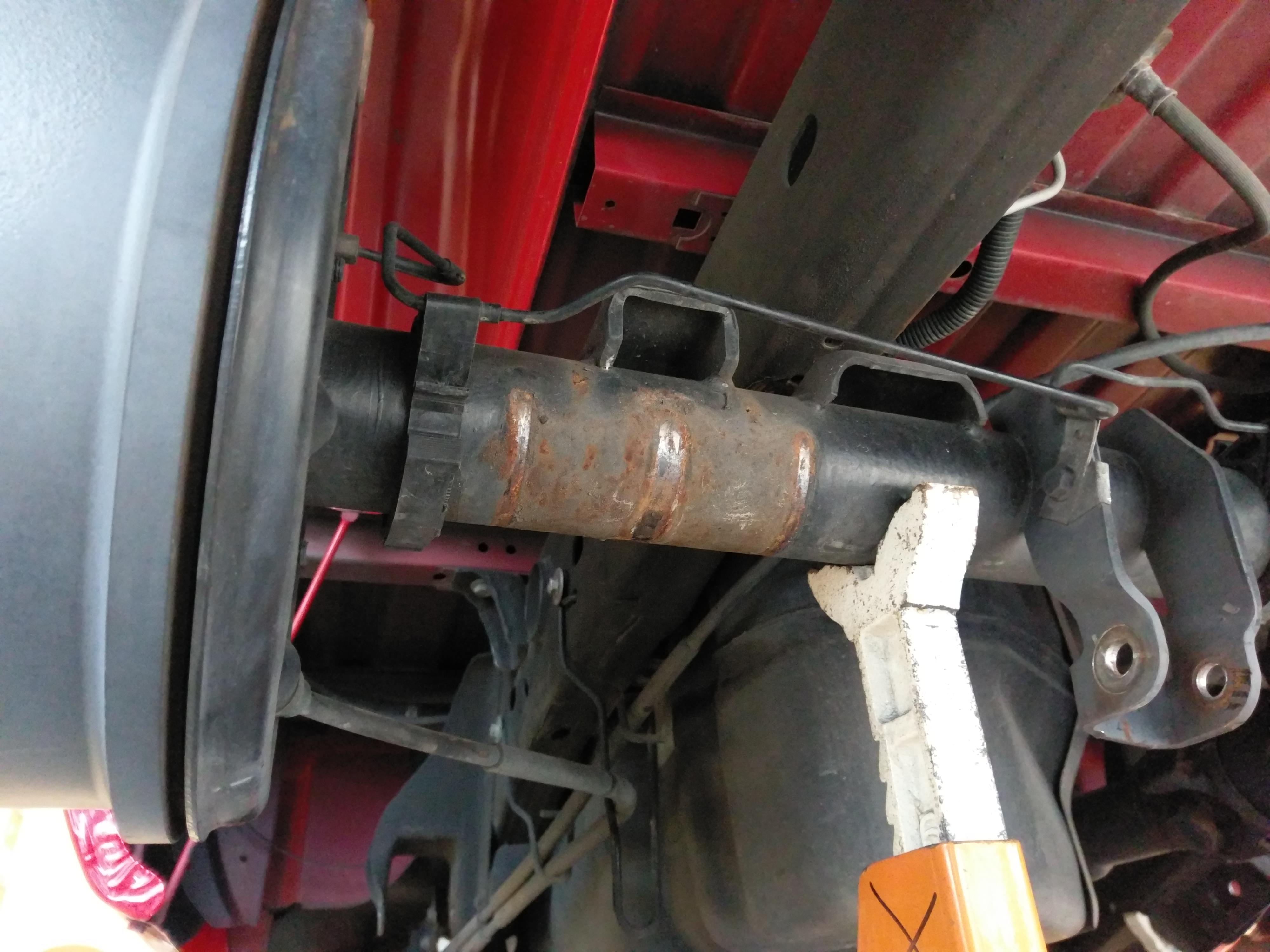

I was looking at the truck and trying to decide what the previous owner might have done to it. Check these out and let me know what you think it could be from?
Three marks on axle. I was thinking flip kit, but it would be two marks, right?
ILuvJDM's 2007 NBS RCSB Build - Turbo/4L80e/Coilovers/Wilwoods-tcvyggv.jpg
ILuvJDM's 2007 NBS RCSB Build - Turbo/4L80e/Coilovers/Wilwoods-svwsxia.jpg
ILuvJDM's 2007 NBS RCSB Build - Turbo/4L80e/Coilovers/Wilwoods-zpmm1rr.jpg

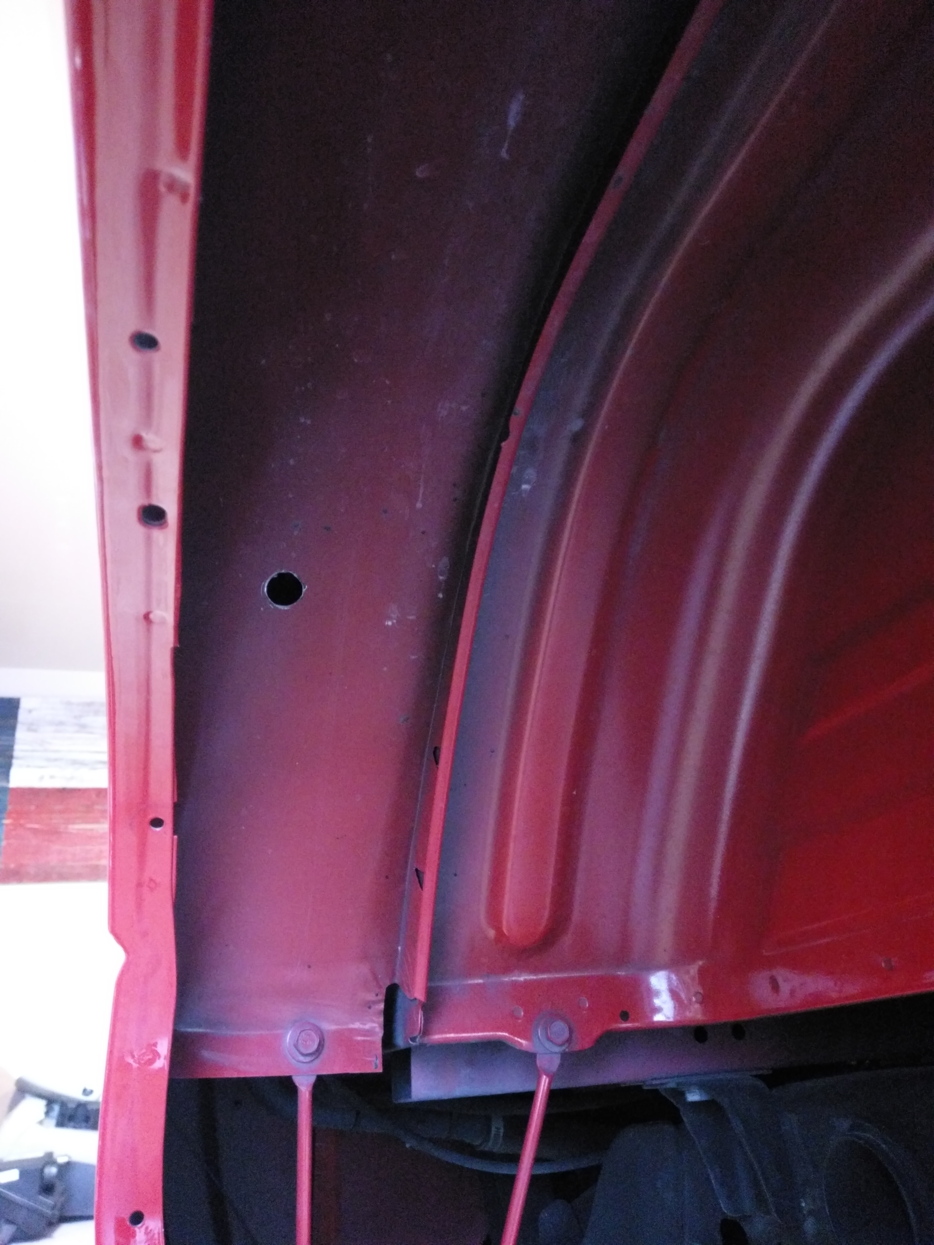

Odd hole drilled in rear fender looking towards front of truck in picture
ILuvJDM's 2007 NBS RCSB Build - Turbo/4L80e/Coilovers/Wilwoods-qzxynae.jpg

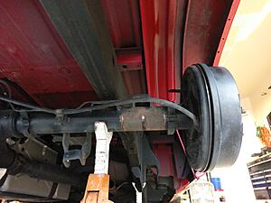

Are the parking brake brackets bolted on from the factory?
ILuvJDM's 2007 NBS RCSB Build - Turbo/4L80e/Coilovers/Wilwoods-4cyynn7.jpg

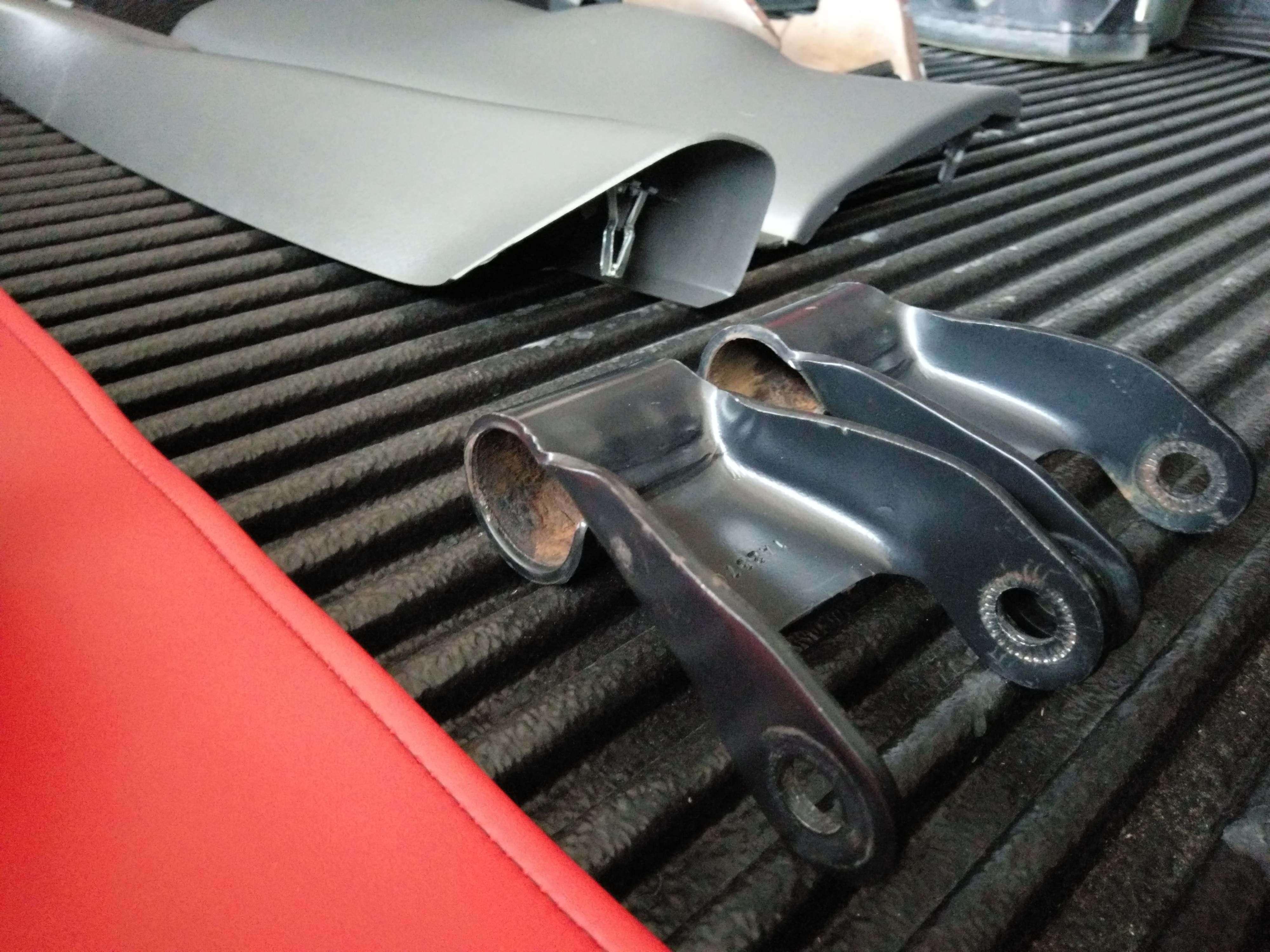

I prepped for my poly bushing install and pressed out the shackle bushings
ILuvJDM's 2007 NBS RCSB Build - Turbo/4L80e/Coilovers/Wilwoods-e5wzdqd.jpg

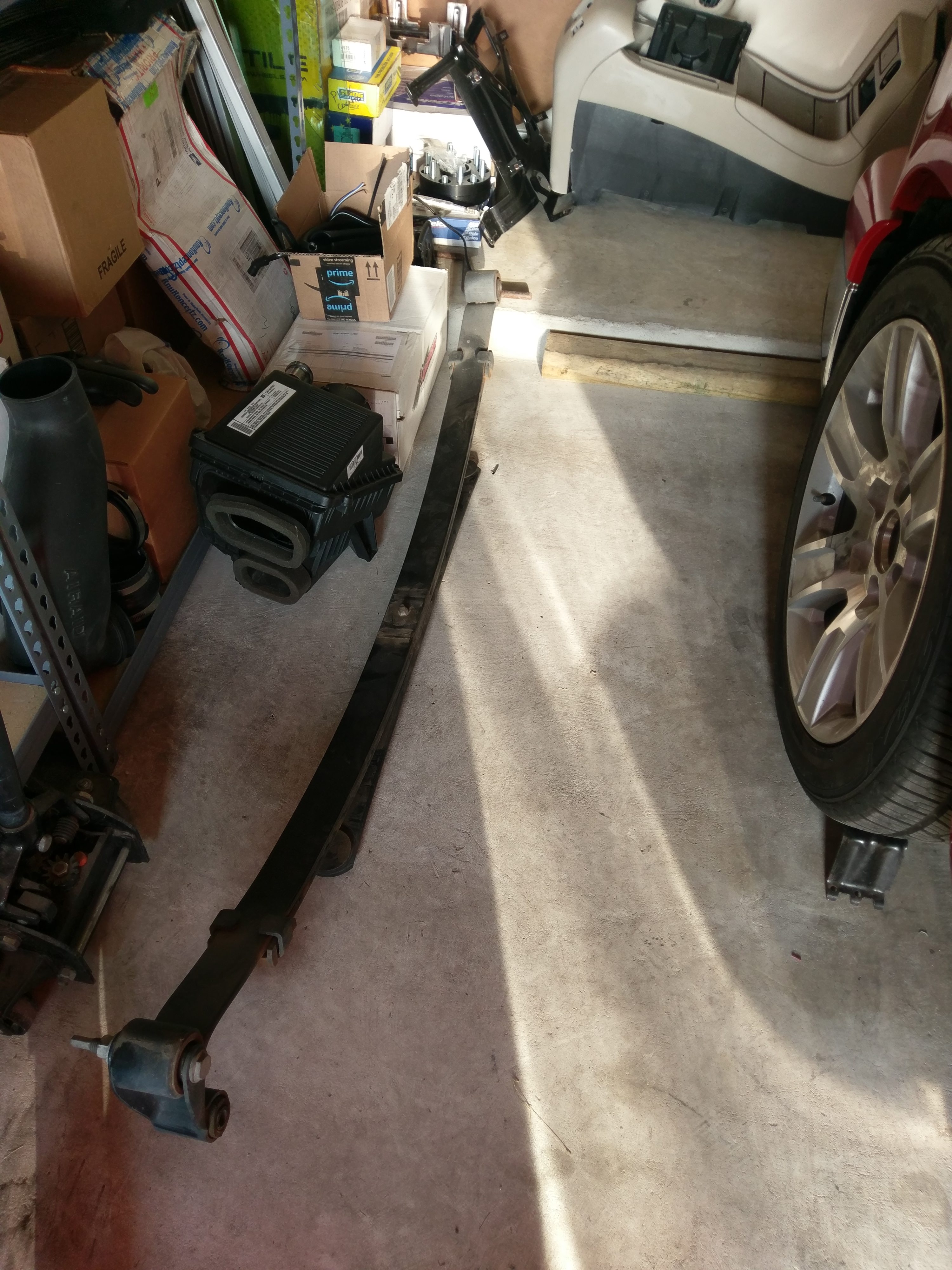

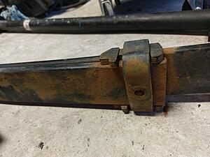

I was going to do the leafe springs, but I was caught off guard by this. The rust had broken the head of the rivet off that holds the clamp tight. Should I use these leafs and just put one of those clamps people use to stop axle wrap on there for safety?
ILuvJDM's 2007 NBS RCSB Build - Turbo/4L80e/Coilovers/Wilwoods-1ttrgyf.jpg

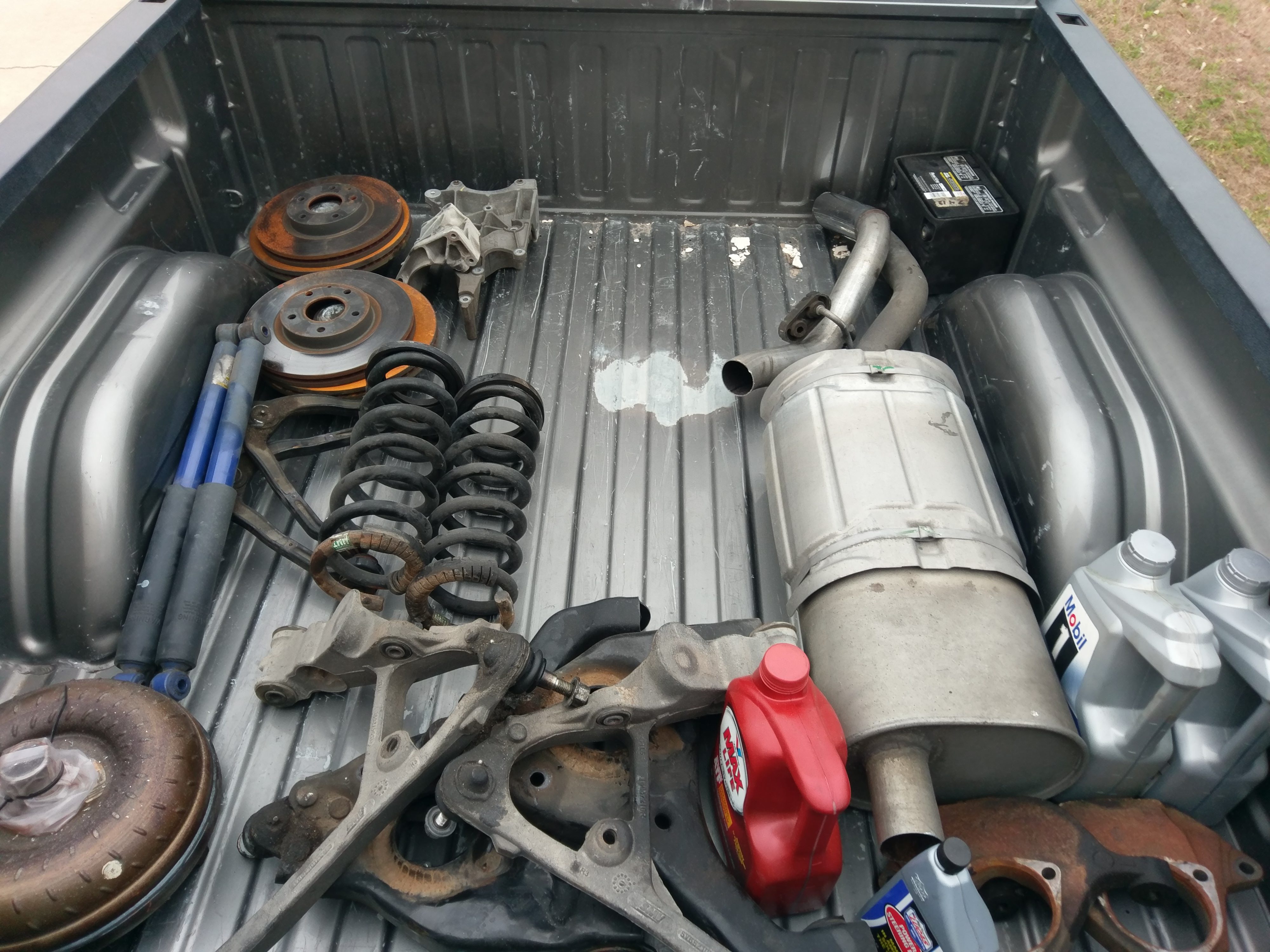

Got tired of having to dance around all this **** in my garage, so it's all going to the dump tomorrow
ILuvJDM's 2007 NBS RCSB Build - Turbo/4L80e/Coilovers/Wilwoods-kzs2pgc.jpg

You should take that stuff to the scrap yard, not the dump!
scrap yard, as in a junkyard? They take parts like that?
Old Feb 8, 2018 | 08:30 PM
  #58
arthursc2's Avatar
Joined: Jan 2014
Posts: 4,341
Likes: 1,517
no man, the metal recycler. Around here we call it the scrap yard. It’s not much, but they will pay you for what you have.
and they will take LCAs as they sit that have balljoints and grease in them? And like the torque converter with tranny fluid in it?
Old Feb 8, 2018 | 09:11 PM
  #60
arthursc2's Avatar
Joined: Jan 2014
Posts: 4,341
Likes: 1,517
yup. Maybe don’t advertise the fluid in it, but they’ll take it all!
