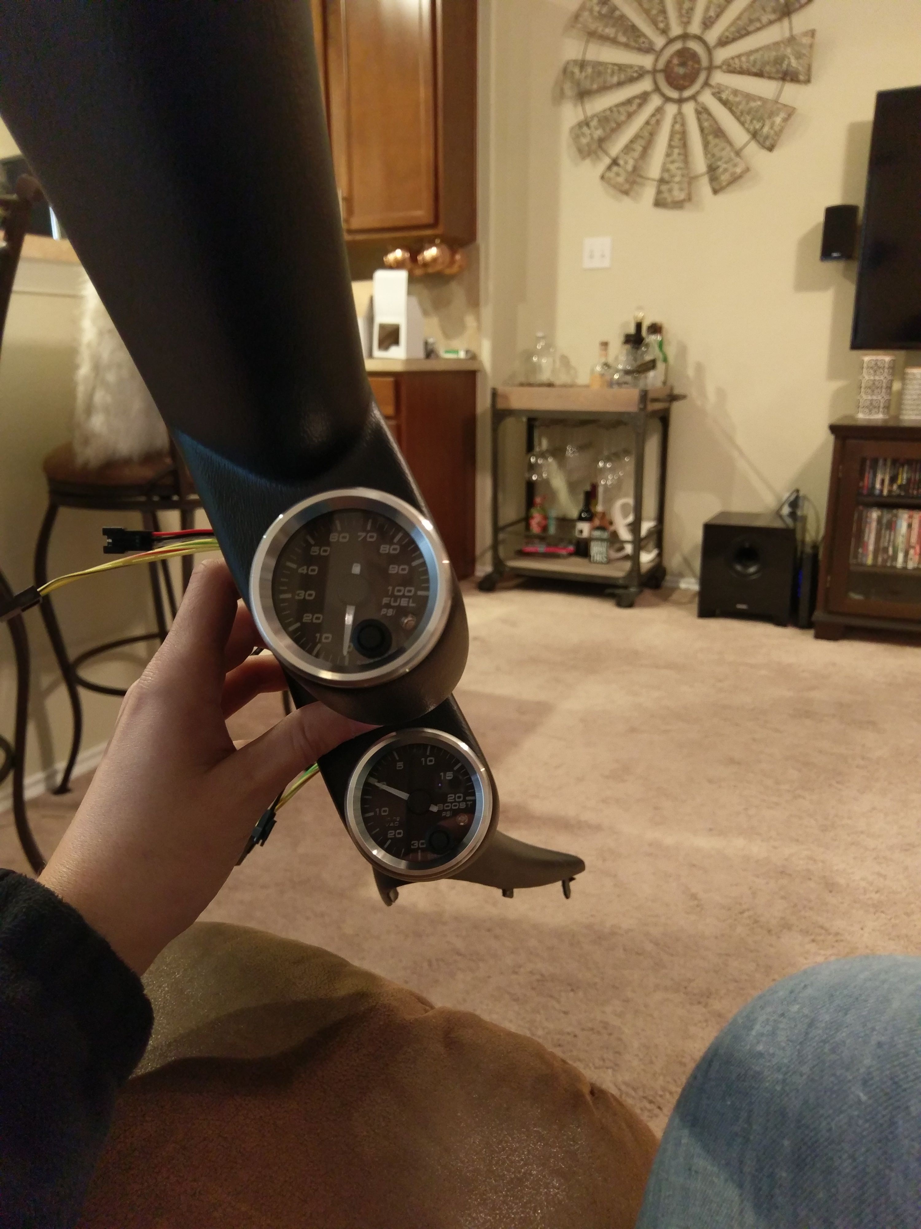

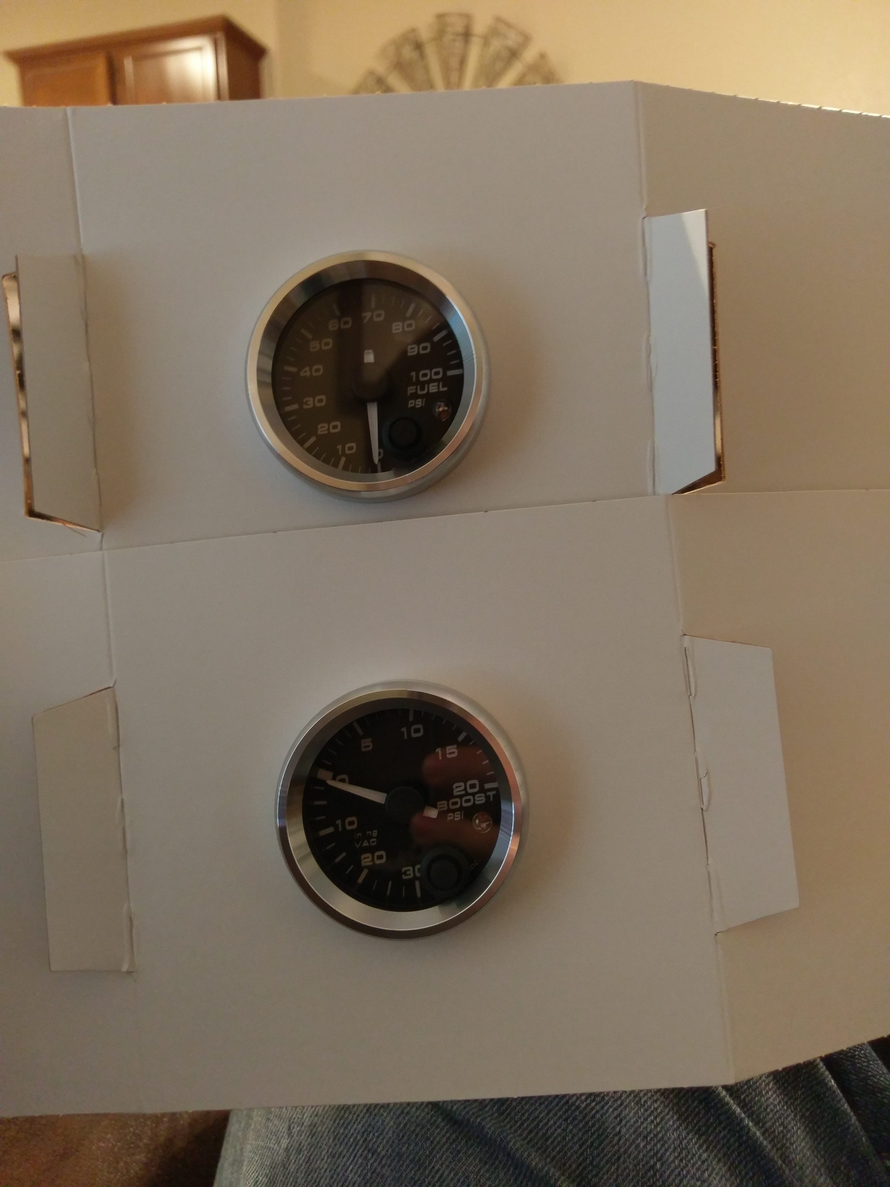

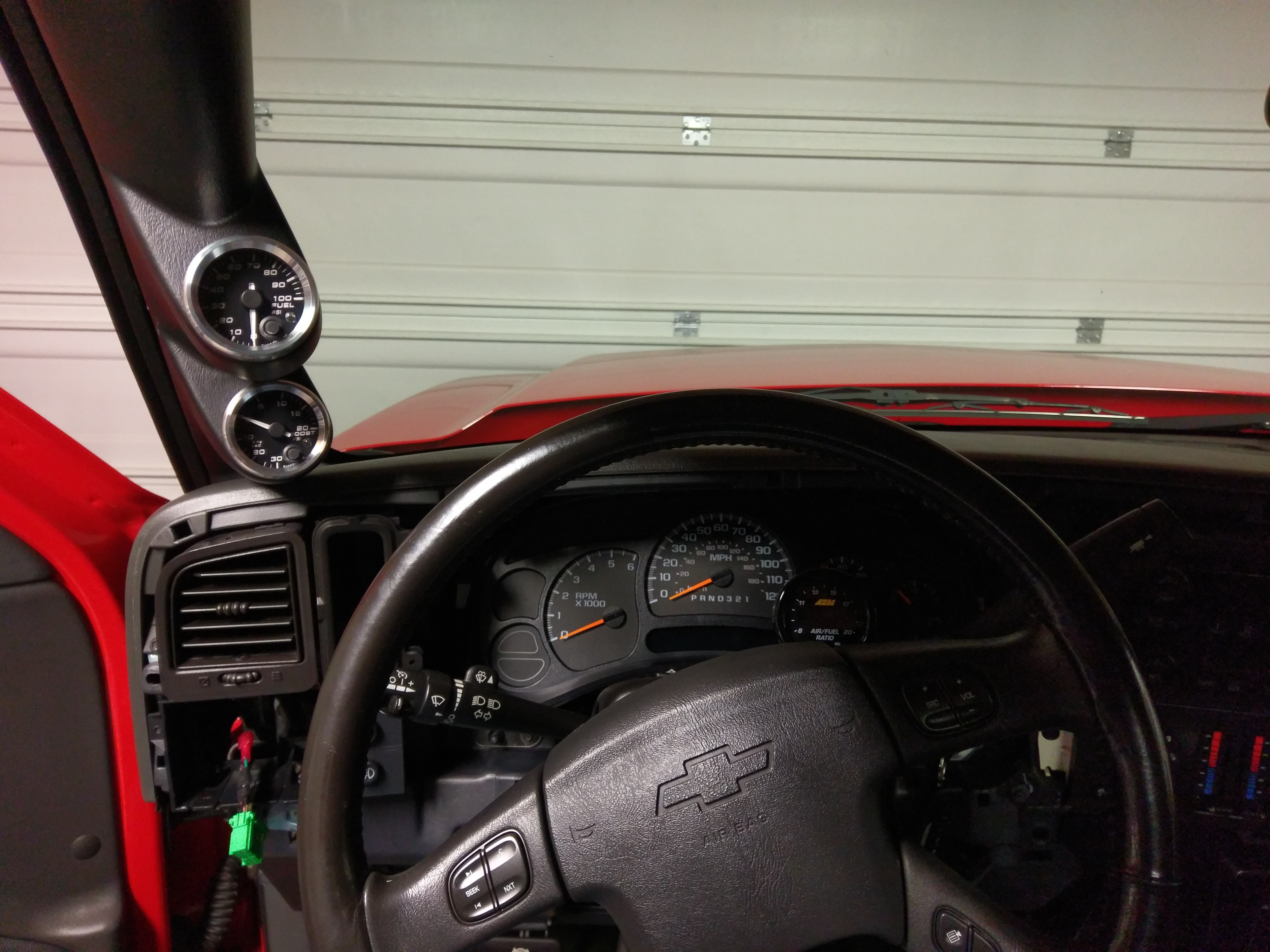

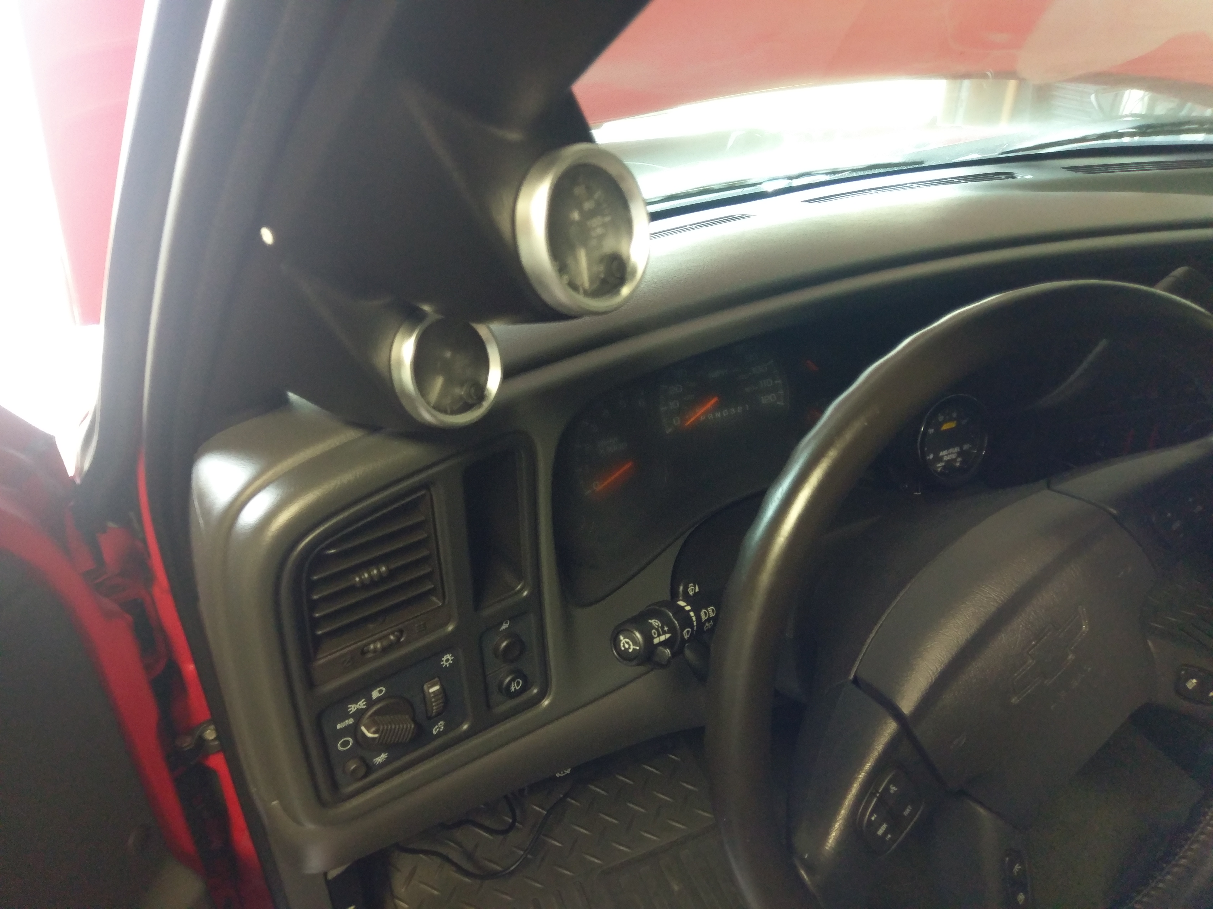

Speedhut gauges came in today. I designed them to match the escalade platinum cluster
ILuvJDM's 2007 NBS RCSB Build - Turbo/4L80e/Coilovers/Wilwoods-t6cw50b.jpg
ILuvJDM's 2007 NBS RCSB Build - Turbo/4L80e/Coilovers/Wilwoods-944cmgj.jpg

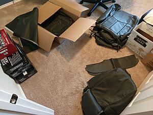

Leather seats also came in
ILuvJDM's 2007 NBS RCSB Build - Turbo/4L80e/Coilovers/Wilwoods-rwwnkte.jpg

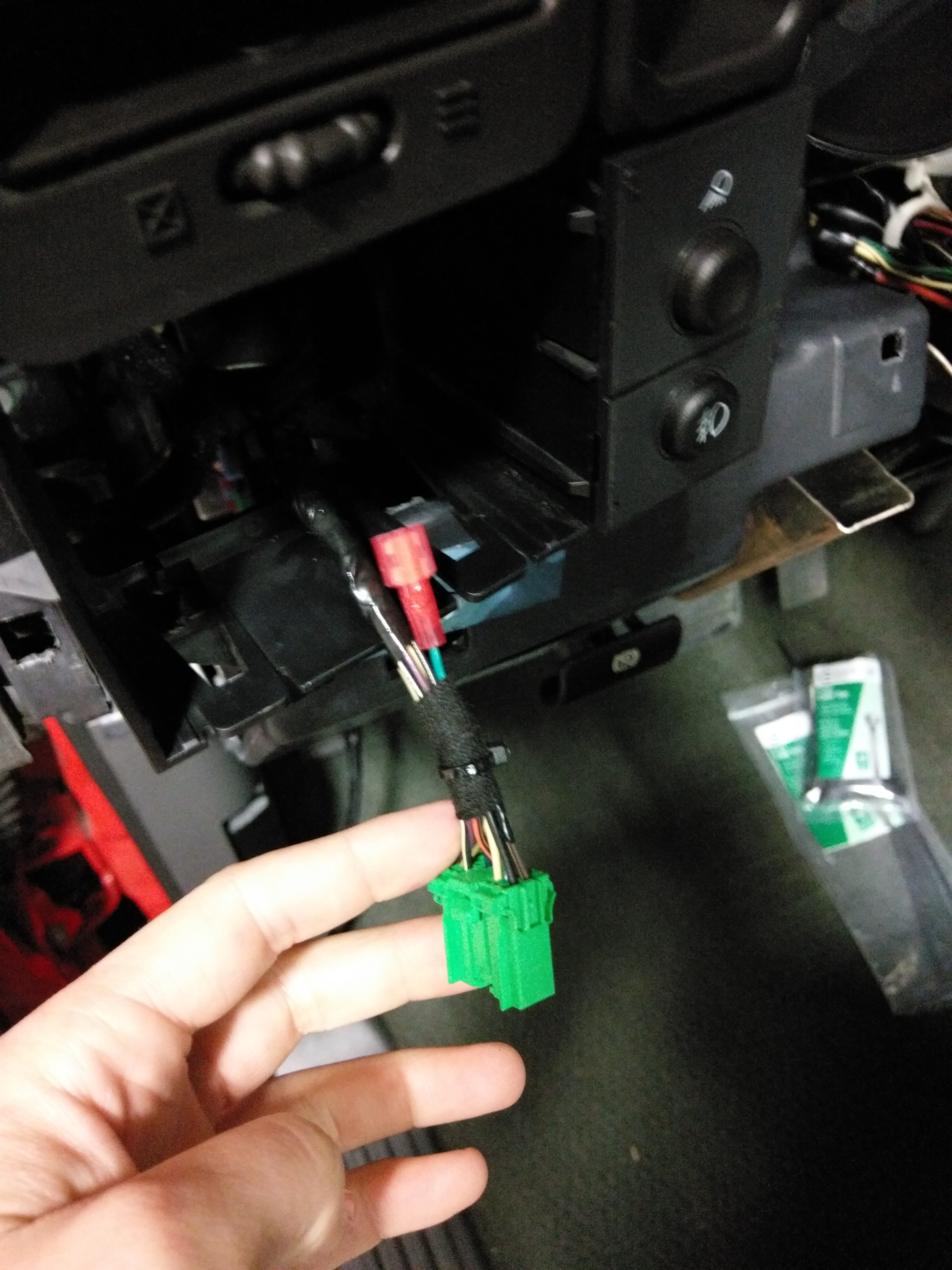

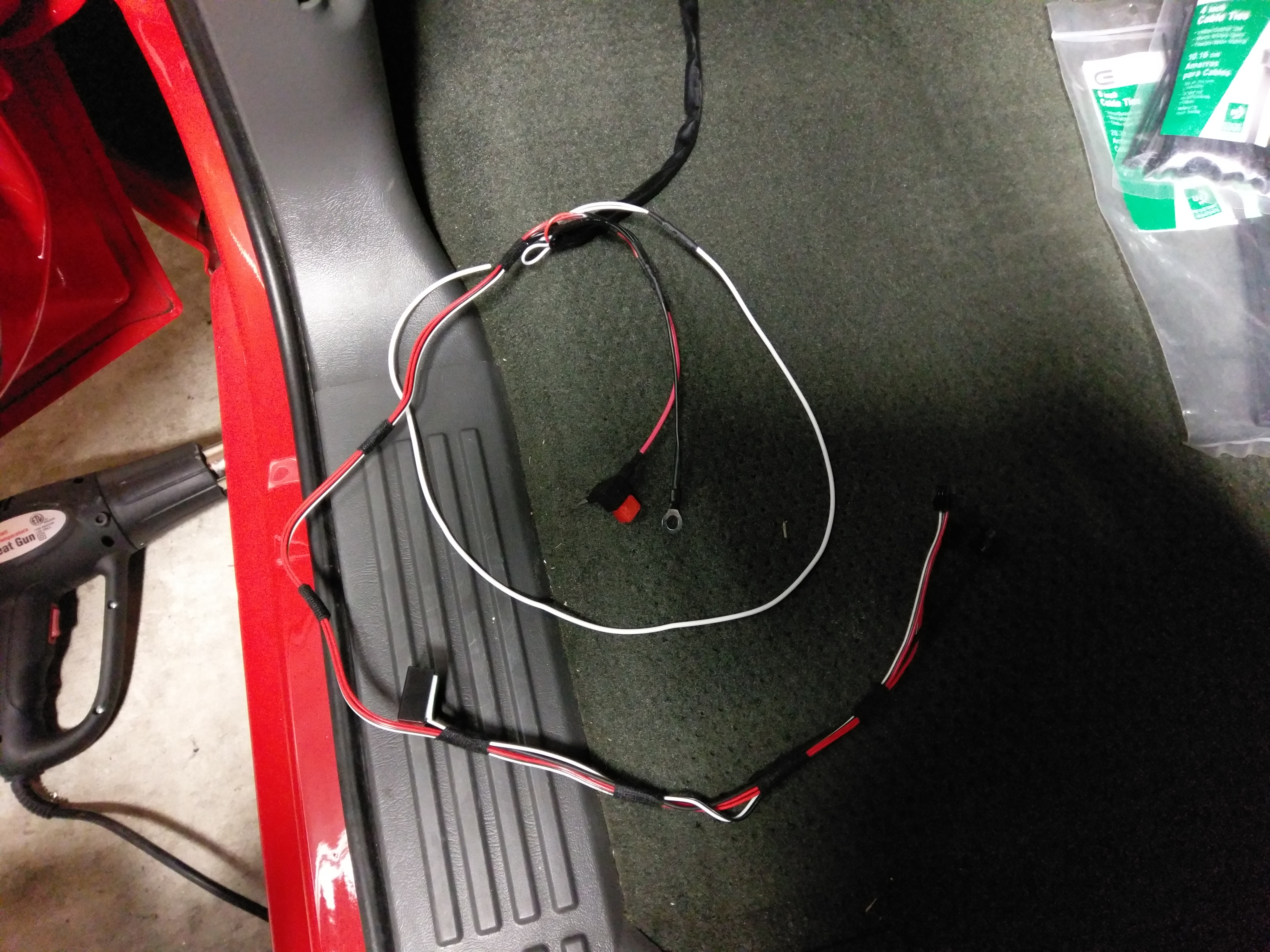

Got the gauges wired up this evening. Still have to mount the two pressure sensors, but I got the wiring through the firewall and into the engine bay.
This is for the dimmer/illumination wire
ILuvJDM's 2007 NBS RCSB Build - Turbo/4L80e/Coilovers/Wilwoods-0hk7grm.jpg
Bundled all three gauges together so it's one ground, one fused 12v and one illumination (just for the speedhuts)
ILuvJDM's 2007 NBS RCSB Build - Turbo/4L80e/Coilovers/Wilwoods-pk5g1hr.jpg

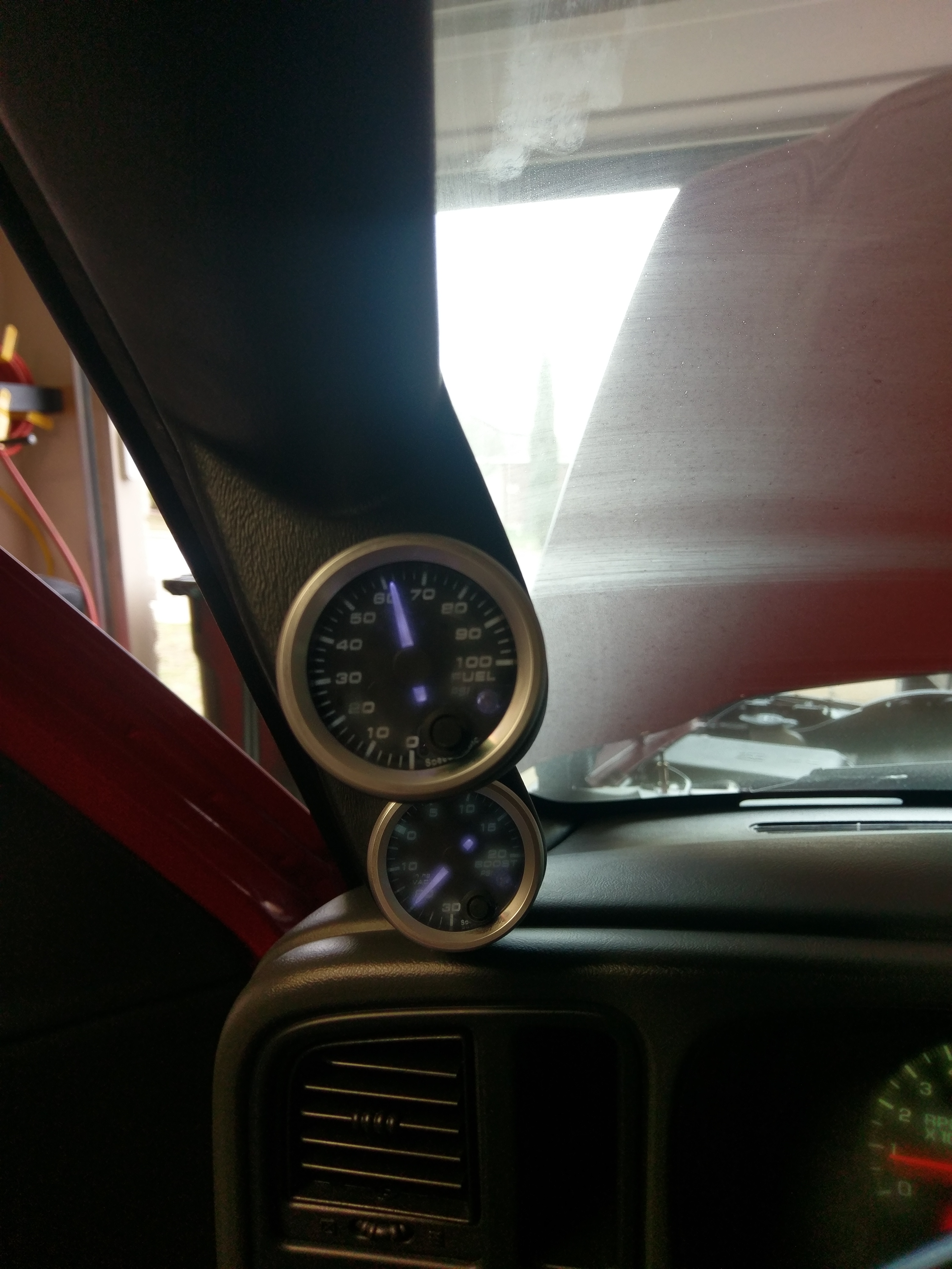

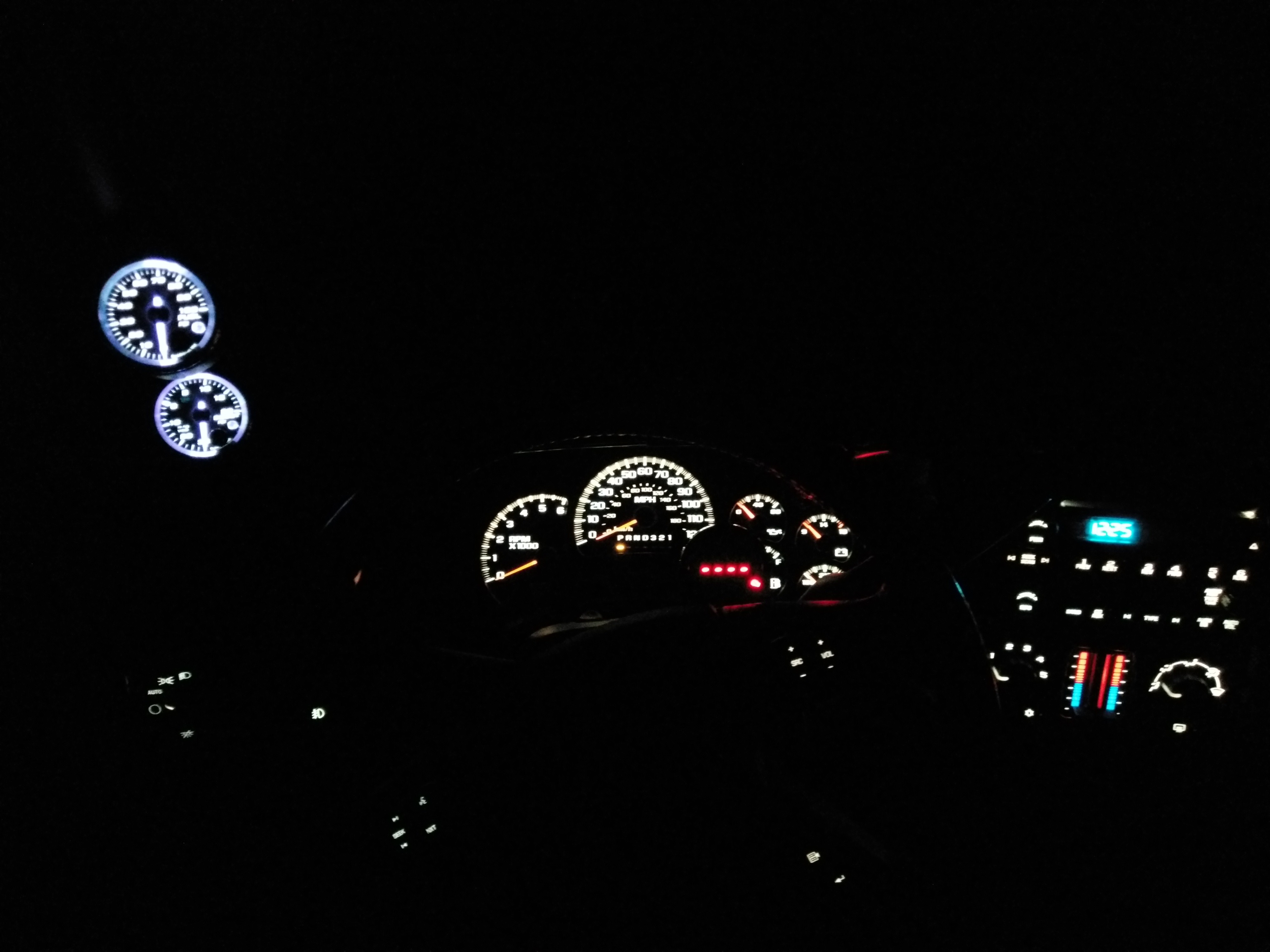

The picture makes them look blue, but they're not
ILuvJDM's 2007 NBS RCSB Build - Turbo/4L80e/Coilovers/Wilwoods-afe0x43.jpg

where did you get the leather covers? what is the price? my leather is warn out bad
These are from leatherseats.com I believe - $630.00 shipped. I haven't installed them yet, but they do feel quality just holding them

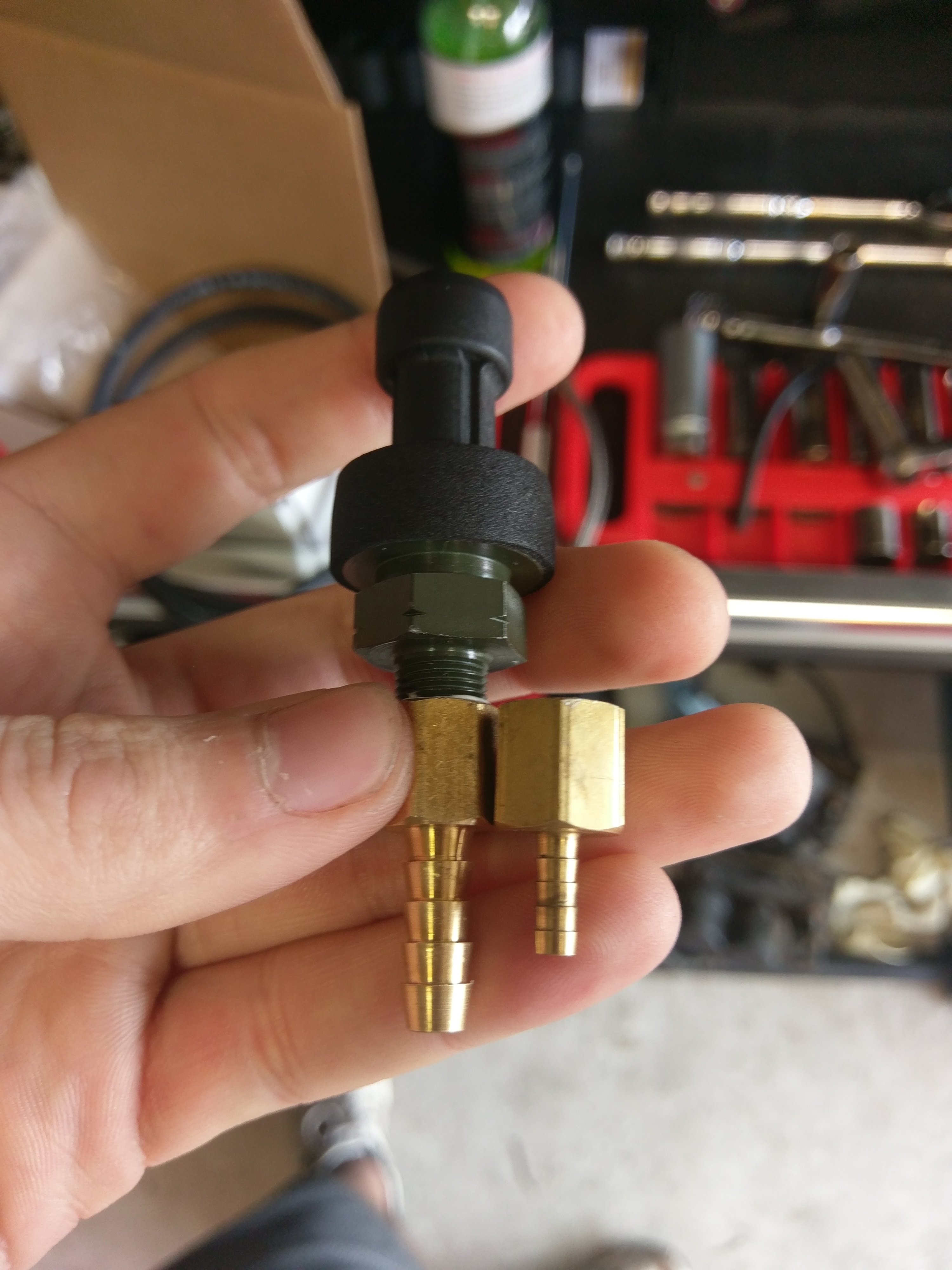

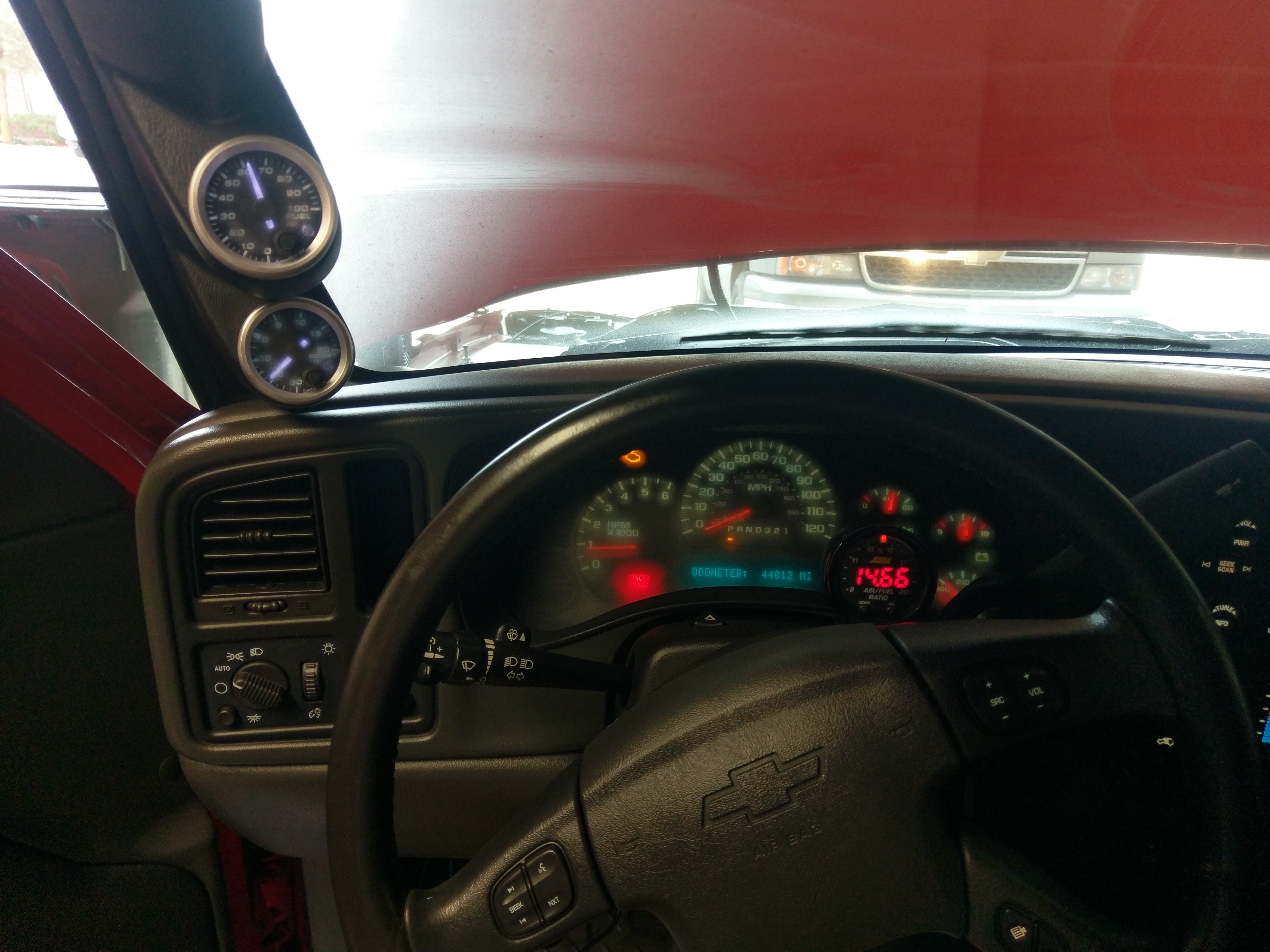

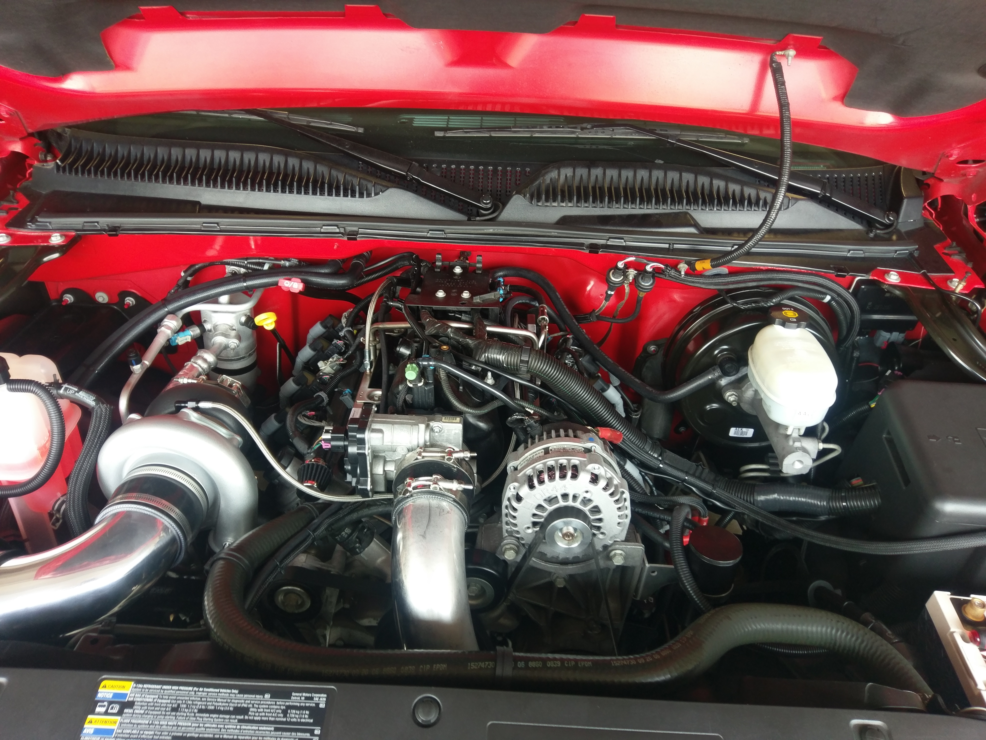

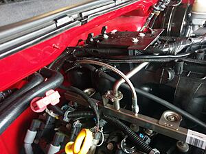

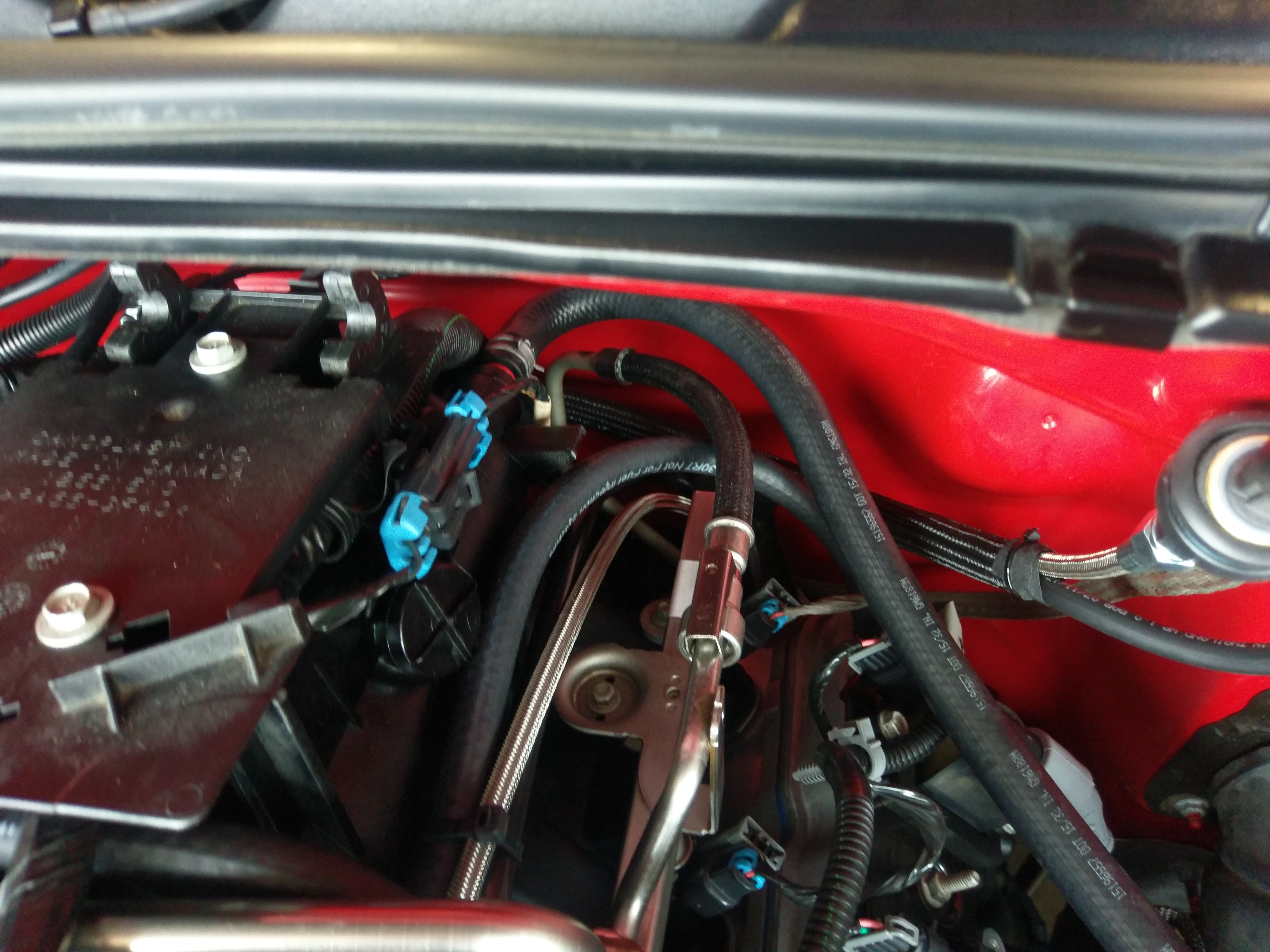

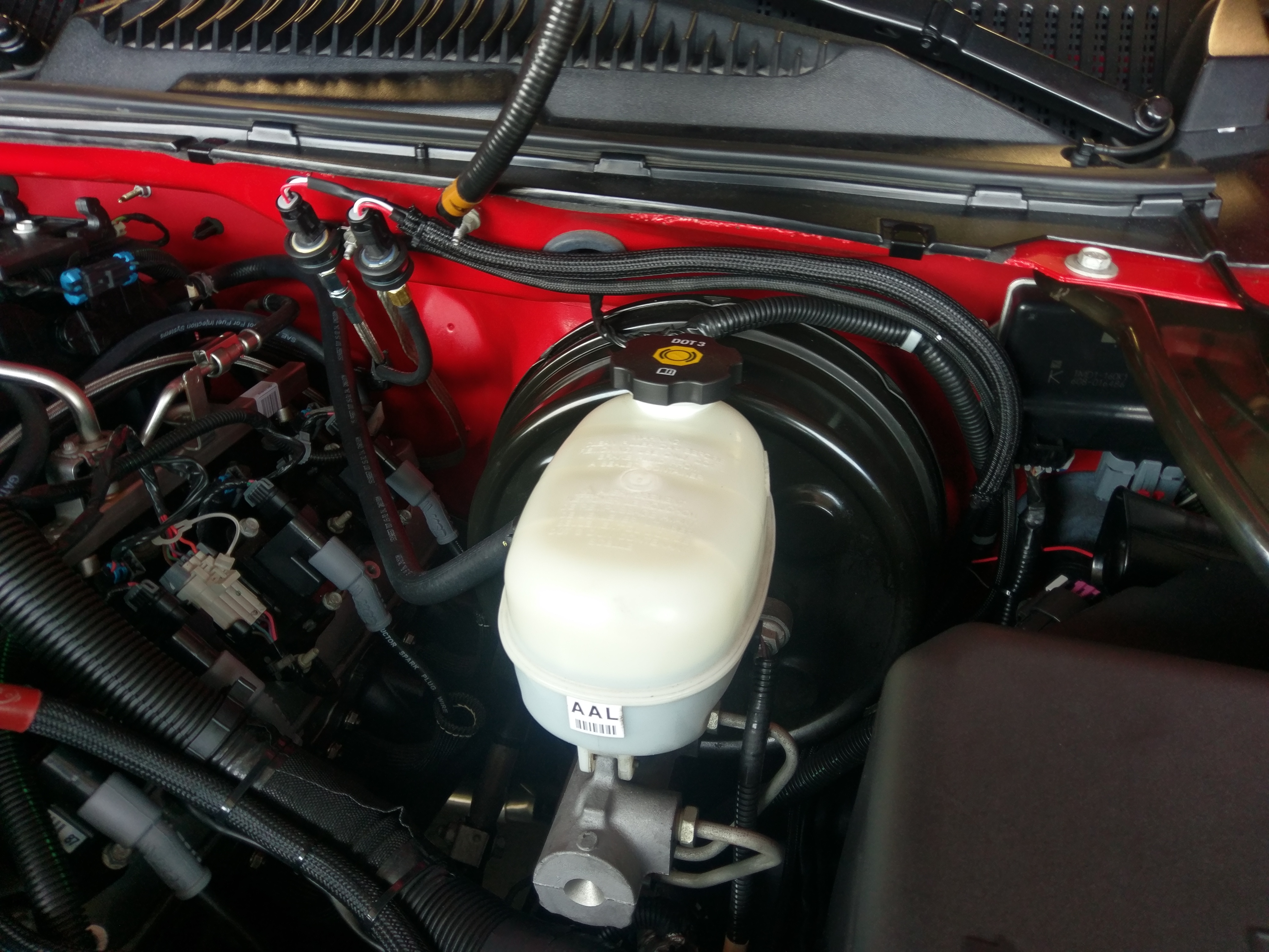

Got the final pieces to finish my gauge installation
ILuvJDM's 2007 NBS RCSB Build - Turbo/4L80e/Coilovers/Wilwoods-3w5dl2d.jpg
The barb that comes with the gauges is too small to fit any vacuum lines on the truck
ILuvJDM's 2007 NBS RCSB Build - Turbo/4L80e/Coilovers/Wilwoods-jksn5jj.jpg
Lines tied together
ILuvJDM's 2007 NBS RCSB Build - Turbo/4L80e/Coilovers/Wilwoods-vk66bdr.jpg
Routed behind the intake manifold and wrapped in techflex
ILuvJDM's 2007 NBS RCSB Build - Turbo/4L80e/Coilovers/Wilwoods-ujrlavj.jpg
ILuvJDM's 2007 NBS RCSB Build - Turbo/4L80e/Coilovers/Wilwoods-rbww43l.jpg
Not enough wiring in the sensor harnesses, so I had to mount on the drivers side firewall instead of the passenger
ILuvJDM's 2007 NBS RCSB Build - Turbo/4L80e/Coilovers/Wilwoods-volgxki.jpg
ILuvJDM's 2007 NBS RCSB Build - Turbo/4L80e/Coilovers/Wilwoods-de8lhgo.jpg
Been humid as **** here lately
ILuvJDM's 2007 NBS RCSB Build - Turbo/4L80e/Coilovers/Wilwoods-s7yo2iy.jpg
Everything seems to be working just fine
ILuvJDM's 2007 NBS RCSB Build - Turbo/4L80e/Coilovers/Wilwoods-6eglwcs.jpg
ILuvJDM's 2007 NBS RCSB Build - Turbo/4L80e/Coilovers/Wilwoods-vnemuvg.jpg
In other news, hit 171717 miles in the daily
ILuvJDM's 2007 NBS RCSB Build - Turbo/4L80e/Coilovers/Wilwoods-lsamm1l.jpg
