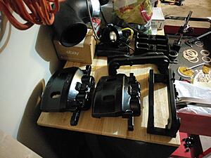

Cleaned and painted the oem calipers and purchased a z36 powrstop kit. Going to remove the wilwoods in the future so I can run a drag pack front and rear

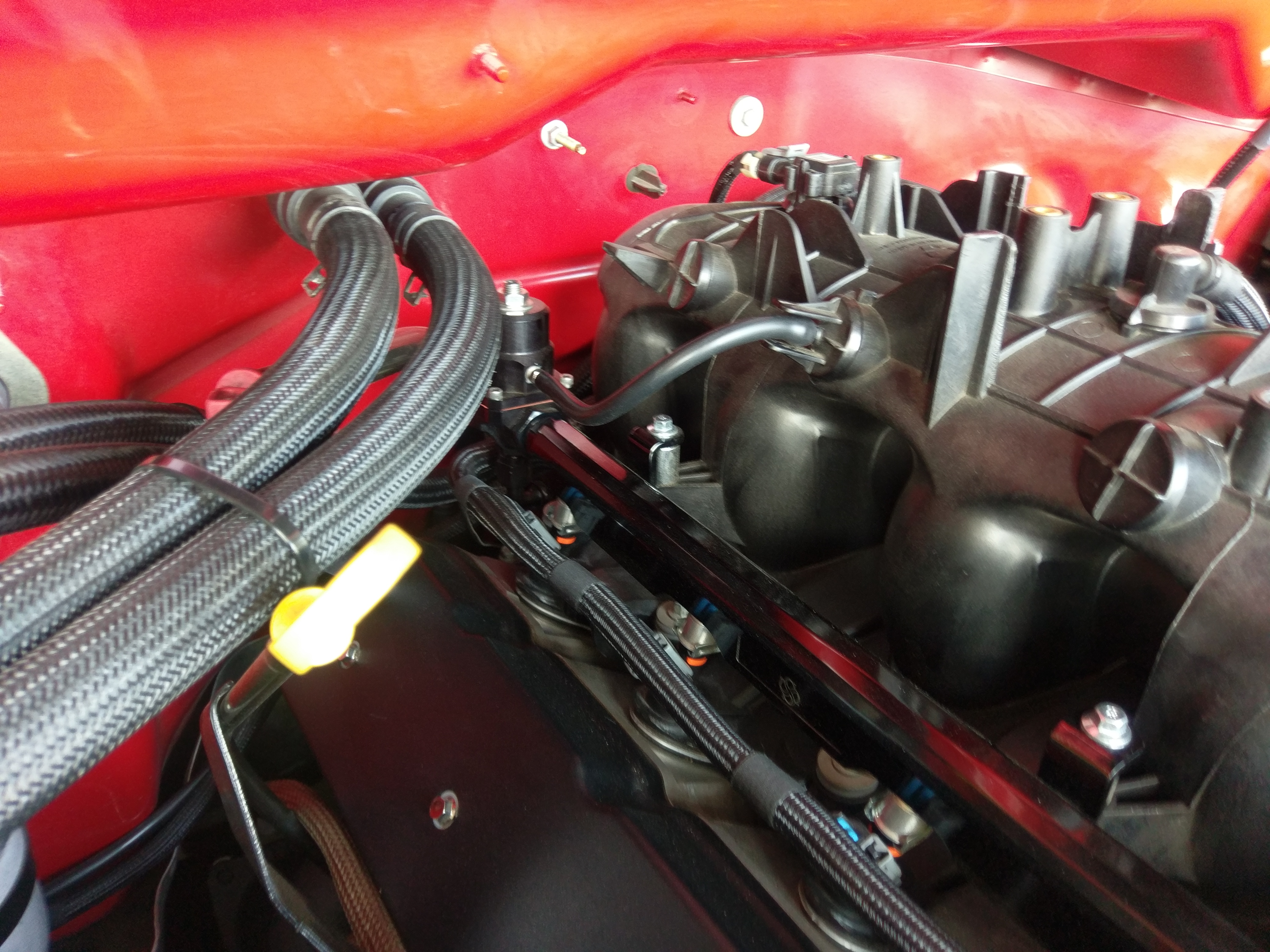

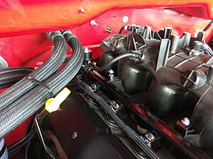

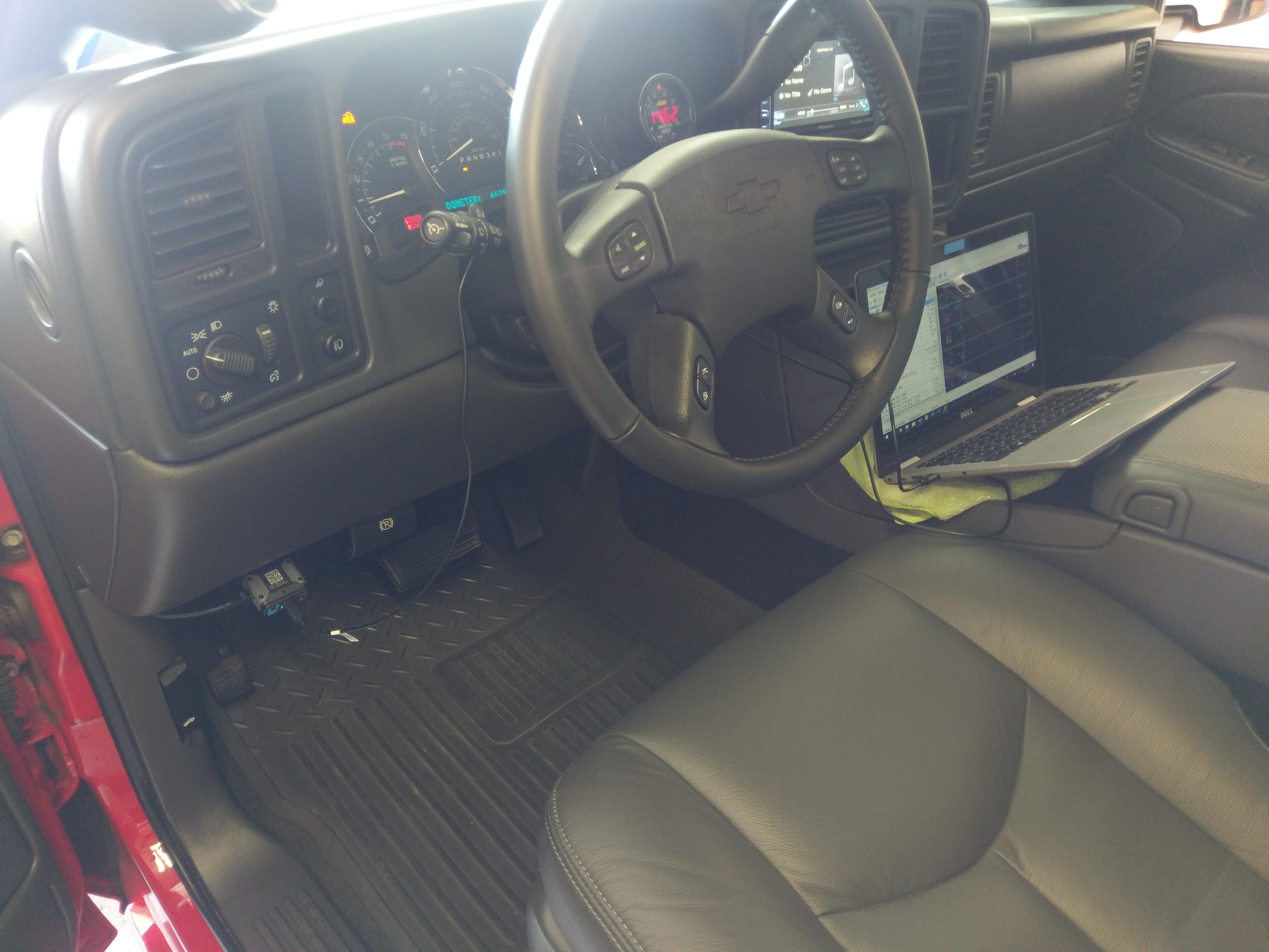

Wired in my MPVI 2 pro interface to the wideband and started the new tuning process with Atomic.
ILuvJDM's 2007 NBS RCSB Build - Turbo/4L80e/Coilovers/Wilwoods-zu5cdqd.jpg
ILuvJDM's 2007 NBS RCSB Build - Turbo/4L80e/Coilovers/Wilwoods-ifcam78.jpg
First file he sent me it idles and drives like a stock truck. Previous shop had the truck for over a month and tried to blame it on the parts I used on the build, or injectors too big, or the PCM, etc.. The truck would stall going from park to drive or coming up to stop signs, and all sorts of issues. I definitely wish I had never gone to that shop to begin with, but live and learn.

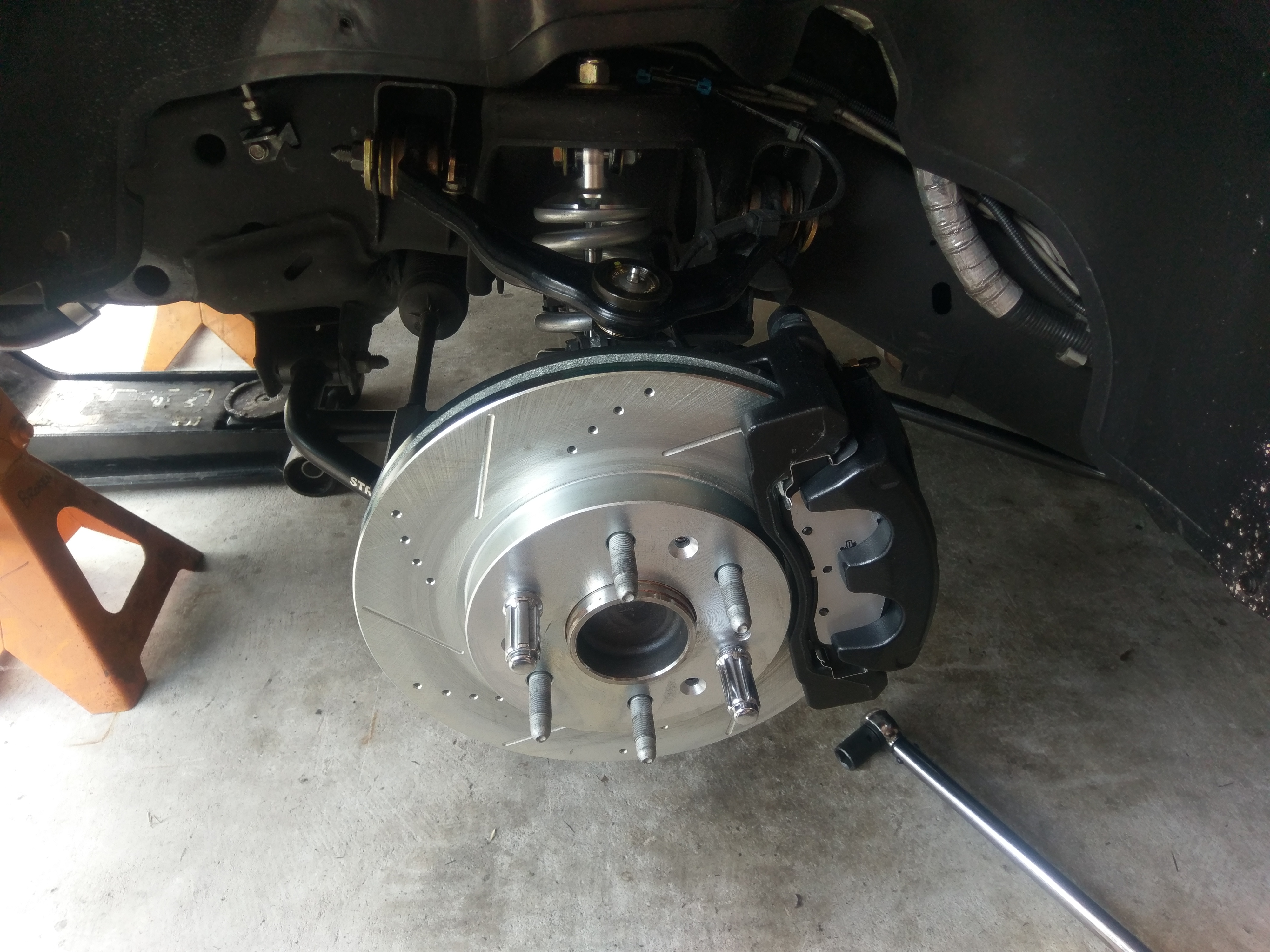

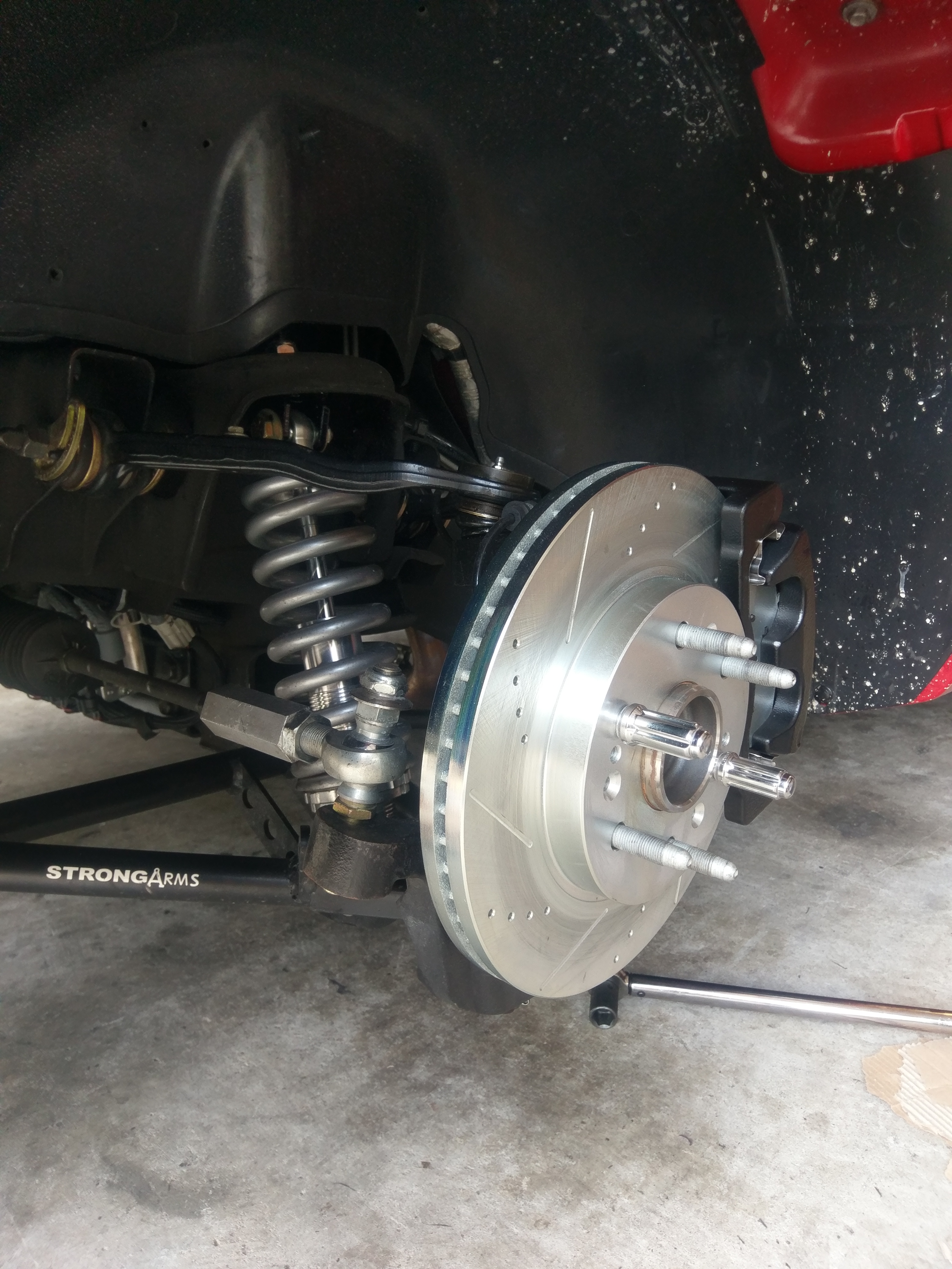

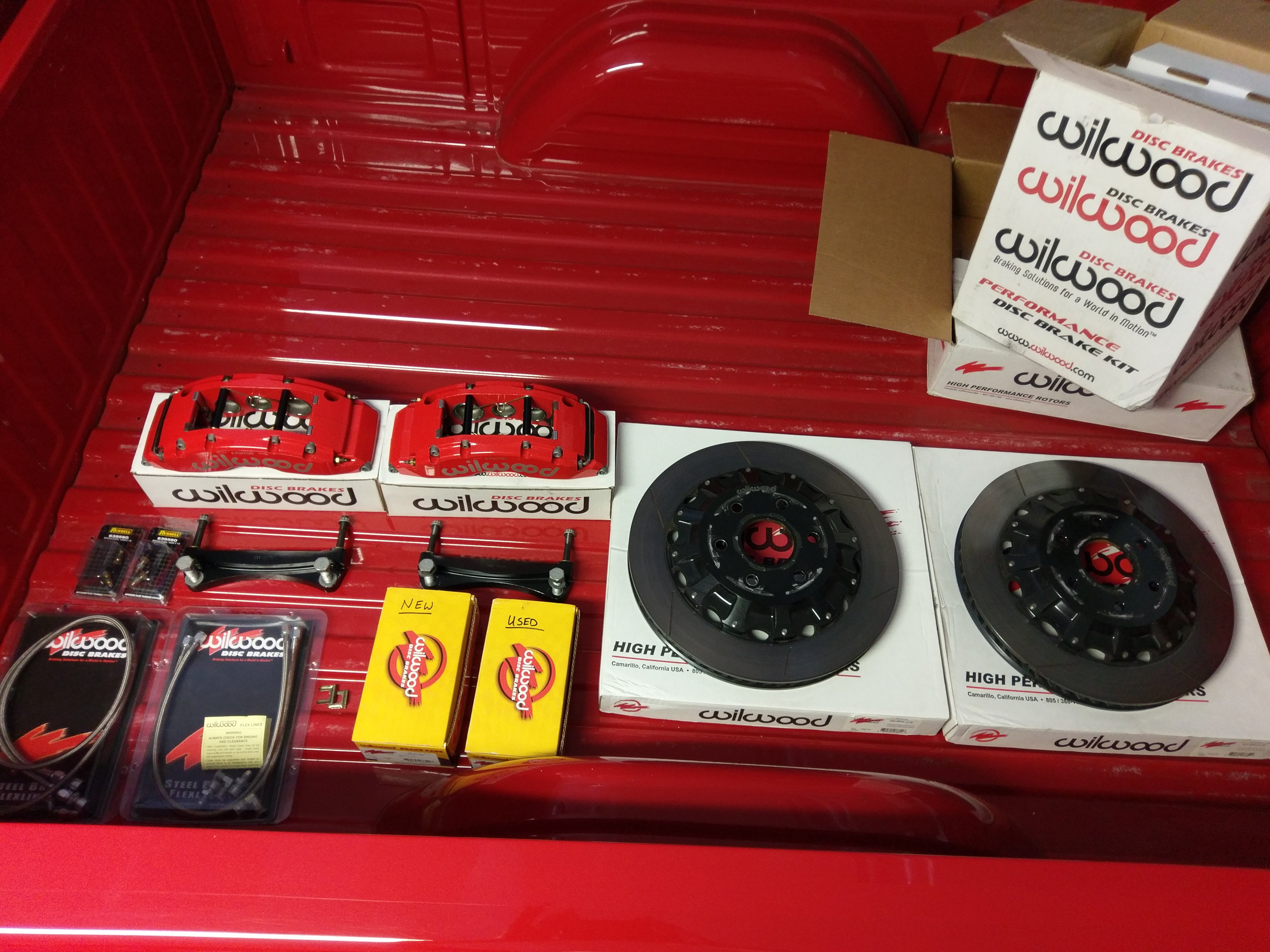

Wilwoods are off the truck, going to have to edit the thread title now...
ILuvJDM's 2007 NBS RCSB Build - Turbo/4L80e/Coilovers/Wilwoods-ondweu3.jpg
Powerstop Z36 kit with the OEM calipers I painted black. Got new slide pins, seals, speed bleeders and russell stainless lines
ILuvJDM's 2007 NBS RCSB Build - Turbo/4L80e/Coilovers/Wilwoods-oreqhox.jpg
ILuvJDM's 2007 NBS RCSB Build - Turbo/4L80e/Coilovers/Wilwoods-fl1gy3f.jpg

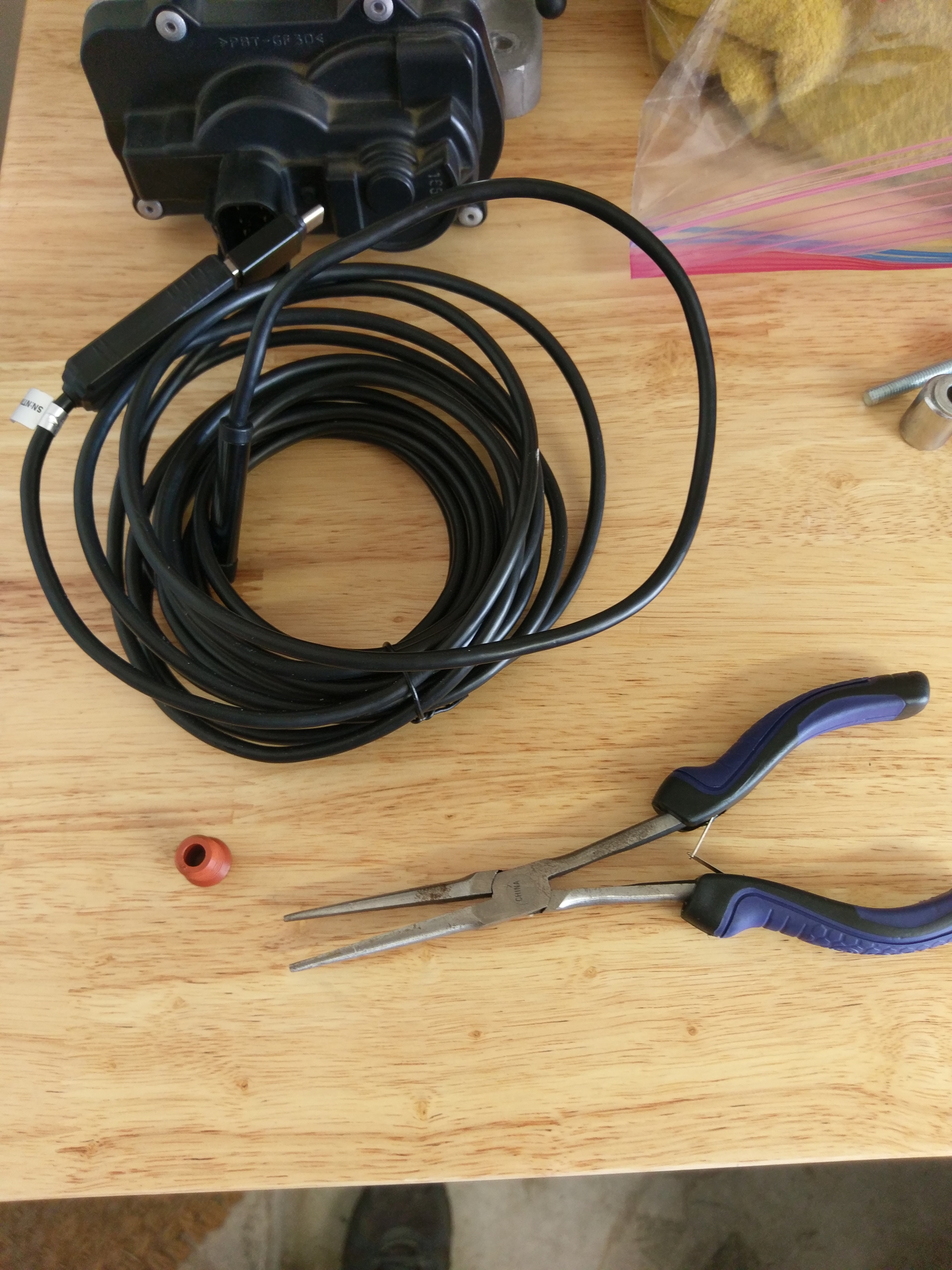

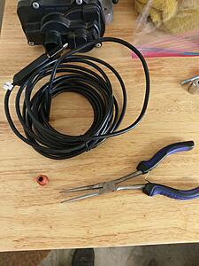

Oh what a fun afternoon. Went to change the MAP sensor and I tried to take a shortcut and long story short the gasket fell into the intake manifold. Left me no option but to remove the fuel rails, intake manifold, etc...
Found it sitting on top of the valve in number 7
I felt like a brain surgeon getting it out with the borescope and needle nose pliers...
ILuvJDM's 2007 NBS RCSB Build - Turbo/4L80e/Coilovers/Wilwoods-qxywryf.jpg
Took a few hours but it's all back together now. Won't make that mistake again.
