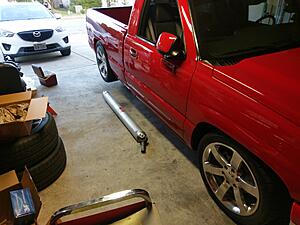

Trying to get rid of a terrible 60mph vibration I'm having... it makes the truck undriveable. Swapped the yoke on the driveshaft thinking it was possibly out of phase since it wasn't marked before the yoke was installed, but that didn't do a thing. Going to try and have the rear tires rebalanced, then I guess check brake drums.

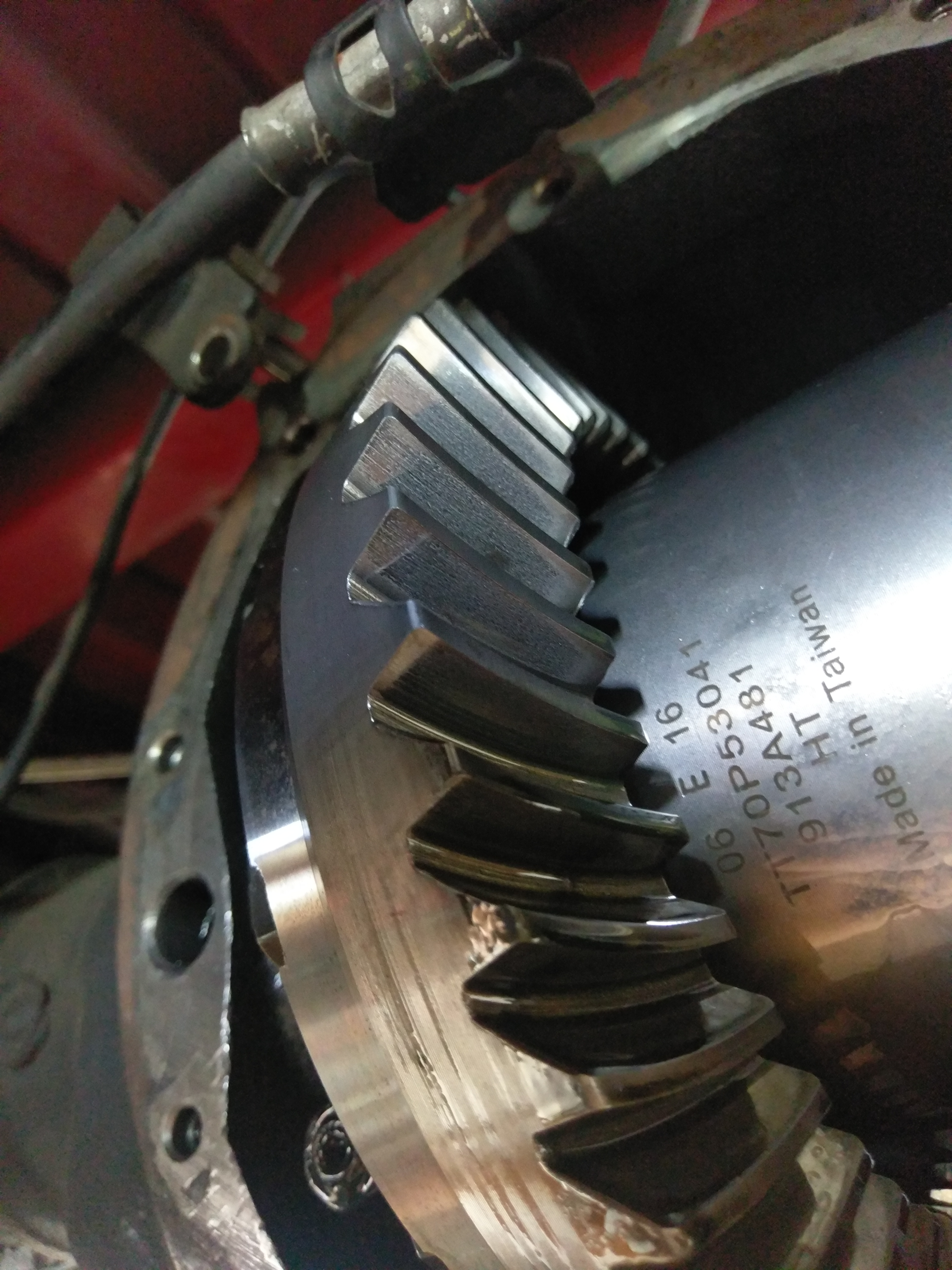

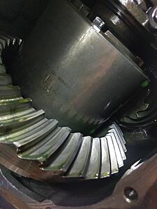

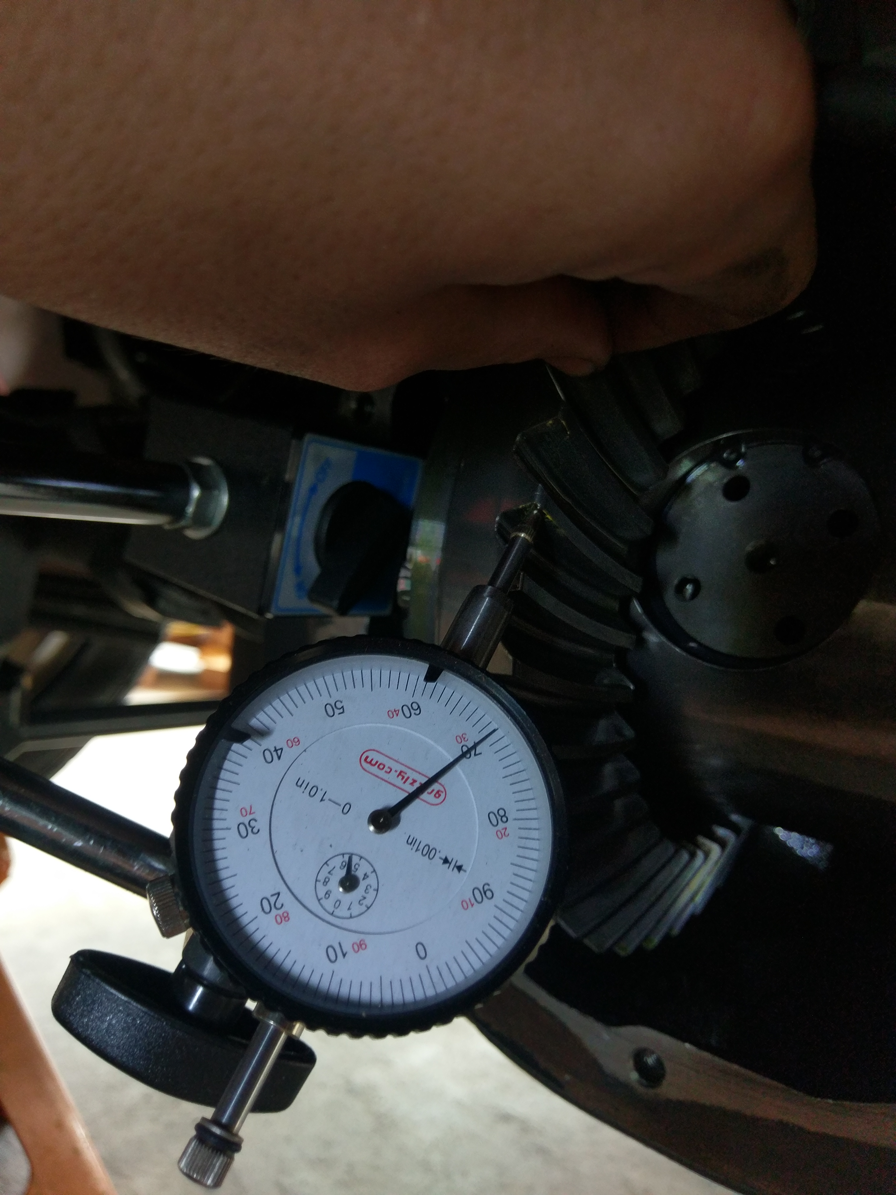

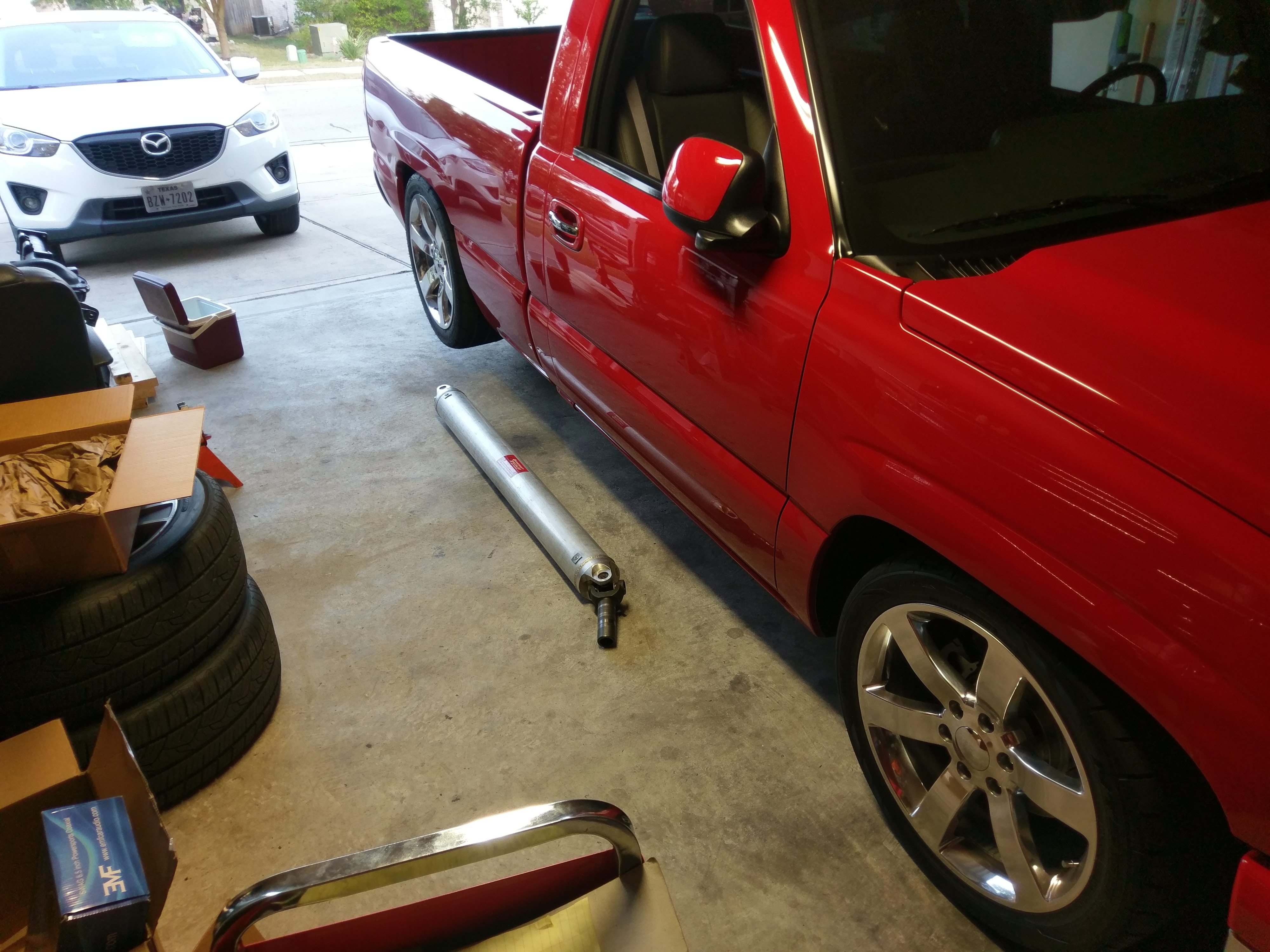

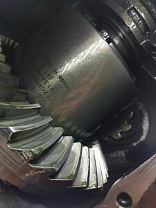

Dropped the driveshaft off this morning to get checked for balance. I went ahead and removed the rear end cover just to be sure it was still good., here's what I found:

Seems fine to me, still have 0.006" backlash, wear pattern looks good (I think) and everything else was tight. No teeth had any damage, and there was nothing in the bottom of the diff that seemed odd. I still have not heard any sort of whining or noises from the diff since I built it.
I did notice that with the brake drums and wheels still attached, when I spun the pinion, I could feel a noticeably more difficult spot. It didn't stop the wheel or anything, but I could tell a difference. I may try either turning the brake drums, or having them checked in some way.
