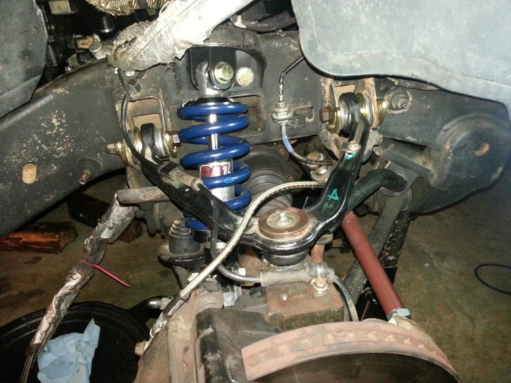

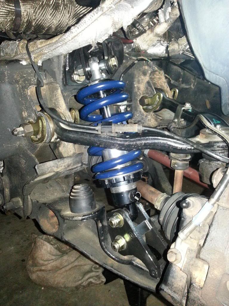

I replaced the UCA bushings with the beltek kit so hopefuly I can get my alignment set up better now. What does everyone recommend for alignment setup specs? I dont do any curvy driving, just drag strip and highway...
As a side note, I bought a 20ton press from harbor freight and replaced the jack with a 20ton air jack....money well spent! I replaced all 4 bushings in probably an hour including taking them off and reinstalling them, pretty easy job!
1000 miles on the coilovers and still rocking!

good deal! what did you pay for the press and jack? people say the jacks that come with are junk. I just replaced all the a arm bushings but took them to a shop because I don't have a press.
how much camber adjusting can you do with the stock parts?

I ended up getting the press for 122 out the door and the air jack for about 80 out the door.
Just under the amount I need to get the alignment where it should be

As much caster as you can get, no camber and about 1/8" total toe in. No bump steer.

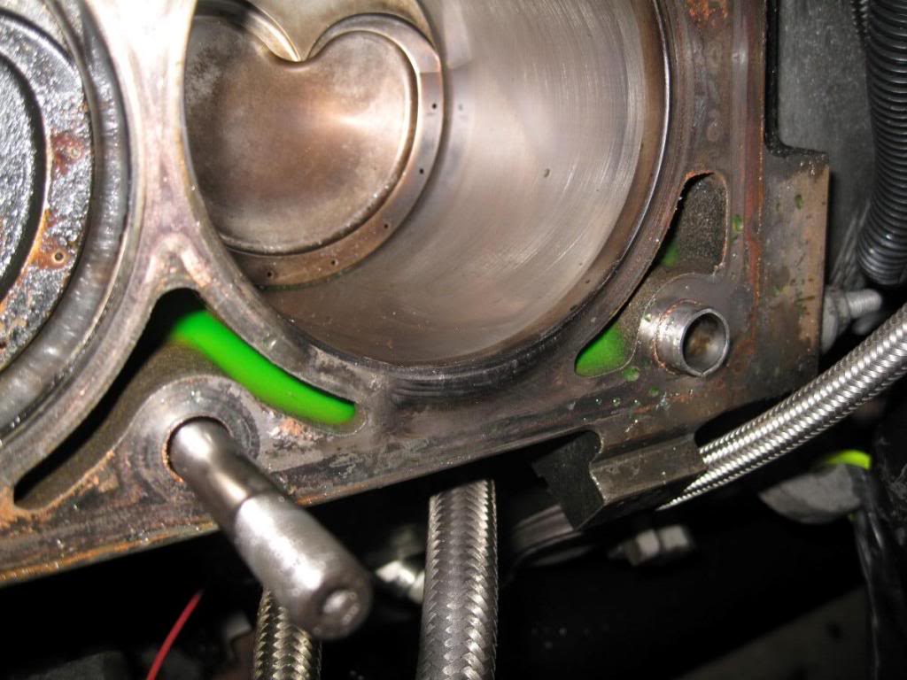

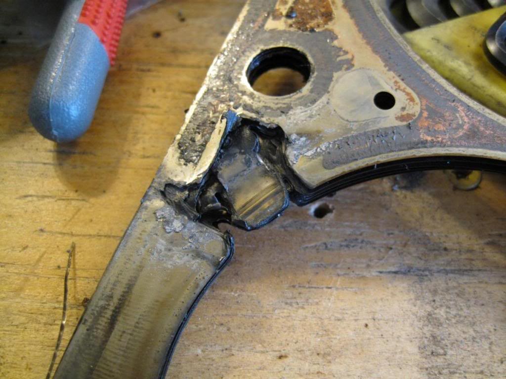

Damage ended up being...
Coolant tank:

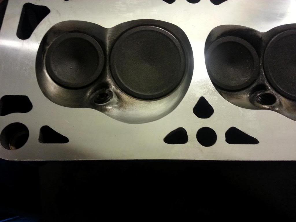

Head and head gasket:

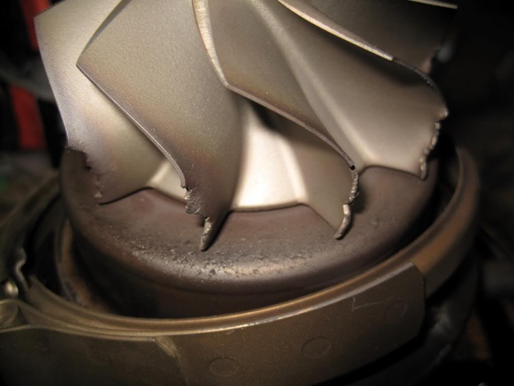

And turbine wheel:
The good news is the block and piston looks fine and the oil is clean.
I had the tank fixed, turbine wheel replaced, and head repaired by MPFab (guy who did my turbo pipes)

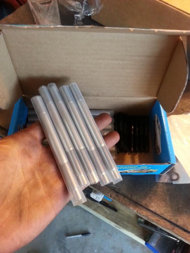

I also upgraded to the ARP CA625 head studs and 5/8 nuts on the recommendation of Brian at LME. There is a substantial size difference...dunno if it helps but it makes me feel better about it.
Fancy head studs...

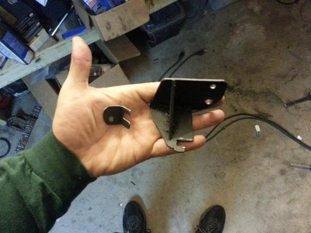

I am working on getting everything back together now, and finally redid that annoying cable bracket...the new design is much simpler

Head looks almost perfect now.

Yea, Walker is a beast

**** those are some beefy head studs!
Should be nice and solid when it goes back together
