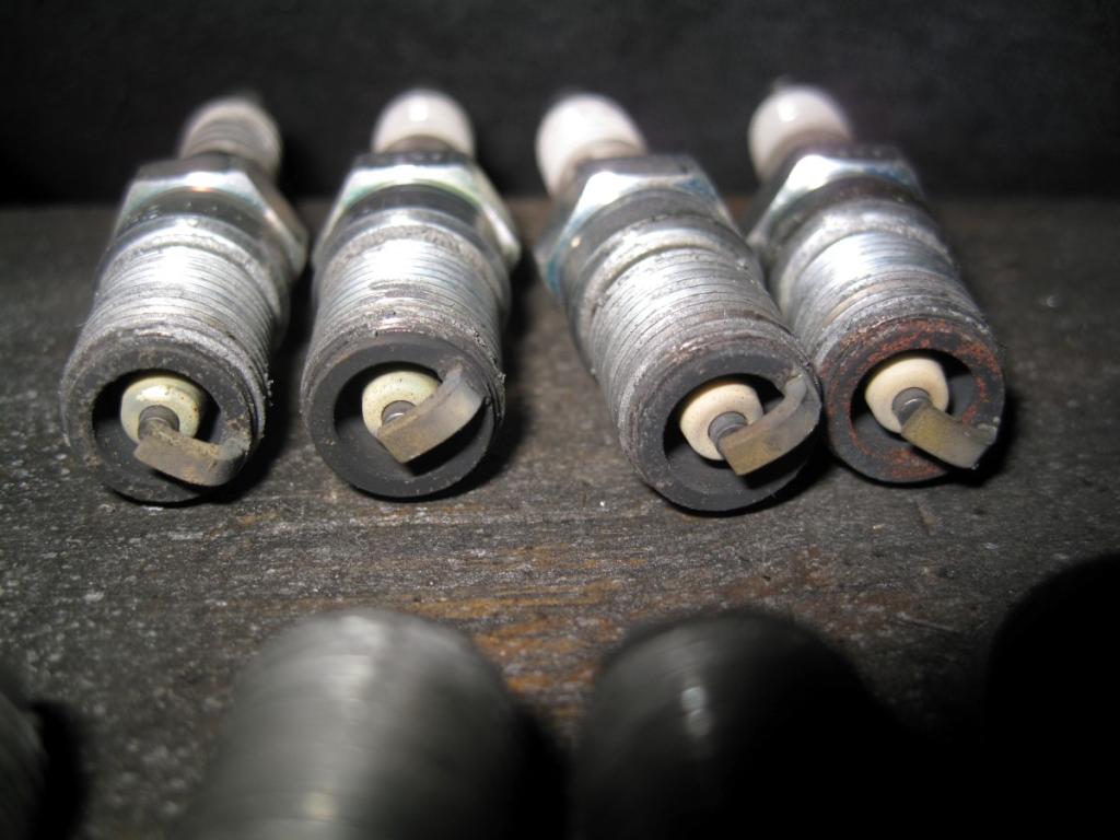

Finally made a good bit of progress towards getting the blower done, but first, here are my plugs after the last run with the turbo. They are B8EFS plugs.
Passenger side (#8 at right):
Driver side (#7 at left):
Looking a little toasty! My radiator is also leaking, so I think I was right in figuring I was at the limit of the 4bolt block. Engine probably would not have lasted much longer at that level.

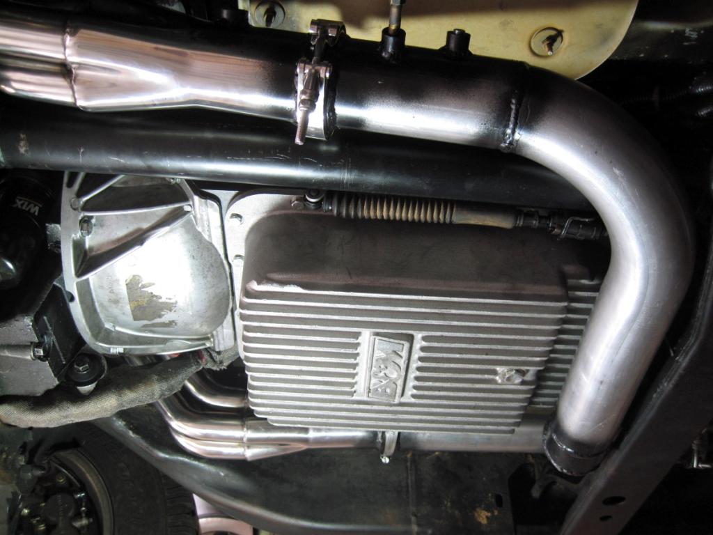

So onto the blower build. I had to make an exhaust so I decided to do this myself. I got some of the speed engineering headers and their Y pipe. Unfortunately the y pipe will not fit an 80e with an aftermarket pan so I had to make my own. I got a 4' pipe from summit, a flowmaster dual 3" to single 4" merge and some vbands from ebay. I wanted to keep my 5" cutout but there was just not any room. This was my first time making a real exhaust. I think it came out pretty well considering. Only had to do 1 pie cut to make a hard turn.
You can see where I added some bungs to be able to monitor exhaust pressure and egt, since I already had the gauges I figured I would use them.

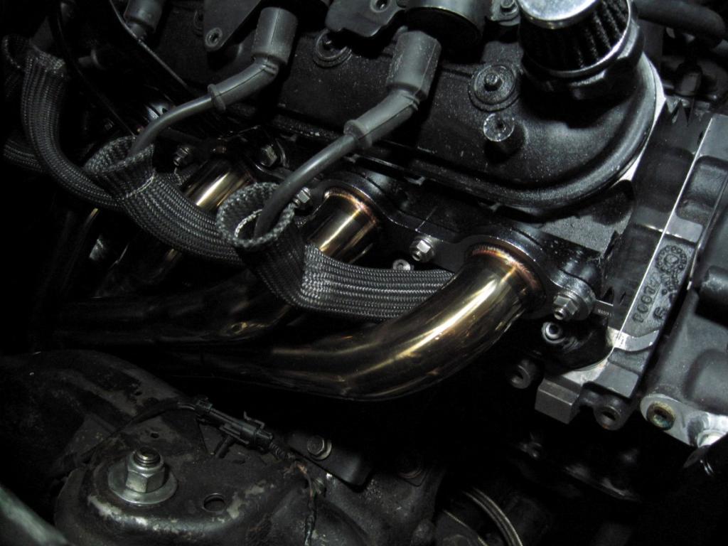

I started it for the first time since October and it idled fine and sounded good, so I think the engine is ok. The headers did turn a nice shade of gold as well. Dont know how long it will last.

Would those 2 rear spark plugs looking hot have anything to do with the rear coolant ports on the heads being plugged by gm? Cant wait to see what you do with the whipple.

I have all the coolant ports open, they arent closed any more. Its more to do with the block design and the fact those rear cylinders dont have as much cooling to them.
