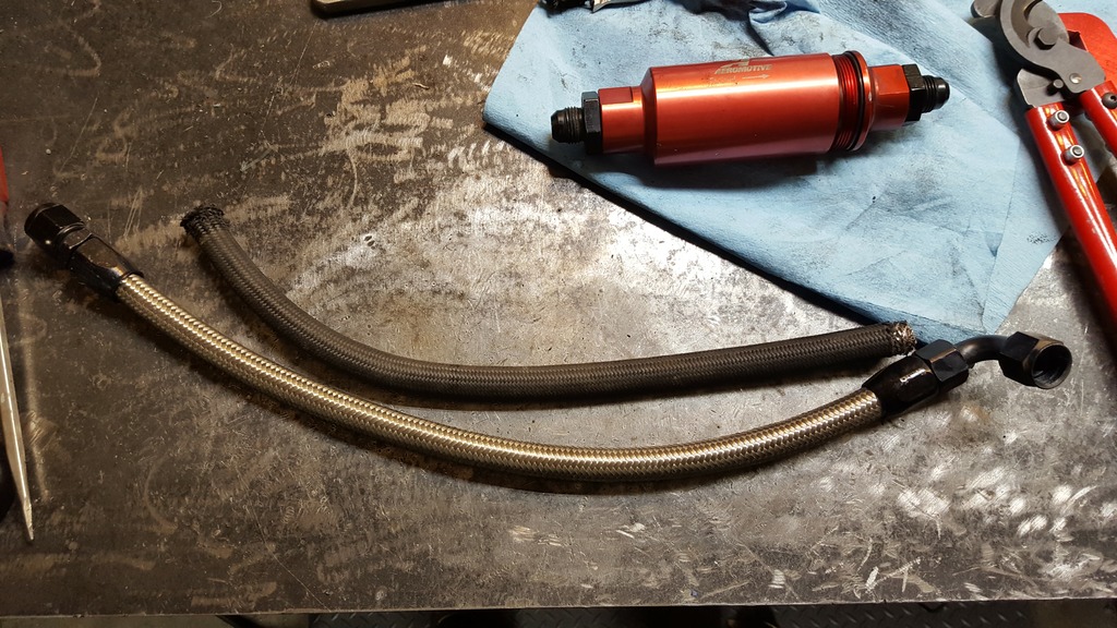

But I started the truck in the garage and let it idle, happened to look under it and saw fuel dripping from the tank area. I only needed to drive for a few minutes, but fuel leaks are usually pretty bad so turned it off and decided to try and find where it was from. Fuel system hasnt been touched in ~6 years and consist of dual walbro400 pumps in an 05 tank using -8an line to an aeromotive filter and the return line is -6an to the stock feed line.
Pulled the bed, didnt see anything, so I dropped the tank and turned the truck on to find it while running. I was poking around and pulled on the feed line and definitely found my problem. The hose lining that the fitting clamps on to had failed and the hose ripped out from the fitting. Its amazing how much fuel a single walbro400 moves with your thumb over the hose, but the truck died obviously and killed the pump.
Good opportunity to replace the fuel filter so I went ahead and did that and made a new hose section from some stainless hose I have laying around. Tested all the other hose ends and they seemed fine, even the other end of this section was fine. Fittings are a mix of Fragola and Summit and hose is summit nylon braided.
The lucky part of the story is this happened in my garage where it was easy to fix, and aside from filling my garage with gasoline wasnt too bad. Already got everything fixed, but since the bed is off I am going to go ahead and do the top crossbar to get the shocks vertical.
