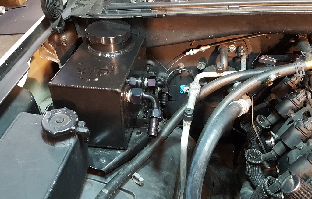

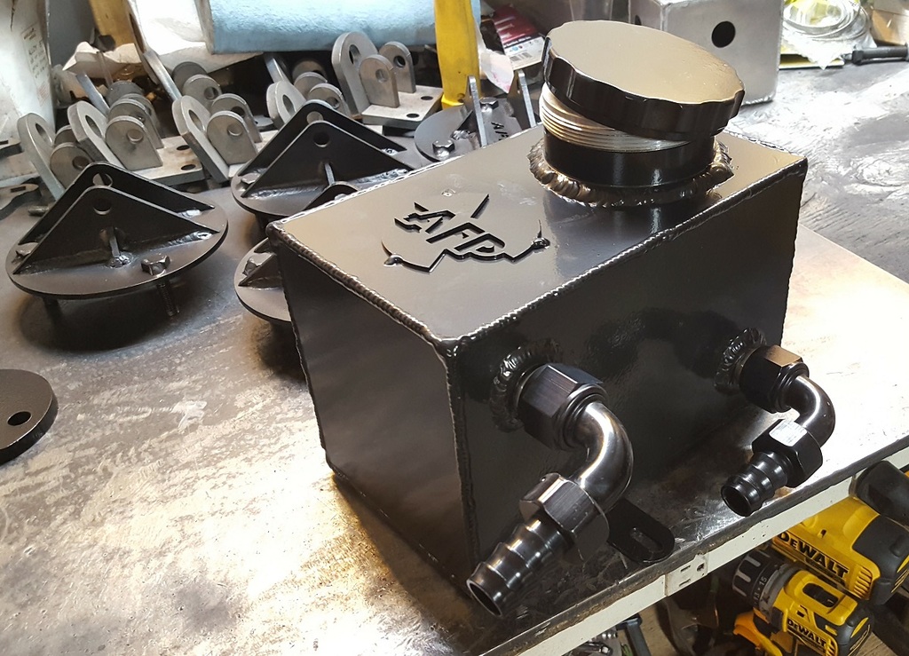

I'm very happy with how this turned out, just wish I hadnt put the top on backwards, doh! The black powdercoat was a good idea I think.

I have enough material to make another one if anyone wants one.

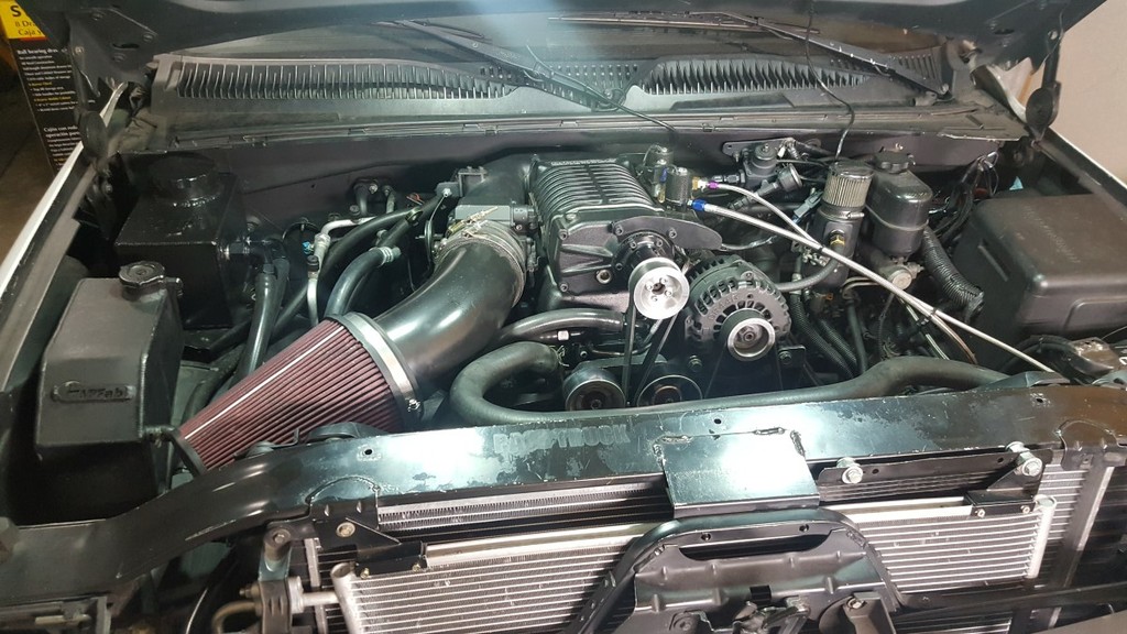

I got everything back together today and just started it up to make sure nothing was going to explode and it was good to go. Before that I turned on just the pump to prime the system and man it primed in about 5 seconds and anecdotally the new setup really helped the flow increase by a noticeable margin. Same pump, just larger hoses, intercooler fittings, and new dual pass heat exchanger. Total capacity is about 1.5 gallons it seems. I used basically a whole gallon of distilled water and half of a prediluted antifreeze jug.
Really cleaned up the engine bay as well having everything on the passenger side

Looking good man.. When is the next track day to get some timeslips ?

Glad it's working well so far. You really need to do something about that non black air filter.

The air filter issue will be dealt with shortly
