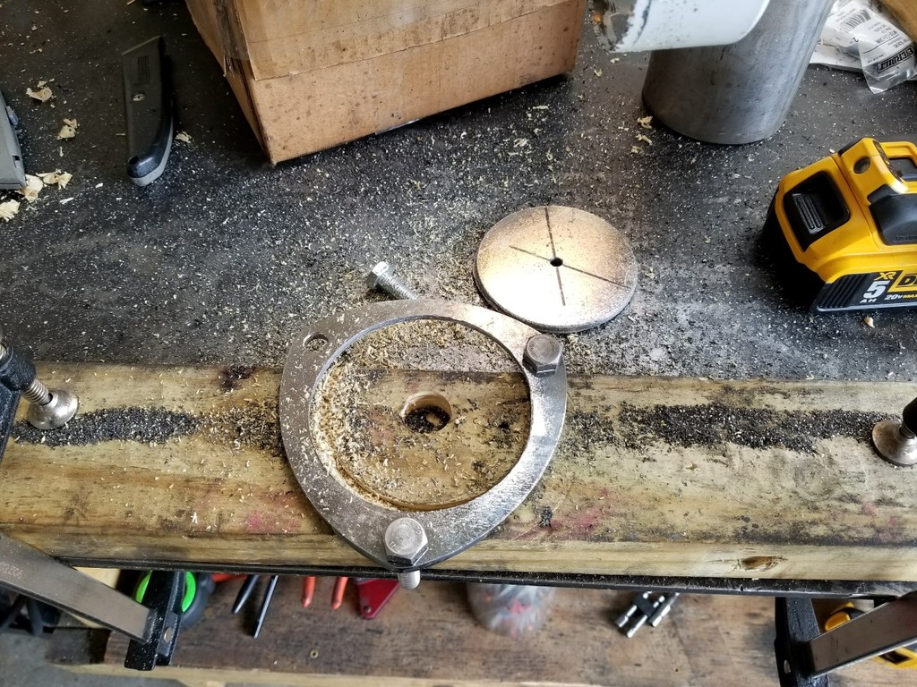

For the cutout since you have to weld on a pipe inside of it to mount I took the cap from the QTP cutout pipe and cut out a hole in it to use as the mount for the cutout,

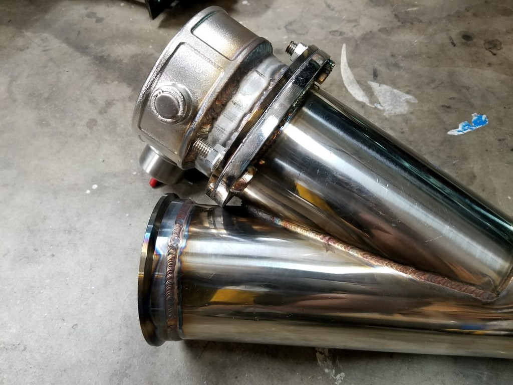

And this is everything together so you can see what I did. I also welded on grade 10.9 stainless bolts as studs to make it easier to remove and use the included gasket.

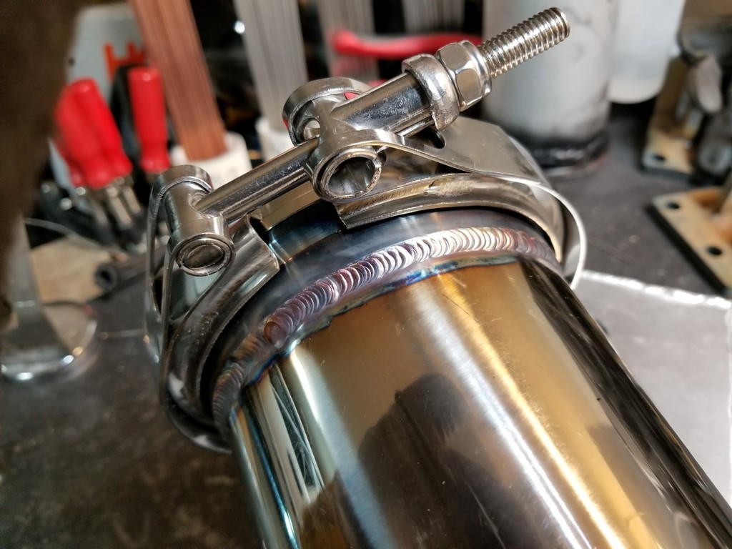

I haven't worked with stainless too much before but this seemed like a good time to practice, and I think it came out ok. I didnt bother backpurging any of this since nothing important is after it. I need some bigger filler, but this will do. Used 308 and 309 depending on which piece I was working on.

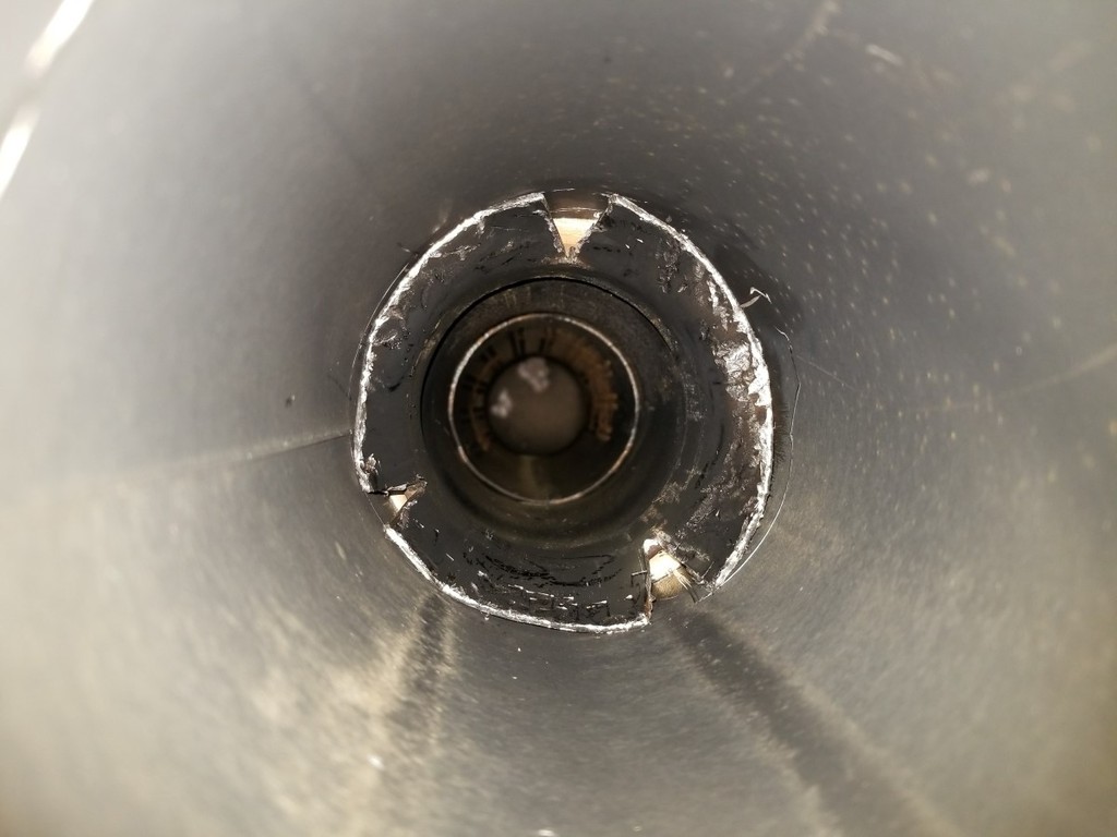

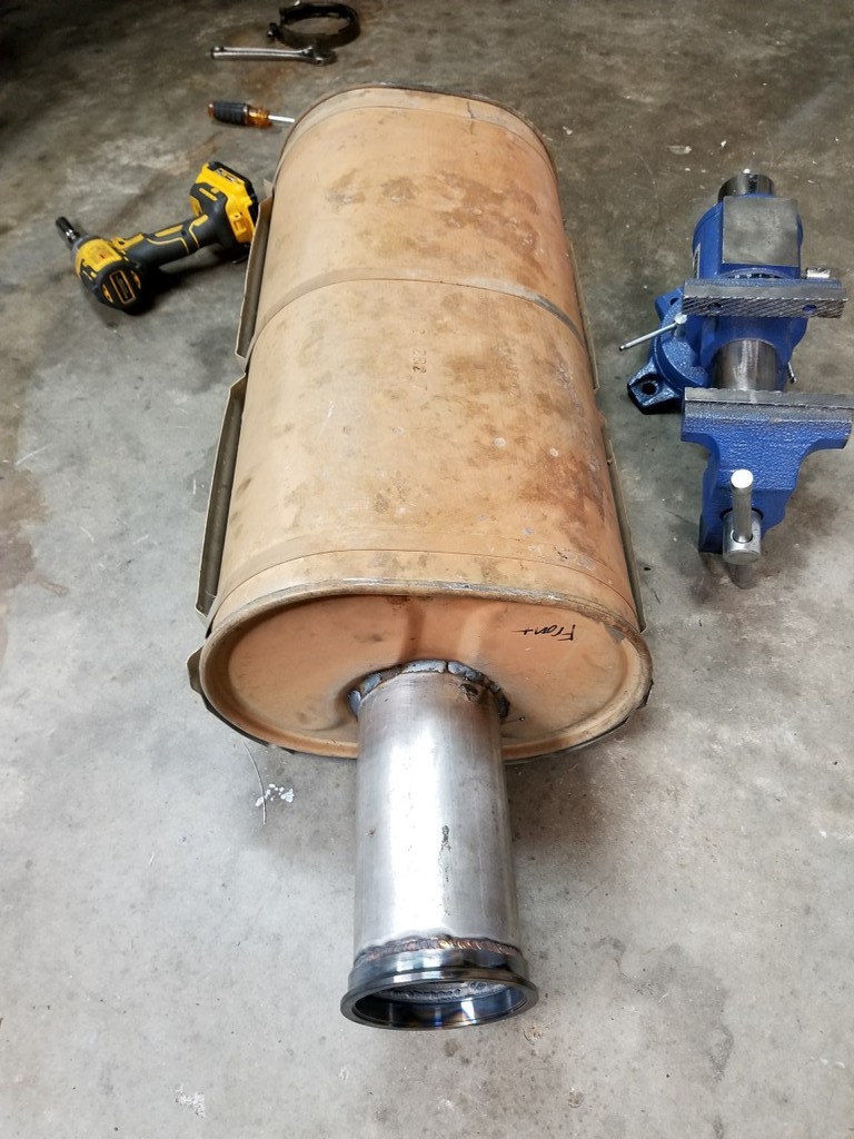

For the muffler since it is 3" inlet and outlet I left a few inches of pipe then made 3 slots and peeled it open to hopefully encourage some better airflow to it (not like it matters) and welded a reused 4" pipe around that and put a Vband on the other end.

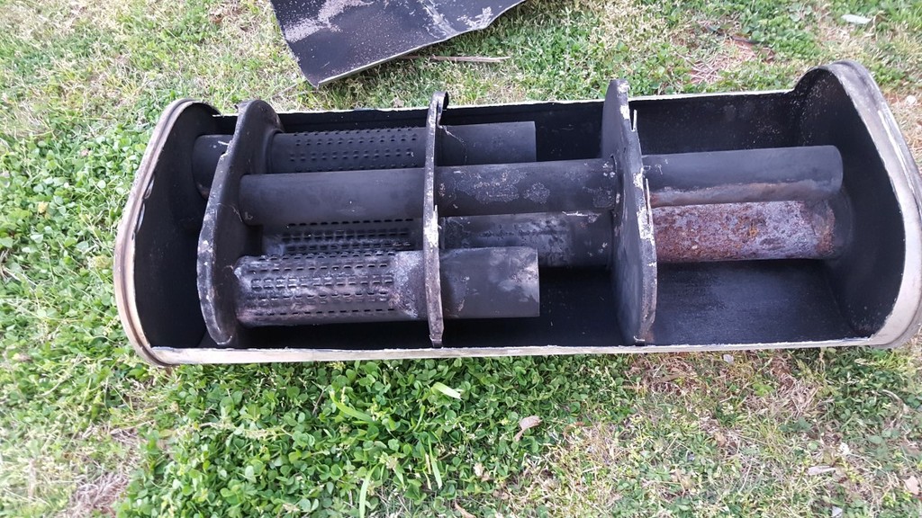

Here is the inside of a stock muffler in case anyone was wondering.
