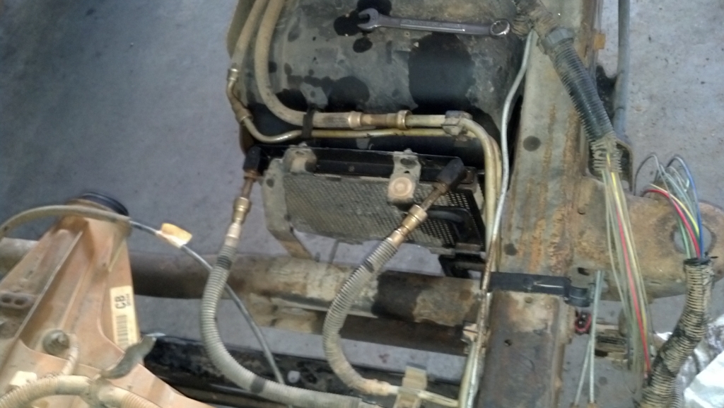

Body lift parts arrived today, so I guess I'll give it a shot and see what it looks like.
Got the fuel tank and lines swapped over today.
Fuel cooler bolts in place of the gasser evap system. No modifications necessary.
I used the factory hard lines and cut a section out of them, spliced with hose. This allowed me to use the factory hardware that mounts the lines to the frame. Everything lined up. Kind of.

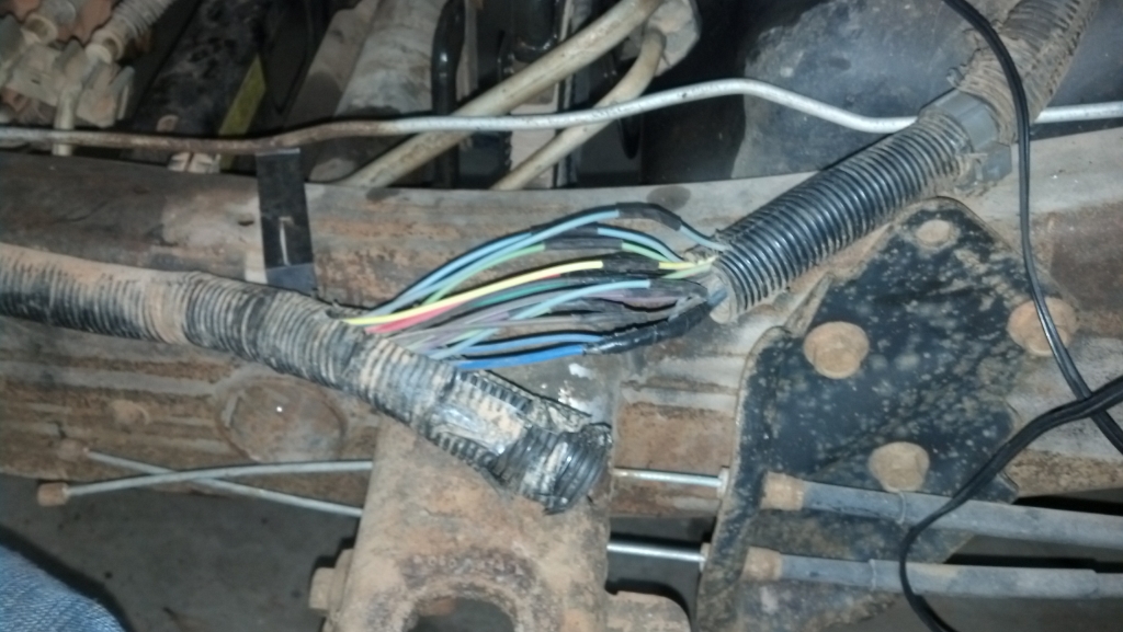

Got the crew cab chassis harness shortened also.

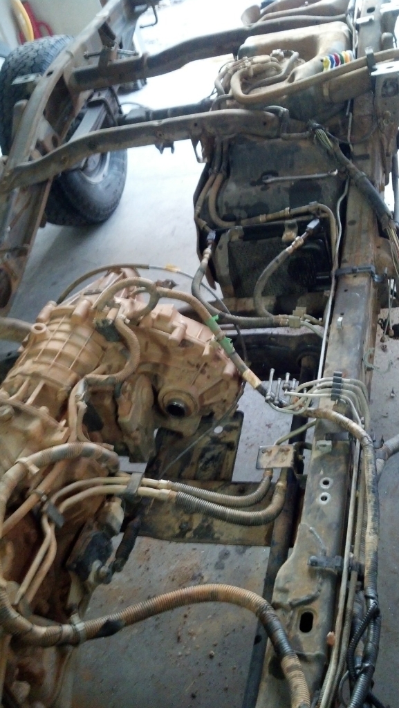

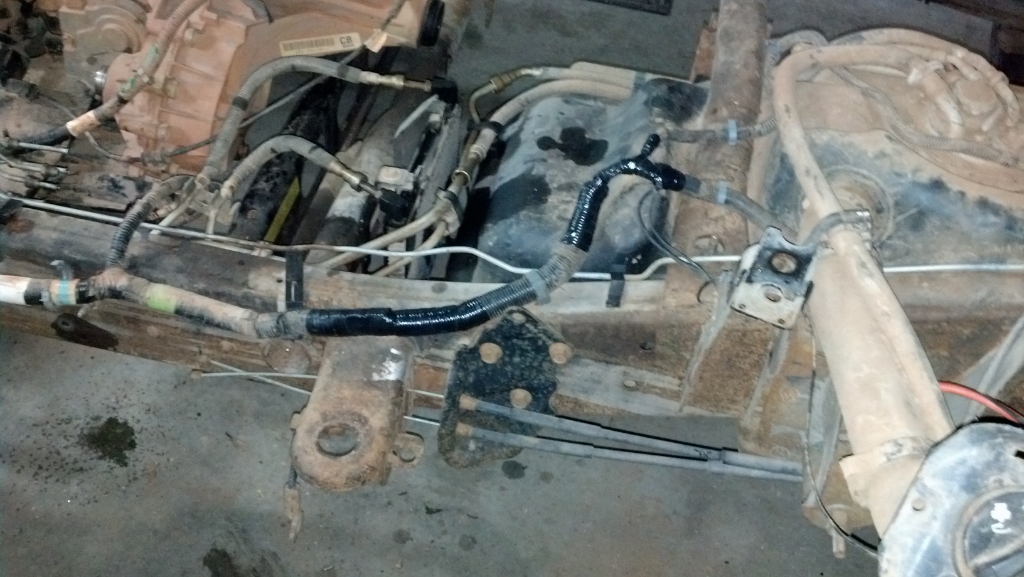

I love all the progress on this build. You're going to be driving this thing in no time. You don't think the rubber hose on the fuel lines will leak? Why not flare it while your in there?
Old Apr 12, 2013 | 09:58 PM
  #194
1slow01Z71's Avatar
Tin Foil Hat Wearin' Fool
iTrader: (36)
Joined: Oct 2004
Posts: 23,204
From: Austin, TX
Diesel fuel lines are in vacuum not under any real pressure like gas trucks since the cp3 sucks the fuel from the tank instead fuel pumps in the tank pressurizing yhe entire line to the injectors. Even after he puts a lift pump in it wont have more than 10psi in the line.

^^ this. I did flare the hard line before putting it in the rubber line.

Thats cool, I didn't know that.

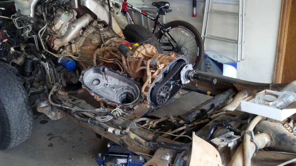

Installed the Merchant Automotive pump rub kit. This was the easiest transfer case work I've ever done

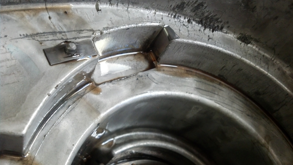

Glad I did this now, the factory clip was broken and there is some wear in the rear t-case half.Name:  IMG_20130413_100907_960_zps19410096.jpg

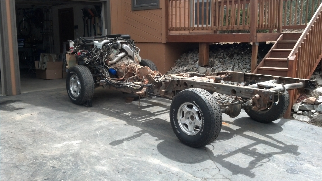

Chassis is ready to go!

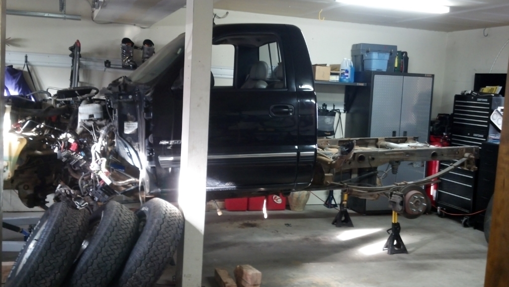

IT FITS!!! WOOHOO!
