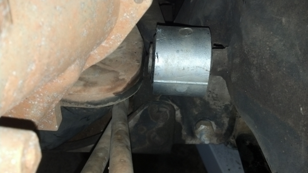

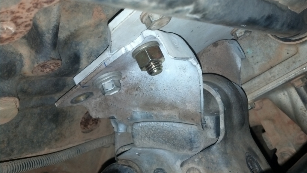

I'm going to try to grind the rest of the hex head off that bolt and see what happens. If that doesn't work, I'll try to loosen the intermediate mounts and see if there's any side-to-side play there, look to see if I can notch the pan a bit, and may try to start trimming down part of the rubber bushing inside the front diff mounting bracket to see if I can get the head of the bolt to recess inside of it. That bolt has a small hex head on the opposite tip as well, so I don't think it's critical to have anything on the engine side that can be grabbed with a wrench.
Here's some more pics I took this morning.
Passenger side mount installed

Driver side mount installed.

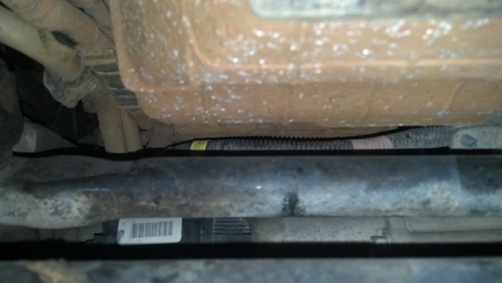

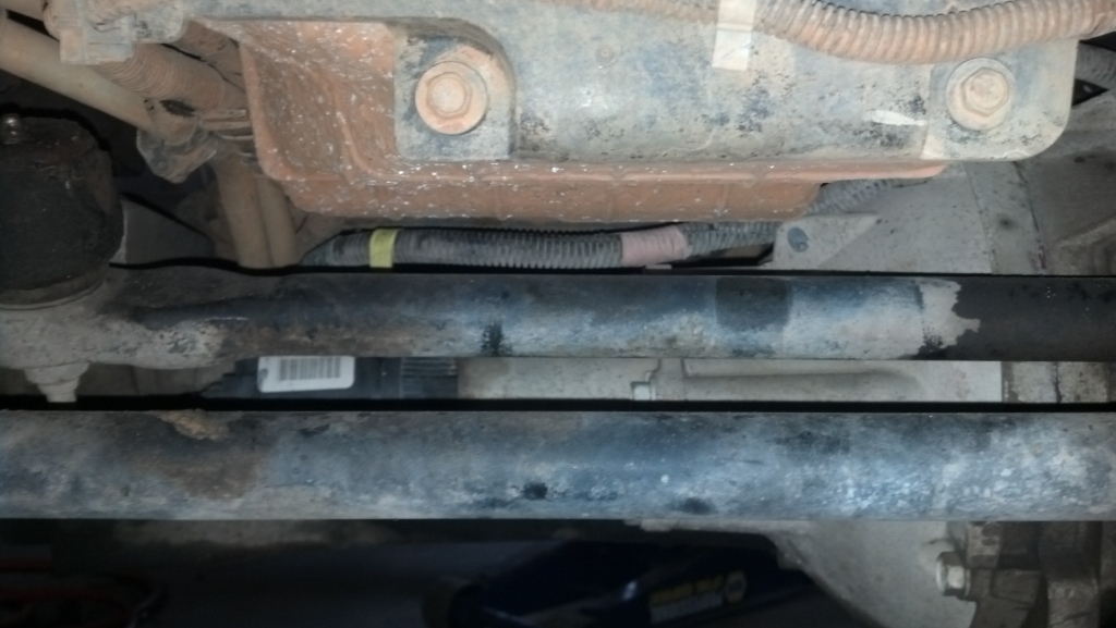

Here's a couple showing the oil pan and center link level with each other.

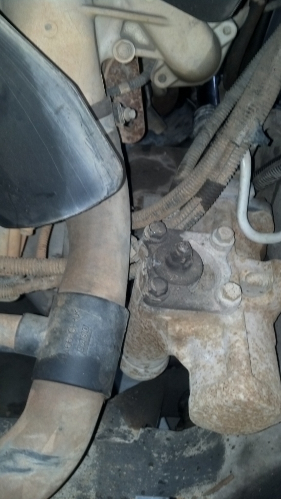

Radiator hose clears steering box

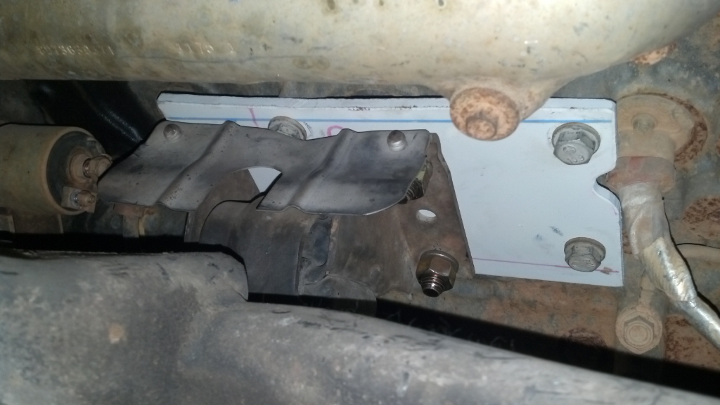

I got the bolt to clear...had to grind the head off completely and also take a little bit off of the sleeve that goes through the front diff support. There's about 1/8" clearance there now, I hope that's enough.

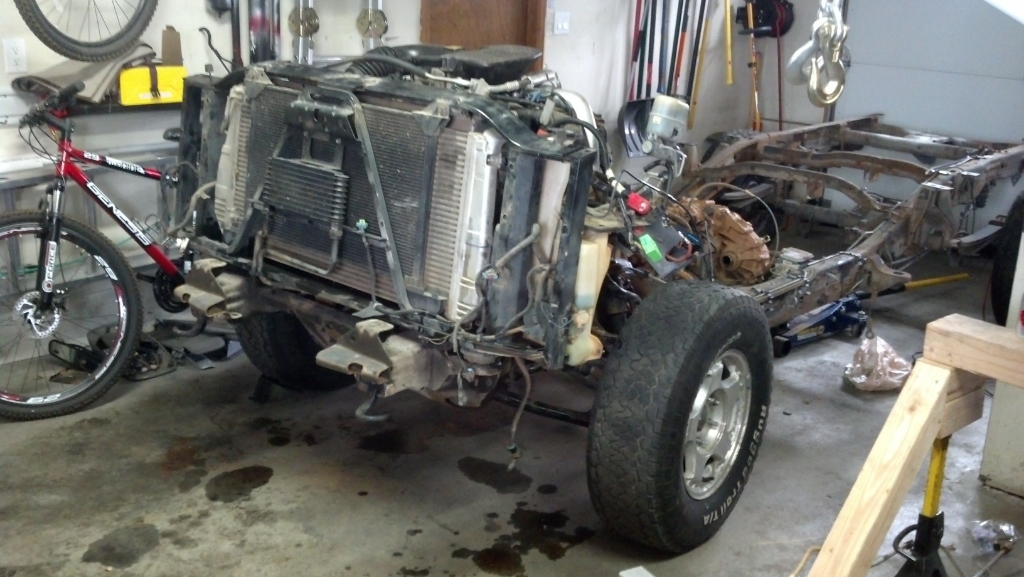

Cooling stack is back on.
Next step is to pull the chassis wiring harness, tank, and fuel lines from the donor truck and put them on this one. I have a pump rub kit from Merchant Automotive on order, so that will go in next, then I need to get my body lift in, then I can set the body back on.
