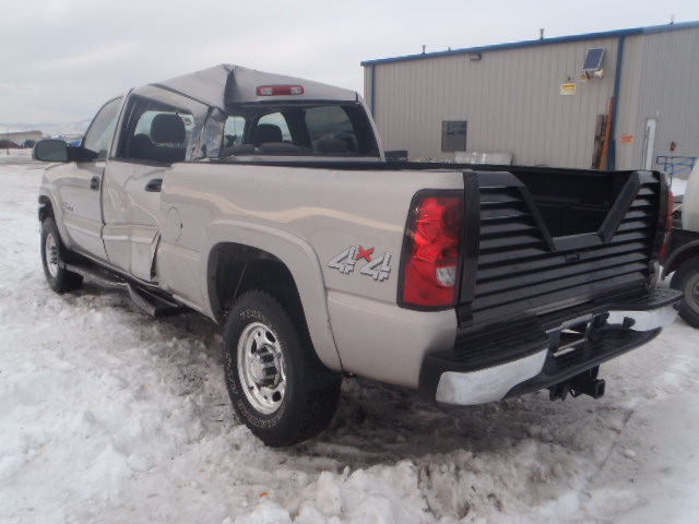

DAMN IT!! This truck sold FOR my max bid today...someone else just happened to get theirs in before my broker got my bid in. 6 more coming up soon, crossing fingers!
