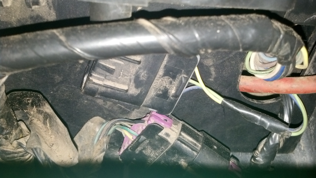

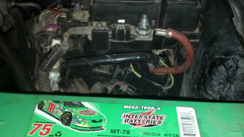

First, I have this connector on the underhood fuse box that I can't find a mate for. It's the only one that doesn't have something that connects to it. Anyone know if this is supposed to be this way, or did I lose a connector somewhere in the rat's nest of wiring?

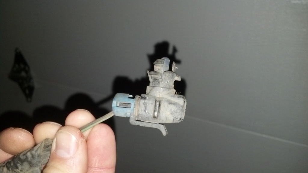

Next, I have this sensor that needs a home. It looks like a temperature probe, but it's not the external temp probe that mounts next to the trans cooler, I already have that one in place. The pigtail feeds into the same harness that the passenger side horn and lights are on. Anyone know where it goes?

That last one i believe is the rear view mirror temp probe

Don't know about the connector but that sensor is the airbag sensor. You need to mount it on the lower core support. Should be a hole somewhere in there for it already.
Already have both of those mounted and plugged in, so it has to be something else...

Here's the response I got over on dieselplace
Originally Posted by Durry SS
the one "missing" connector has nothing connected to it if its the one on the outside of the plastic box near battery...... and in the second pic.. the one "probe" clips into the plastic filler on passenger side under marker light.. and the other"probe" on driver side clip into the filler plastic in the center of the rad cradle at the bottom
I'm curious what these sensors do now...it's not the compass temp sensor, what else would it be?
