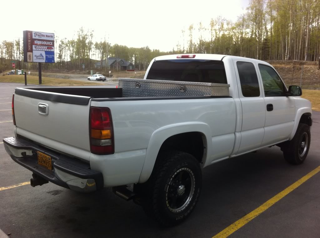

For the tailpipe, I like how mine is done. You'd need to get a mandrel bend and a polished stainless tip of your choice, and weld a little bit. Here's an old pic of mine(looks like **** right now, covered in winter grime & mud).

I'd take that clamp off and weld it there, get a 45* bend and a tip and make sure the tip is AT LEAST flush with the body, if not out 1/2" or so, itll completely jack the paint and bumper up...

GFYS! I'm going to look for a tip to put on that exhaust, and I'll spend some time soon trying to move it around to get it where I want it. It's far enough back that it won't affect the body but I think where it is right now it would probably get the rear bumper.
Thanks for the pic. I like the swept look, just need to play around with it after I put a tip on there so I can keep it away from the bumper.
