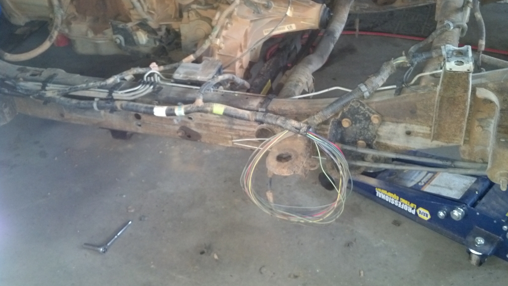

Got the chassis and transfer case harnesses swapped over this afternoon. I have about 2 feet of length to take out of it, might try to do that tomorrow. I am currently out of heat shrink tubing and almost out of electrical tape, so tomorrow is a parts run afternoon.
Also figured out that the connectors on the ABS modules are different. Any thoughts on whether I can cut and splice the connectors, or if I need to swap the whole module over from the 05?
