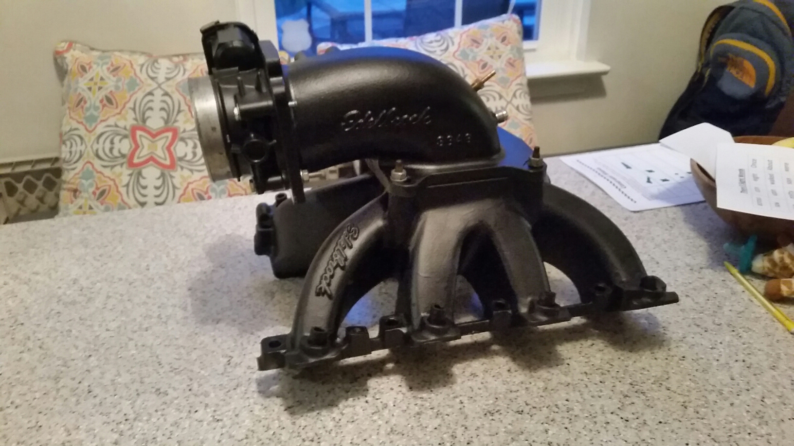

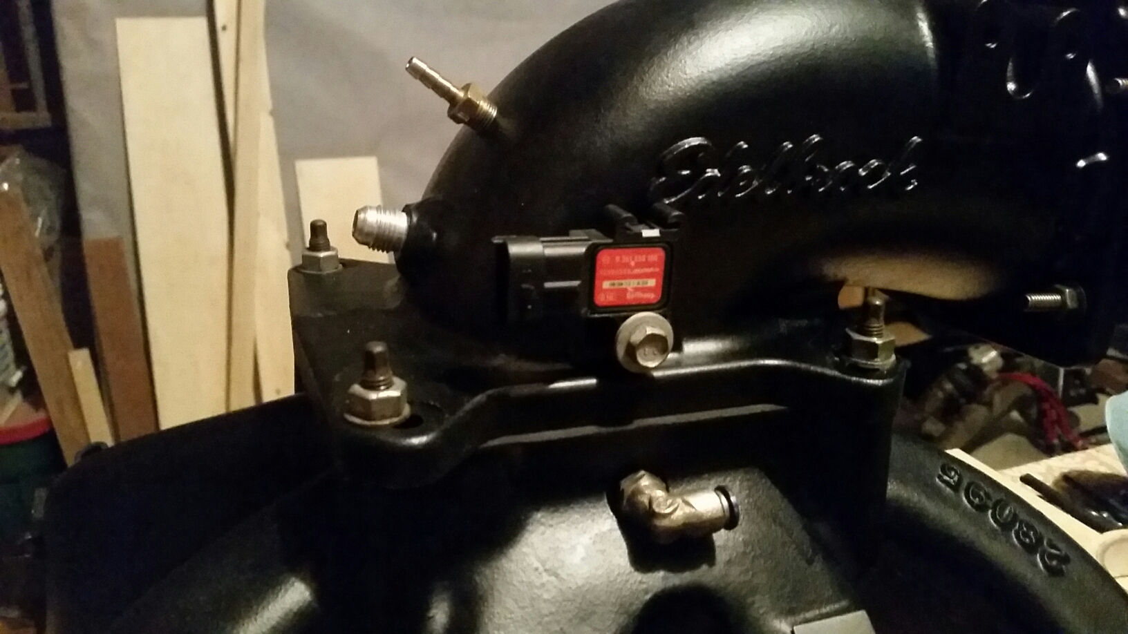

Giggidy... painted and mounted MAP sensor directly instead of off a Tee and also set up vacuum ports directly off of manifold to keep things a bit neater at the back of engine.

Now need to order the MAC boost solenoid to work with my AEM boost gauge/controller and wire that up.

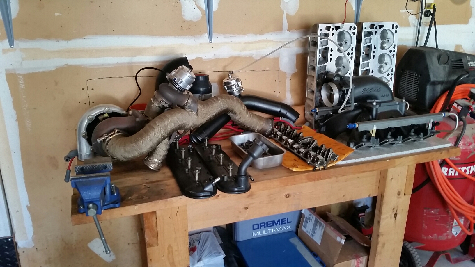

So, I put everything away and did some spring cleaning around the garage today.

Also go into the engine bay with a brush, rags and carb cleaner and went to town cleaning the deck surface and all the piston tops, they're all squeaky clean now. My neighbor gave me a wierd look when she saw me IN the engine compartment haha

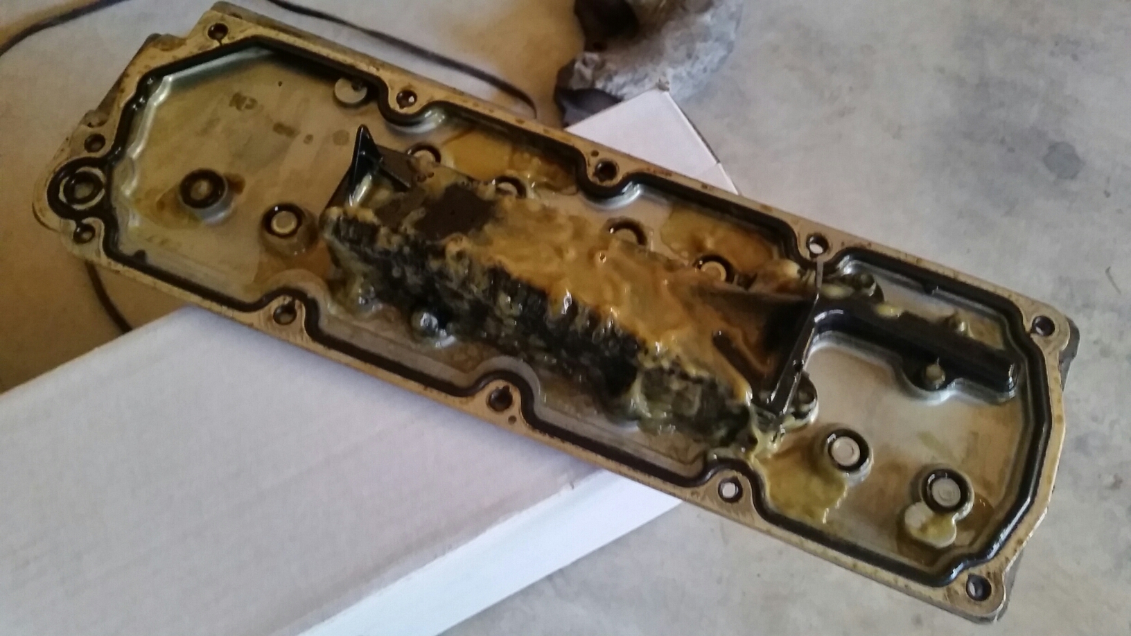

So I kept at it and took the valley cover off ... holy crap it looked like poop in there!

Took kitchen towels and went at it again ... it's all clean in the engine as I can get it. Took valley cover pcv system completely apart and cleaned it all and sealed everything back up. What a mess...
